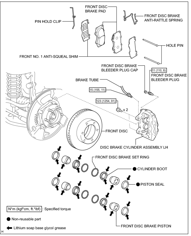

Caliper sliding pins require lubricant. See attached. My question is what Silicon lube everyone is using and happy with for these. Don't want to buy the Lithium soap base glycol grease from Toyota. From looking into it further last night, it seems silicon paste or Sil-Glyde lubricant will work after cleaning the pins.

Toyota uses Lithium soap based glycol grease, which evidently is pink or red. I plan on using Sil-Glyds or Silicone paste or possibly the urea stuff above on the pins. I'll use some high temp brake grease on the pad shims and a thin coat on the metal piston face.
Am I the only one who noticed that this is an exploded view of the rear calipers?

HAha, you are correct! I pulled that off the internet somewhere. Here is the correct front from the RM.
But what is odd is that it is labeled front brake caliper.
