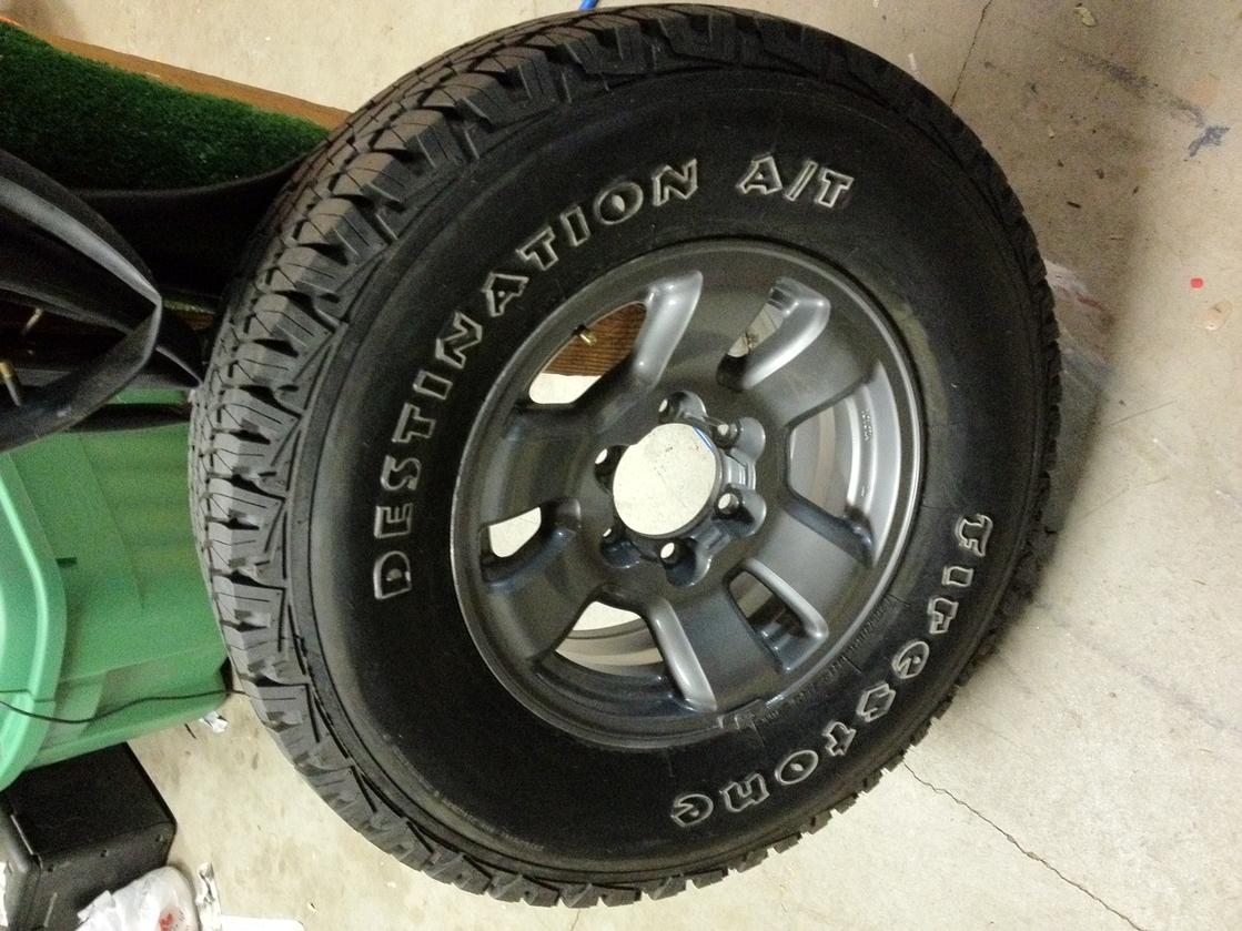

Thanks Fightman! I'll be doing the exact same color with a couple exceptions.

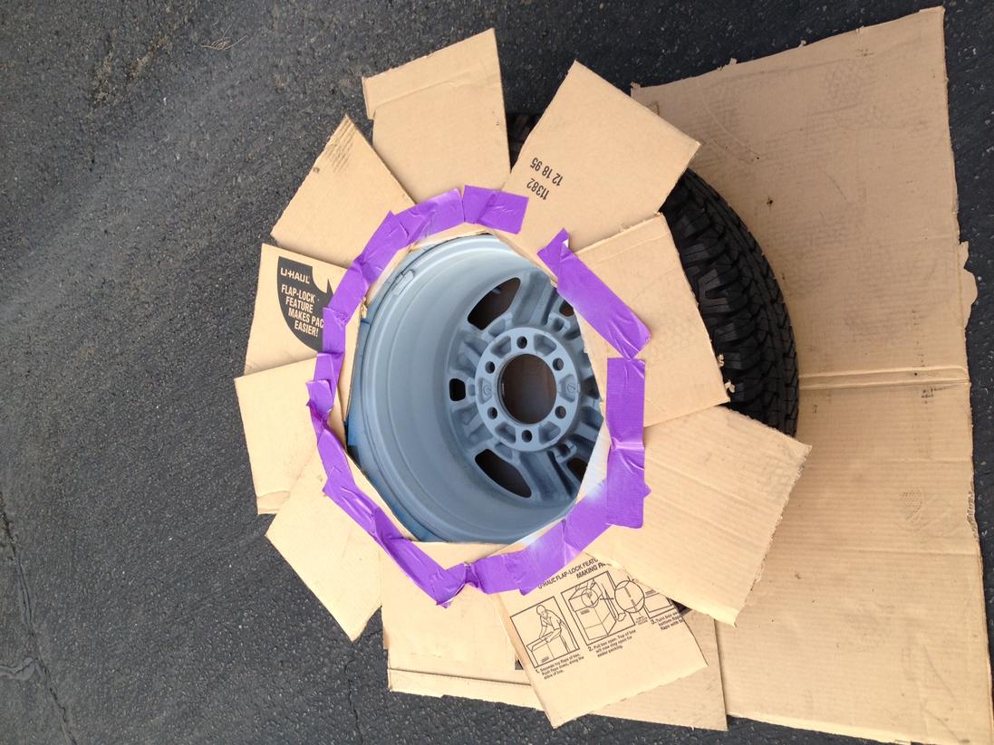

I'm only doing two wheels at a time.

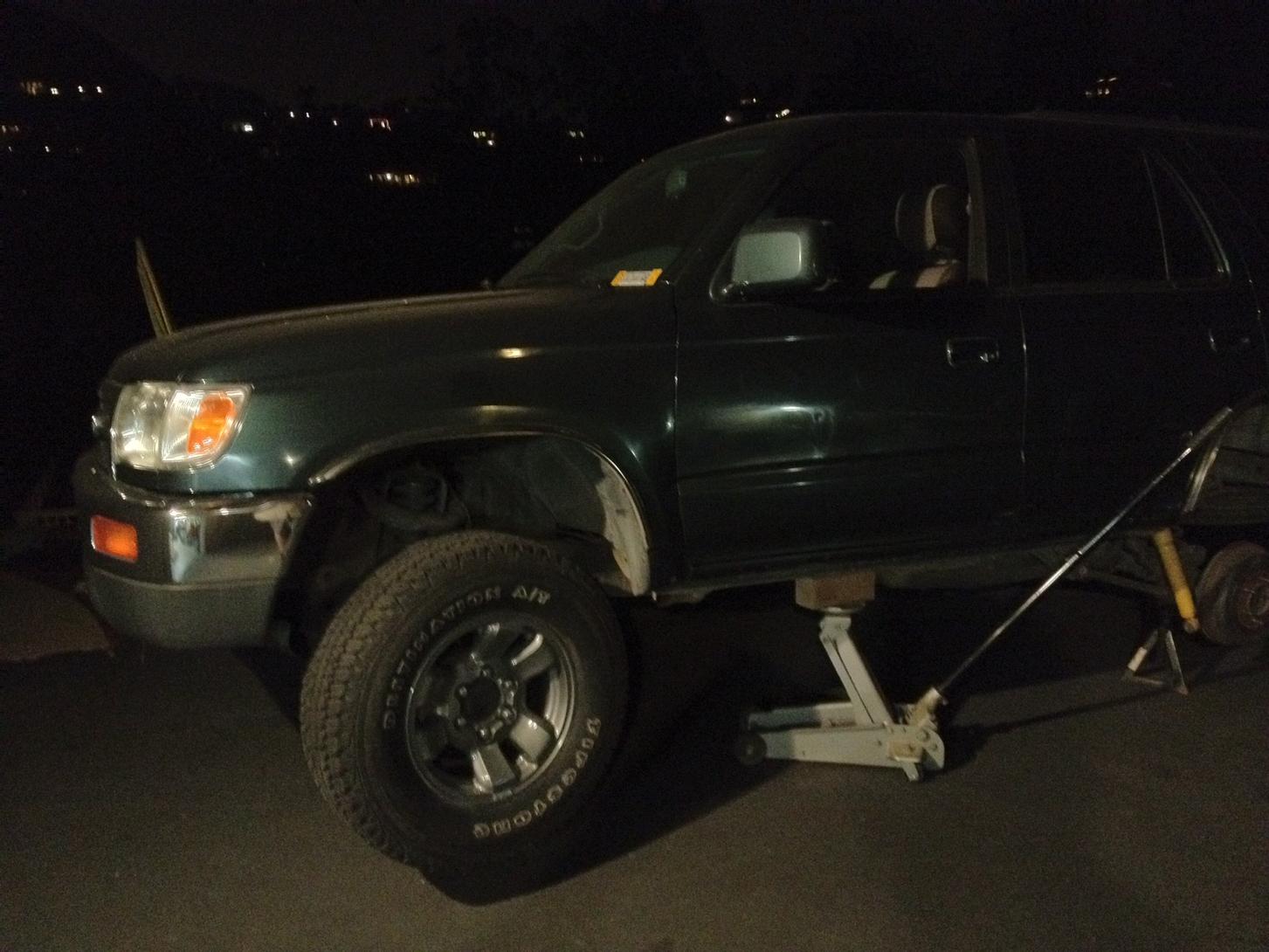

Well I'll let the pictures explain it.

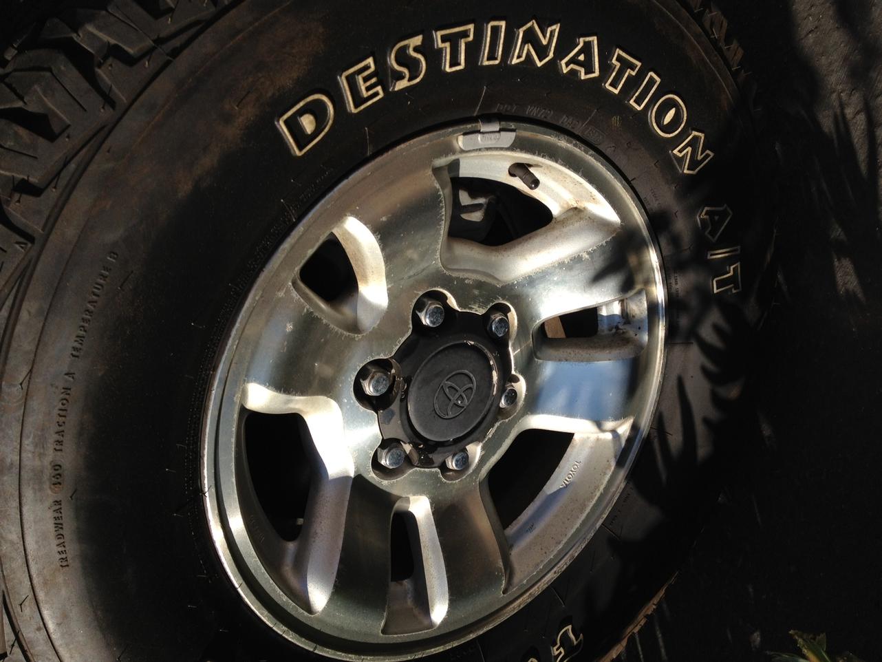

Photo 1) Wheel before (Clear Coat Peeling off)

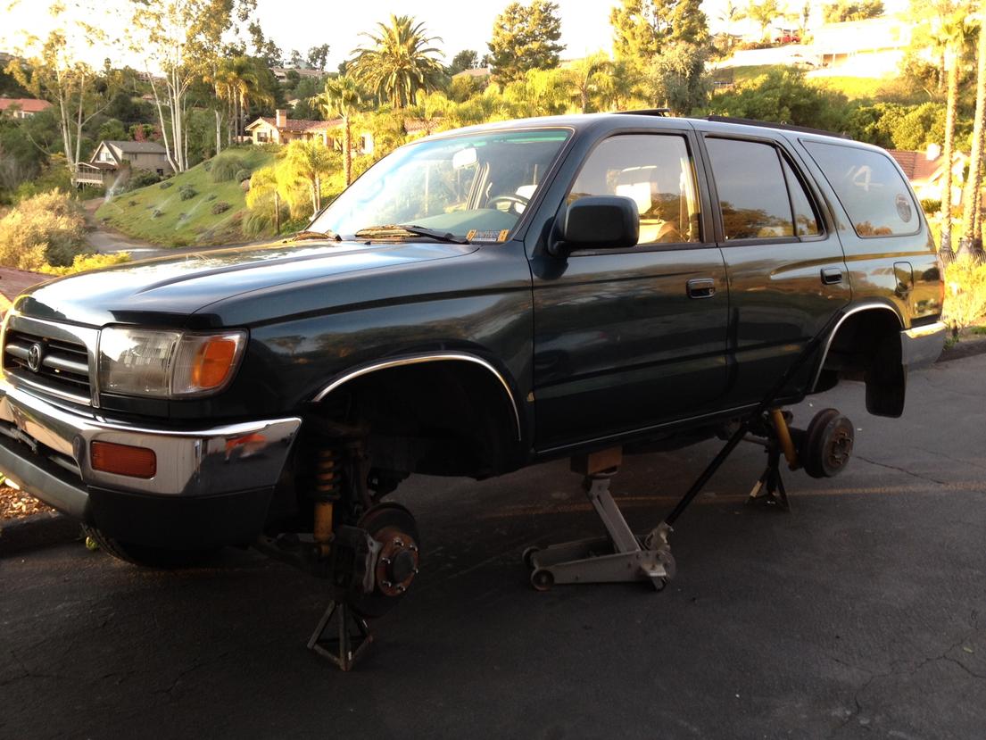

2) Jacked it up

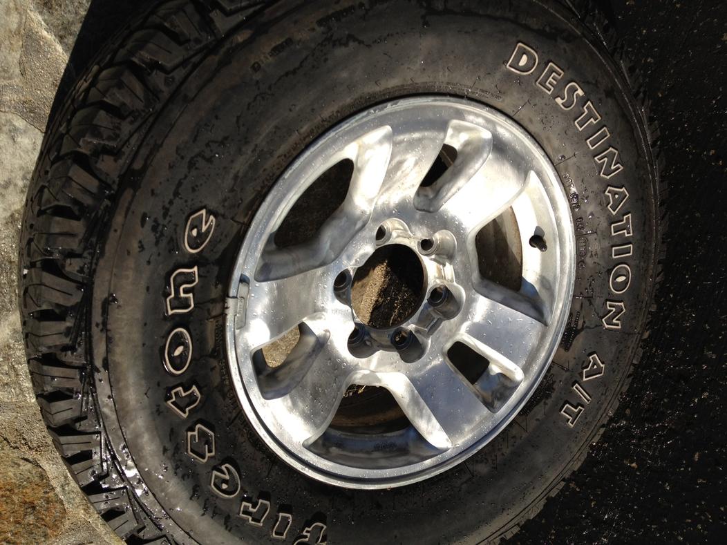

3) After wire-wheeled it

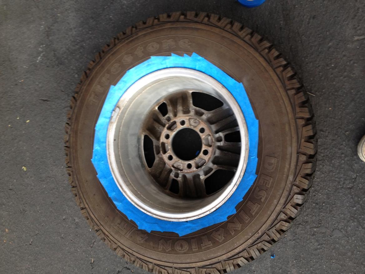

4) Tape around the wheel
5) Use some cardboard and duck tape to make this thing.

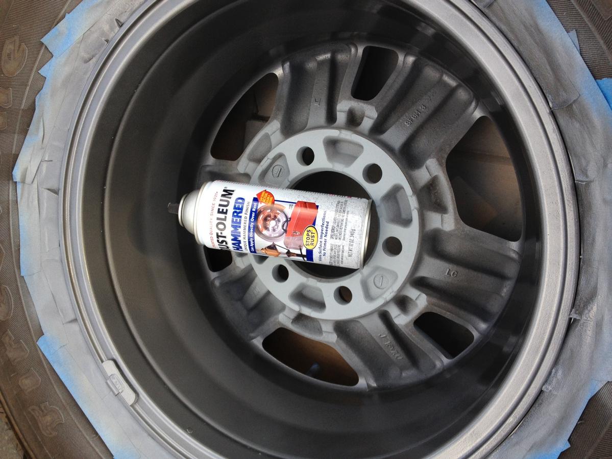

6) No Photo, but after primer I wet-sanded with 400 grit. Tomorrow will spray another coat of Primer.
7) After another coat of primer and sanding again, painted the inside of the wheels with Rust-Oleum Hammered Gray Paint. 2 Coats of that and the inside is done.

They are going to look good...Use playing cards or business cards in between the wheel and tire. Saves a lot of time...
Doing the INSIDE too? Wow, now I feel like a real lazy schmuck. I thought about that for two seconds when I did mine...naaaah...don't need to do that.
Can't wait to see what you come up with man! I also used playing cards....only did so halfway through the job though.....as I didn't know about the trick until after.......

Whatever Wire wheel I had in my garage. The all work, you're just trying to get the clear coat off. Ya I just put it in my drill.

If you take your time to sand, paint coats, and use the right clear coat. It will usually stick.
I'll try your Jelly thing tomorrow!
(Playing cards didn't work the best.)
Did you use a self etching primer? If not then I still wish you the best of luck but it might not hold up.
Yes I did.
Rust-Oleum from Home-Depot
Edit: I just checked and I'm actually using Primer Filler from Rust-Oleum. So if it doesn't work then, I'll just have to do it again.
It's my Daily Driver and won't see too much off road use.
