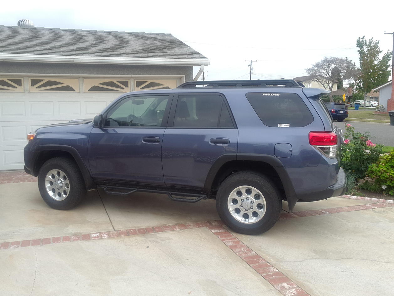

I have an old 2013. I set the Bilsteins to 0.85 and it's almost level. Going to 1.75 may be a good level, but it may go nose high, reverse rake when loaded. You could add air bags, but may have to change the pressure too often. The photo is at 0.85.
The rear was 1 inch higher than the front after the front Bilsteins; when I added 5100s to the rear recently it's 1 1/4 higher in the rear. I have 6 pounds in the Airlifts.
