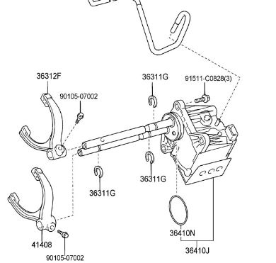

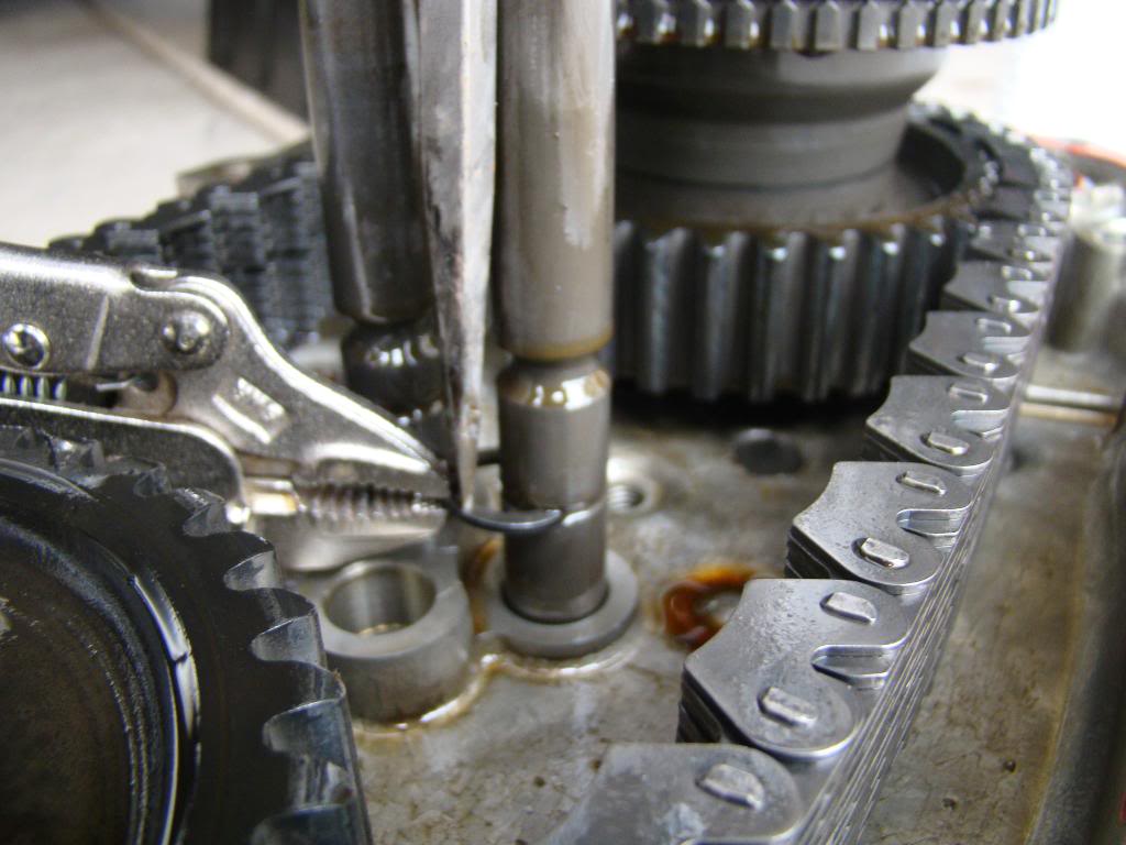

905201-3002 is a snap ring that goes on the actuator shift rods. There are two on one rod and one on the other for a total of 3. You should have replacements in case they get banged up during removal. See attached removal picture and parts diagram (36311G).

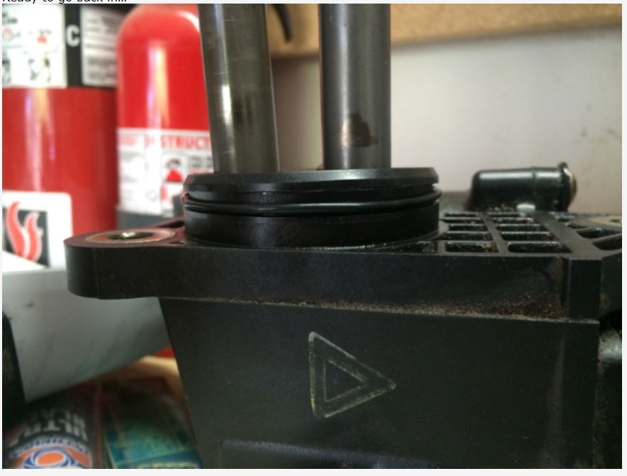

90301-56009 is an o-ring that goes around the base of the actuator. It typically leaks so you want to replace this (36410N in parts diagram). It is also shown below in a pic from the OP.
Note: you may also want to get 2 new lock nuts that go on the two transfer case output flanges (90179-22016) and dust seals (90312-23001) for good measure.
