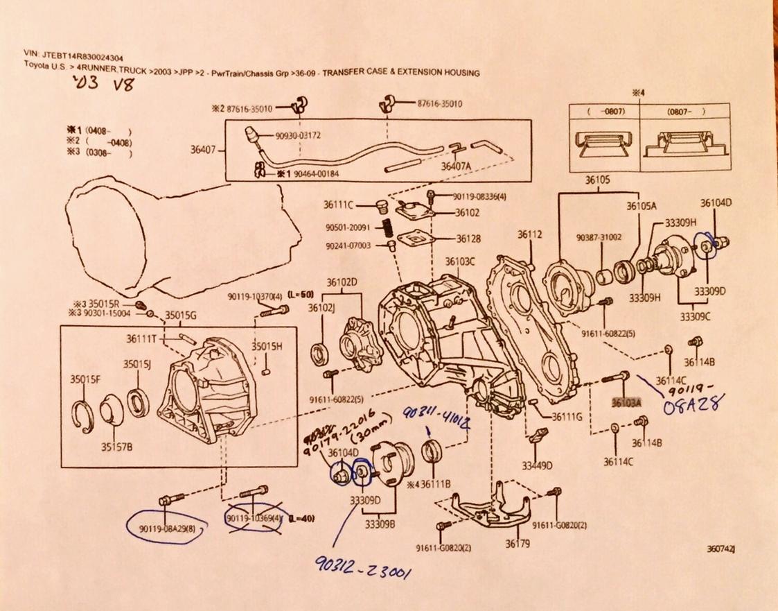

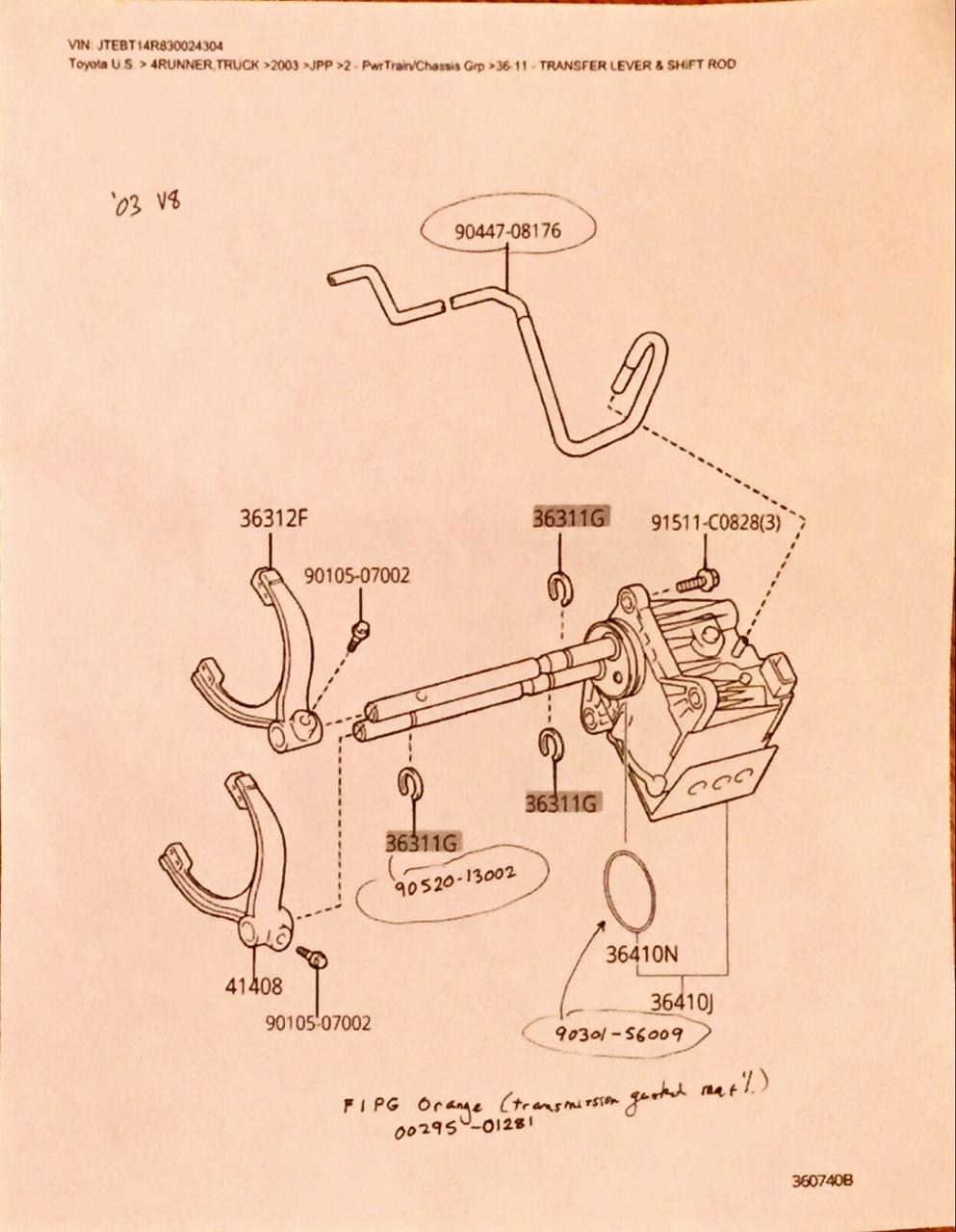

First, I attached schematics for an '03 V8 with part numbers of the items you will need and some you may need. The local dealer was very helpful figuring the parts I needed and getting them in the next day typically.

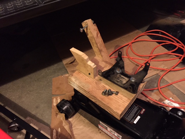

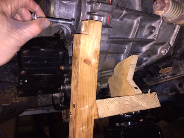

Second, here are a few thoughts as I went through the process.
1. I wish I had taken the advice of a previous poster and built a good cradle on top of the floor jack or procured a transmission jack. Instead I built a half-ass cradle and the xfer case rolled off and hyperextended my thumb (ouch!). I ended up building the cradle shown and lag-screwing it to my floor jack (see attached images; worked well.)

6. Had to destroy the 3 snap rings to get them off. Was worried I would have trouble getting the new rings on but they were a ...snap.
7. Looks like the case itself must be the same as the V-6 model because there are holes for three actuator shafts. I wonder if the third (empty) hole were not there if the leakage problem would be bad on these V-8's.
8. The O-ring was definitely failed; flattened around most of its circumference. It bothered me that there was a little play in the lineup of the actuator with the three bolts. I hope the O ring gap is even now.
9. During reassembly I thought I would be smart and do a couple of dry fits before applying the RTV. This turned into a scary moment when the bearing on the top of the shorter shaft got stuck in the larger half of the case. When I separated the halves the lower bearing pulled out of the lower half; that caused the chain to fall off. It took a few minutes to figure out how to put the chain back on.
10. I wish I had remembered to put the wiring harness bracket back on when I bolted the case back together. One of the case bolts had come out with galled threads; I didn't think to chase the threads in the case so when I screwed a bolt back into that bad socket it got very difficult to turn. But it went in all the way without breaking.
11. I am glad I went ahead and replaced the front drive shaft seal. The old one looked a bit ragged and it was not difficult to do.
12. Again, the cradle on the floor jack really help getting the transfer case back into the vehicle. It took several minutes of minute adjustments and jiggling but it went in with little effort. I cannot imagine how my helper and I could have manhandled the thing back into place. The driven shaft has to fit through a bearing in the transmission and the shaft is not tapered so lineup is critical.
