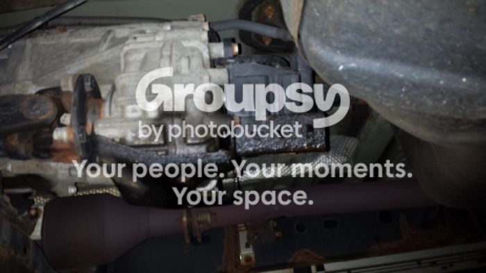

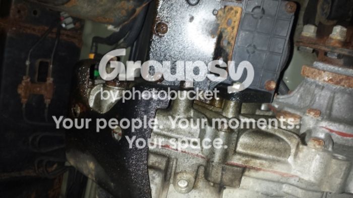

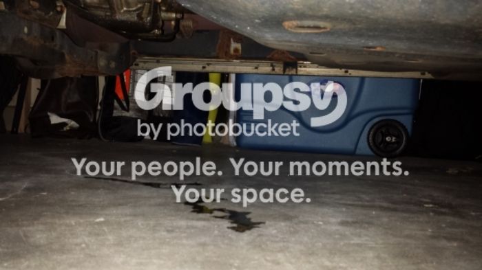

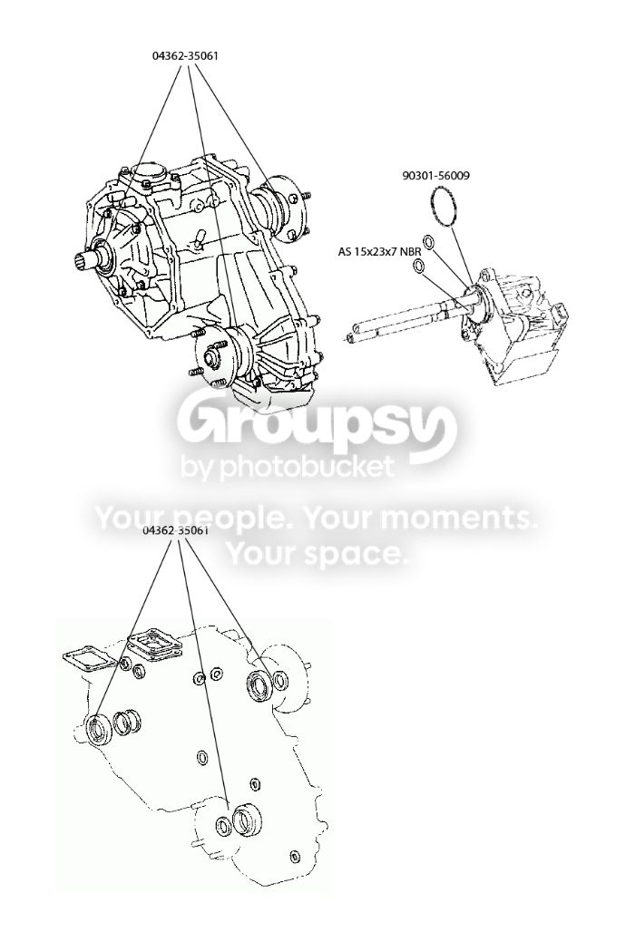

I had this done last weekend (in addition to a bunch of other work). I bought the car from NJ and drove it back 250 miles and put it in the garage. A week later I took a look under and found a nice puddle of gear oil. Seems previous owner never engaged the actuator so me doing it may have cause it to finally leak. I did my research and came upon this thread. I acquired the parts, printed this thread out in addition to a custom parts diagram I made and handed it to my mechanic. He followed it to the T and now the undercarriage is as dry as Cali. Thanks for a great DIY.

My transfer case actuator is leaking as well and I am gonna go ahead and deal with it soon; I wanted to point out that if you're going to go through the hassle of tearing the case apart you may want to spend the extra $30~40 and get the gasket/seal kit for the transfer case to replace them while you have it apart.
Here's the part numbers for the gasket/seal kit, transfer case actuator O-ring, and Toyota "Orange" FIPG (Form In Place Gasket) we use at work:
04362-35070 [VF4BM and VF4AM Transfer Case Gasket/Seal Kit]
90301-56009 [Transfer Case Actuator O-Ring]
00295-1281 [Orange FIPG for Transmissions/Transfer Cases/Differentials]
