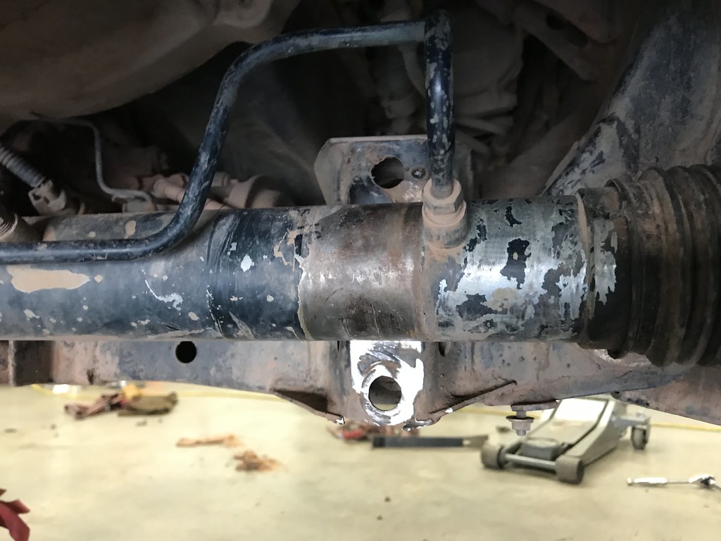

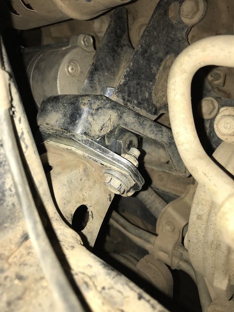

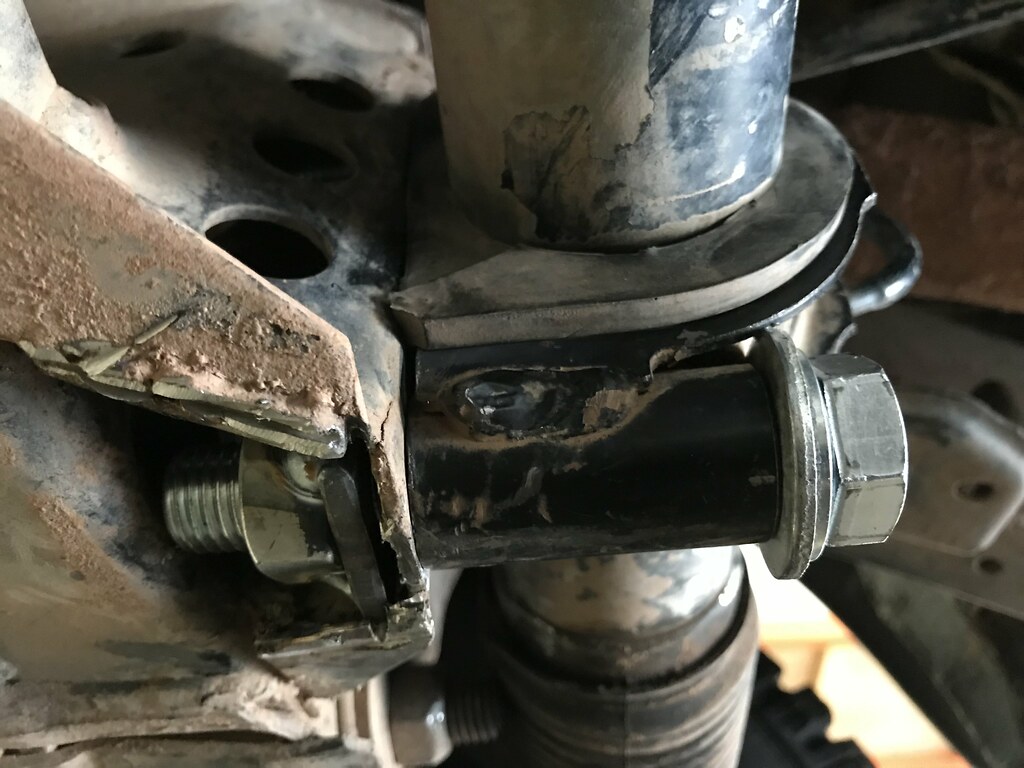

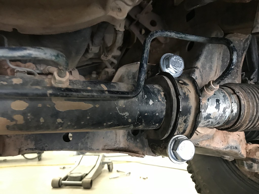

Step one of fixing Moab carnage was to fix the broken D bushing clamp hardware. When I broke mine [MENTION=118730]AssBurns[/MENTION] sent me a picture of his fixed and I liked it a lot so I copied it. Really quite easy.
Stripped everything down. The hardest part was pulling the ratchet strap off as it had lodged into a small gap on my frame. Needed a bfh to get it out.
Untitled by alex fleming, on Flickr

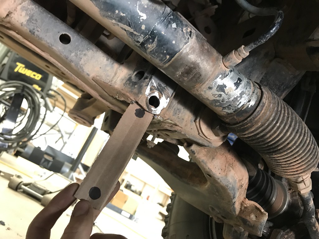

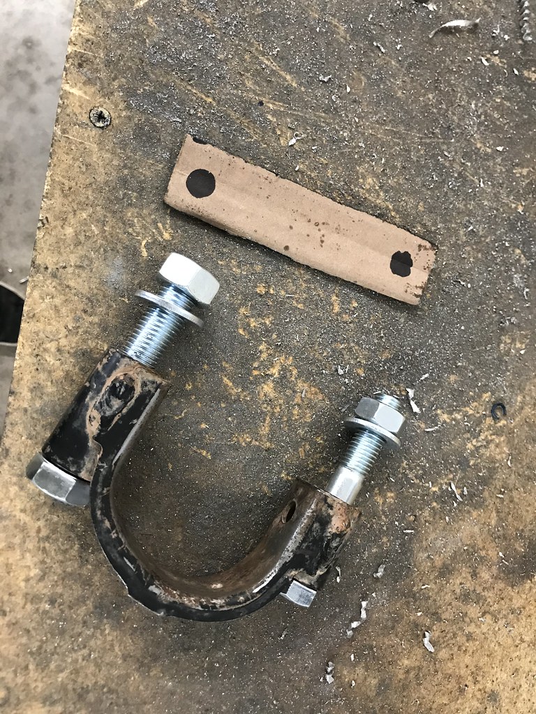

Quick template to get my hole spacing and width and length of the part.

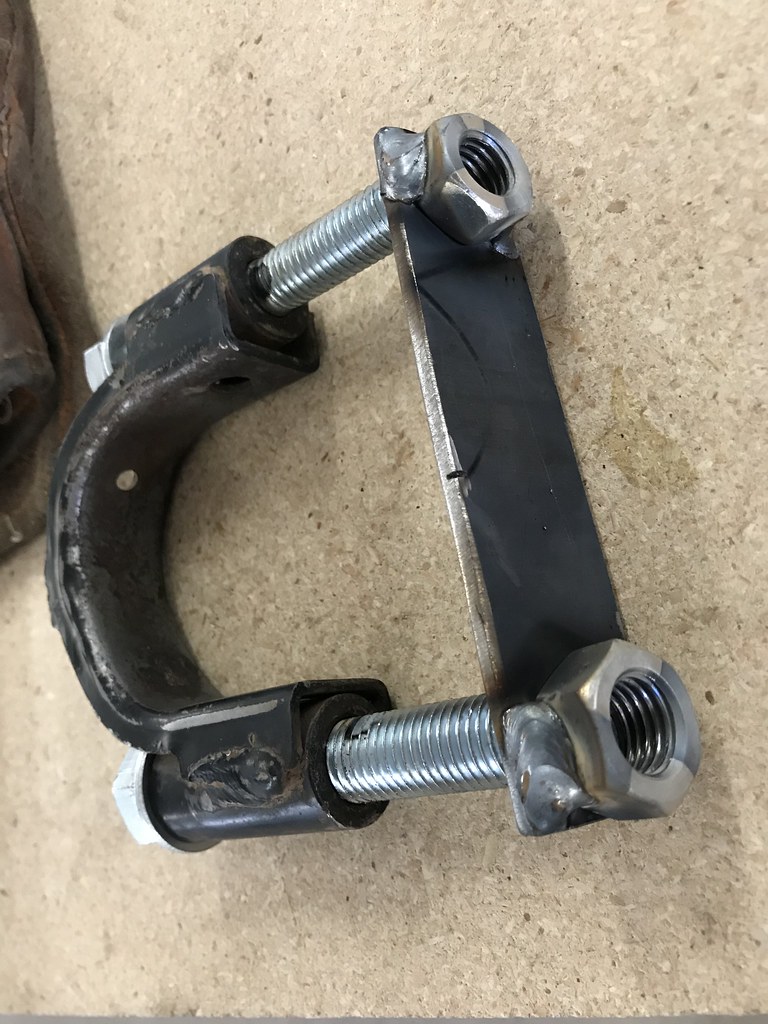

Some new hardware and a few welds later.
Bolted up super easy. Took about 45 minutes with a trip to the hardware store.

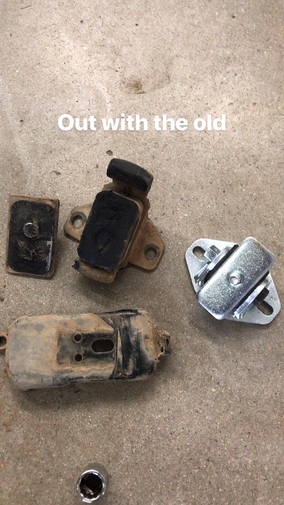

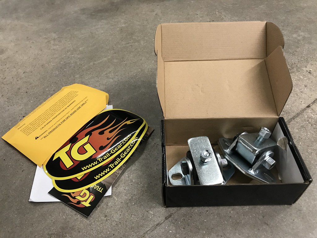

Replaced my motor mounts with Trail Gears Bomb Proof mounts.
Having had the same issue as [MENTION=107971]derpiful[/MENTION] and losing my driver side motor mount completely, I opted to go for beef over comfort. The price tag was slightly more appealing as opposed to OEM mounts as well.
Ordered my mounts from Chasis Unlimited. Minus their lack of communications, the mounts showed about just over a week after I ordered them and they had the best price I found.

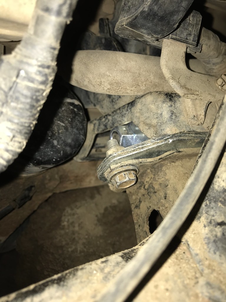

Got the old ones both out in about an hour, It's quite tricky getting tools in to remove them but with some persistence and creativity, it wasnt too bad.
The new ones also took about an hour to get in, using a jack on the drain plug. Not my best idea... and a prybar, I was able to line everything up and bolt them in by myself. I had a little help tightening everything up at the end as it was available but I would have been able to complete the job all by myself if anyone was wondering. It is totally doable.

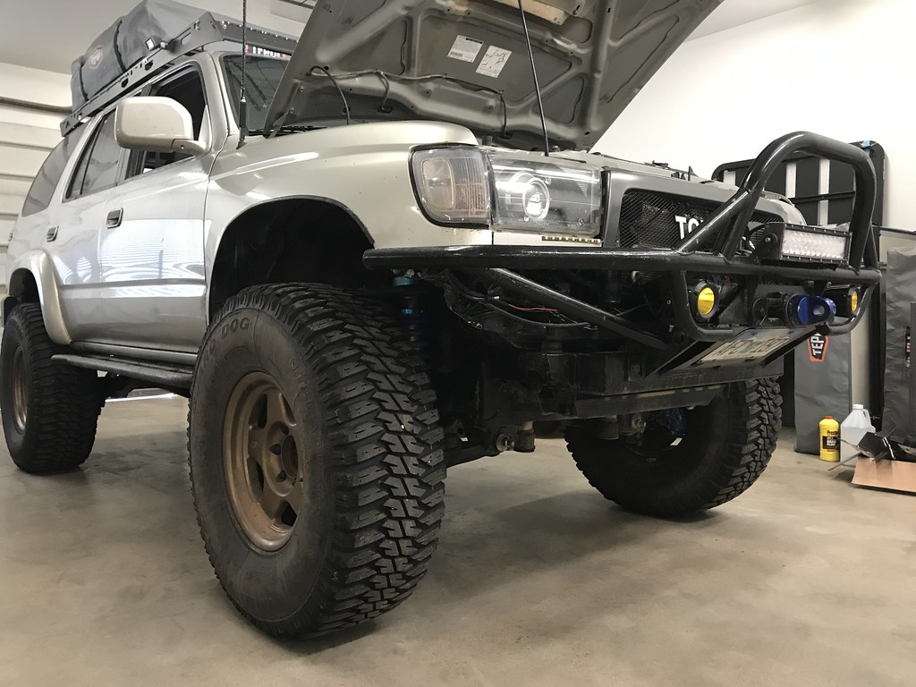

Once everything was in, got the tires back on and back on the ground.
One of the main problems with these motor mounts is vibrations. I have heard from several sources that it is unbearable and people often switch them back out for OEM mounts. I will say this. They exist and it's noticeable. But, it's not bad at all. I had a transfer case skid that slightly rattled on my frame back in the day and that was way more horrendous than what these do. In gear at idle its the loudest. It can cause a harmonic rhythm that rattles some stuff and can get loud but if you drop it in neutral it completely stops. I've also been told they break in overtime and get nicer so if this is the worst it is ever going to be I am totally happy with the piece of mind they will never break again.
Overall, fairly easy to swap, just need skinny hands and willingness to scrap your hands on everything. Ill update on vibrations and how they do cruising on the highway once that happens.
