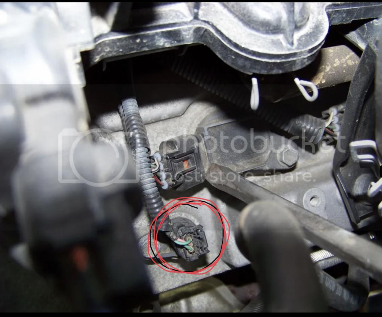

I also tore the wires out of the sensor that is on the valve cover just below the #4 cylinder. The wires to the coil pack and the sensor were taped together and of course I didn’t cut them apart. When I pulled the plug out of the coil pack I jerked the plug back and ripped those small wires clean out of the sensor. I don’t even know what the sensor is. Any help would be appreciated. I will have to buy a new wire harness for it I guess.

Here is a pic of the sensor I destroyed.
