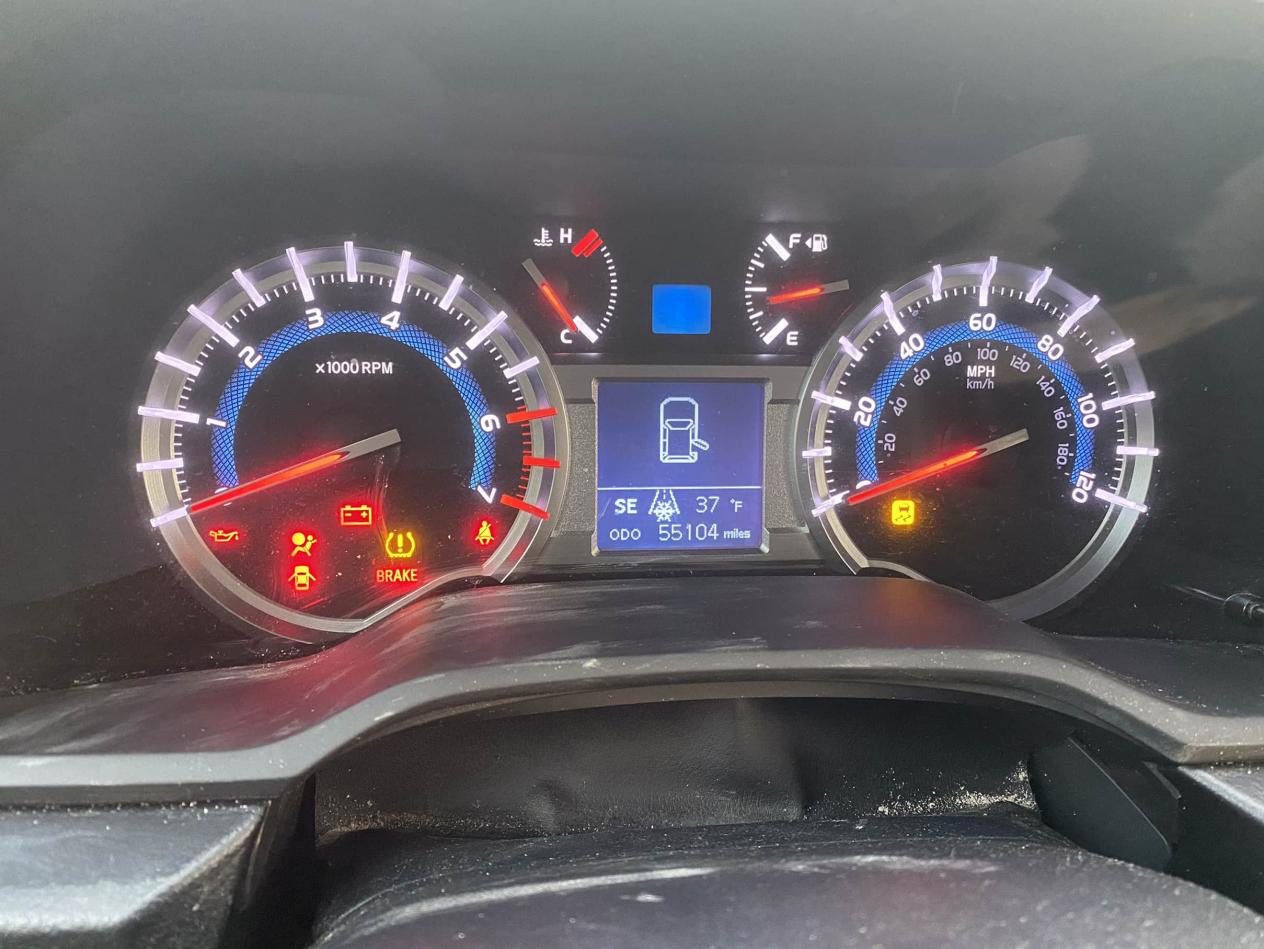

Just got the kick in the nuts again. The ECM that I ordered was damaged and Will be refunded. Thanks for the link and the lead, it just didn’t pan out this time. Currently I kicked the truck on and still no communication with ECM but now the transmission position indicator is blank again.

Any idea on the blank shift position window on my dash?
Thank you
Until you get the ECM back in the game and talking to the OBD-II port, it's not possible to diagnose. It's likely that the ECM monitors shifter position and reports this info to the gauge cluster, or that the fuse that powers the shifter position sensor is blown.
I only have wiring diagrams for 4th gen 4Runners, and didn't see any on the service manual linked above...but there are likely similarities and they're easy to check.
Pull the cover on your under-hood fuse panel and examine the IGN1 fuse (may be labeled IG1). On 4th gens this also powers the shifter position sensor. Also check the fuses labeled IGN, EFI, and GAUGE. By check, I mean remove and test for continuity with an Ohm meter. Let us know what you find.
I believe the transmission position indication comes from the switch on the passenger side of the transmission. It has been the subject of other threads because it is prone to corrosion. That position indication may be handled by one of the ECU's though. Just wanted to make the OP aware the switch could be a factor here.
[MENTION=147877]Carova Colton[/MENTION], I might be able chime in and help here if possible. I've played around with my 4Runner electronics more than most.
All information going to the instrument cluster occurs via the vehicle CAN bus or via a direct line. Shifter position, RPM, etc is all via the CAN bus, with the charge indicator (batt.) check engine light, and fuel gauge being direct line. The Instrument Cluster and the ECM are the two ECUs that act as the termination ends of the bus.
