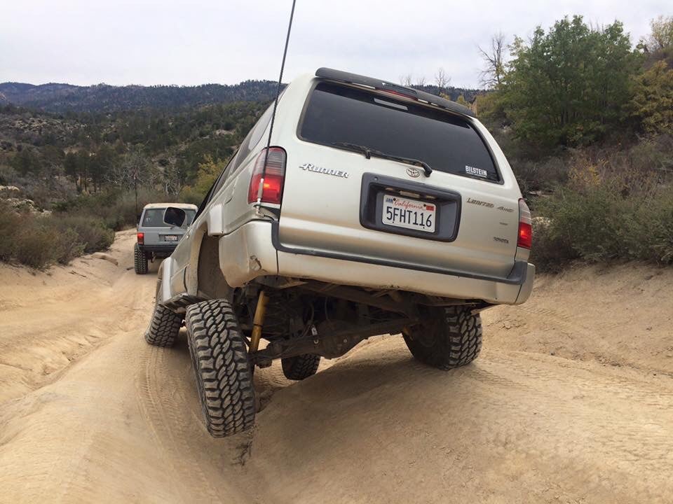

Never measured actual wheel travel with these since I only had them for 1 week, just to be able to go on an offroad trip but here is a picture of flex with them.
I mean you can easily mount them outside the frame. But ask them how much they extended their bump stops and how much travel they actually gained.
Axle bumps higher than factory, factory bumps removed and running SPC hydro rear bumps, 11" travel shock. Given the front only has 8.5, this is sufficient. A lot more to a suspension setup than what the tape measures.
