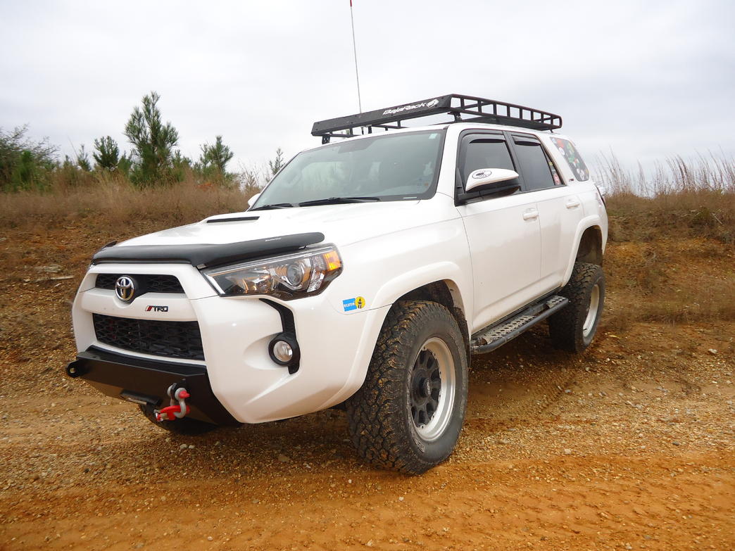

I love the BFG AT KO, but I have a problem with giving money to Michelin since they bought BFG (sometimes principle bite us in the butt). For roughly half the price you can get these. 60,000 mile tread life, very similar tread pattern, and very quiet on road. I have the light duty ones linked below and they have handled everything I have thrown at them so far. But they only list either the light duty or load range E in that size. No C rated that I can find. At least at Tirerack.
http://www.tirerack.com/tires/tires...ite Letters&partnum=67SR7GRAT2OWLV3&tab=Sizes
