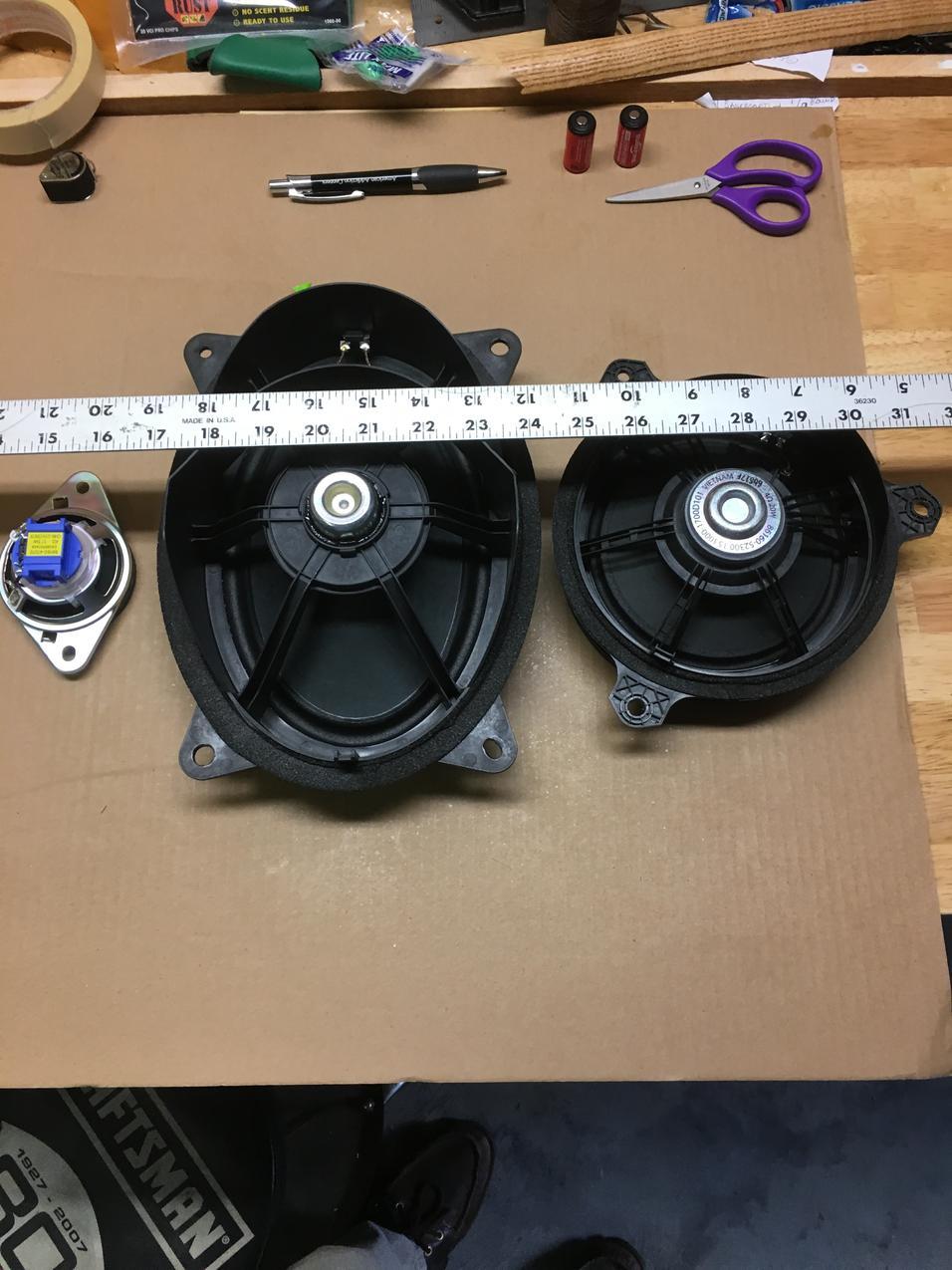

Just installed these speakers today...mainly a plug n play install for me...about 1 1/2 hours at a slow pace.
I chose to use a Dremel cutoff wheel to nip off a small section of the original brackets where the new brackets interfered a bit...simple. I also chose to leave the panels hanging on the door and work behind it. A bit harder to remove/install the speakers, but didn’t have to remove the window and door lock cables.
They were substantially heavier than the stock speakers...hope they are worth the cost.
Toyota should be embarrassed about using these cheap lightweight speakers. And they sounded worse than they look. My refrigerator magnets are bigger and I got them for free.

Let us know your impressions once you've listened to them.

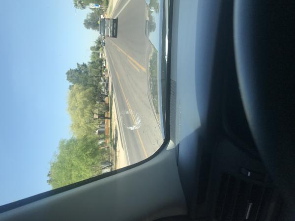

My only issue with the Focals...
The reflection of the tweeter brackets drives me nuts, especially when driving at night and it gets reflected every time I drive past a street light. Happens on both sides.
I know the fix is to paint/wrap them...Ive just been too busy to get to it.
...and for the life of me I cant figure out why some pics get rotated?
