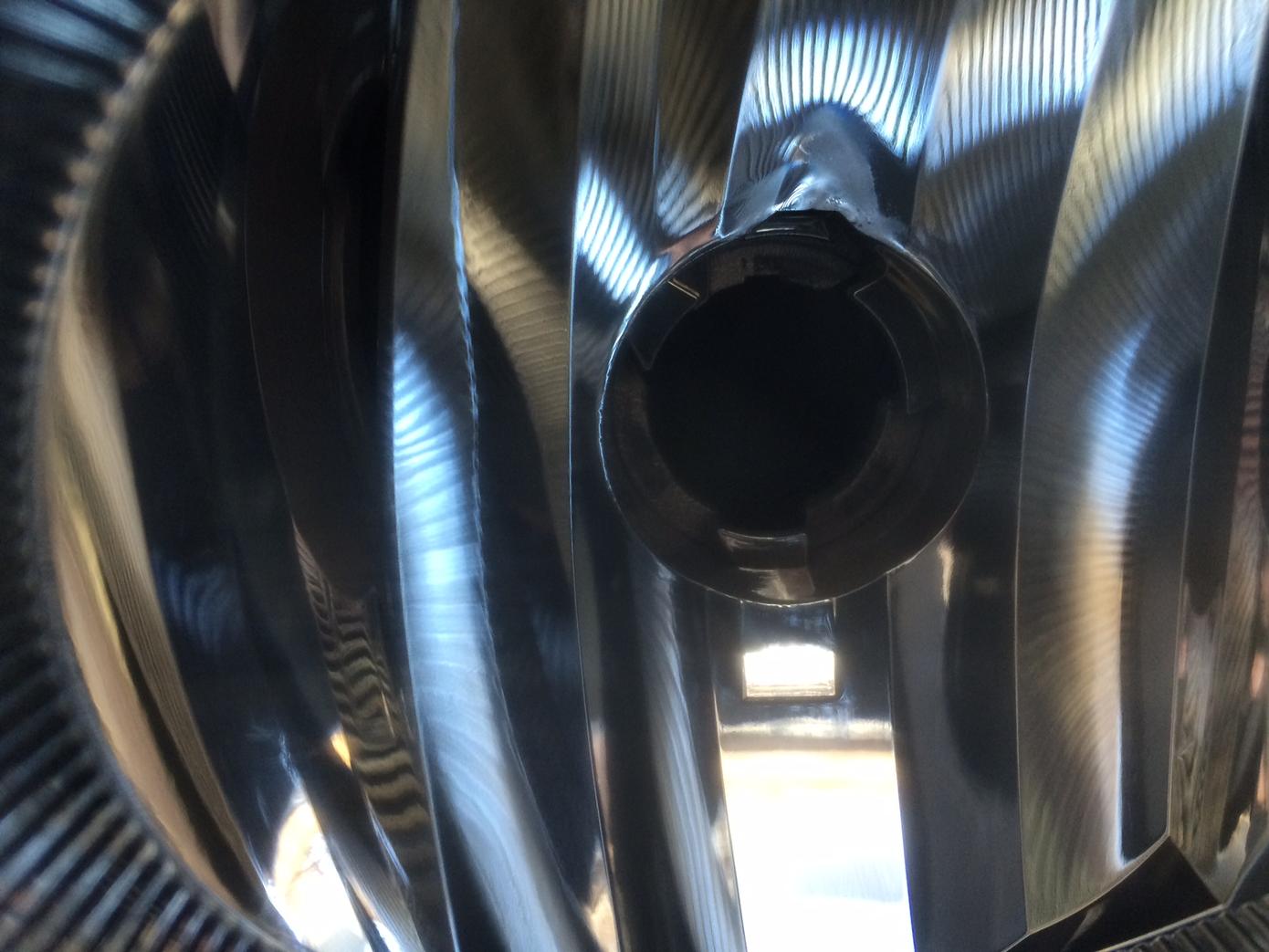

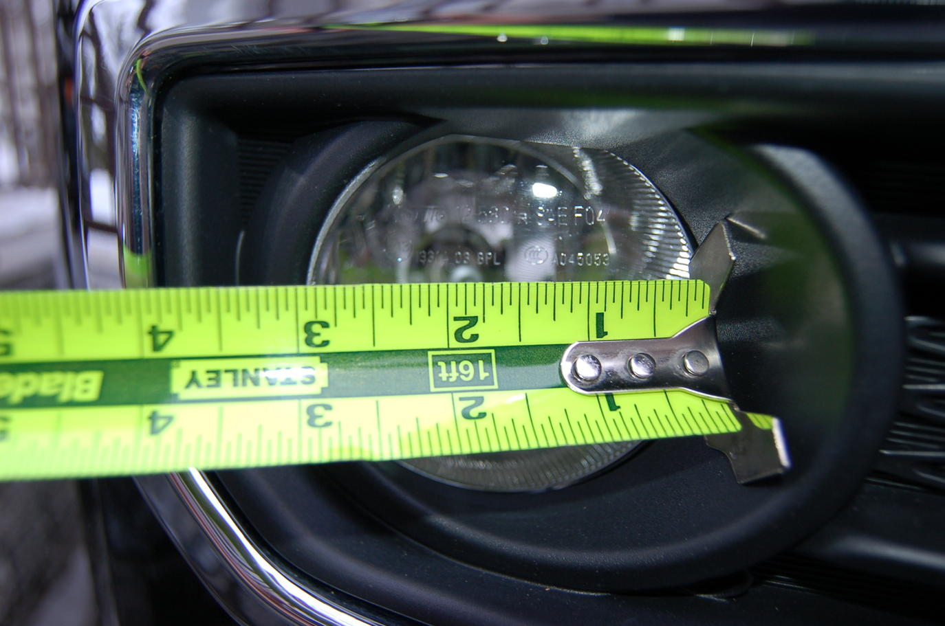

Could you take measurements of the diameter and approximate depth of the fog lamp reflector bowl? I'll do the same and we can compare...because the 2010-2013 fog lamps are factory 55w H11s, and I would imagine that they are likely made of similar material. My thinking is, if there's enough of an "air cavity" (I dunno what to call it, lol) in the 2014 fog lamps, then it can probably handle about the same amount of heat as the 2010-2013 housings? This is all speculative of course because I've not the faintest clue about material science :)
Why not just be daring and try it out on one fog lamp to see if you melt anything? It'll be cheaper to replace just one, lol.
Will do. I suspect they are the same. Will measure, post pic tonight.
I just measured it, it's ~3" diameter and I eyeballed the depth...my best guess is it's approximately 3"-3.5" deep (the tip of the bulb looks to be about 2" away from the glass lens). Hope that helps!
Same: 3-inch diameter and about 2.5-inch depth.

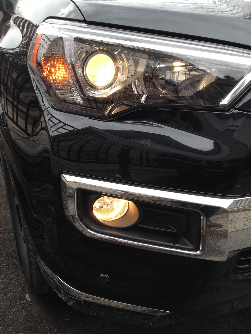

I've been running them for about a week (H11 55w yellow hella lights) and no sign of melting or any type of heat damage. I must say though, these suckers are BRIGHT!

Installed 55W H11 in to the fogs where 19W H16 were. Does appear to be noticeably brighter, but fog lens is also hot to the touch, so not sure if this is a good fit.
[MENTION=85512]eddiebx[/MENTION] any idea what temperature difference there would be from 19W to 55? Are your lenses hot to the touch?

The fog housings in the 14s are the same as the 2010-13s, which also run 55w, so in theory they should be the same. I checked the lens temp in a 2012 Limited that belongs to a friend, and his were just as hot as mine — at least to the touch. I haven't had any problems yet, but I've also used the fogs more sparingly, perhaps in an abundance of caution because I still worry they might be too hot. Definitely waaaay more light spread out low - in effect making them a better fog light.

Thought I'd update this after a year with my H11s in the fog housings.
While the housings in Gen 5.5 are the same size as Gen 5., the bulb changed in 2014 from a 55W to an H16 with 19W, obviously producing less heat (and less light).
So with the same housing, and 2010-2013 models running 55W and same wiring, no problem right? Not quite. Heat is an issue, as evidenced from my housings that have a slight sunburn from the H11 bulbs.
I've since swapped the H11s out for JDM Astar (1200 lumen) LEDs, which are stone cold and give off decent enough light. Not sure I like them, but figured they're better than the H11s for now.
