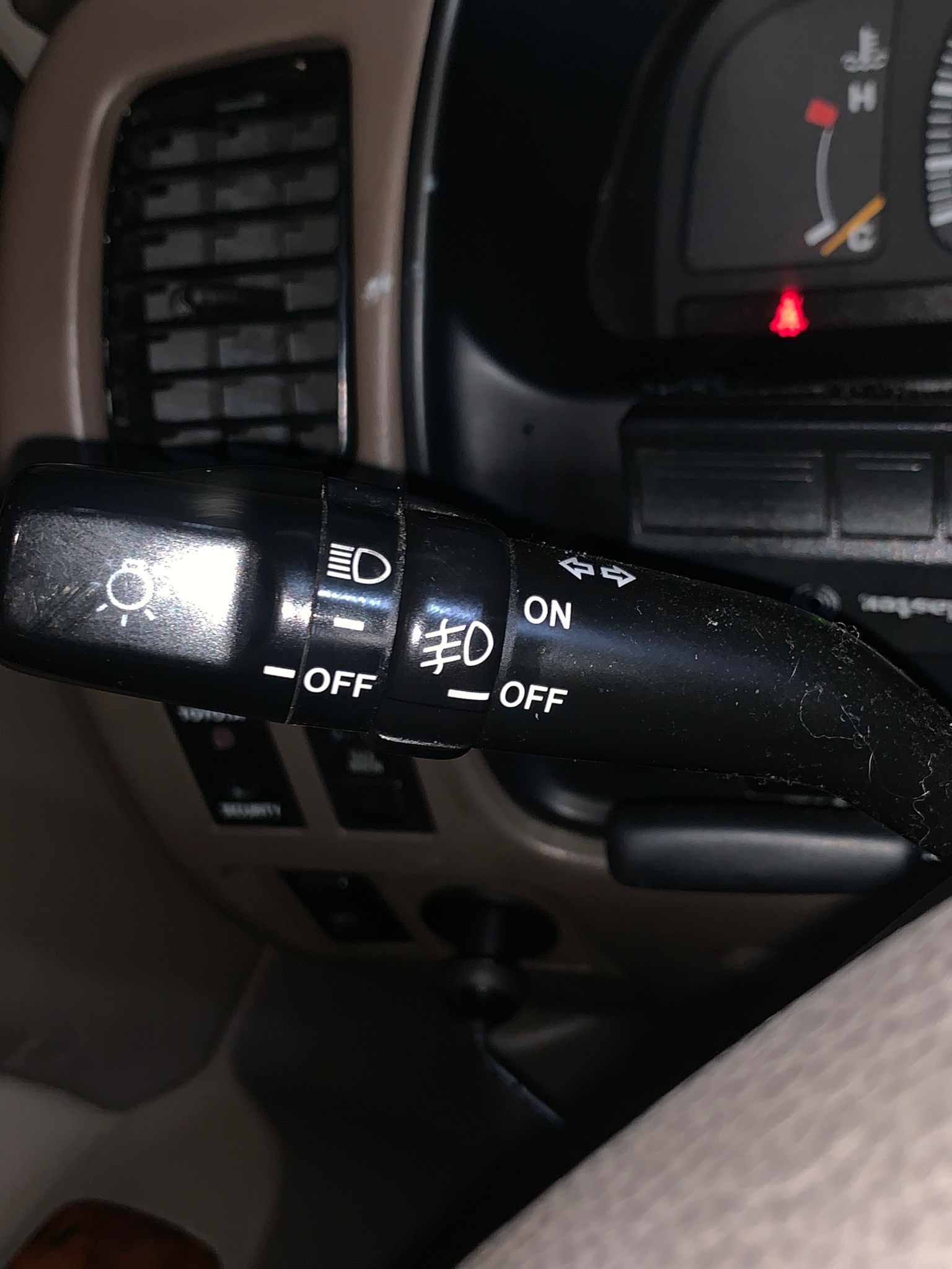

I want to use the OEM '99+ turn signal stalk(with fog dial) on my '97. I've seen/read that it's an easy upgrade on the non-fog '99+, and all you have to do is add the stalk and relay. I know this isn't the case with the pre-'99, but was wondering if any of you have done this, and what's involved.

I'm interested in this as well. Would be very nice to have fog lights. I checked before and found that the '96-98 and '99+ fog/turn signal stalks are different sizes, would require some modification to make it fit. Or you could just swap a 99+ fat lip bumper with fogs

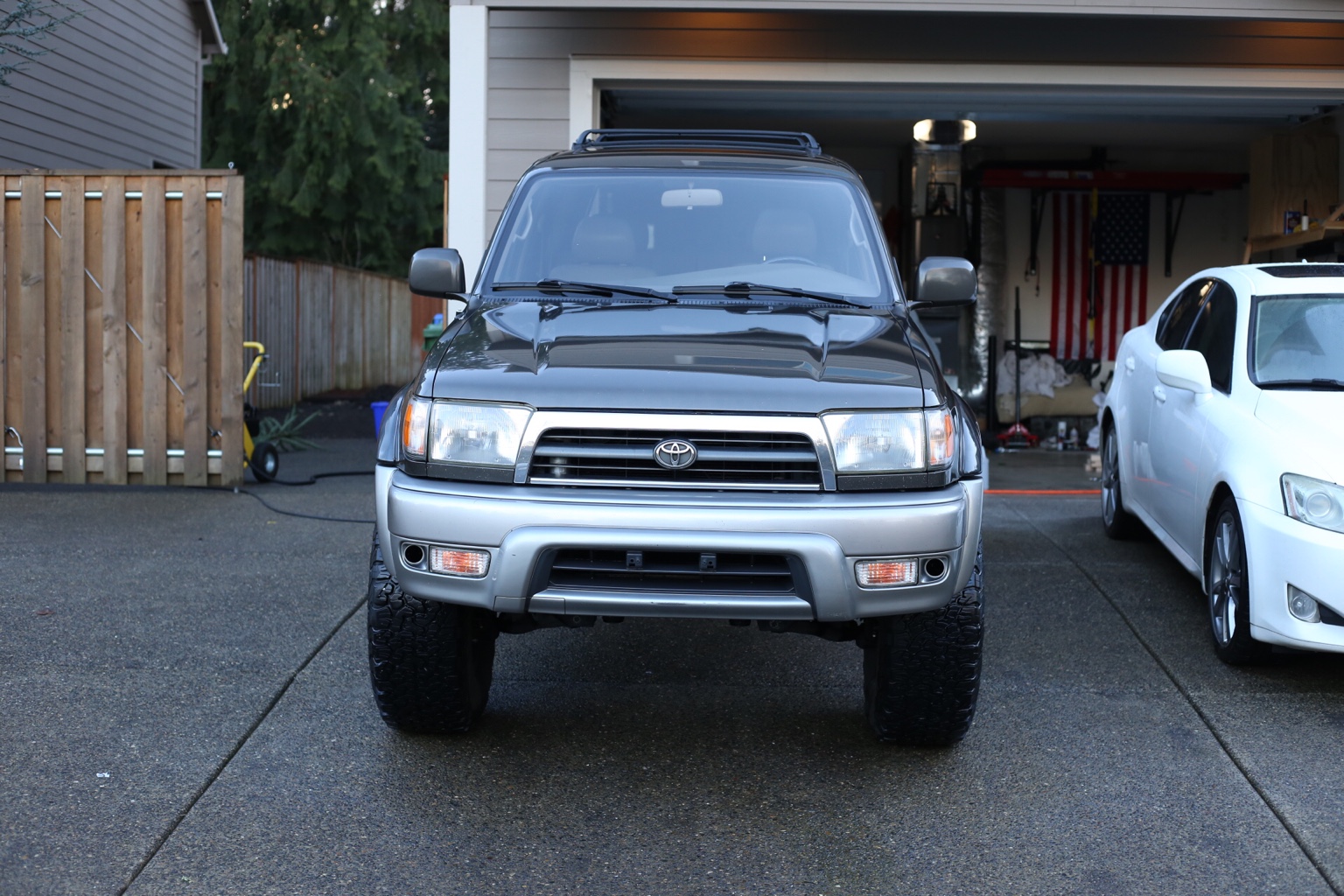

Wait a second, i interpreted that totally wrong. My bad[emoji23]. I thought you meant you were gonna try and retrofit the entire fog light+fixture from 99+ into a '96-98 bumper. Cause in that first pic you posted it looked like you had the stock 96-98 bumper.
Regardless of bumper/fog light setup; I'm just asking about making the '99-02 signal stalk- with fog dial- function in a '96-98.

I did it into my 97. Super easy, all you have to do is to insert two wire pins into the existing wire plug and use those two wires to turn on the relay. I should have the thread somewhere. Let me find it.

Super easy. It will bolt right on. I did this to my 97, and avalon etc.in the same period, has the same switch. You have to insert two wire clips into your existing wire plug (have room in your wire plug) and pull wires to activate the relay. I did this so long ago and there should be a thread on t4r.
When you get fog light stalk switch, make sure to get 2 wire pins out of donor vehicle.
