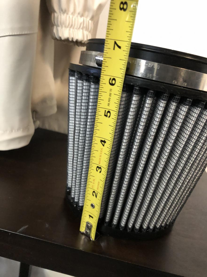

After the eBay sequoia 4” intake fail, got the AFE full intake with the pro dry S filter. Sent dimensions to outerwears to send me a hydrophobic prefilter.

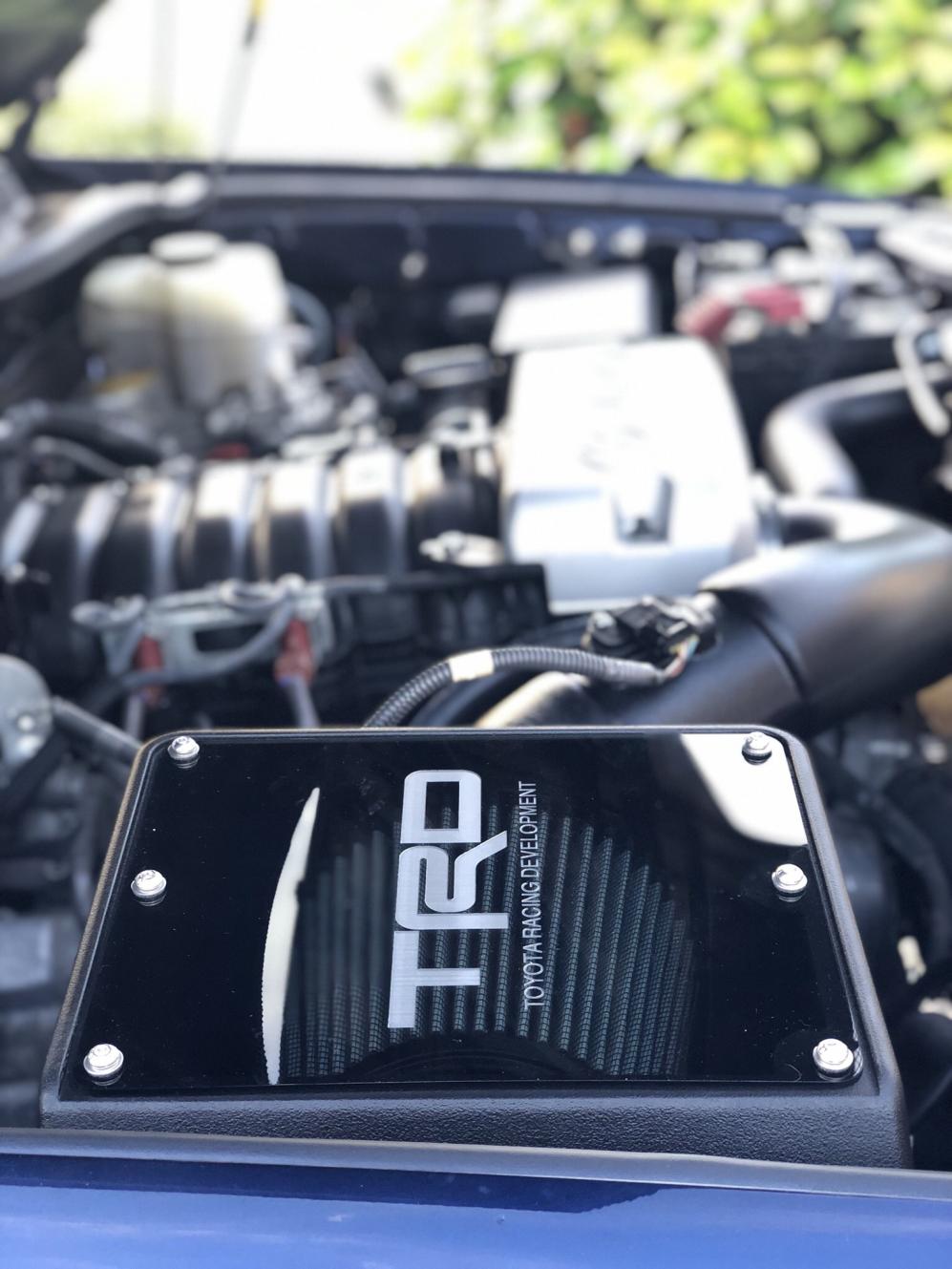

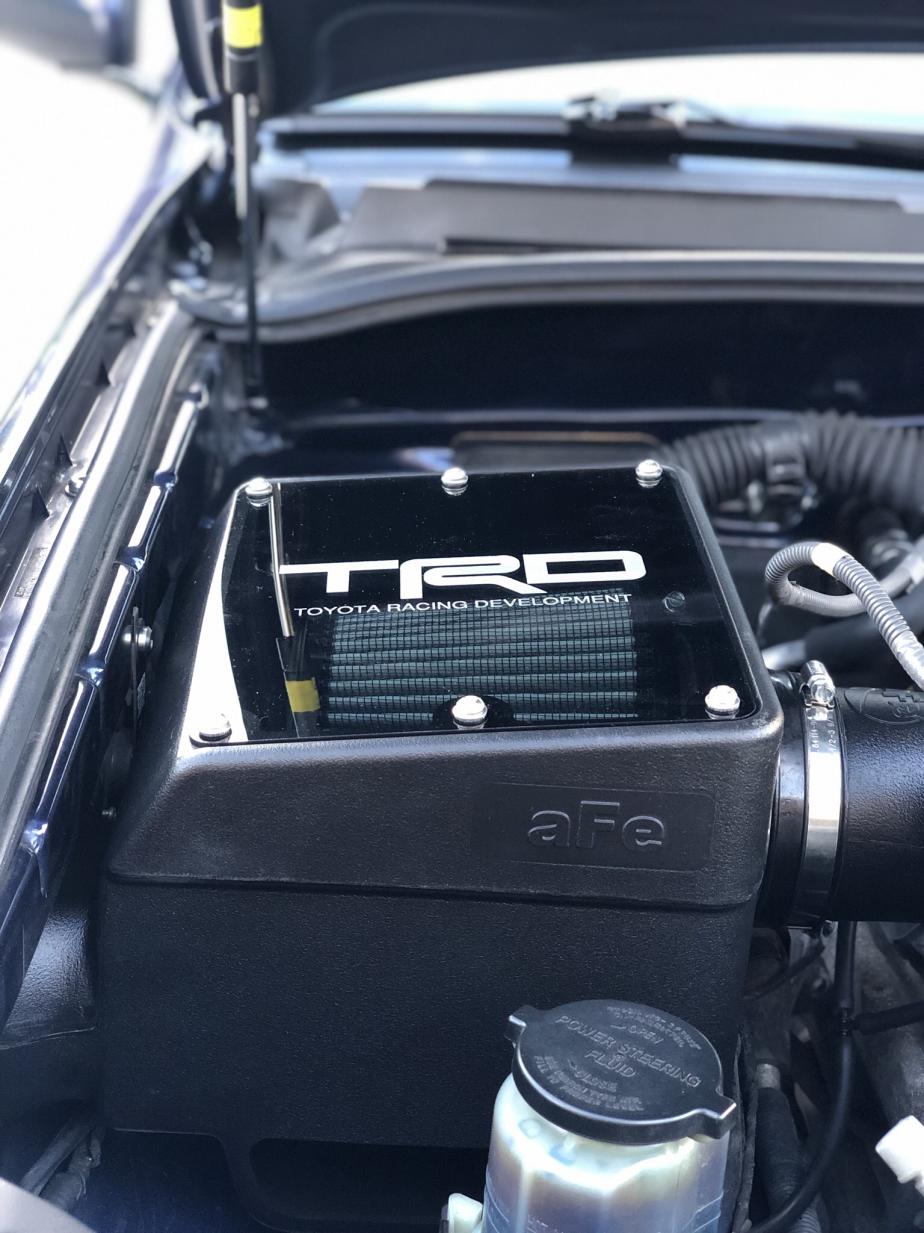

AFE used to make the TRD intake for the 4.0L. They make one for the 4.7L. Noticeable growl at partial and WOT due to removing the silencers. The V8 now sounds wicked with the URD exhaust and this AFE intake. Maybe 10 hp difference. Quality is excellent. Everything bolts up as it should and unlike the eBay intake, no CEL.
I found a gentleman that makes custom acrylic covers for this intake. His SN is Coupe on tacomaworld. Spruces up the engine bay for the time being and allows me to keep an eye on the filter.
Outerwears hydrophobic prefilter is also in the mail. I run these on the GTR. Very effective at keeping the original filters clean.
