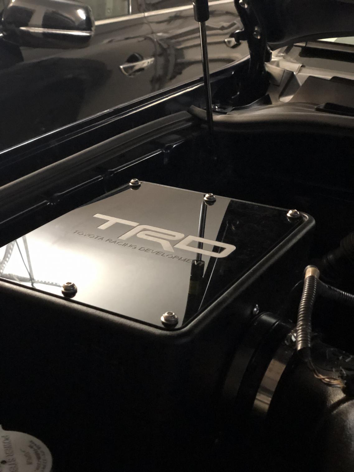

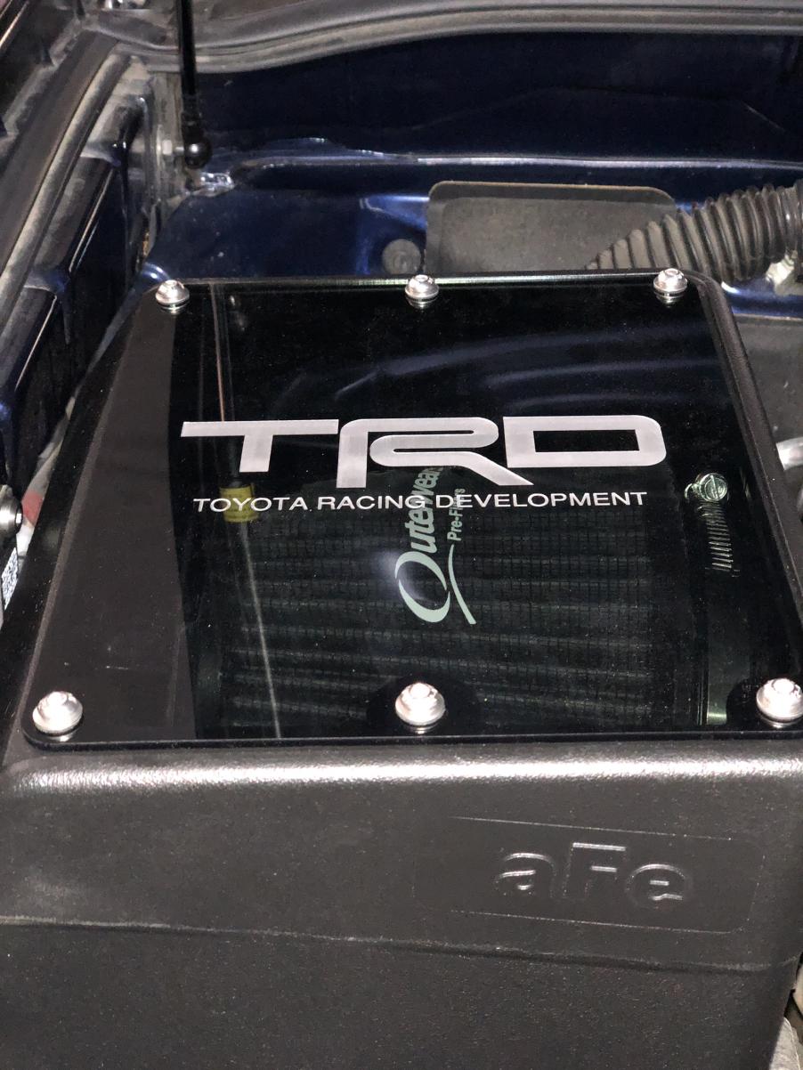

Aww man... I wish I saw this earlier. There is an additional hidden screw if you look from underneath that holds a retaining clip in place. Need to unbolt all the 10 mm nuts AND unscrew the retaining clip, (one small hole, middle of scoop, easy to miss).
Ok, so I got the scoop plate in the mail. Now i'm having problems removing the scoop itself from the hood! I un-screwed the 5 nuts underneath the hood and nothing is budging. Any ideas before I brake apart the whole hood? I thought it was a gonna be a simple swap.
Edit: Guess i'll be getting a new hood scoop insert as I have essentially cracked it trying to get the old back plastic plate out.
LOL, I saw the additional screw once I pried out the scoop insert. I was like "SOB!". Once I got the scoop insert out...finally...there is a plastic back plate that is some how help my 3 plastic screw like inserts that I could not get out. I just gave up lol.

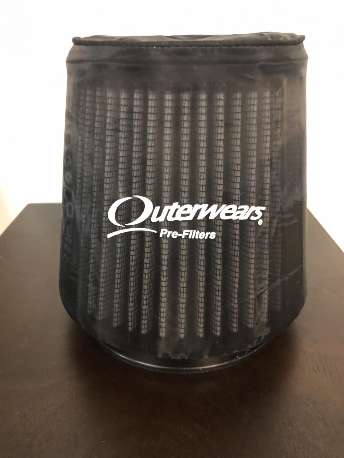

Outerwears hydrophobic prefilter is on. This thing is an exact fit. Very snug.
Water beads off these prefilters. Makes cleaning a breeze. Also zero reduction in flow. Dyno’d the GTR with these on and it put down 1124 AWHP on a conservative tune. Since then bigger turbos and billet crank were thrown on. Expecting 1400 AWHP conservative, 1700 AWHP on kill.
Nice! I just got a Outerwears hydrophobic prefilter for my filter as well!
Thanks! The main point being these outerwear prefilters don’t really affect flow. If they did I wouldn’t run them on the bigger power cars. They resist water very well, which I think is important in rain soaked Seattle.
