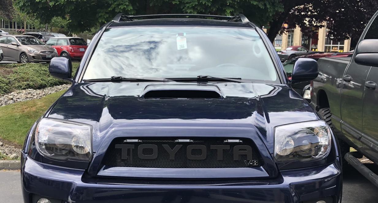

Formidable 2008 V8 Nautical Blue Metallic Limited Edition URD Build

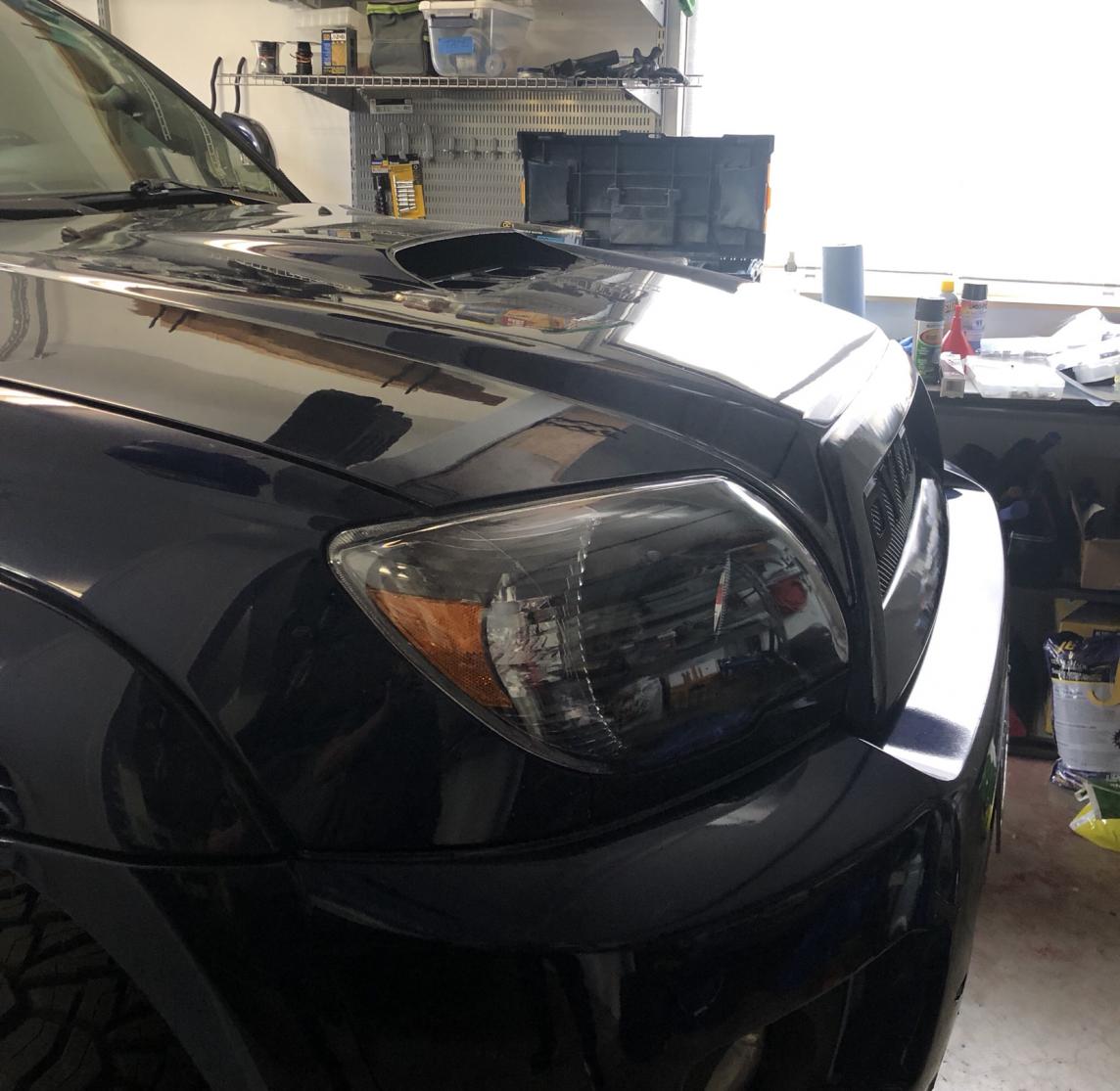

Sport hood is on. One grille bolt doesn’t line up. No biggie, will widen the hole. Otherwise fitment is pretty good. Need to align the hood left to right a bit, but overall pleased. Brand is “platinum auto parts”
Good find! Definitely trial fit it before painting, just in case.
Looks great. Did you have to buy the plastic scoop pieces, or were they included when you bought it? I was just looking at a CAPA certified new one last night, but it doesn’t come with those parts.
Thx! I lucked out I guess. Even the body shop asked to test fit prior to paint. I told them I rattle canned the front grille... Main thing is the hood is blue. Ha!
Purchased the scoop insert separately. Paid more for the insert and the hood scoop grille than I paid for the hood.
Yeah, that’s what I was worried about when buying an aftermarket hood. I found some at wrecking yards through an online search, but trying to find a black one that doesn’t need repairs, or paint is close to impossible. The good thing is that at least they are complete with all that scoop hardware, and hood insulation. If it has to be painted either way, I may be better off going with a used OEM one.

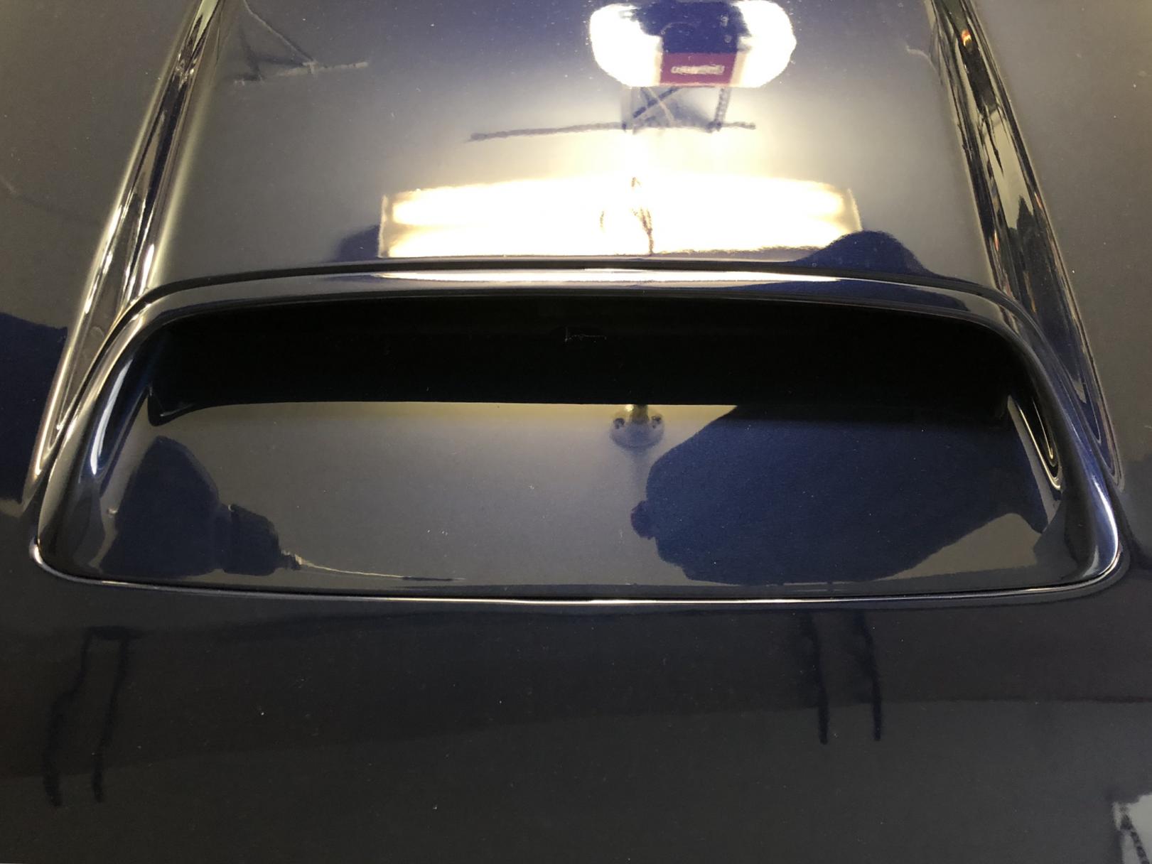

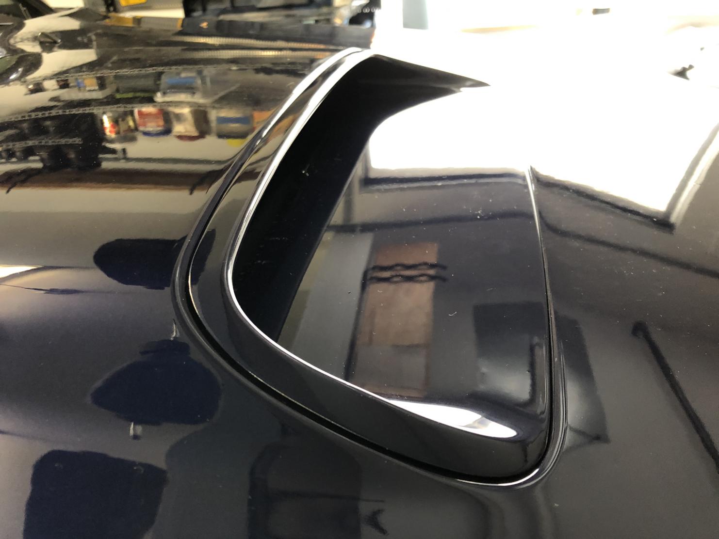

Scoop insert color matched and fit like a glove. Impressed with the quality of this hood. Left the OEM plastic insert out. Deciding on satoshi type grille mod or C4 lighting bracket. I think the C4 might come with its own grille but need to verify.

i did not receive any grille with my c4 fab hood scoop light bracket just so you know. Awesome build you got. :thumb3:
Ah... Well there it is! When I ordered the insert it came with the air guide. Apparently there is an OEM hood scoop grille I need to order. Can’t find the part number though
From what I see online I think what you need...the grille..is called a scoop plate..but I could be wrong, couldn't find any actual photos of it only the cartoon images Toyota seems to think is just as good, say you have the "air guide" not sure if that the same "scoop guide" it seems the "scoop plate" inserts into.
The part number for the scoop guide is 76182-35060, not sure if that's the same part number for the air guide you have.
Just an FYI, it seems that the hood scoop and related parts are the same on the T4R and the Tacoma since they both use the same part numbers, with the exception of the last 2 digits which are the color code part of the part number.

Thanks! I think you’re right. Based on the exploded view it’s got to be the “plate.” Very helpful!
