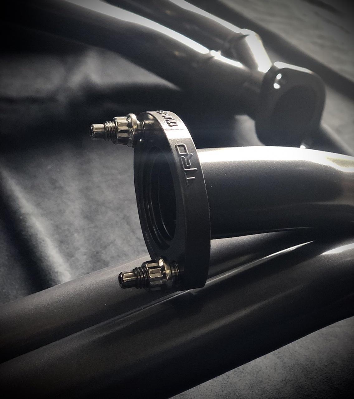

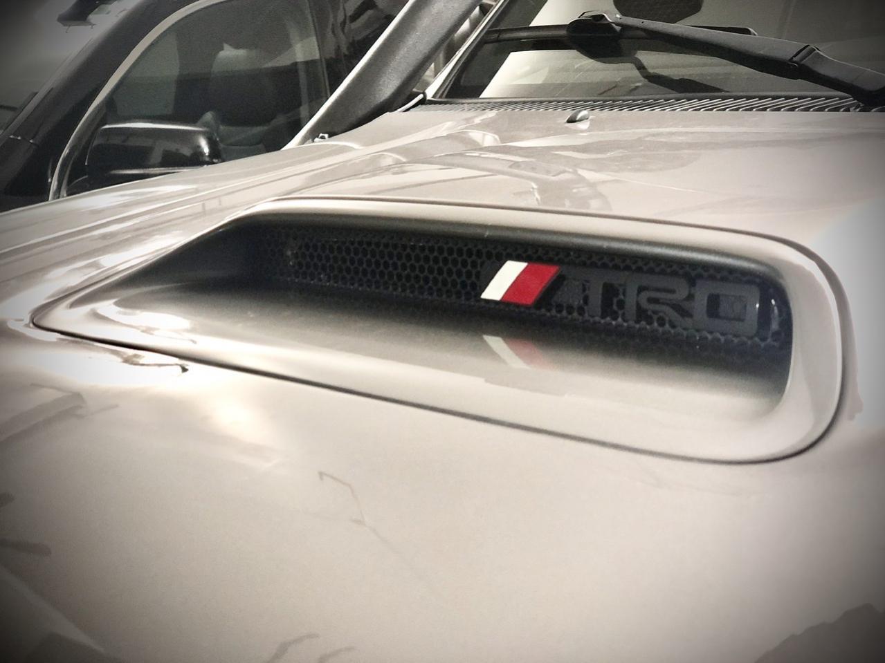

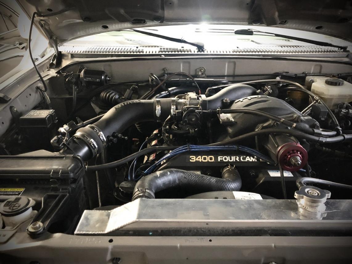

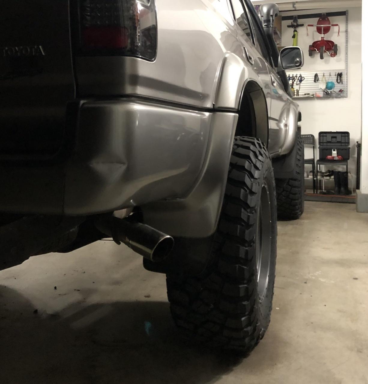

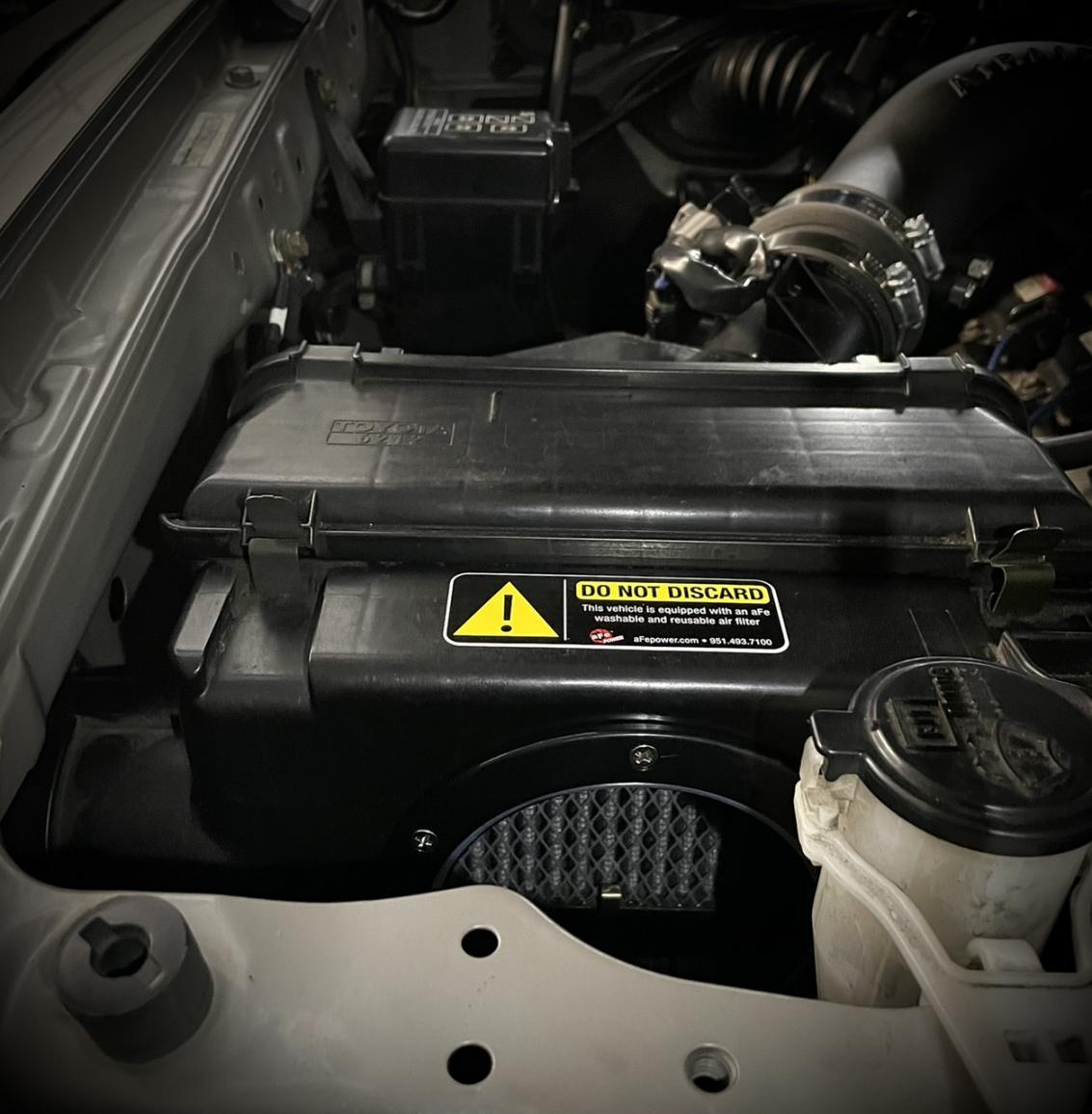

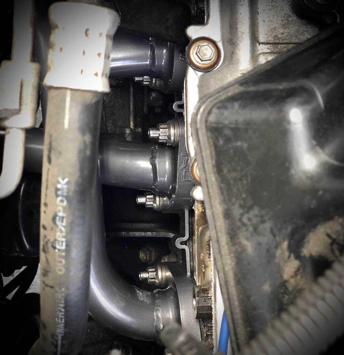

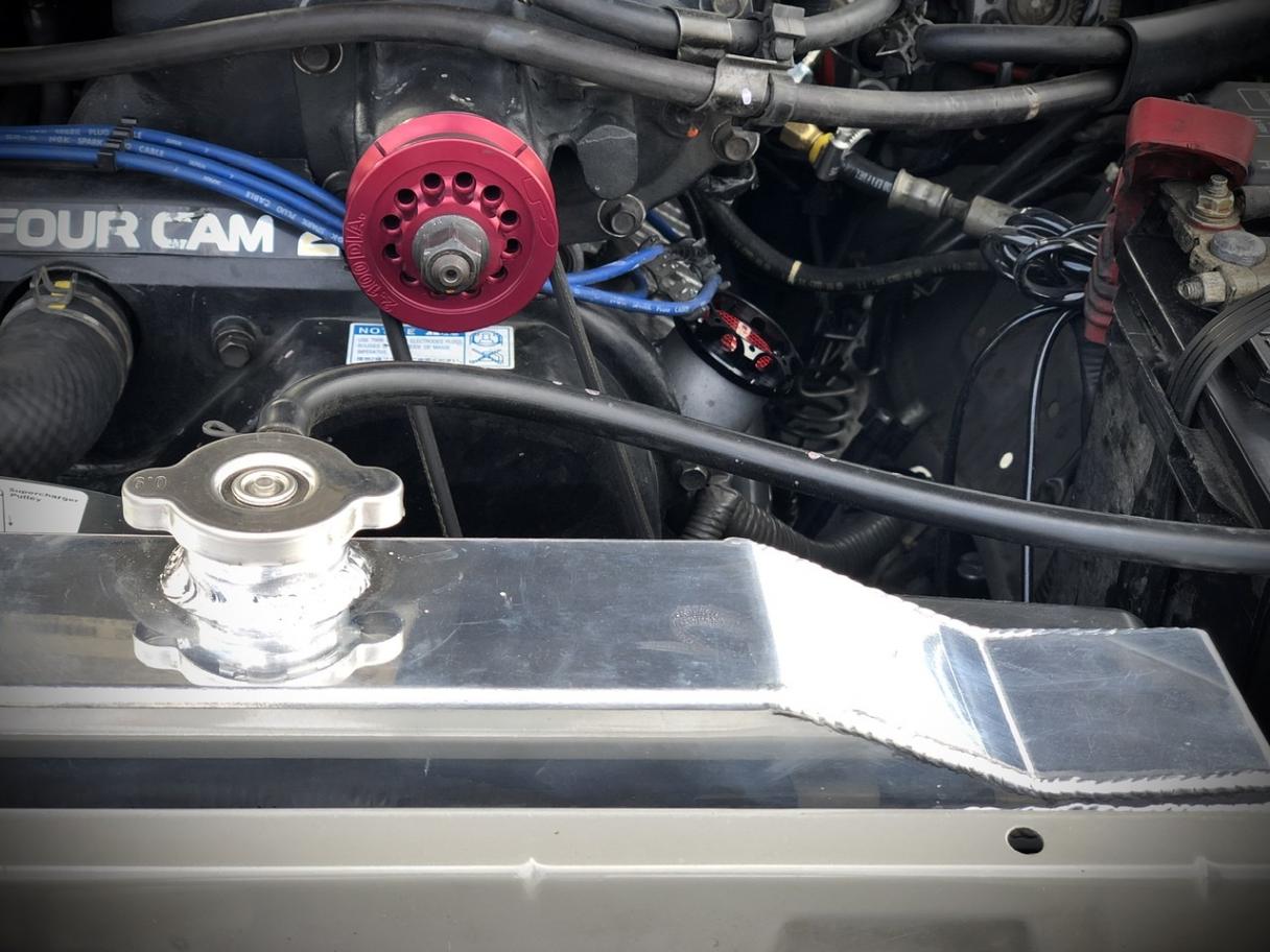

Performance:

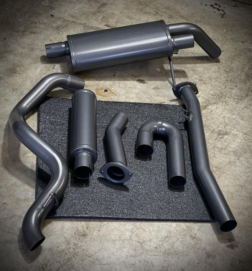

The 3.4L is anemic... period. The TRD supercharger makes this truck drive like a normal car. The smaller pulley, URD 7th injector, crank pulley, and TRD headers help to address the negative impact that heavier wheels, tires and armor have on this truck’s performance. This 4runner will never be a race car... BUT... it can be made to perform like a normal modern day vehicle while retaining its off-road capabilities.
-TRD supercharger
-URD 2.2” pulley
-URD AIC
-TRD headers ceramic coated
-ARP stainless studs PN# 400-8027 and 400-8007
-Magnaflow Overland exhaust ceramic coated
-AFE intake filter
-Deck plate mod
-Airaid modular intake resonator delete
-Champion radiator

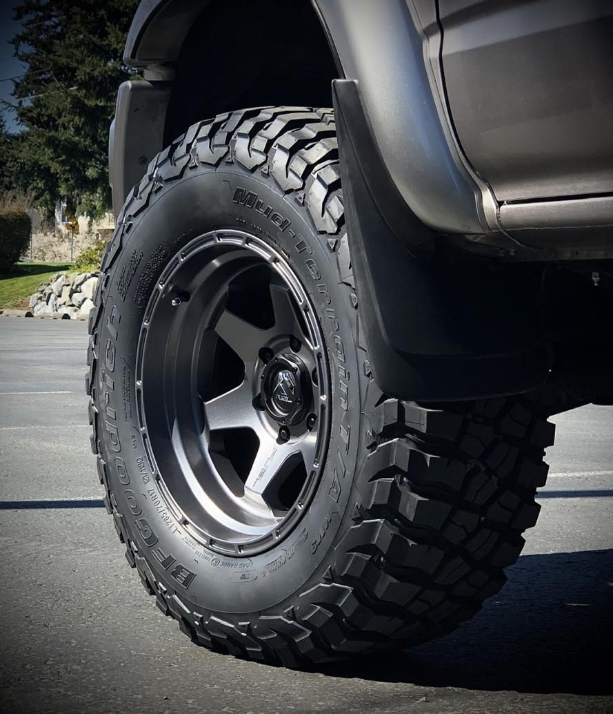

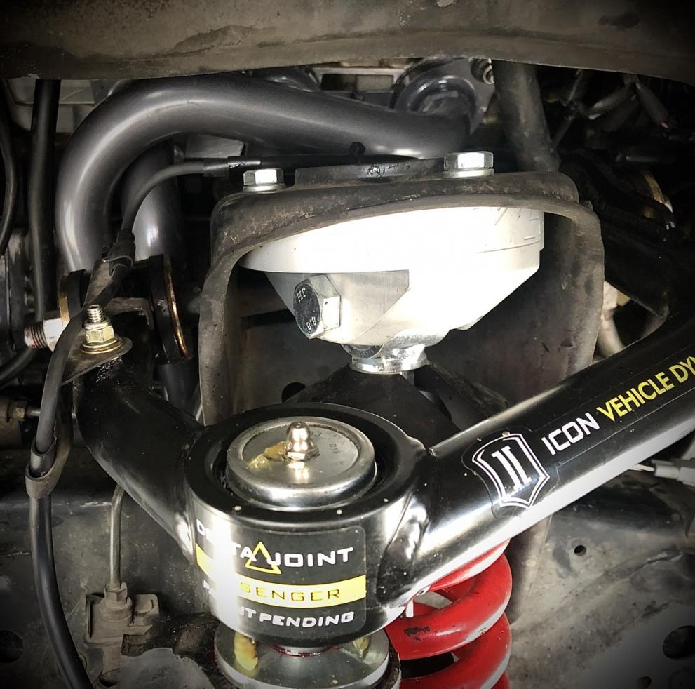

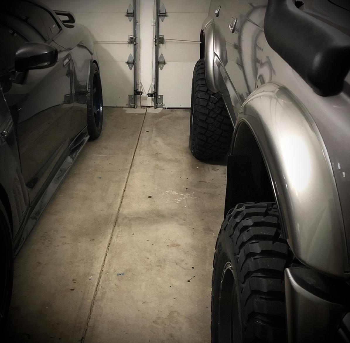

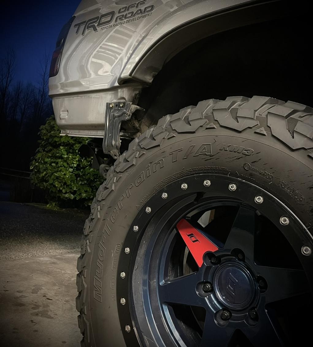

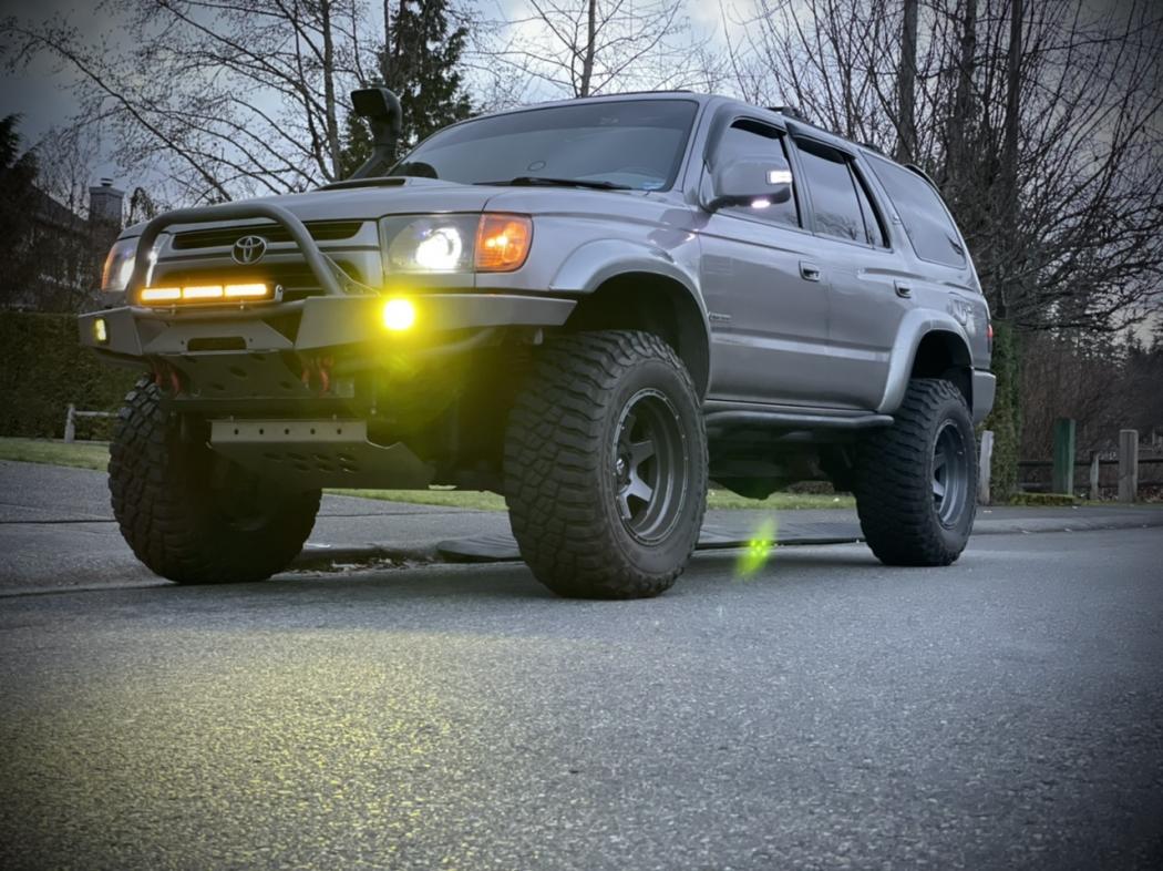

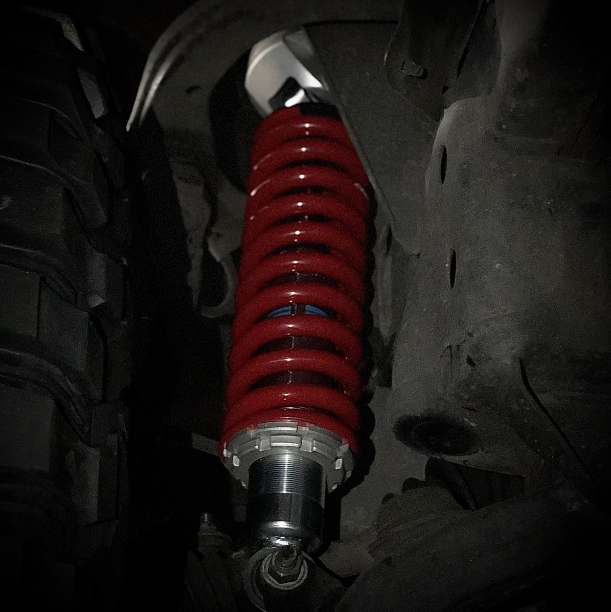

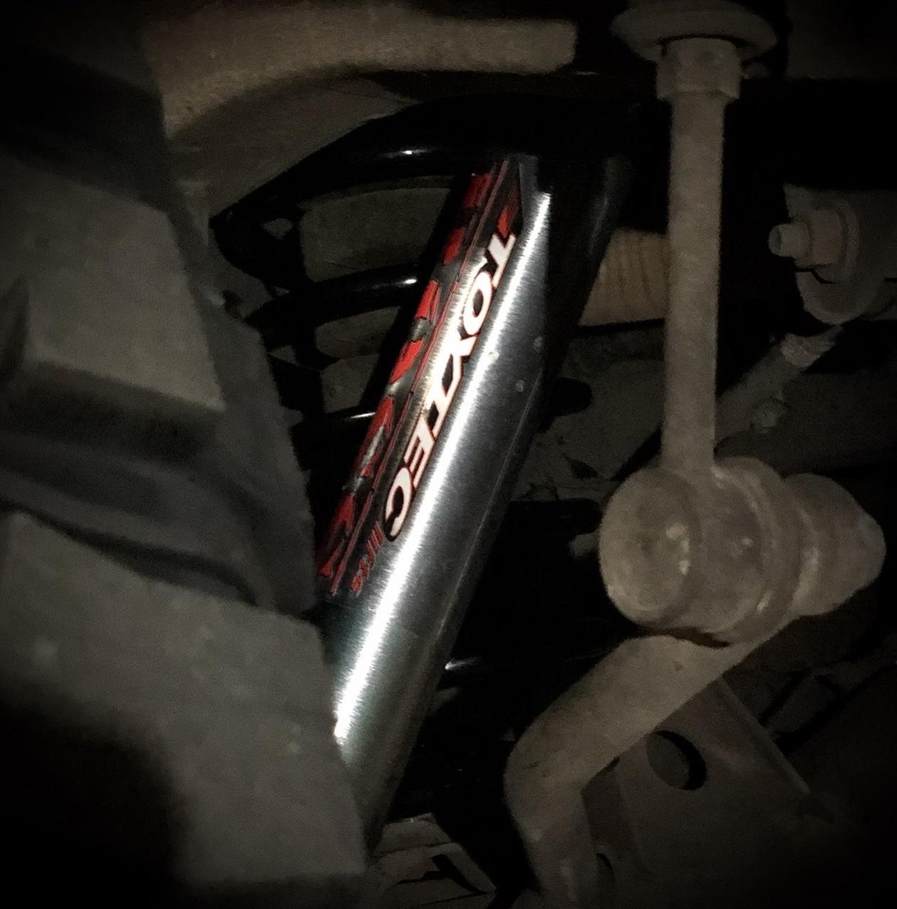

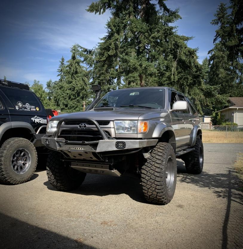

Suspension, Wheels & Tires
Suspension: I had Toytec adjustable coilovers on my prior 3rd and 4th gens. One thing to keep in mind... Their 650 lb springs are a must. For weight and also for ride. The 4runner has more rolls in the corners than Costco has in the bakery section. The 650 lb springs help to reduce the body roll and I love the stiffer ride. Huge improvement. The Toytec 1” body lift allows me to run 33” tires with zero rub on the front mud flaps and minimal rub on the fender extensions, (addressed with trimming 1 cm off the infero-medial aspect of the portion of the bumper extending into the fender). Highly recommended. UCA’s are a must to dial in alignment following the lift and also to eliminate the contact the stock arms have with the coilovers during full articulation. If you’ve had aftermarket UCA’s in the past you know how much of a pain they are when dirt, grime and corrosion start eating away at the ball joint. Icon’s delta joint are sealed. I ran them on my prior trucks with zero issues. Highly recommended.
Wheels: I am OCD or CDO in alphabetical order. I can’t stand five spoke wheels on six lug trucks... Five spoke wheels make the truck look off balance when the lugs don’t line up with the spokes. I also can’t stand people that purchase custom wheels only to run spacers to get that aggressive look... This defeats the entire purpose of getting custom wheels. Get the right offset the first time around. Volk TE37’s are some of the nicest six spoke wheels out for this truck. Problem is their conservative offset. With Fuel Shok, I get the balanced look of six spoke wheels, the modern concave look of the TE37’s, the step lip of the TE37X, an outstanding anthracite finish, an aggressive AF offset, ALL for an affordable price. Obviously very impressed with these. Ran them on my 4th gen in 18x9 offset -12. Going significantly more aggressive on this application.
Update: Fuel Shoks replaced with the following:
SCS BR6
Stealth Blue finish all around
Matte gunmetal finish for the spare
17x9” offset -38
Tires: I have run BFG KO2’s, Toyo open country AT, Nitto Terra, Ridge, and Trail Grapplers in the past. All of these are great choices. I wanted to try something different with the KM3’s based on a friend’s recommendation. These have more road noise than the Trail Grapplers. They are also notoriously difficult to balance. One tire is presently being sent back on warranty for being out of round. On the positive side, they look phenomenal... Will see how they perform in the mud but based on the above, I can’t recommend these.
Installed:
-Toytec 1” body lift
-Toytec 3” coilovers with 650 lb springs
-Toytec differential drop kit
-Icon Delta Joint UCA’s
-17x10” offset -18 Fuel Shok Anthracite
-285/70/17 BFG KM3

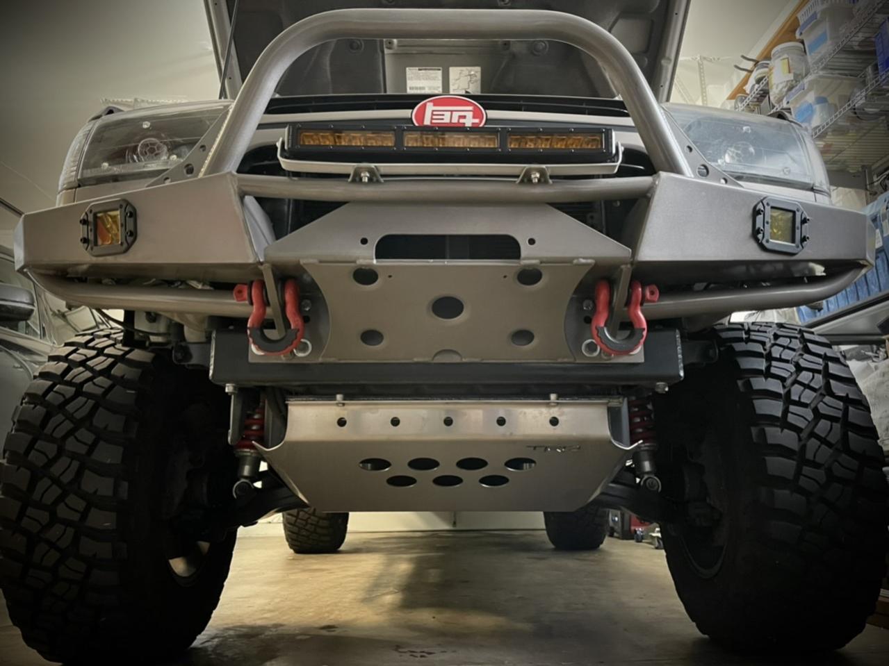

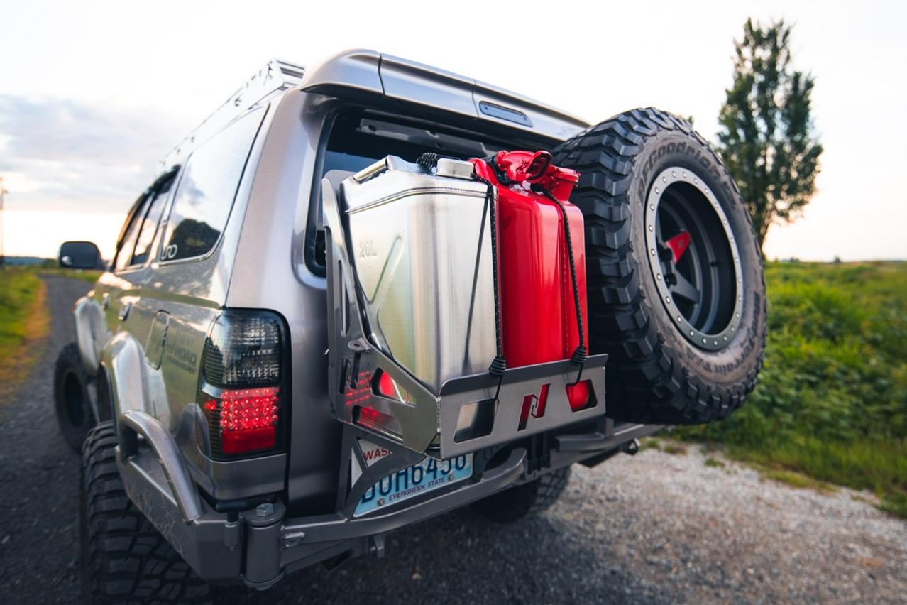

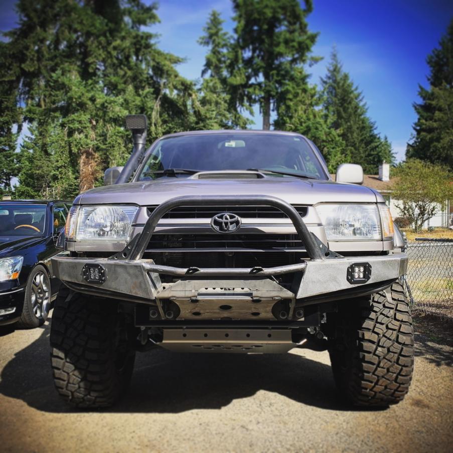

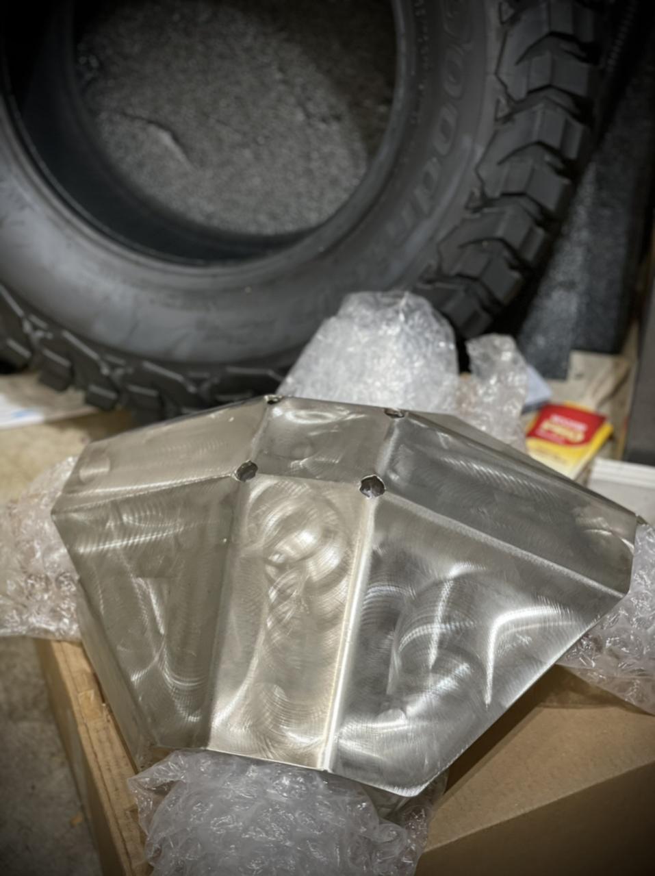

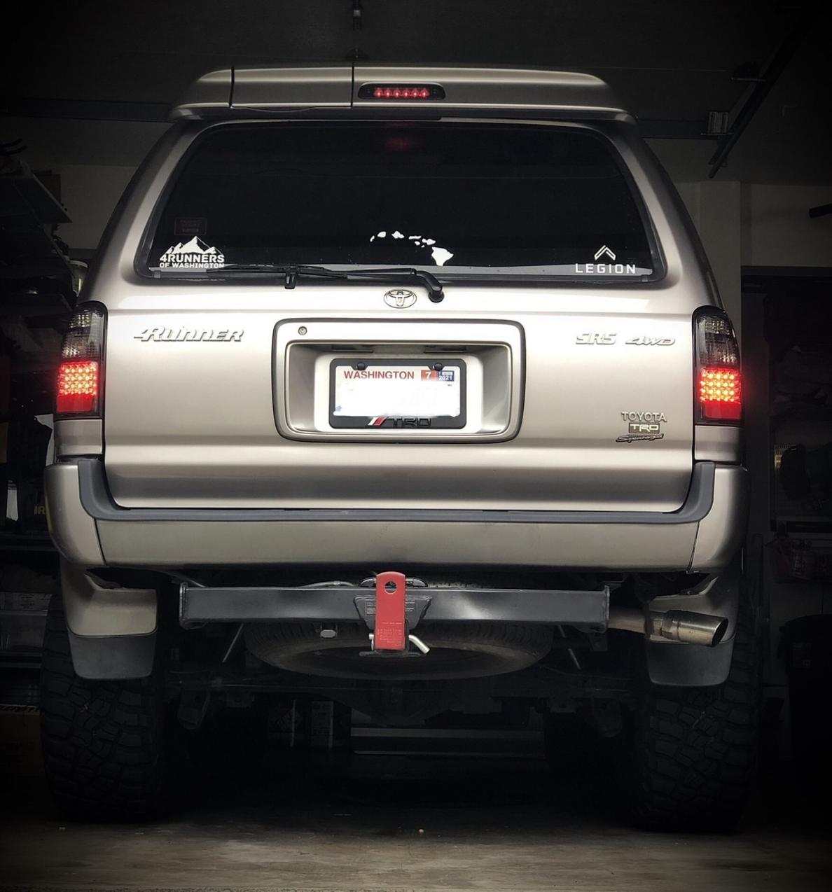

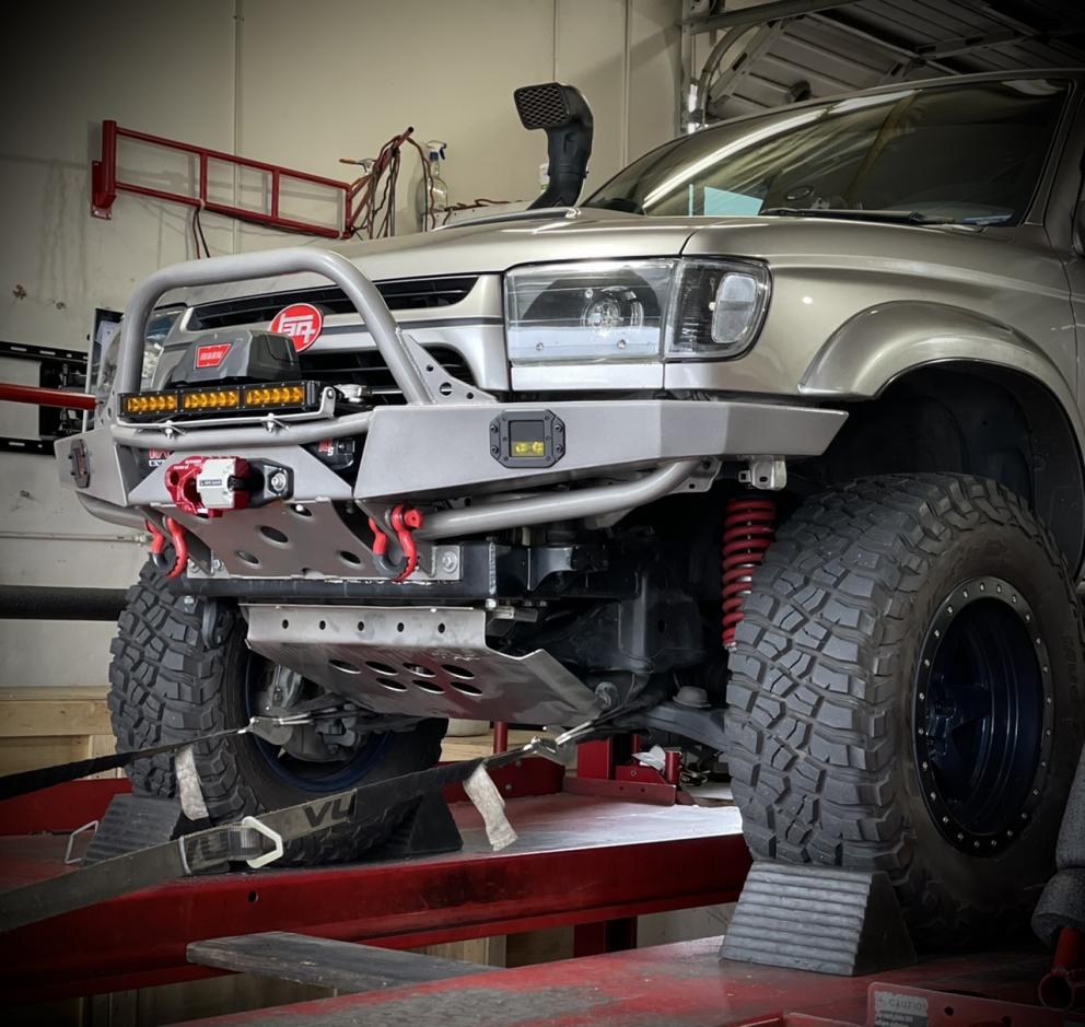

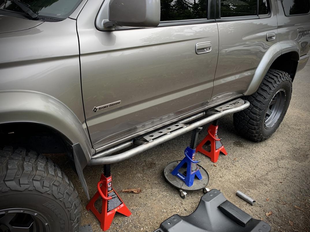

Armor
-Custom stainless skid from member 22RETHAN
-4xinnovations sliders
-Addicted off-road plate bumper color matched
-Nguyen Works dual swingout rear bumper color matched
-Bud Built stainless rear diff skid
-Shrockworks trans, transfer case, gas tank skids

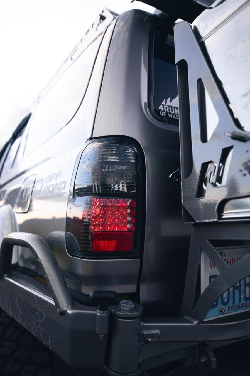

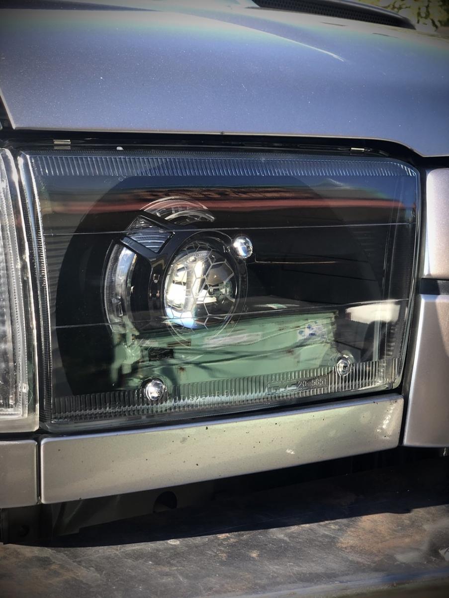

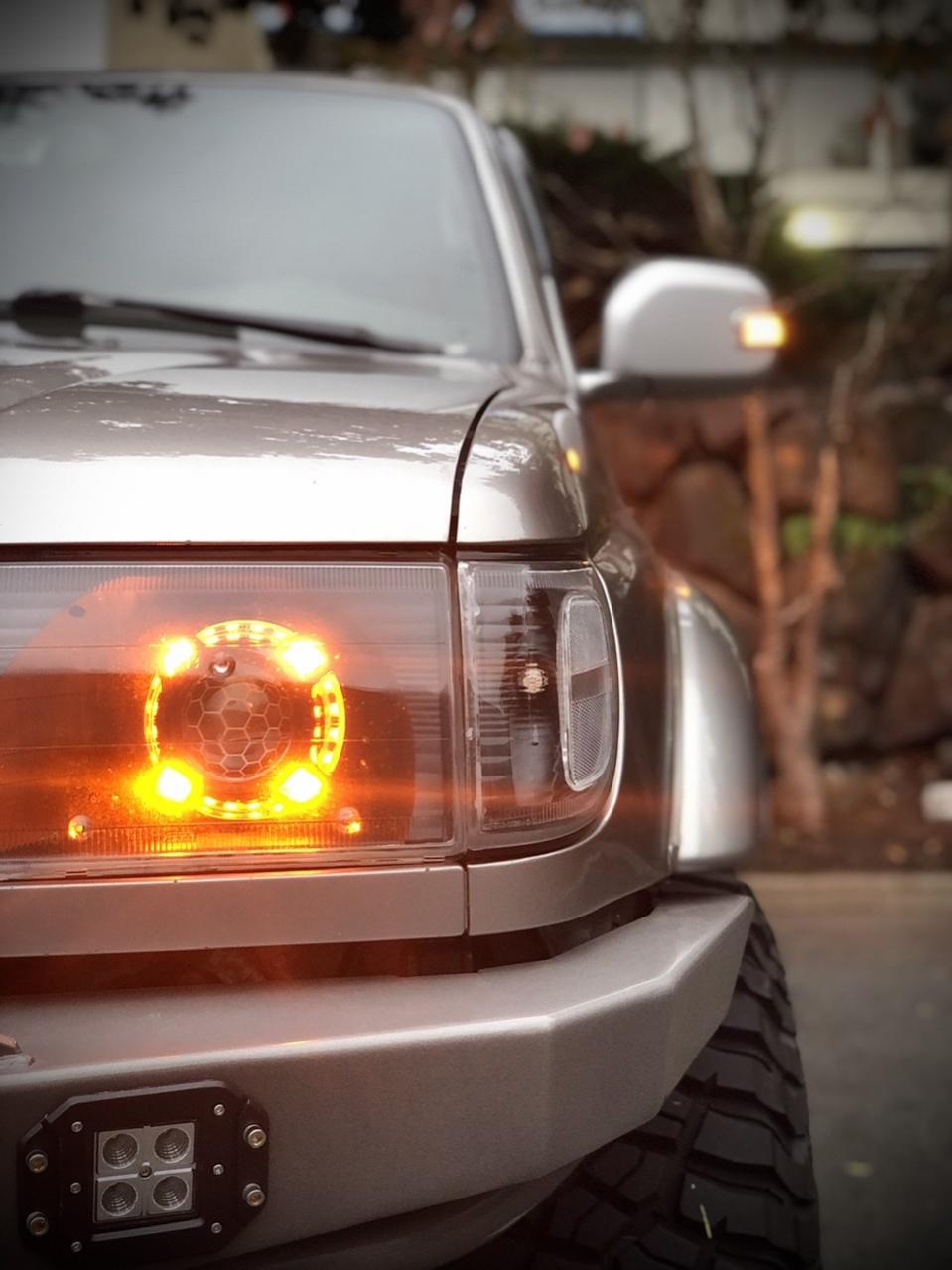

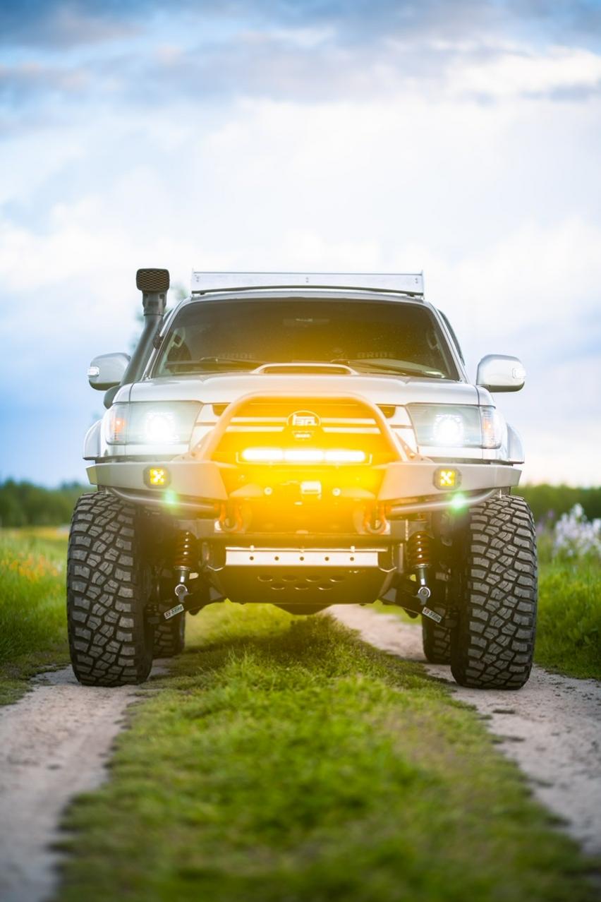

Lighting:
Installed:
-Depo LED tail lights smoke lens
-Oznium interior LEDs
-BXBuilt custom LED headlights, honeycomb lens etching, matte black housing
-BXBuilt custom corner lights matte black housing
-Diodedynamics 18” light bar amber lens
-Revier LED third brake light smoke lens
-Revier LED mirrors

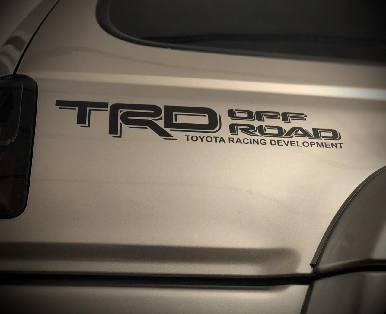

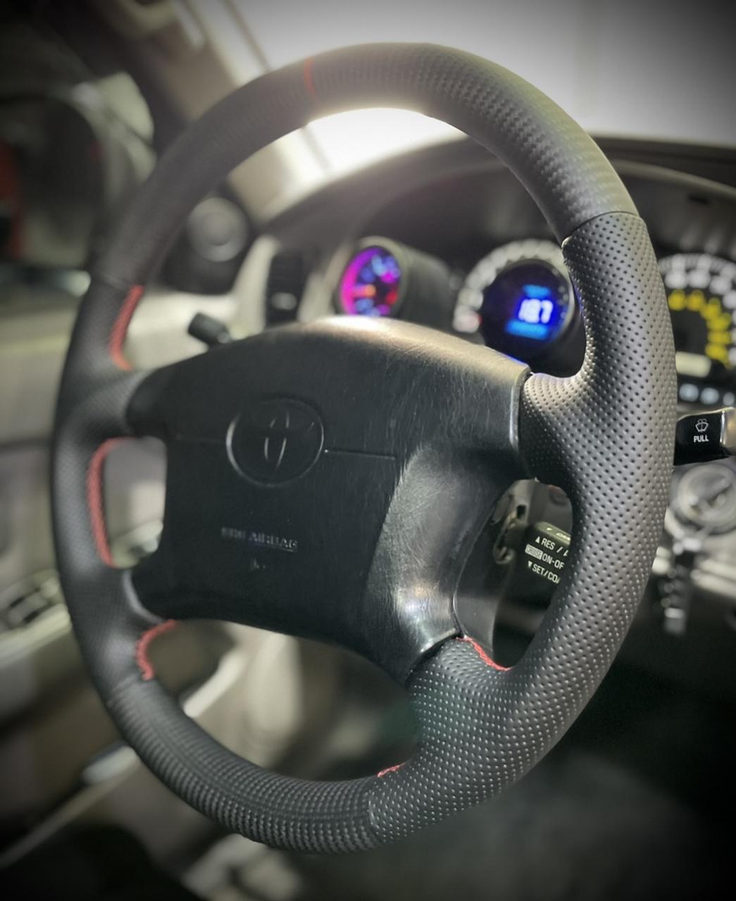

Details

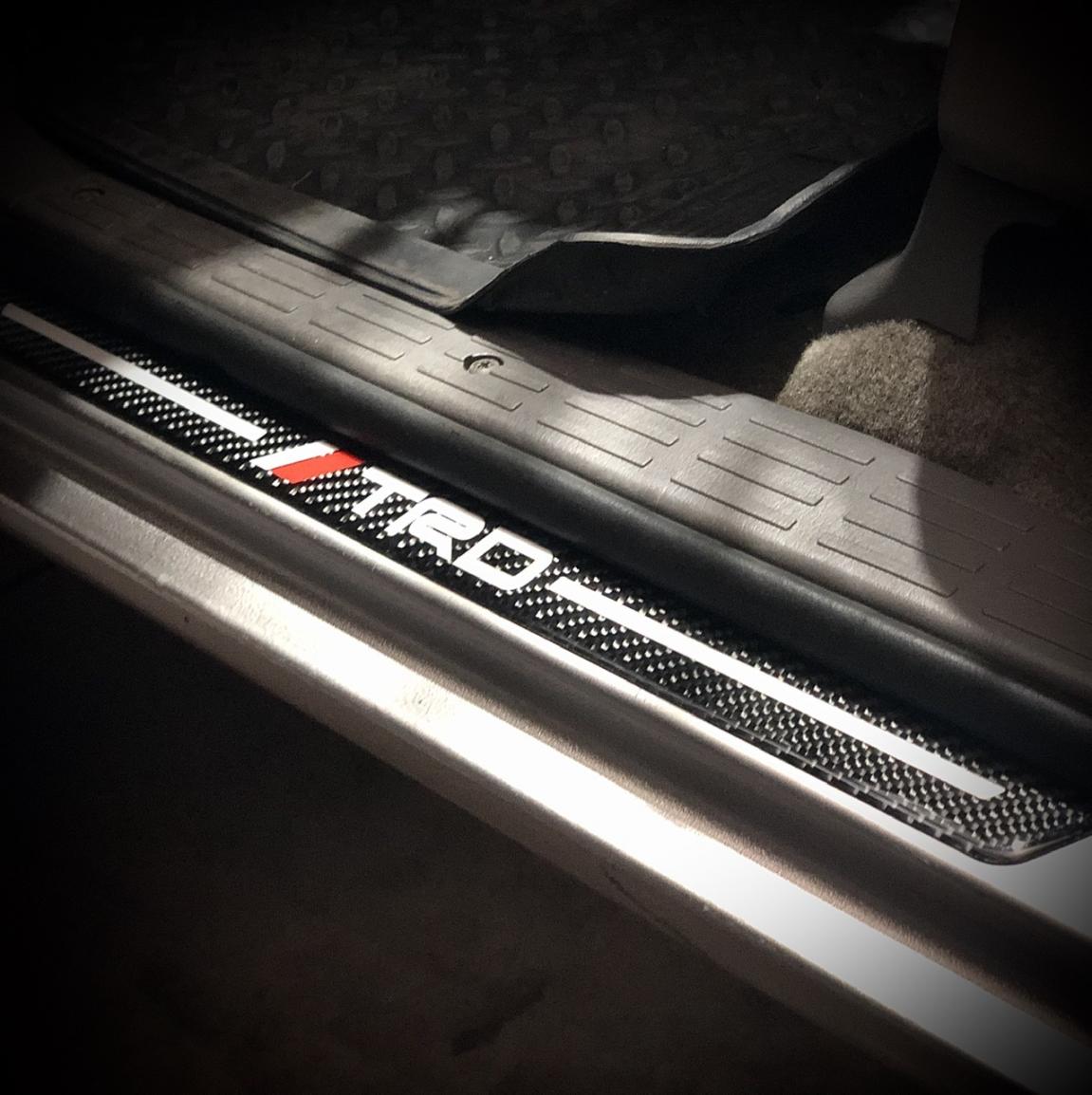

-TRD carbon fiber door sill protectors
-TRD supercharger emblems
-TRD off-road decals
-TRD license plate frames
-AJT designs key fobs
-TEQ badge billet aluminum
-Custom matte carbon fiber steering wheel

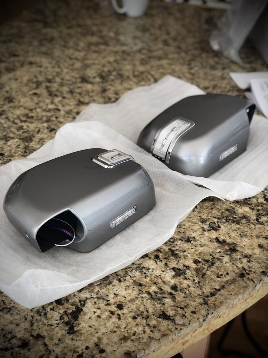

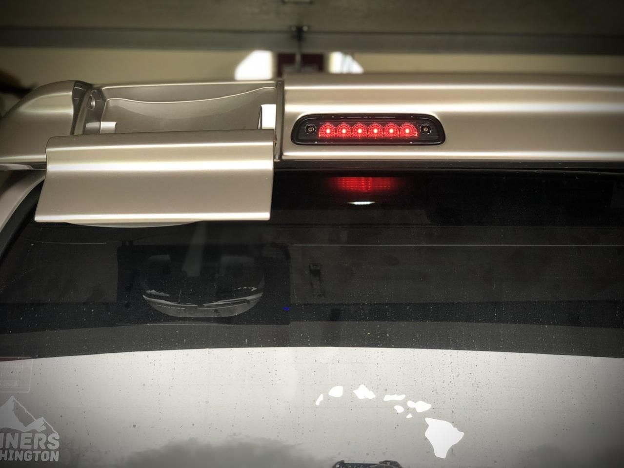

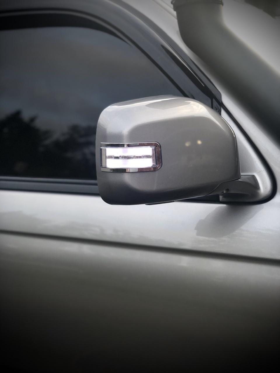

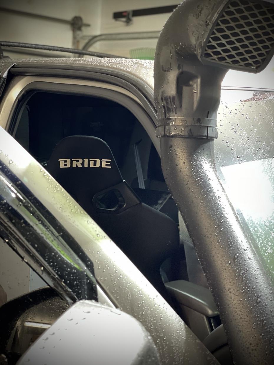

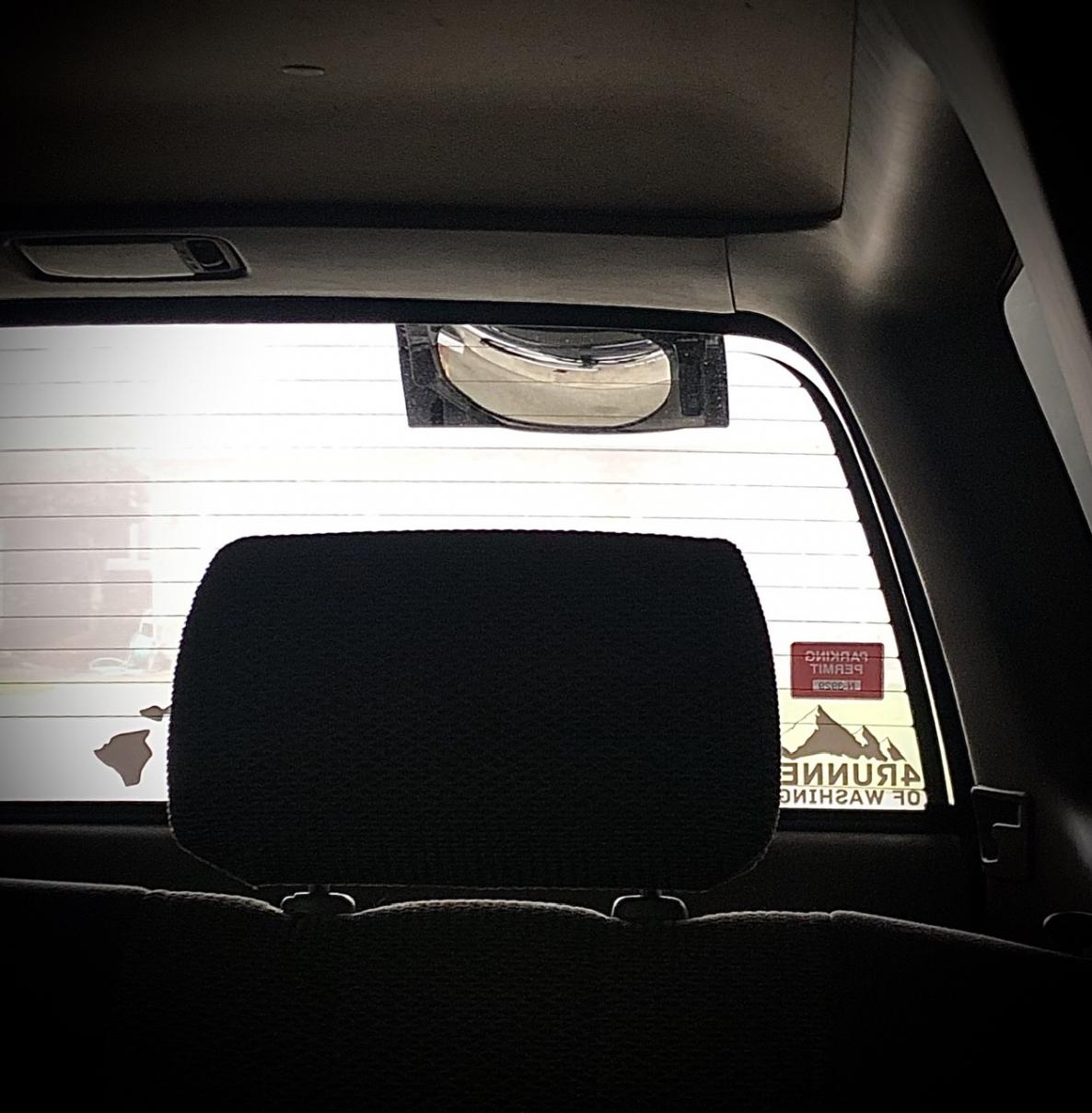

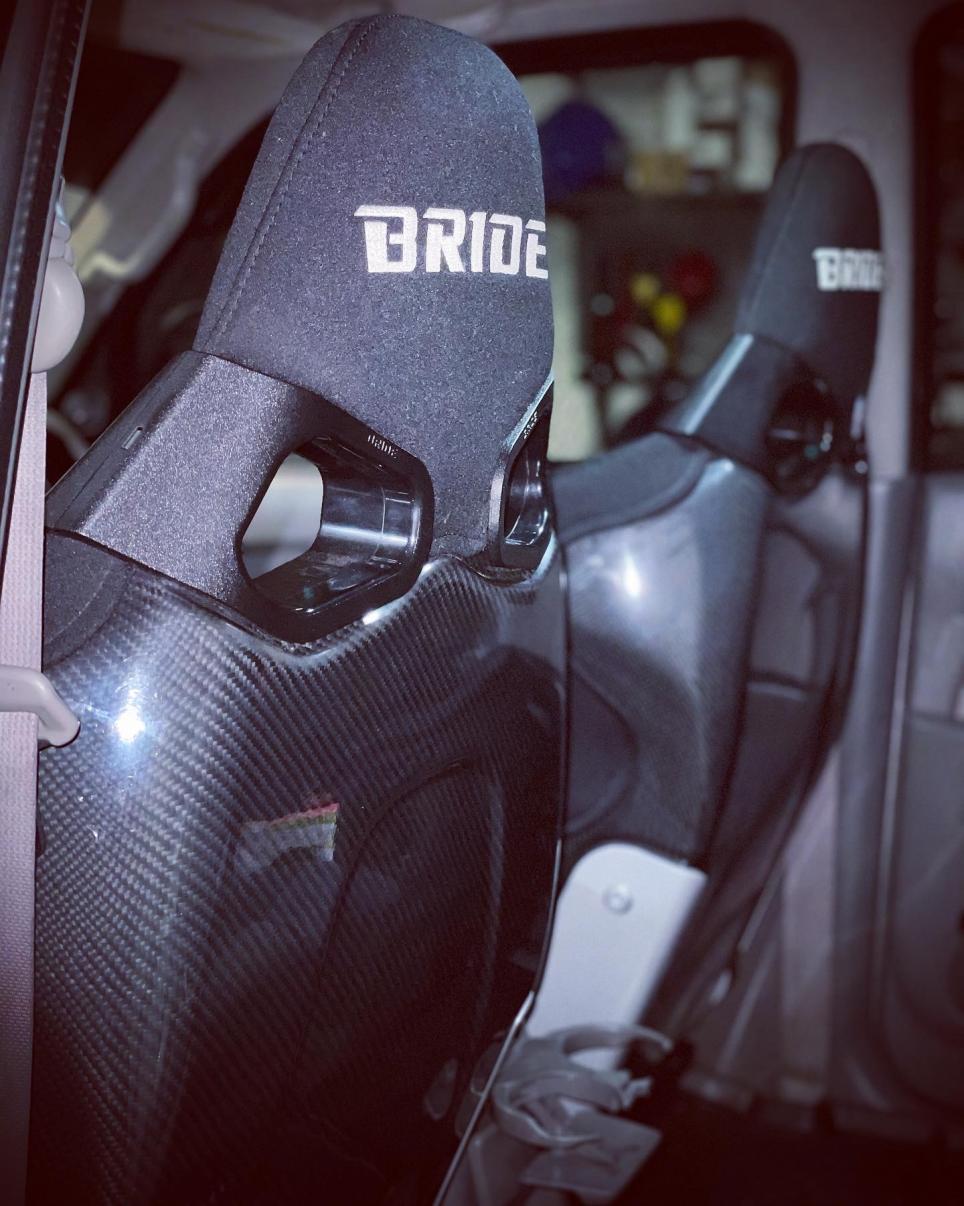

JDM Parts

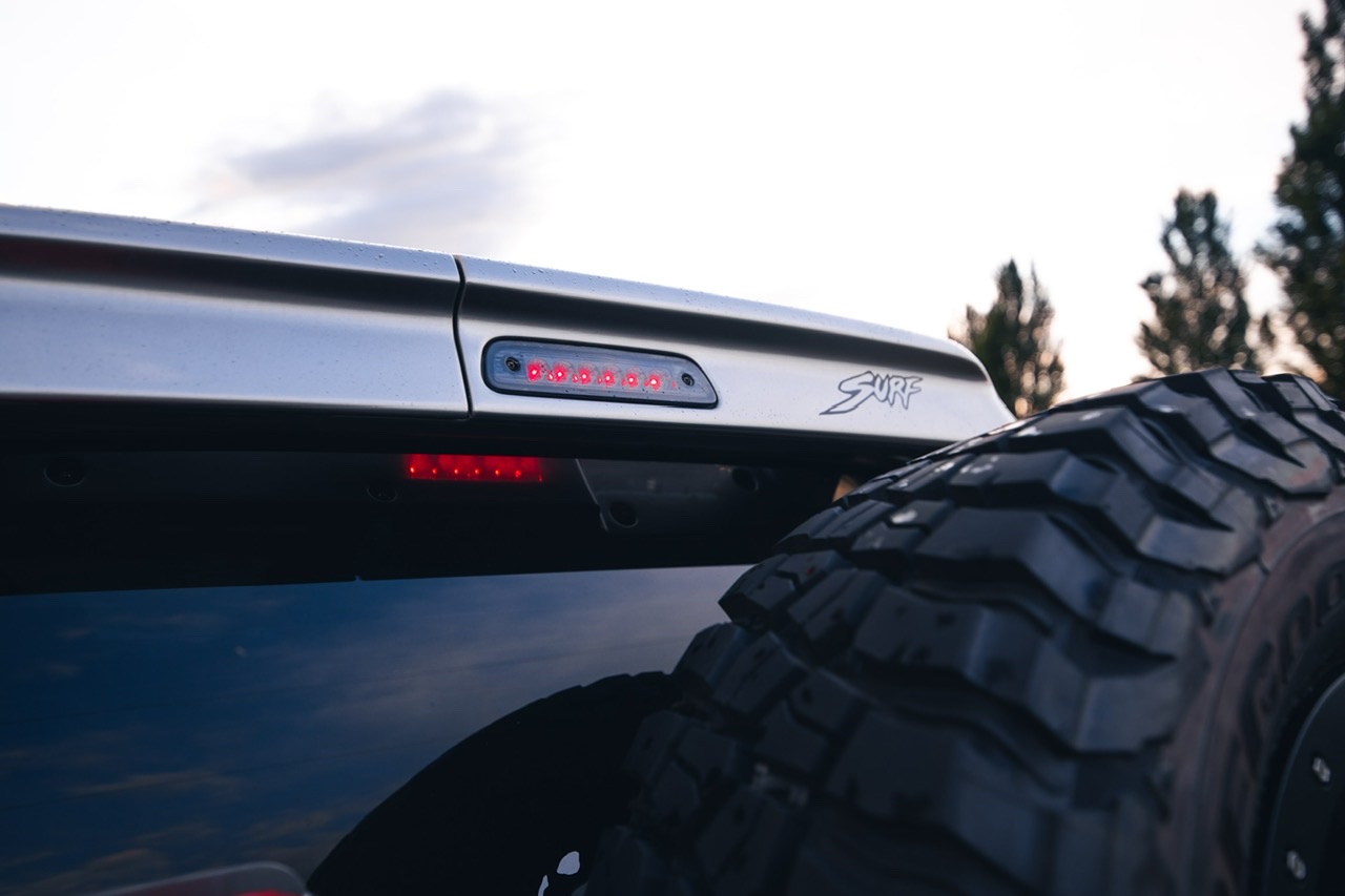

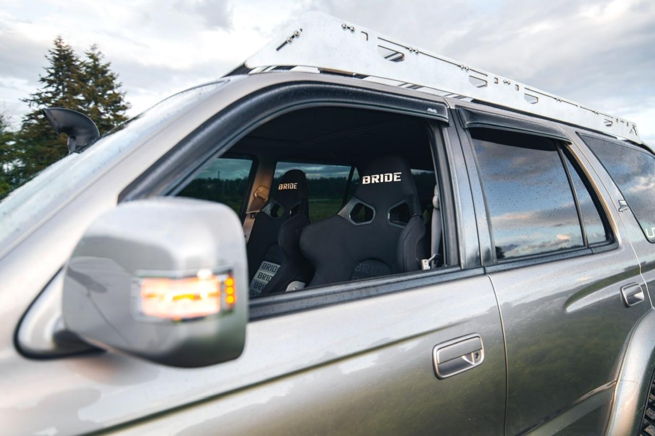

Genuine Hilux Surf 185 Power Rear Mirror Spoiler installed. Perfectly color matched @tajcollisioncenter Thundercloud Metallic. The function of the rear mirror drop down is to see the rear bumper while backing up. This part predates the invention of the rear back up camera. The mod is totally unnecessary in this day and age but it is appreciated by JDM enthusiasts and adds a very unique detail to this US spec 4runner. Extremely difficult to find.
Also installed are two Revier LED third brake lights. The one seen is the high mount spoiler version with smoke lens to match the tail lights... The one not seen is the hatch mount version with red lens (seen in the reflection in the final pic). These lights are discontinued and are also near impossible to find.
-Hilux Surf 185 power rear mirror spoiler color matched Thundercloud Metallic
-Revier smoke lens led third brake light, (spoiler mount)
-Revier red lens led third brake light, (hatch mount)
-Revier side mirrors with LED turn signals, DRL’s, and puddle lamps
-BRIDE Vorga seats with carbon aramid backs

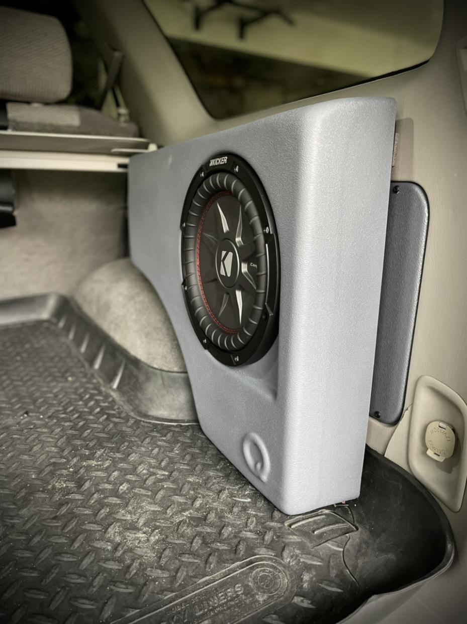

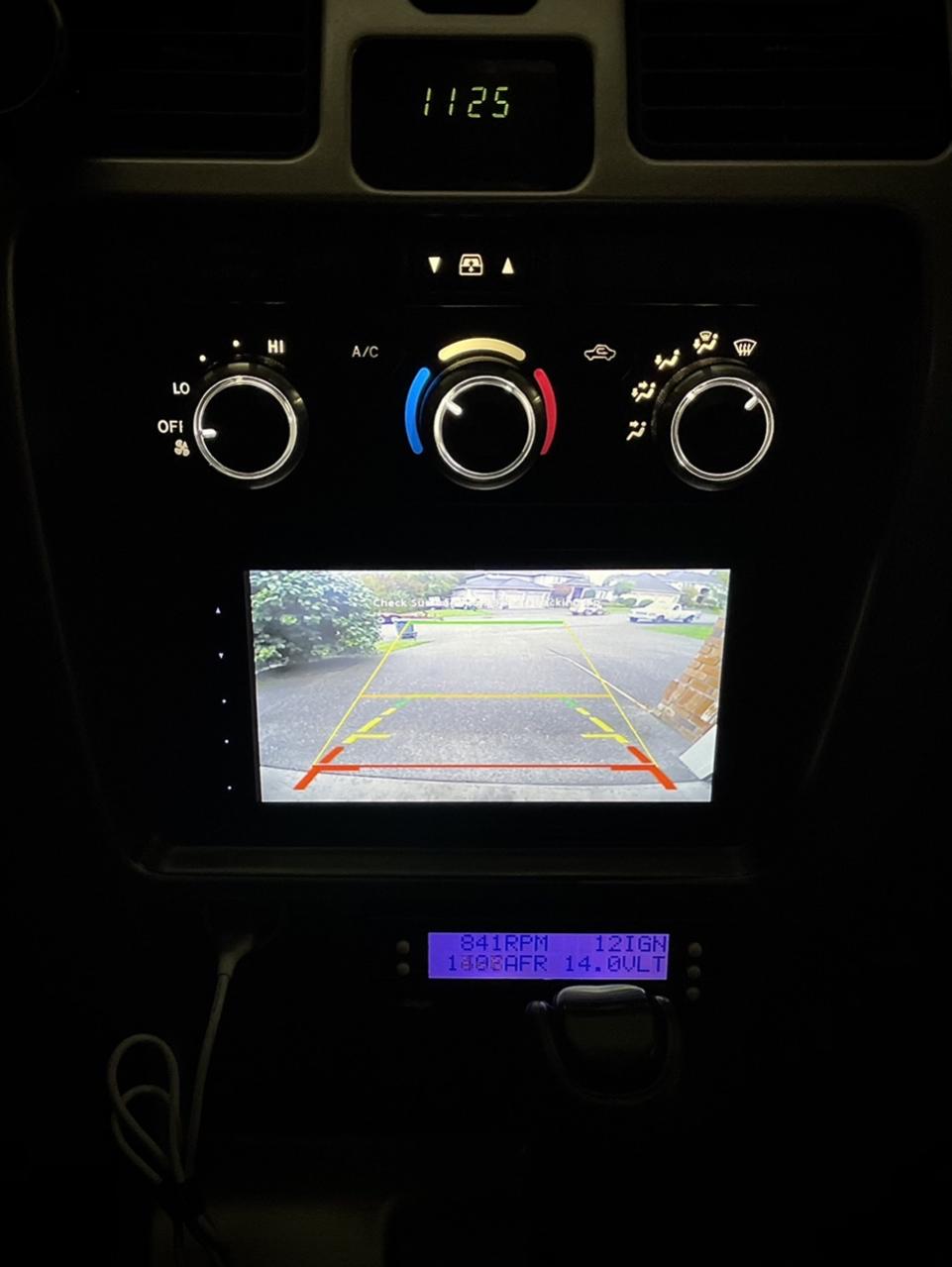

Audio
Goals: Primary objective, improve the OEM system, and fill in the missing bass without annoying rattles. Secondary objective, modernize the ride with Bluetooth connectivity, Apple car play, and back up camera. Third objective, reduce in cabin road and tire noise. The following gets the job done.
-Kenwood DMX4707S with backup camera
-Focal front separates
-Focal rear coaxials
-Audio control 300 watt amp
-Kicker 10” CompRT sub
-Qlogic box
-Noico 80 mil and 315 mil sound deadening

Look into the Deckplate mod and a drop in oiled filter, aFe Power is what I recommended since they made the original TRD performance air filters for Toyota. K&N's take in too much dirt. Those two intake changes will net a combined +18 HP and should run less than $100.
The deckplate mod involves cutting a hole in the air box and installing a marine grade deckplate that is waterproof. By bypassing the snorkel when you're not doing river crossings, you'll gain loads more power. It's probably more than +18 HP for you since that's a long way for the air to travel with a lot of bends. Pop it back in when you do a crossing and the snorkel works just like it's supposed to.

Covid 19 directly translates to more garage time. Thought I could handle body lift and coilovers on my own. Body lift? Yes. No problems. One man job. Coilovers? Nope!
Anyways, installed the following with my friend Ed bailing my ass out!
-Toytec ultimate 3” coilovers
-17x10 offset -18 Fuel Shok Anthracite
-285/70/17 BFG KM3
Of note, installed body lift first. Which was helpful with the coilover install. I encountered extremely stiff steering with body lift install due to tension on the steering shaft. Need to loosen 12 mm bolt on c clamp right above the rag joint to relieve this tension, (once loosened pull shaft to and fro rack). This solved the stiff steering issue entirely. Toytec needs to include this step with their body lift install instructions.
