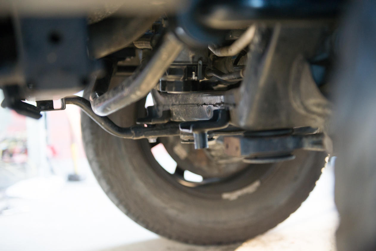

I'm having a hell of a time getting pics off of my camera. I'm looking for photos of how much clearance there is between the sway bar corners and the springs. Photos of the sway bar and the radiator support brackets and the mounting points of the sway bar with the spacers provided by fox, which look identical to these
We used those supplied spacers and ended up having to file down one of the arms under the skid plate because it kept making making so much contact ( On the drivers side ) that it would not allow us to move the sway bar away from the coil overs. It also seems that the driver side of the sway bar was lower than the passenger side, is that normal?
I'm hoping someone has installed A similar setup on an LE and can provide some feedback.
This is the only photo i took apparently, I thought there was more

Very similar to this, [MENTION=8206]harper7[/MENTION] posted this on another thread but those spacers wouldn't have done much. We needed about 1/4 inch of clearance.. and it was only making contacts toward the driver side of the radiator support bracket.

This is what we had to do in order for the sway bar to move enough to clear the spring. And so that sway bar clears the radiator support bracket..

I would really appreciate if someone would take photos of the space between the coils and the sway bar, specifically in an LE or SR5. The reason being is that my sway bar is way too close to the coils, Here are some photos...
Passenger side
Drivers side
I can barely fit a business card in between the space, so it stills clear but if it moves a hair than it will be hitting the coils.
