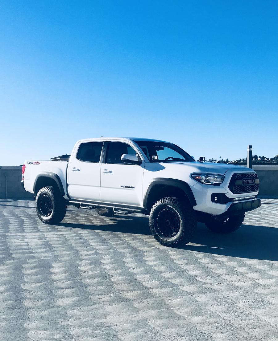

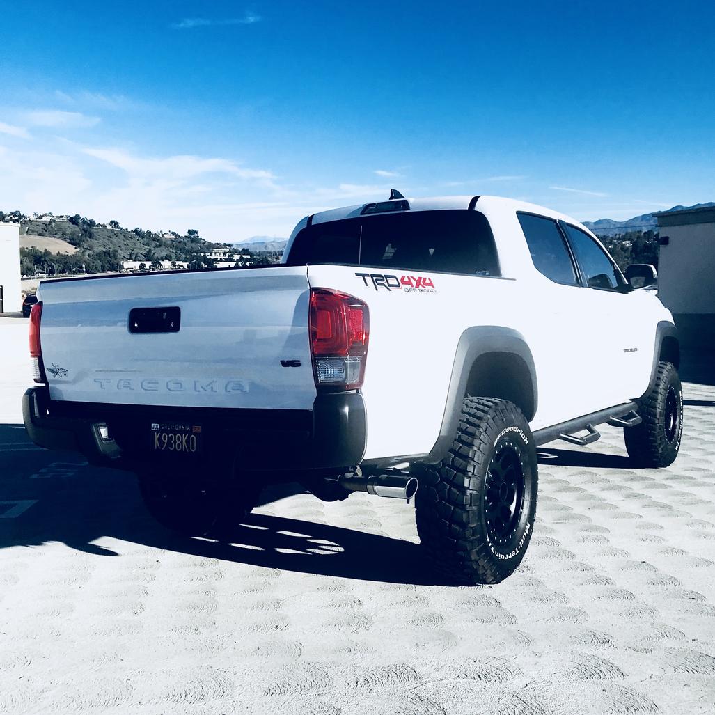

To be completely honest, we haven't done any crazy trails yet, just the basic stuff. We use it mostly to get us to the campsites and hiking trails. I say we because my wife actually daily drives the 4runner - I have a Tacoma. We decided to finish the 4runner build with full armor before anything major.
This being said, I run the Fox series coils w/ remote res on my Tacoma (see image) and I'm super happy.
We've only had both trucks since July of this year, but we started building them the day we purchased! Sharing funds between two trucks is annoying, however, two is one and one is none :zoom:

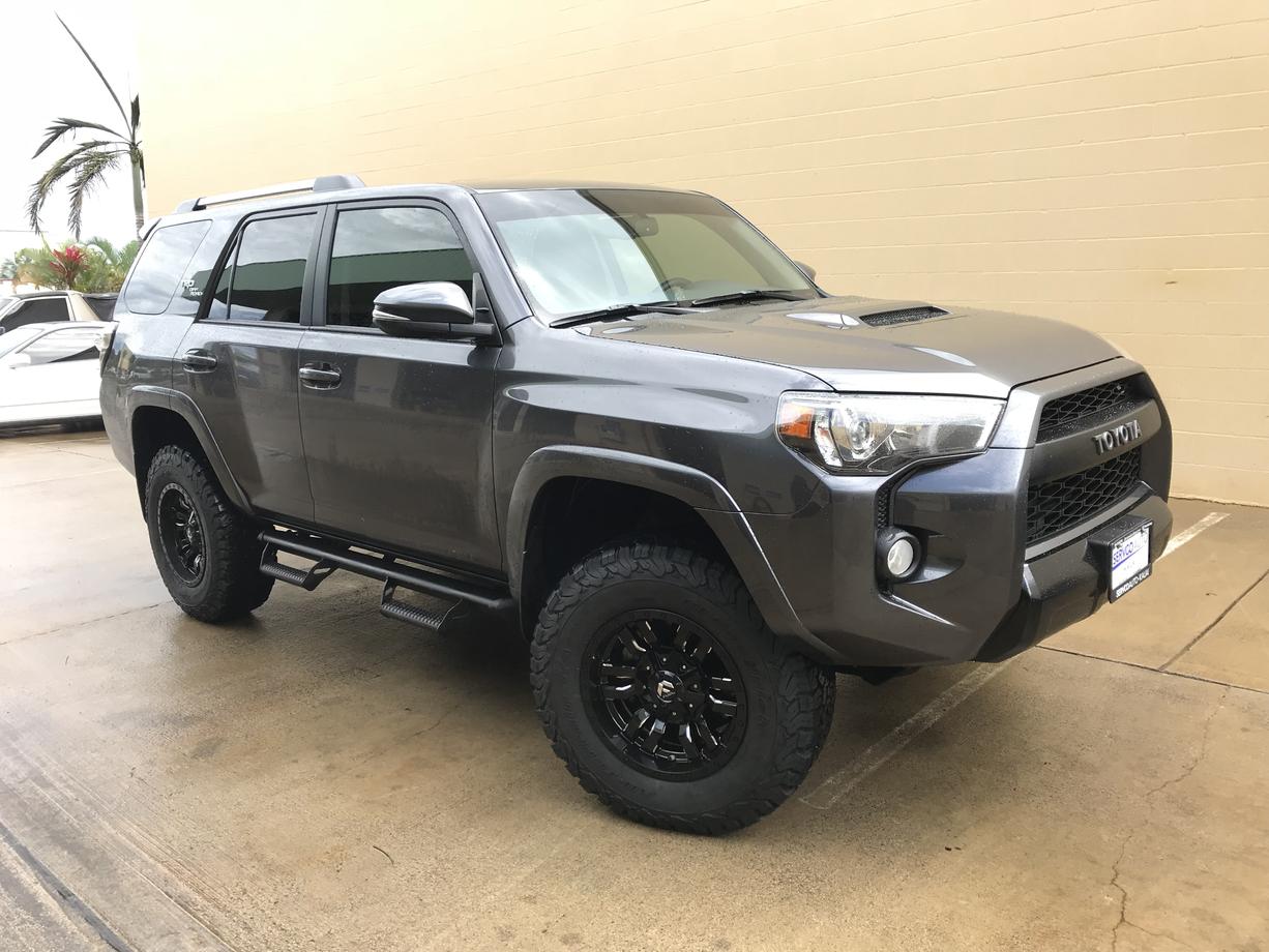

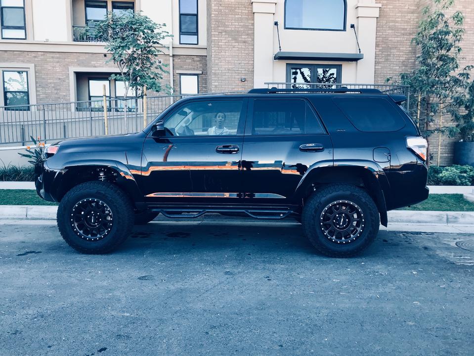

Here are some more photos :cheers:

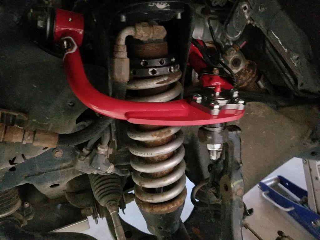

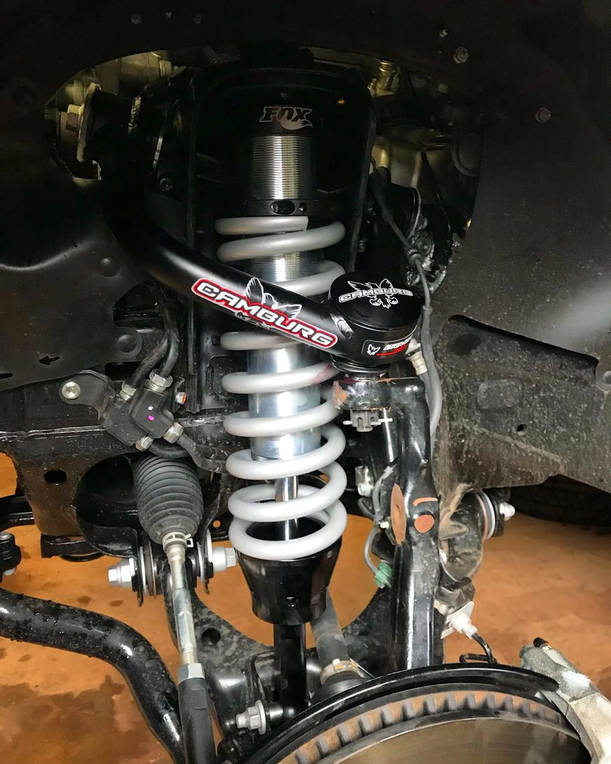

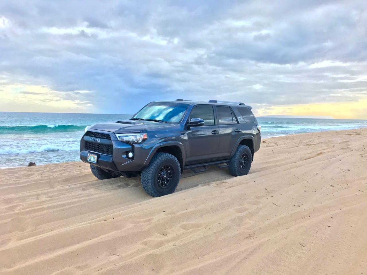

Fox 2.5s with Camburg Performance ball joint UCAs. 2018 4Runner. Rides nice!

I didn't measure it but it's about 2 1/2" - 3" of lift. 2" of exposed thread on the coilover body. It's out of the box from Fox. I didn't crank it at all. Rear lift is 1.5".
