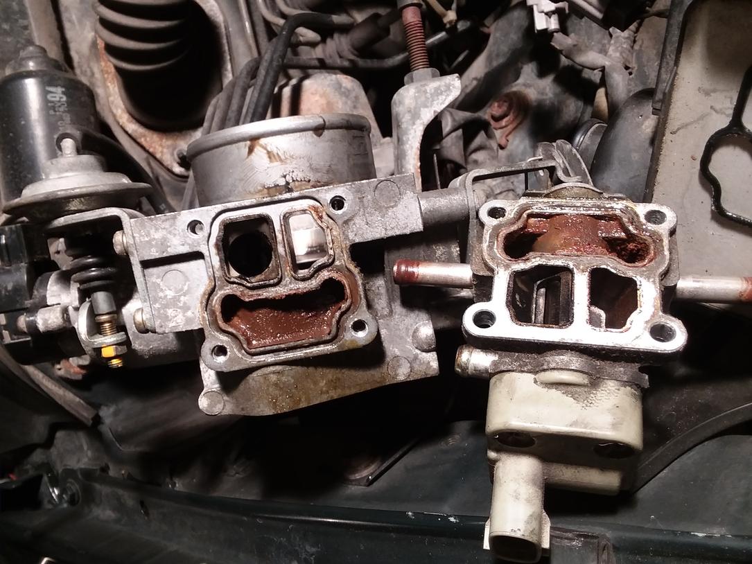

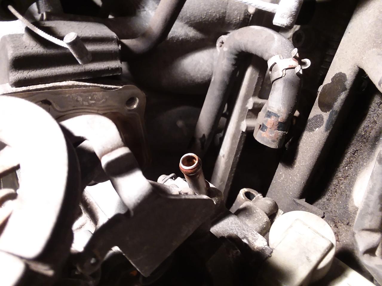

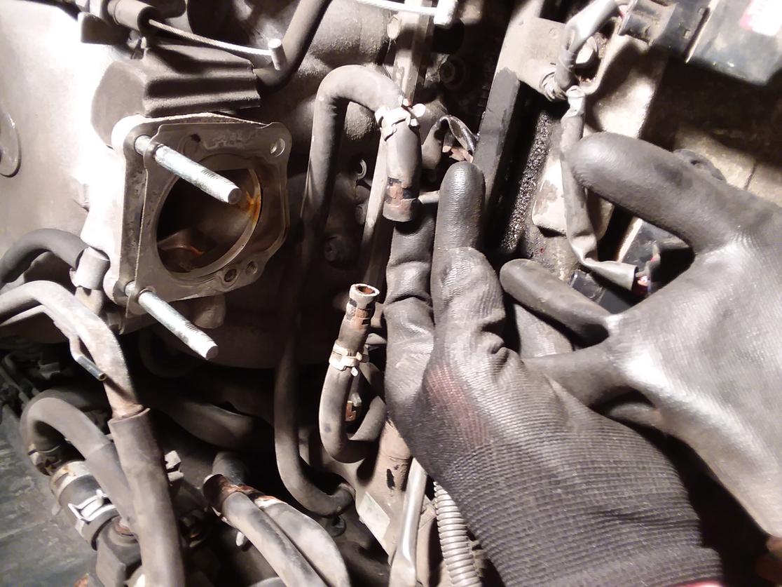

So the MAF sensor was clean but i cleaned it anyways. i noticed fluid in intake tube and decided to investigate further. Not sure what this tube is but it is under the throttle body and makes a squarish 180 turn to the back of the engine. It was full of fluid. I assume condensation or water but can't be good. What is this tube and do I have to drain it out from back of the engine? I drained what I could and now cleaning the throttle body and bottom sensor.
Edit: I forgot that these engines have cooled throttle bodies so never mind on that.
However, the in take box that attaches to the throttle body had fluid of some sort in it and I had to shake it out a bit.

Well this aint good....
edit: turn out it is coolant.
Yeah, that coolant is supposed to be there...
Though, your cooling system looks like it has had a tough life! Make sure you get new gaskets for the IAC valve when you reinstall it, and clean up those sealing surfaces.
-Charlie
Iac
Did you test out the little motor in the IAC to make sure the cam is moving properly/freely? Would be nice to test it before and after cleaning to see how much it helped. That coolant junk in there looks pretty bad. Was it clogging the IAC path significantly, or just more cosmetic?
I am not familiar with how to test that motor. I just took everything apart, cleaned the best I could, and reinstalled. I did not have a new rubber gasket for the TB so I cleaned the old one, lubed it a little, and reinstalled. It was still in good shape.
I didn't notice anything different on the drive home.
According to the maintenance records, the PO had a radiator implosion...TWICE....so the transmission fluid and coolant mixed If I'm not mistaken and I think that may have caused that buildup in the cooling system. I flushed the radiator a few months ago for winter preventive maintenance.
I'm just wondering how that liquid got into the air intake box, the one that attached to the throttle body. There is a crevice where water poured out of as I turned it over. The air filter box was dry.
