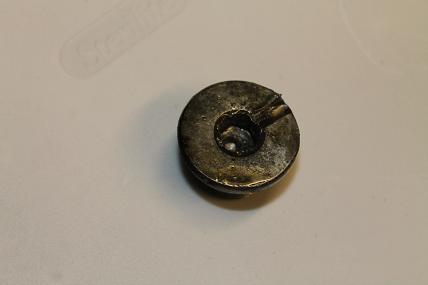

Great suggestion! :hatsoff: After rounding the allen hole, I used a dremmel with a cut-off wheel and very carefully ground a slot across the face of the plug. I could then put a chisel in the slot and tap it with a hammer to break it free. This worked great. After draining, I replaced the slotted plug with a new plug. However, as cj80cruiser has suggested, I should have welded a bolt head or nut to the face of the new plug prior to installation to essentially convert the plug to a hex head style like the rear diff has.
