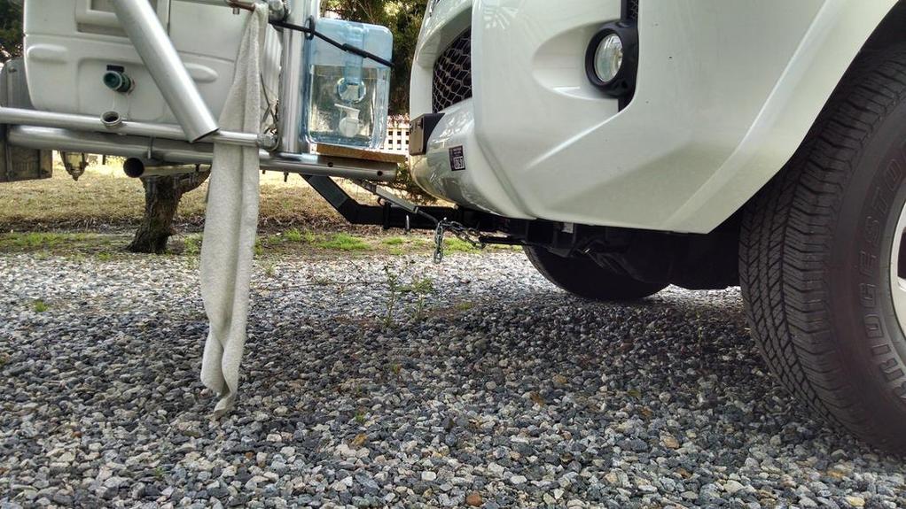

Another thing to consider is up/down and side to side wobble. I use two turnbuckles on the hitch tow points to the rack to stabilize it.
Picture of stabilization. There is another turnbuckle rig on the other side as well.
