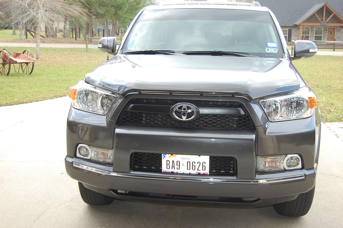

Theres no known front tag frame specifically made for the 5th gen but what i used is a frame from a current Camry which fits the bumper curve of the 4R.Hope that helps.IMG_7006.jpg

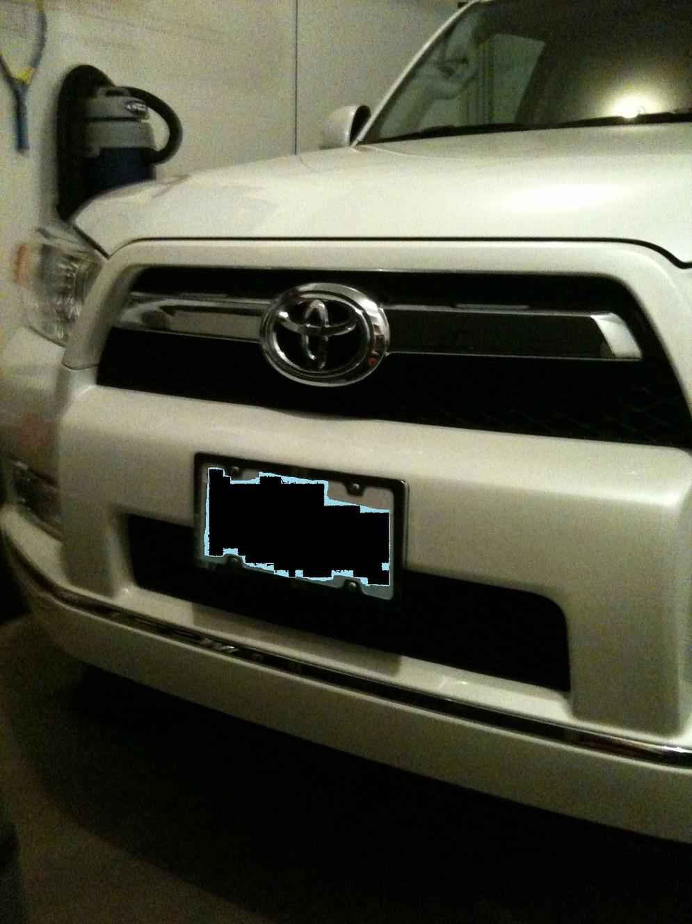

I purchased my T4R from a dealership out of state, which required only one license plate. My home state requires two, so like others I had to harness my OCD and drill into the bumper. I purchased a generic plastic mounting plate from the auto store ($5). I didn't care for the appearance of just the plate attached so I trimmed it out with one of the chrome plate covers ($10). I did have to use some metal shears and trim the plate down about a 1/8 to 1/4 inch on the top and bottom, but it's not noticeable. I did trim down the top mounting screws like ("mib" did in the above post) so they didn't go through bracket into the painted bumper cover. I also used stainless steel screws. For around $15 I found something which tied into the vehicle's stock appearance. Probably not an option for everyone, especially the anti chrome people, but it worked for my application.

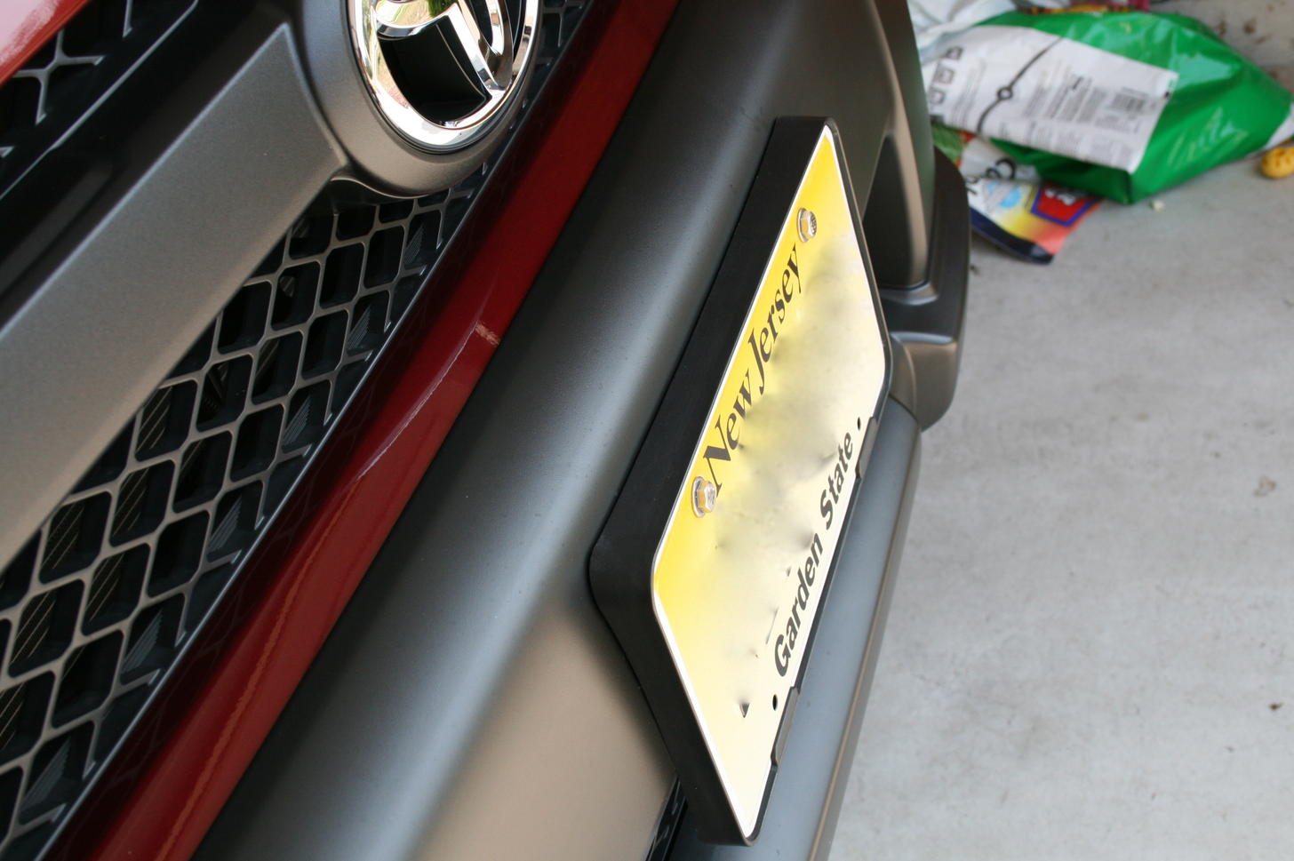

Here is a photo of how I mounted my license to the front of my 2010 limited. Cut tag on band saw top and bottom, about a 1/4 inch and mounted with zip ties. I was asked to show photo but don't know how to attach to a pm? Hope this helps Anthony who asked for it.
