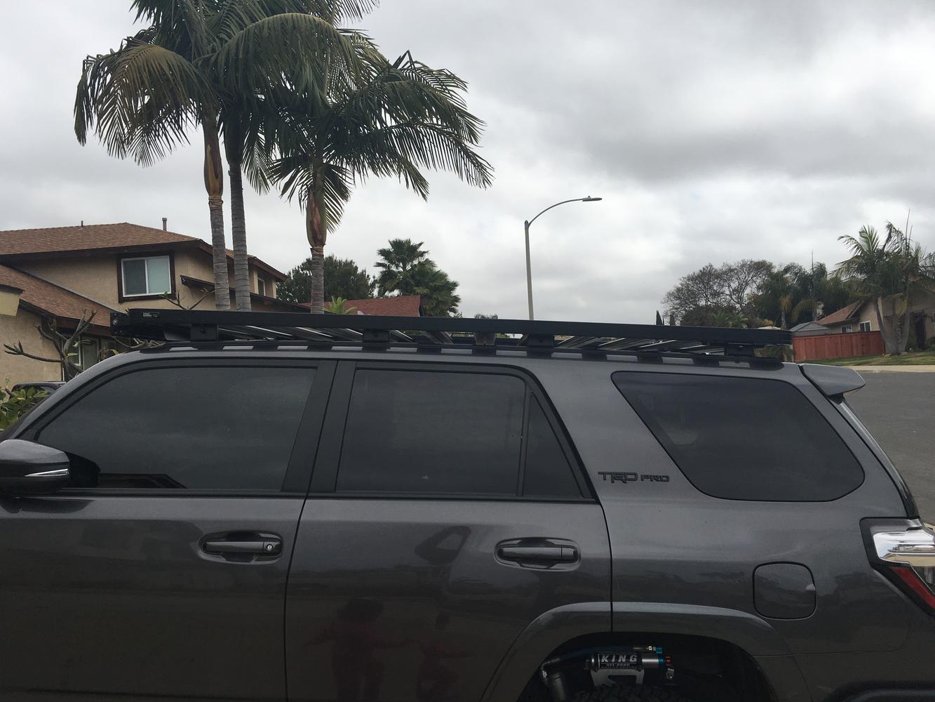

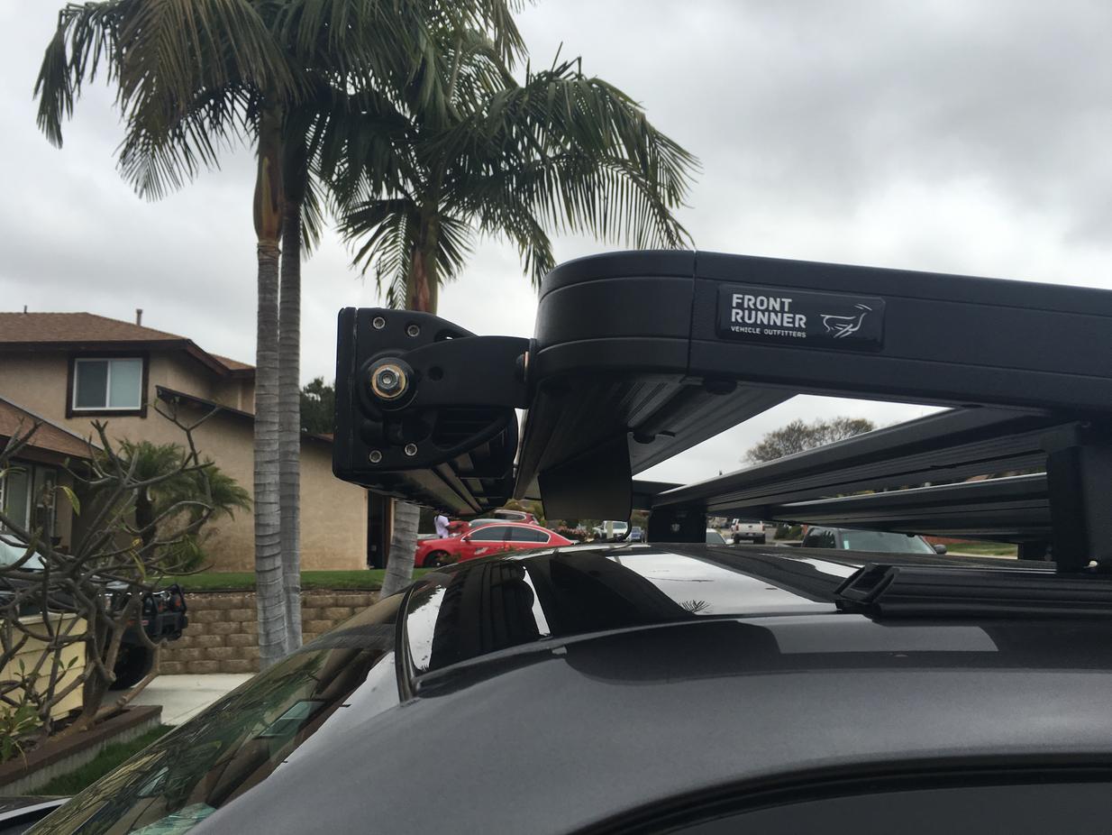

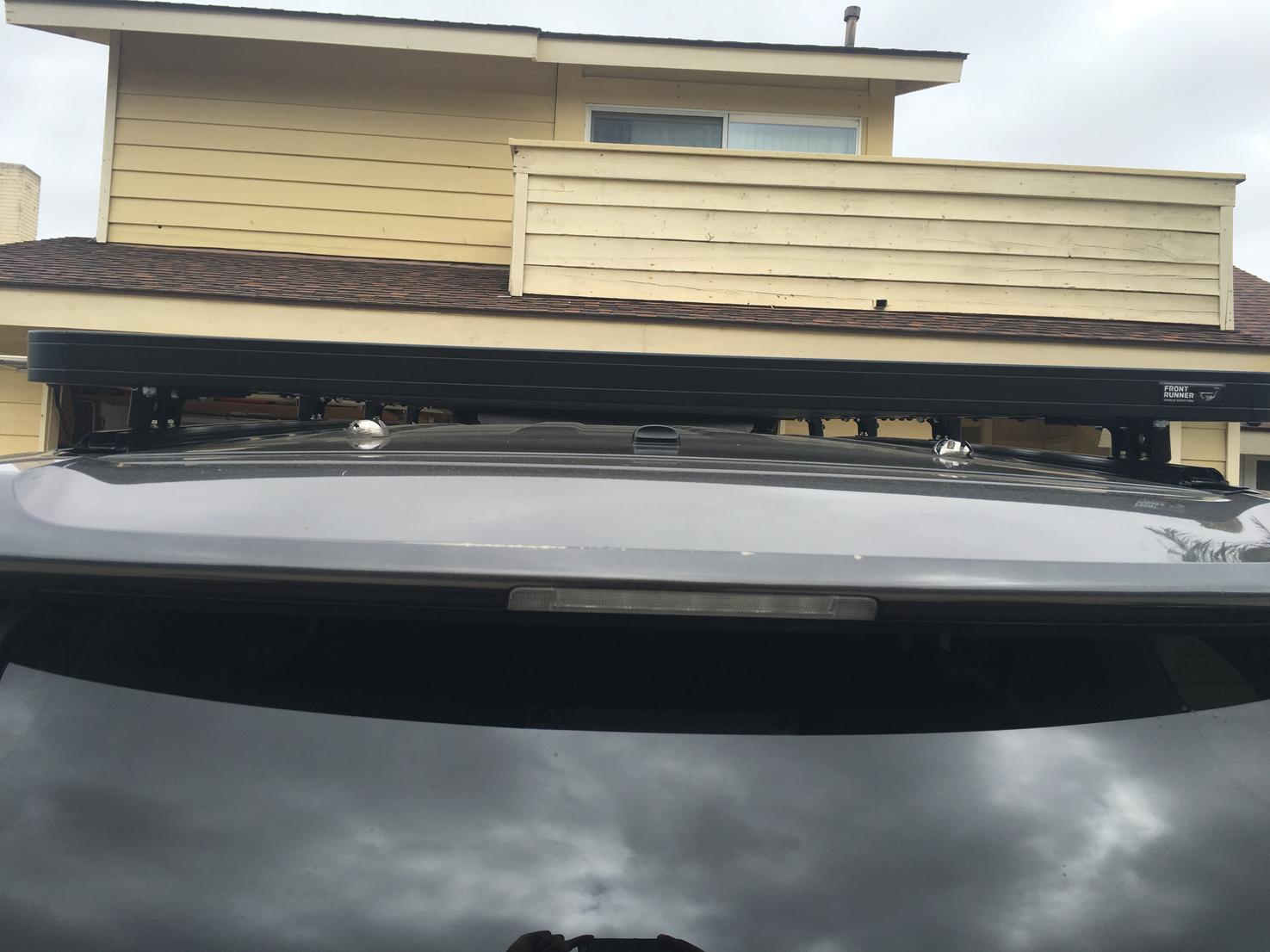

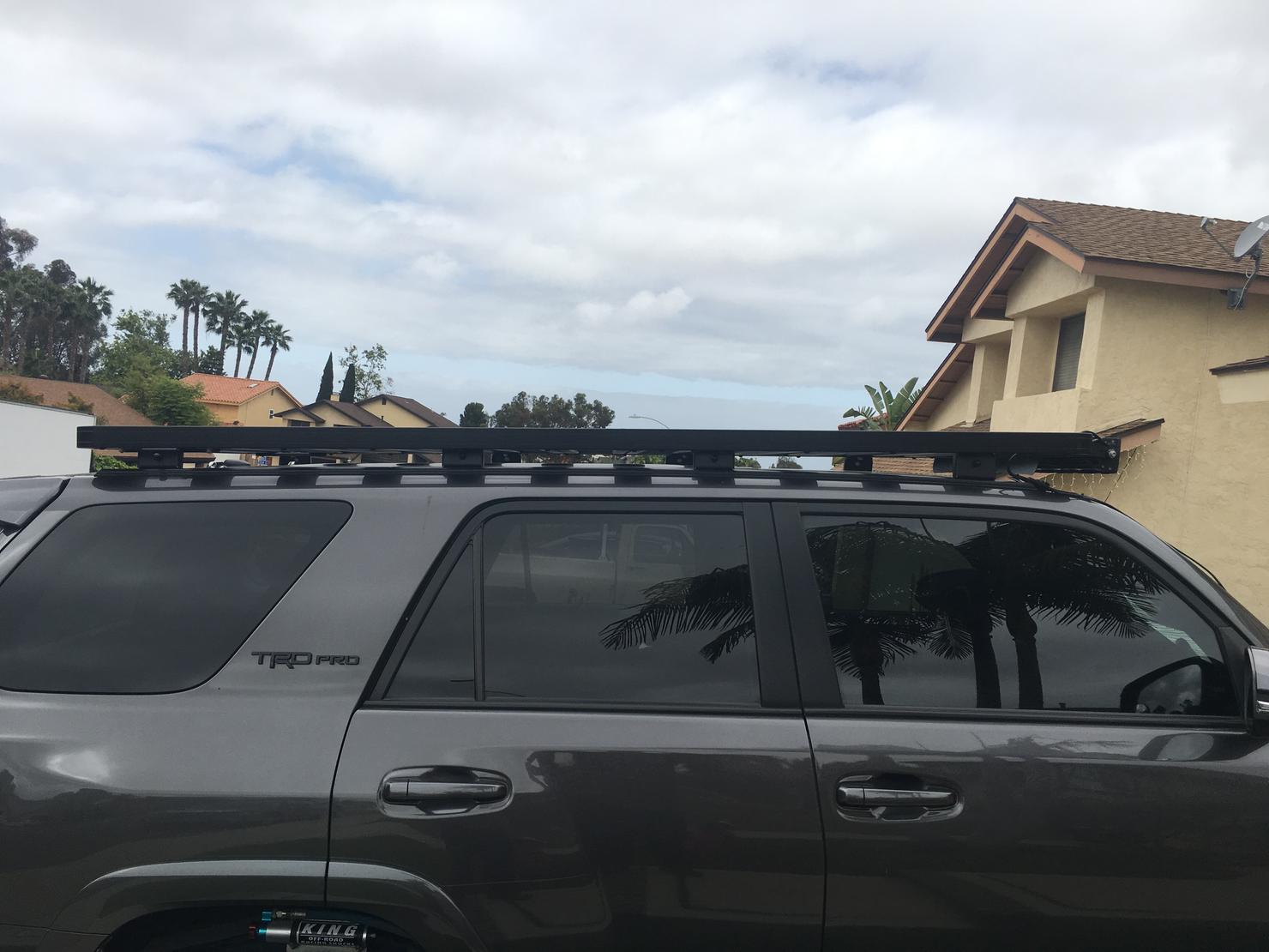

Here are some better photos. hopefully they come out well on here, its a bit overcast today.
this is with the light bar mounted to the front of the rack leading edge.
Im getting ready to do this rack with 40mm feet, I noticed you mentioned the light bar needed to be below to break up wind noise, I noticed the wind fairing behind the light bar in some of your pictures, did that take care of any of the wind noise?
Not to butt in but I just went through this. The included fairing is somewhat helpful, but nowhere near as good as an led bar. After having a Gobi with the fairing, I’d consider a light bar or custom fairing a top priority. Great rack, just needs buffering from the wind imo.
I cant see the photos you quoted at work but if its the dual row lightbar, nothing fixed the howl. it was coming from my lightbar. once I changed to the single row lightbar,i didn't run the fairing and the lightbar alone was quieted it all down.
