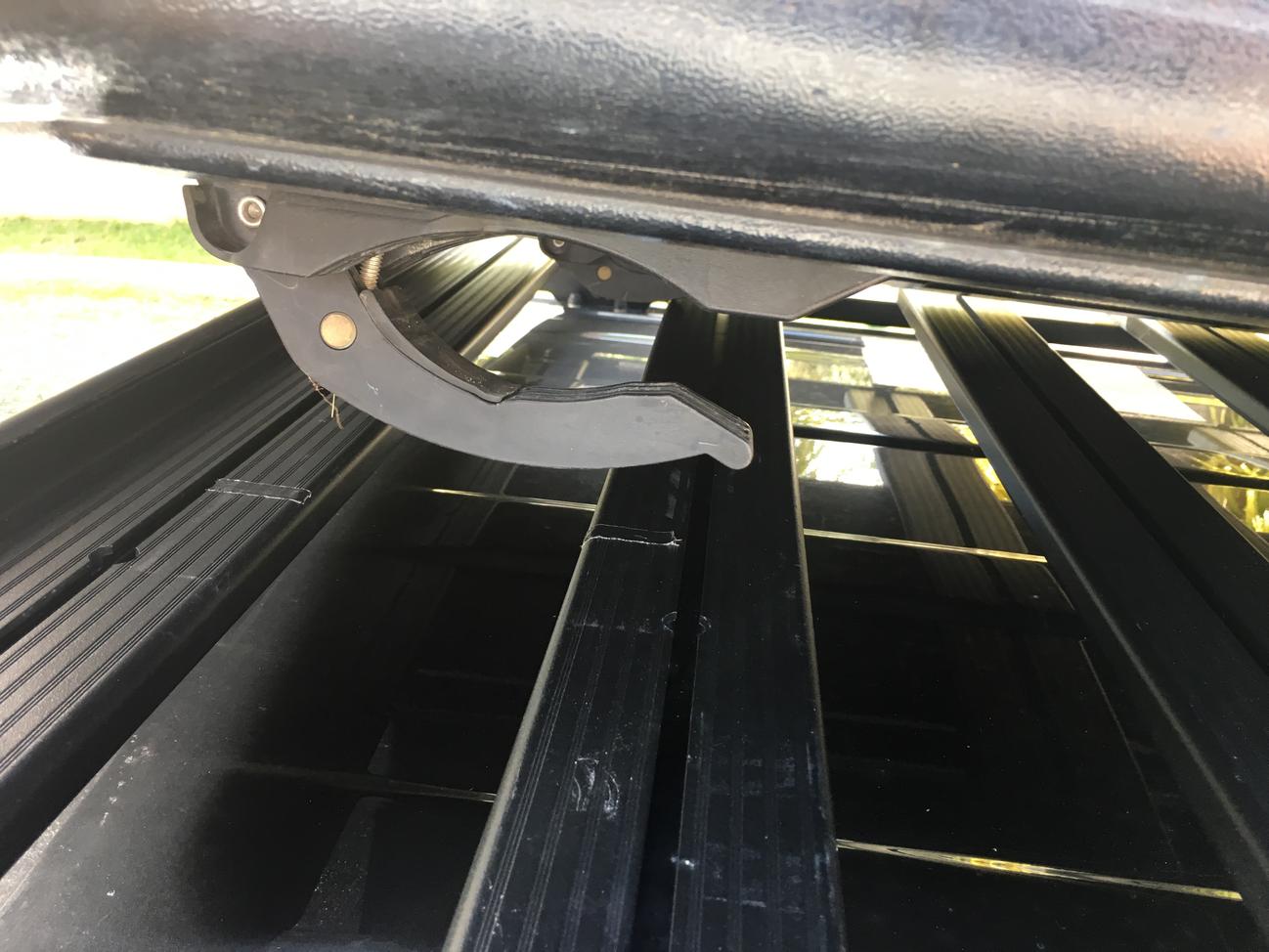

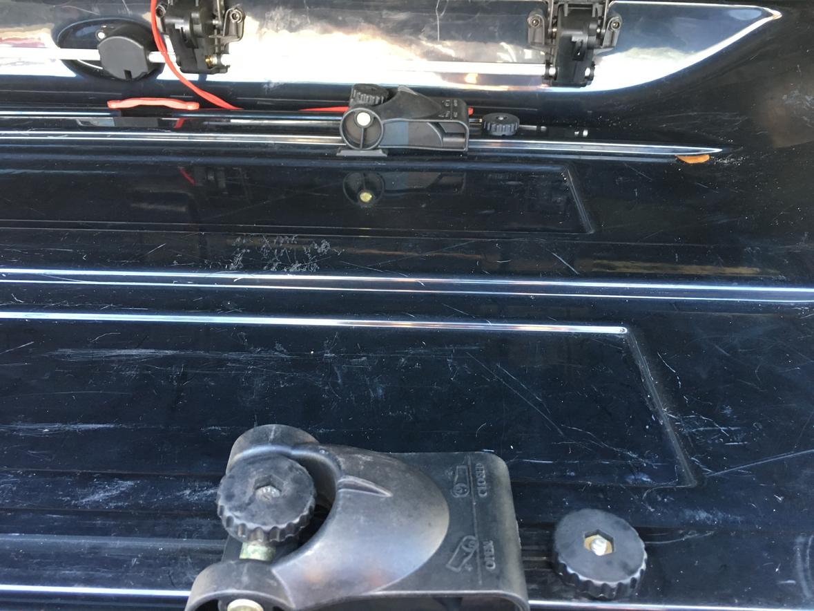

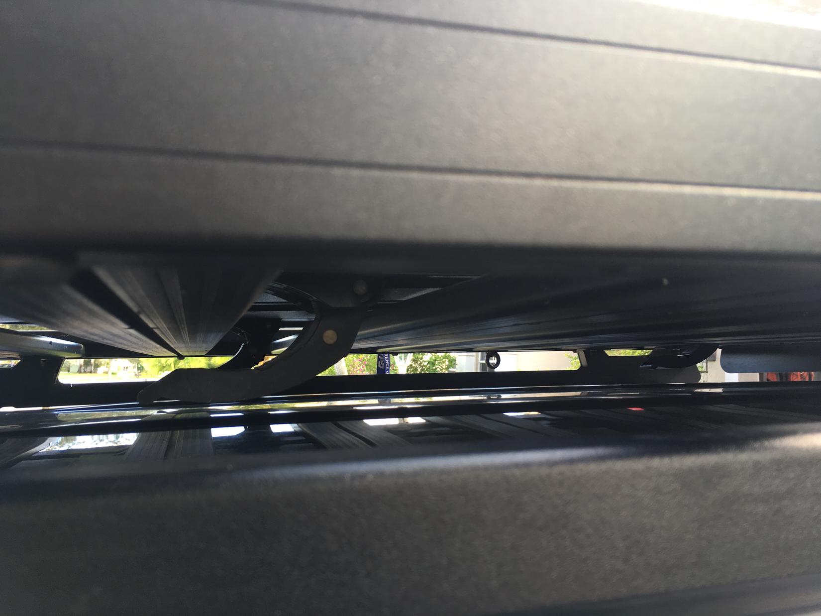

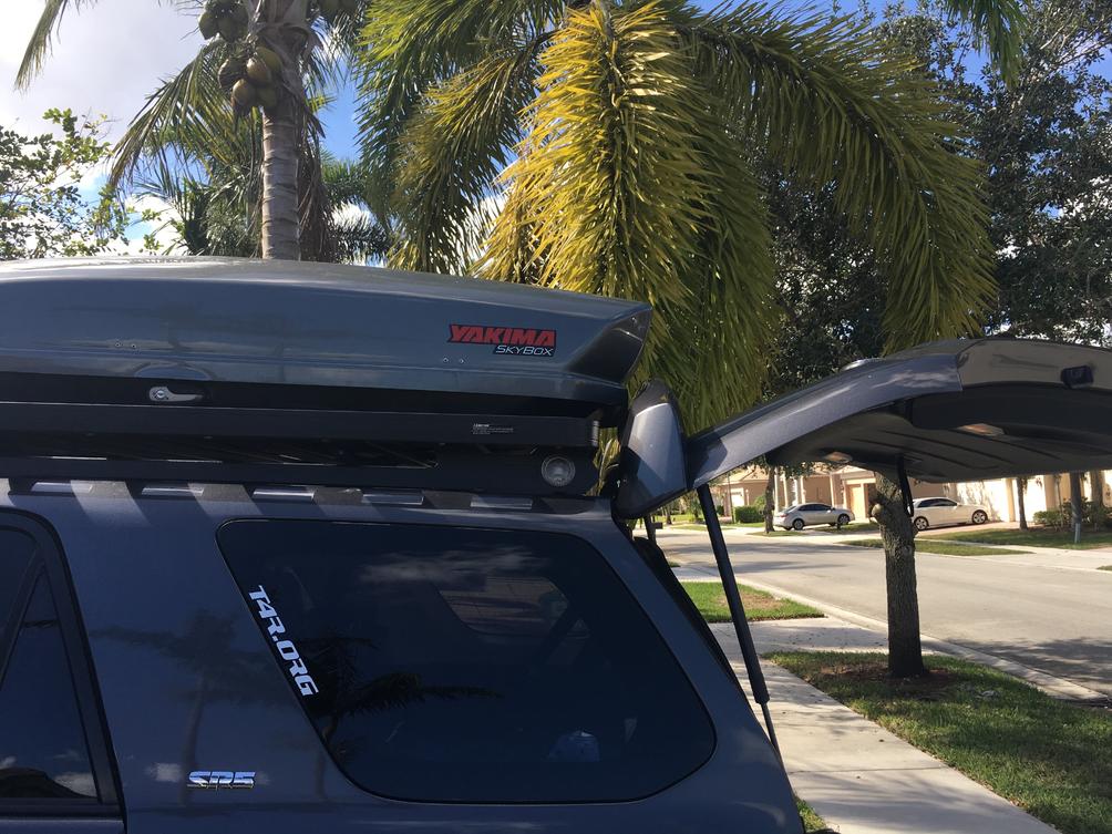

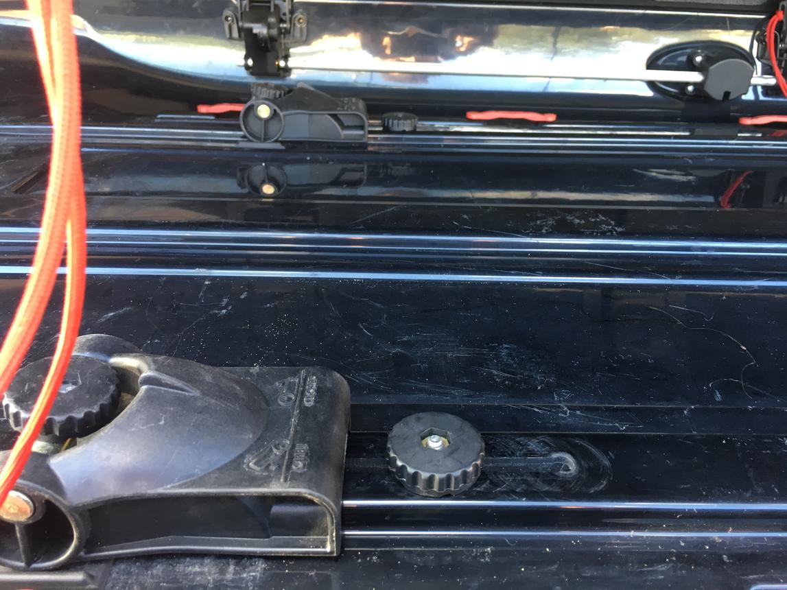

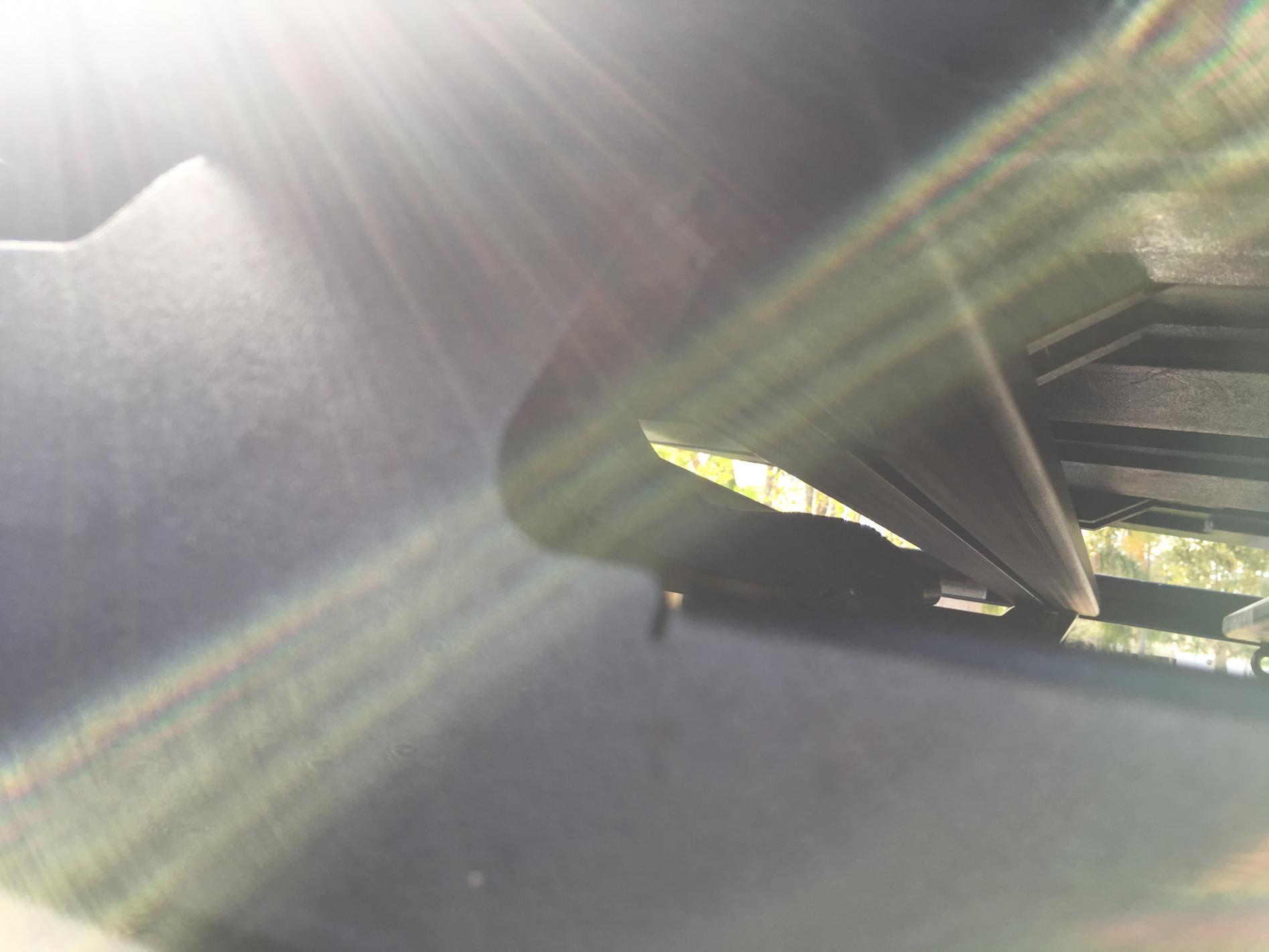

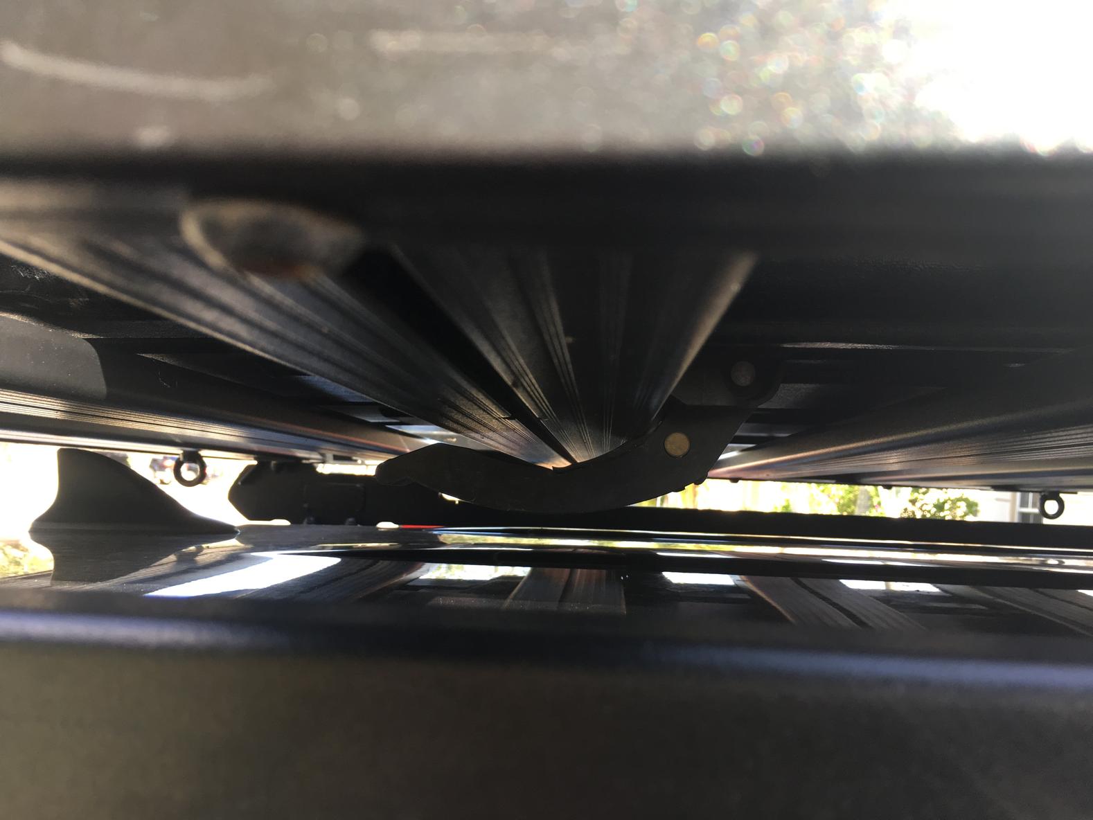

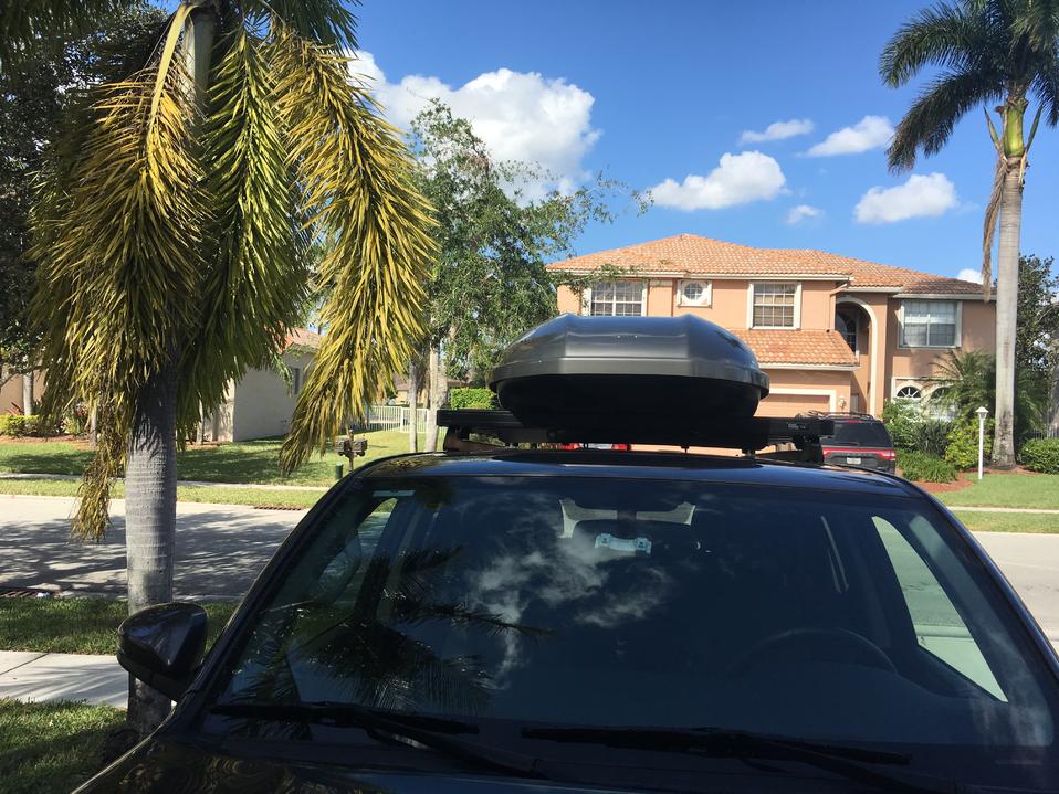

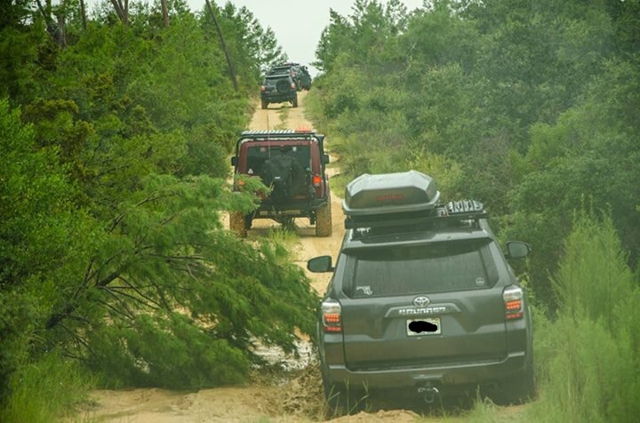

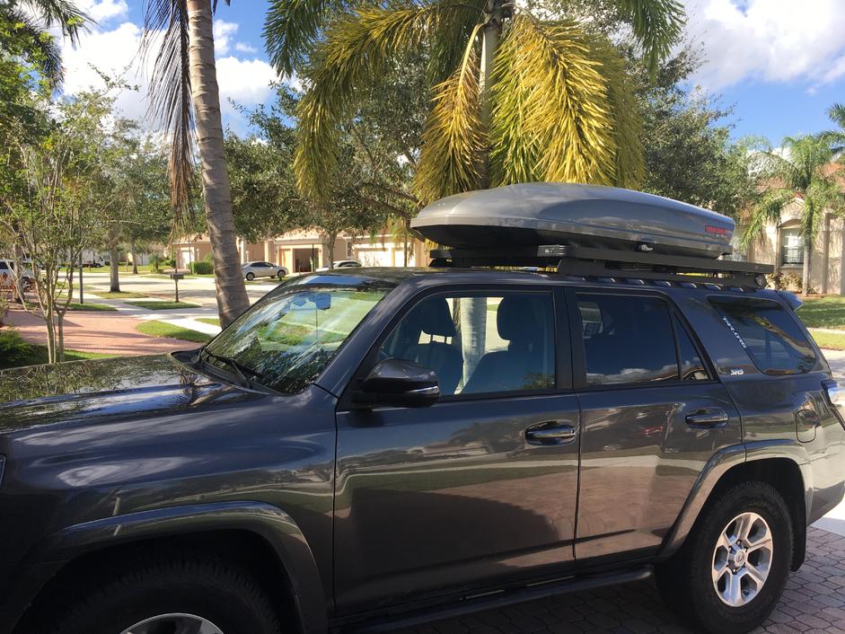

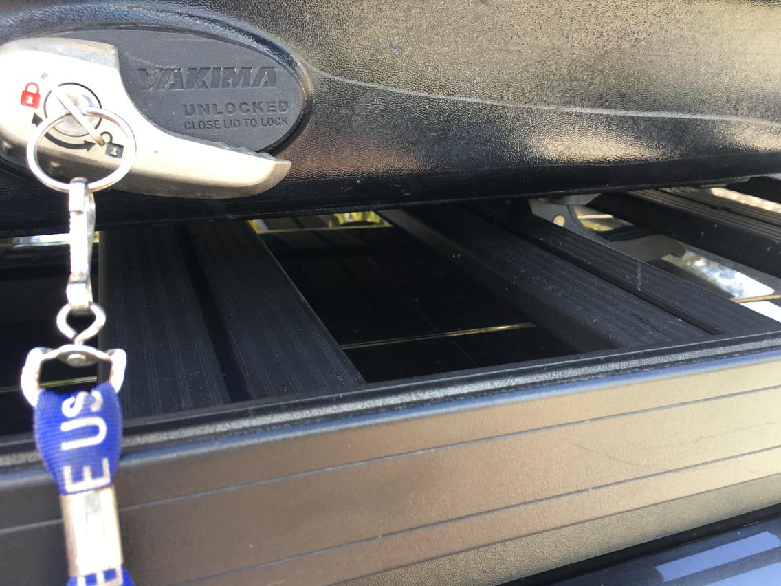

[MENTION=75328]DannyLlama[/MENTION] sorry it took so long. Just put my skybox back on today for extra storage with all of our family coming in to town. The key is really to loosen the clamps so they are at “full droop”. In the pics I also took some of the inside so you could approximate where the setup would be. Let me know if you have any other questions.

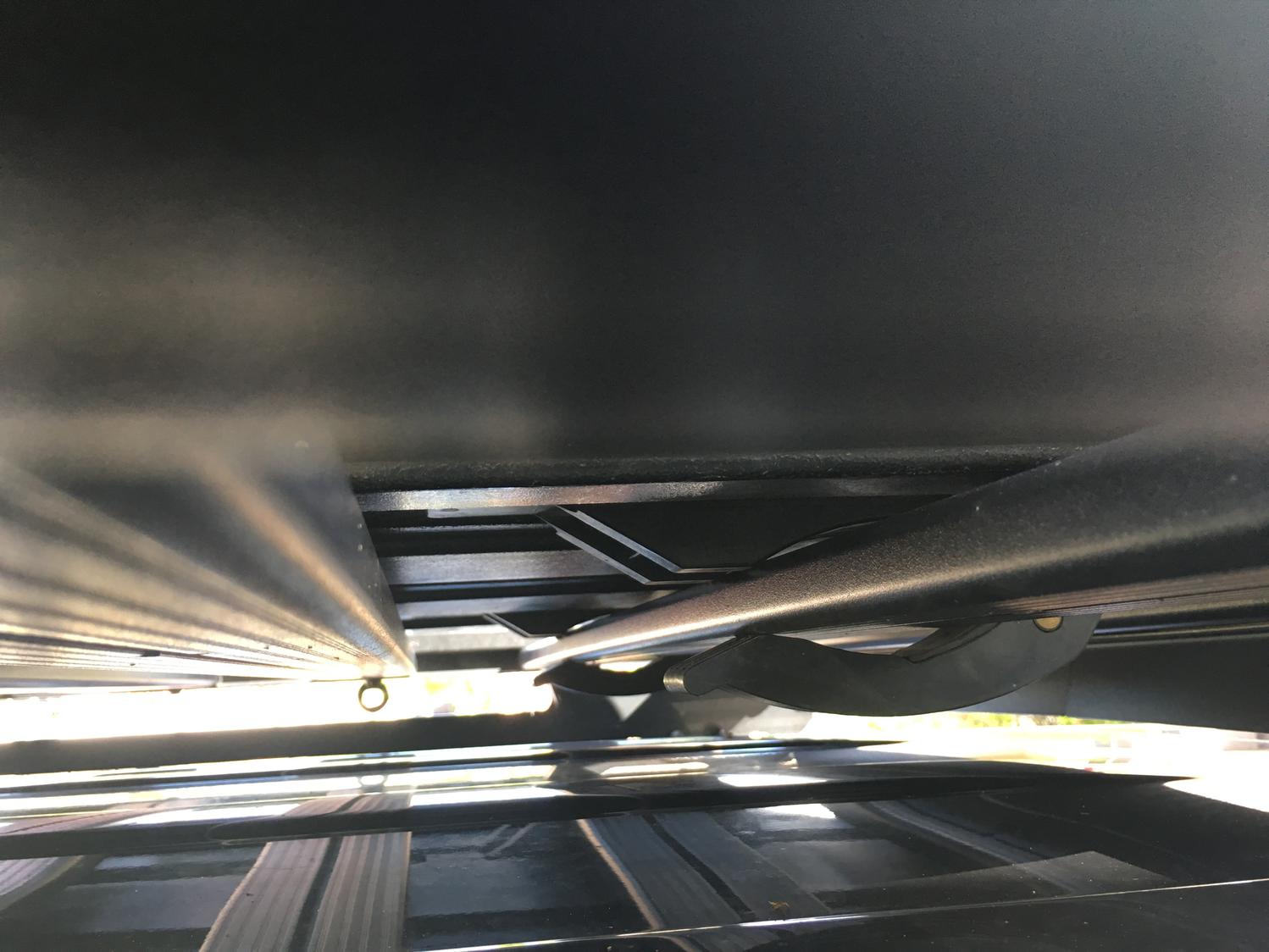

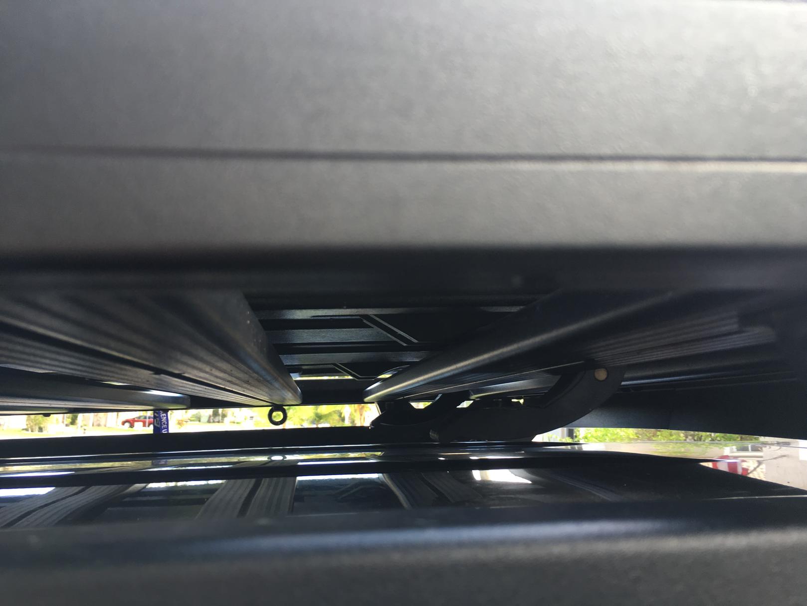

This is what they look like fully clamped. You can see they they don’t wrap all the way around but are completely tight (I can push and pull on the skybox moving the whole car without it budging). I’ve travelled thousands of miles with it, on and off-road and never had issues.

Thanks man, i appreciate the follow up and the photos. I have the biggest skybox, so i would be afraid of it coming off in high winds or fast breaking situations. The fact that it doesn't clamp all the way around the bars seems unsafe. But i will take your word that it fastens securely. So no issues at all?
thank you
thank you
None. Driven cross country (California-Maryland-Florida), up to Maryland several times a year and up to Vermont for Skiing every winter (all from South Florida), traveling I95 averaging 75+ mph. Taken it off roading, fully loaded with camping gear and not a budge.
Edit: I do tighten the the screws that adjust the clamps to the point where you can barely lock the clamps down...super tight).

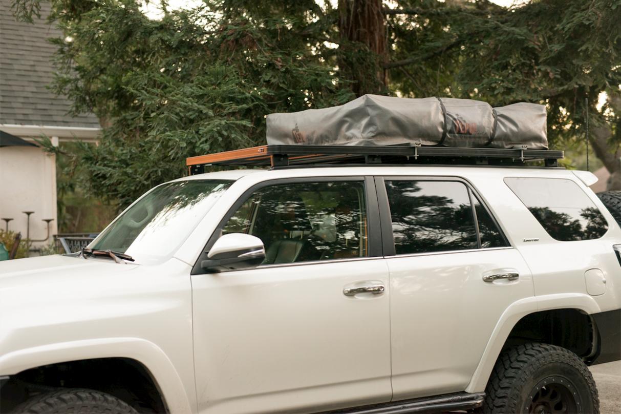

Installed one this week, took a bit of time to fashion some spacers but it all went together nicely. Thanks to Front Runner and [MENTION=77370]Gabex35[/MENTION] for the assistance. This is with 3x 40mm feet and 1x pair of 50mm.
My table fits but contacts the top of the low-pro antenna which I was prepared for. Some spacers for the rear should clearance it, I can update with a solution if anyone is interested.
For some reason I'm getting an error when trying to load photos.. anyone else having an issue there?
Edit: got the image to upload, weird.
