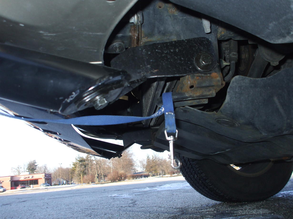

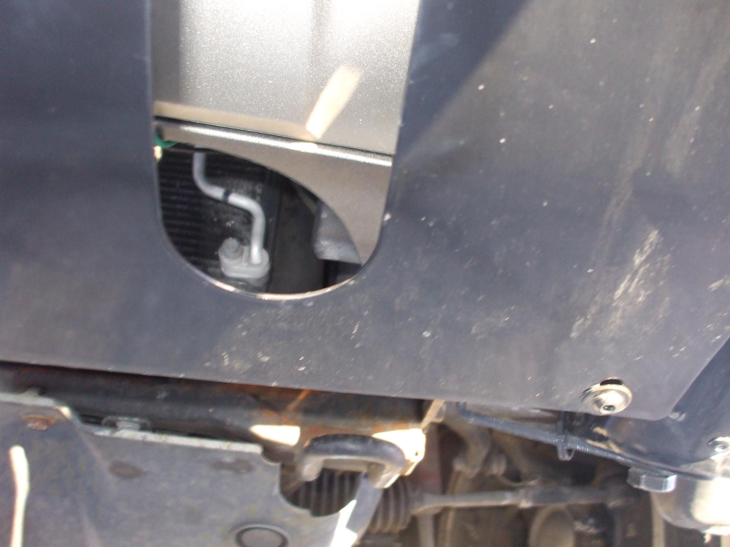

OK...I got the Steelcraft which is a little bigger (wider) than the Westin, Aries, etc etc...and didn't need to remove the tow hooks for installation
Some pics to give u an idea how it would be if need to tow the 4runner. Now...the Steelcraft bull bar skid plate is removable and thats a plus.

JAC, please tell me this isn't how you walk your dog.
ha ha ha..I knew someone was gonna say something..LMAO
I just used it like and example I didn' t have anything else available at the moment to take the pic....so I used what was handy so the person who asked get the view.
I think is funny..it looks like I was taking my runner for a walk... he he
Thanks for the observation tho'.!...:lol:
