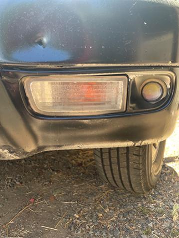

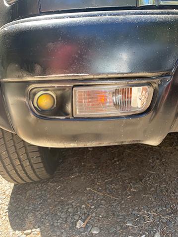

Hi 4Runner enthusiasts,
I'm struggling to find a front (in the bumper) RH turn signal part # for a 1998 Limited with Factory fog lights. All the searches that I come up with carry the turn signal without fogs. The lenses on the turn signals are clear (with fog) v. amber on the non-fogs. Any help would be greatly appreciated.

I have a 2000 LTD with (separate, round) fogs. Not sure how that affects the turn signal's lens color (many people seem to buy clear lenses on the aftermarket) but a picture would help. I ask because I may have a set of spares after a bumper swap soon....
It's hard to tell but it doesn't seem like the right shape...

That picture is from a '99+ front bumper. You need '99-'01 front turn signals.
-Charlie
I believe Charlie is correct as the early years 96 -98 do not have fog lights like this. I have a 1997 5 speed with factory add on lights. They are in a totally different location.
