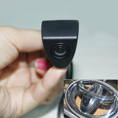

My camera is located just below the front emblem.
Front Camera for Toyota Emblem
http://www.ebay.com/itm/160874928117?_trksid=p5197.c0.m619
