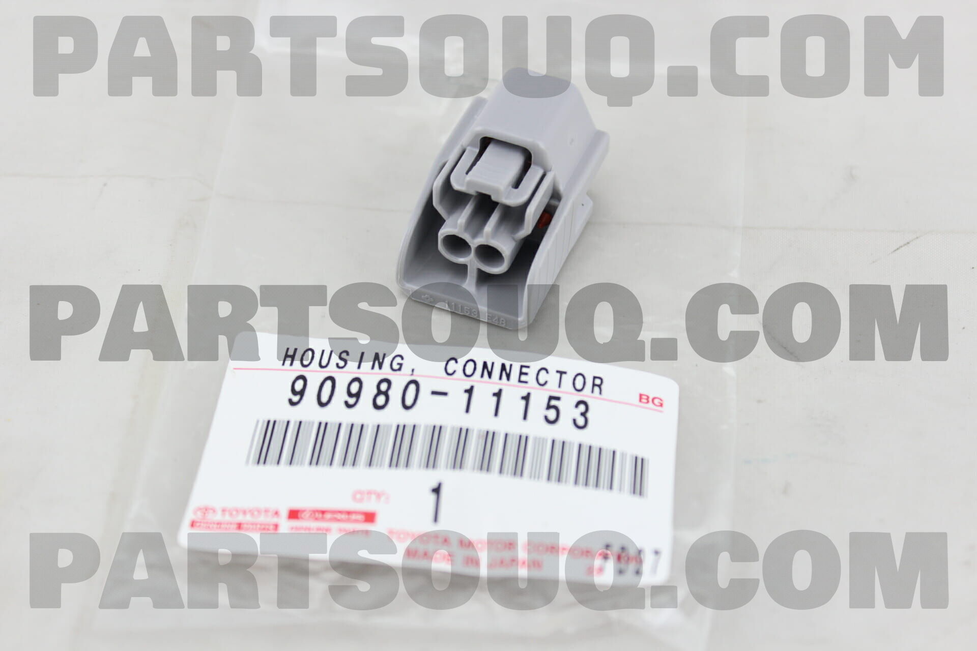

I think I learned the trick from [MENTION=10169]TheDurk[/MENTION] if you add 90980 before the part number printed on the connector you will find it in the parts search.
all of the connectors attached.
I know the connector for my 2000 but you will also need the wire parts.
you might want to consider something like this? they did all the hard work already and it's really what your after.
Toyota Fuel Injector Connector with wire pigtail - Kit-1079
