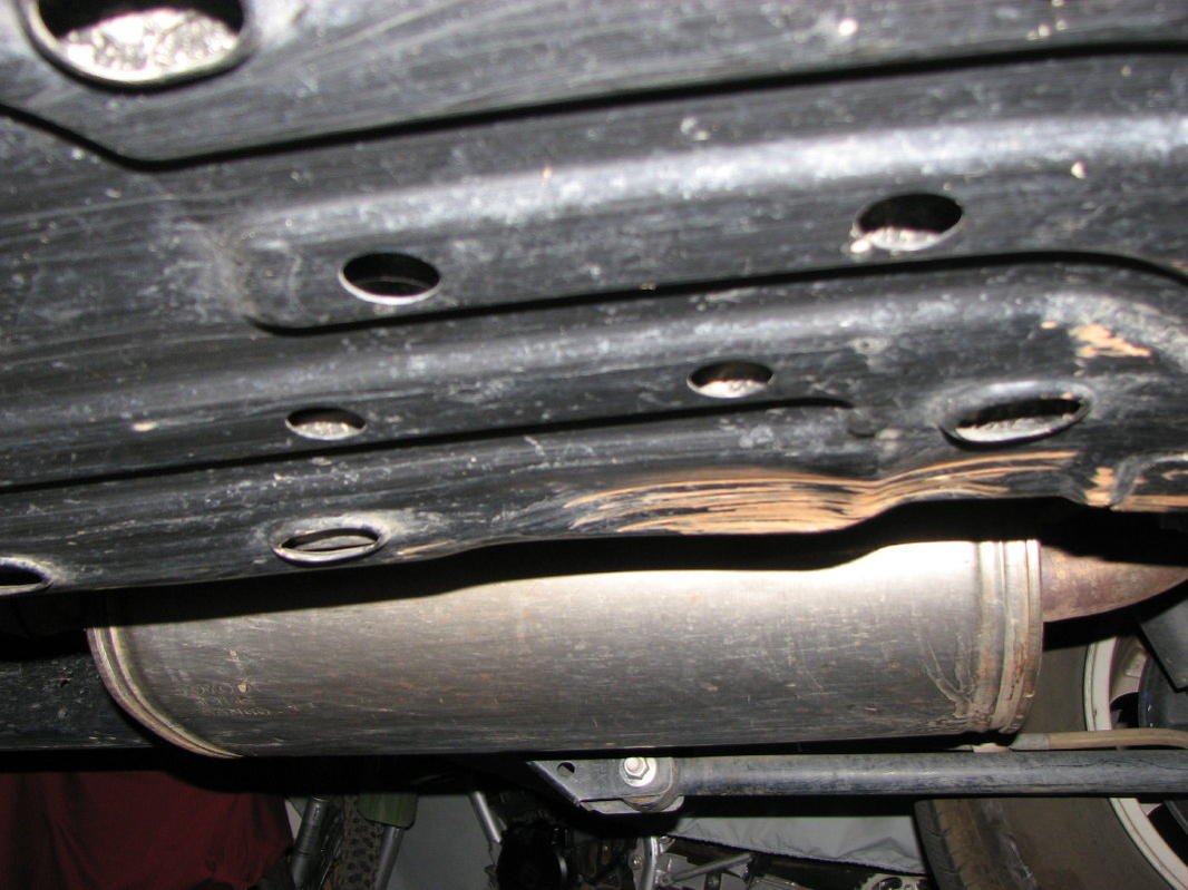

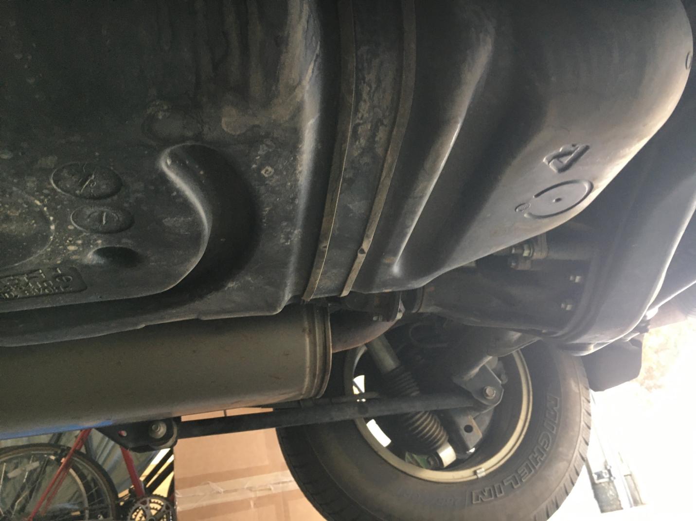

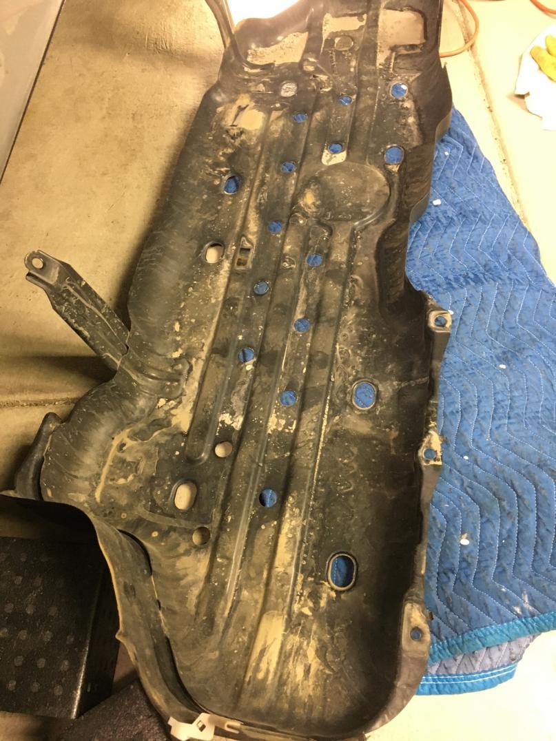

Get under there and take pics. Make sure you’ve got the two rear bolt holes and they’re tapped.
I took a couple pics when I removed mine for repair, maybe they can help a little.

thanks for this. the rear bolts are what I am most curious about - the point about them being tapped vs simply being there is something I would have probably overlooked. I'm pretty confident the first 4 at the front line up with the half skid. the first picture will help me. thanks

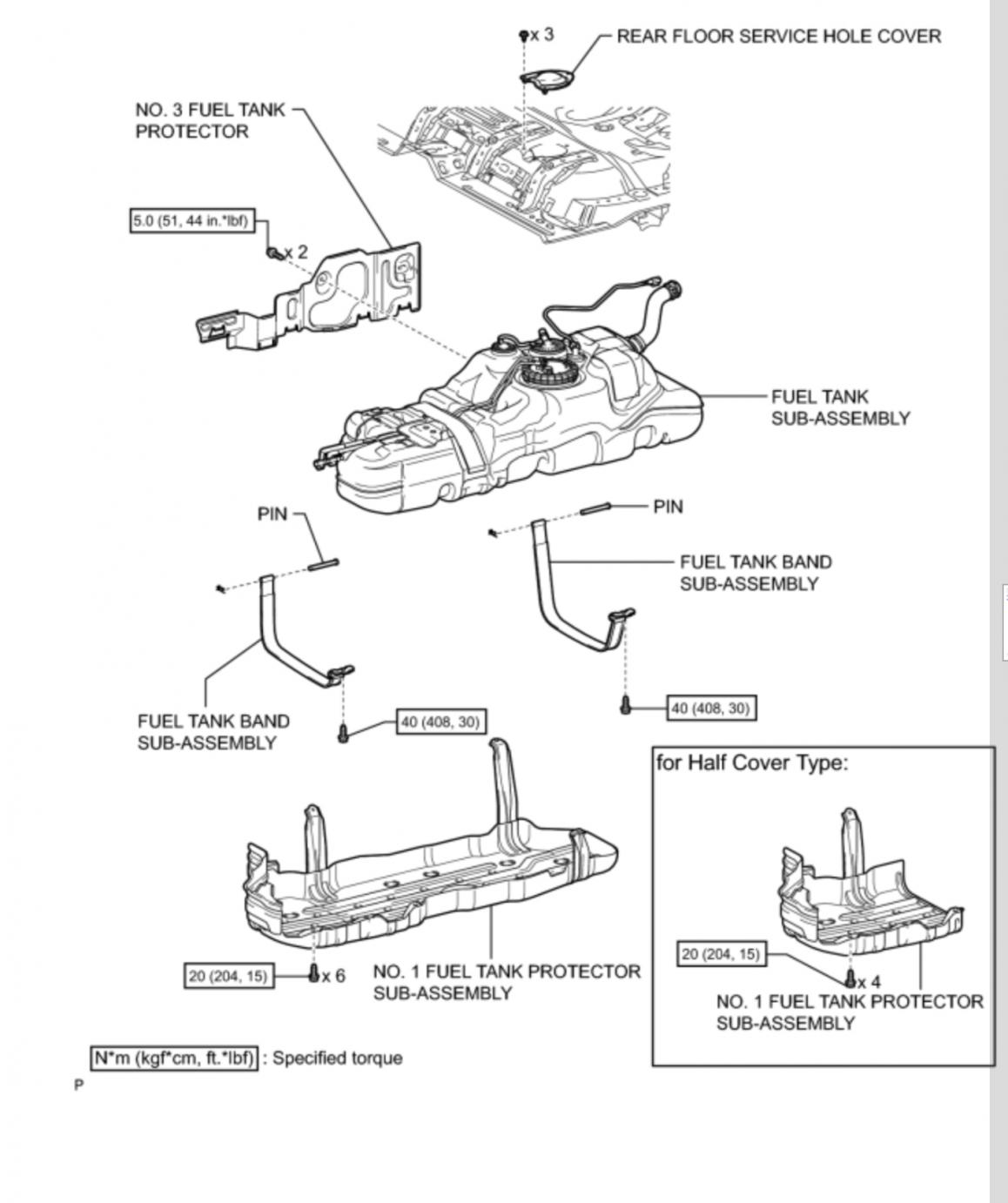

installed the full skid yesterday. for anyone else thinking about this one area of confusion I had was the bolt part number. P/N 90080-11373 are the screws you want, those are what I used (used them for the front skids too). M8-125x20mm stainless also will work as well (I tested them too). the P/N above does not show up as the standard screw when looking at the part diagram for the skid plate, a different part comes up. however, these bolts worked perfect. the skid plate # above for the full skid is what I ordered as well, careful not to break the plastic hose protector unless you order a new one when transferring
most people here will just order after market skids which there are some really great options. but anyone not living in the USA the full OEM skid that comes with the trail isn't a bad choice by any means for only a few hundred $, it's better than the half skid and much cheaper when you factor in shipping, taxes and duty than the aftermarkets
This is an old thread but the correct bolts for the fuel tank skid plate are…77644-60020.
6 needed for the full skid.
