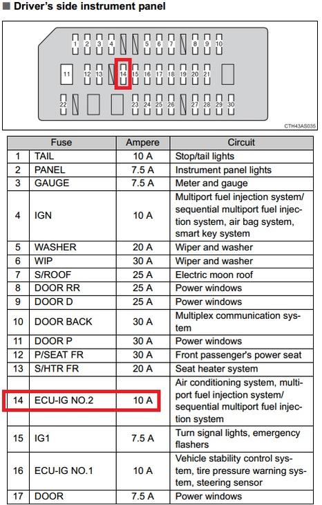

I was installing my radar detector using a mirror tap. I must have had the wires reversed and blew a fuse. Now I can't figure out which fuse it is. The climate control is off, so they must use the same fuse. Anyone know which this might be??
Oh what the heck, it's the holidays let me be more helpful than usual :)
Thanks, I thought I pulled all of those and checked them but I'm going to do it again. Possible that it's a relay? It seems the power windows button doesn't work either. I hope I really didn't screw something up.
