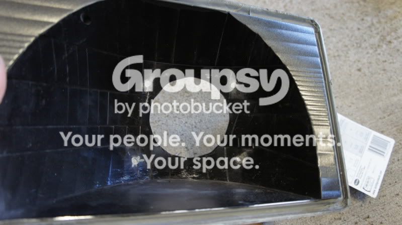

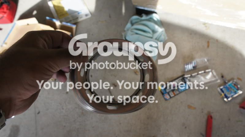

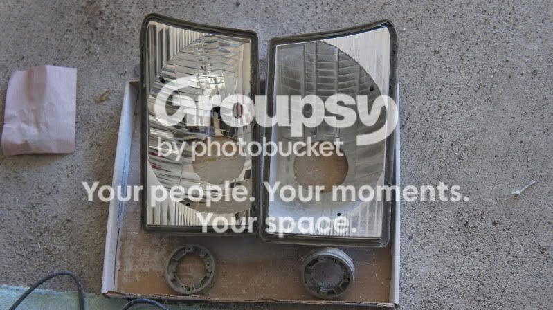

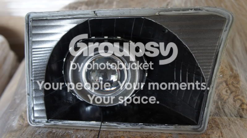

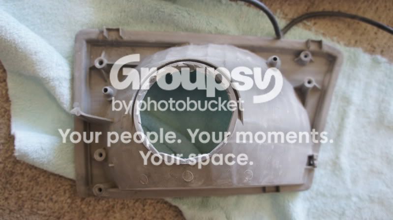

Okay so now that the glass lens and the headlamp are separated, we have to try to fit the projector into the headlamp. Many people use a circular drill but to cut a two-two and a half inch hole on the back where the bulb goes. However, I did not have such a bit but did have a dremel. So I basically cut alongside the base of the back of the bulb using single cuts. It looks like this:
DSC03119.jpg~original

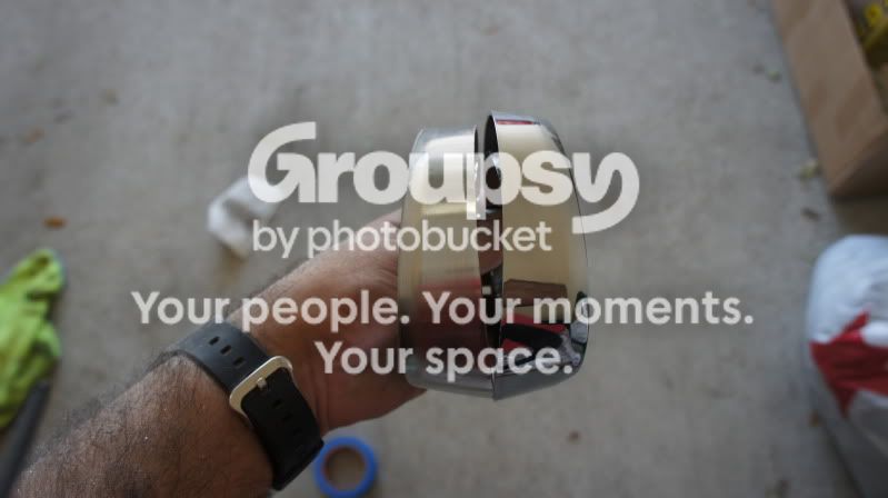

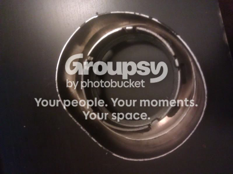

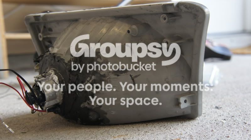

After I did this, I sanded the rough edges down using the sanding attachment for the dremel. Since I was sanding, I also sanded the inside of the headlamp housing. I had intentions to paint so now was a good time. I also sanded the shroud since this was going to be painted as well. This is a picture of the big hole in the back all cleaned up. Also note the right headlamp is sanded the and left isn’t. On the bottom of the picture, you can see the base of where the bulb used to go:
DSC03122.jpg~original

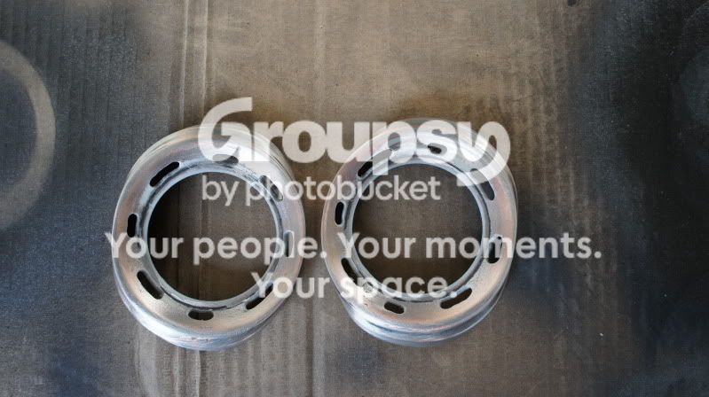

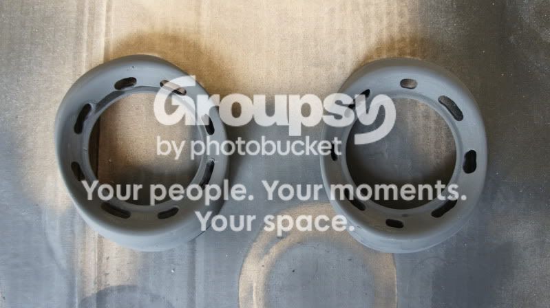

Picture of the shroud sanded. The left is sanded and the right is not.
DSC03123.jpg~original

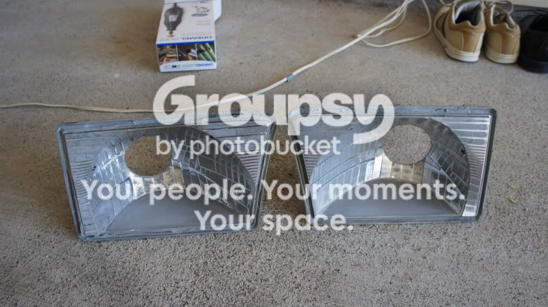

With both headlamps sanded all around:
DSC03124.jpg~original
Result of my watch after sanding for awhile:

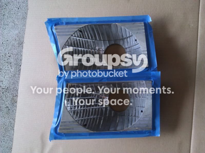

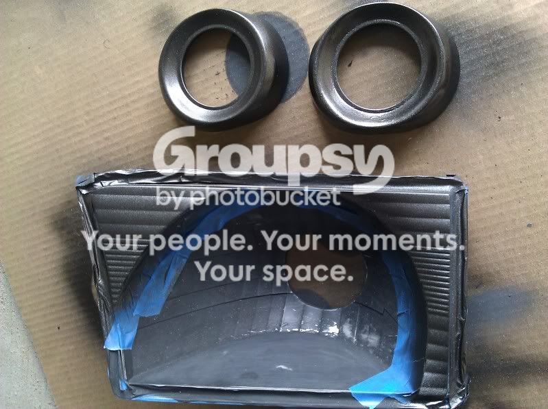

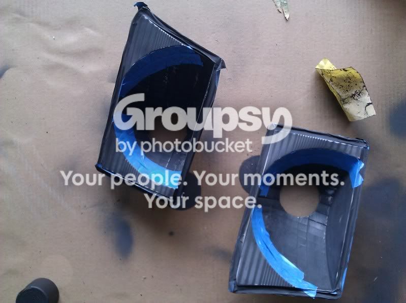

I then took some painters tape and outlined the edges of the lights (where the sealant was). Then I took automotive primer and primered both the housing and the shrouds (2 coats):
IMG_20110318_124151.jpg~original

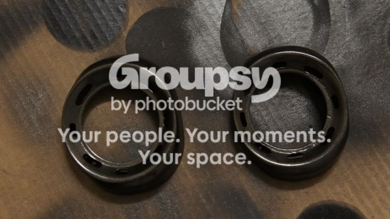

Then I sanded the primered headlamps and taped out the inside of the housing. I wanted the trim of the headlamps to be a different color and what used to be the reflective housing a different color. So I decided to paint the trim first and taped the reflective portion of the housing:
IMG_20110318_151552.jpg~original

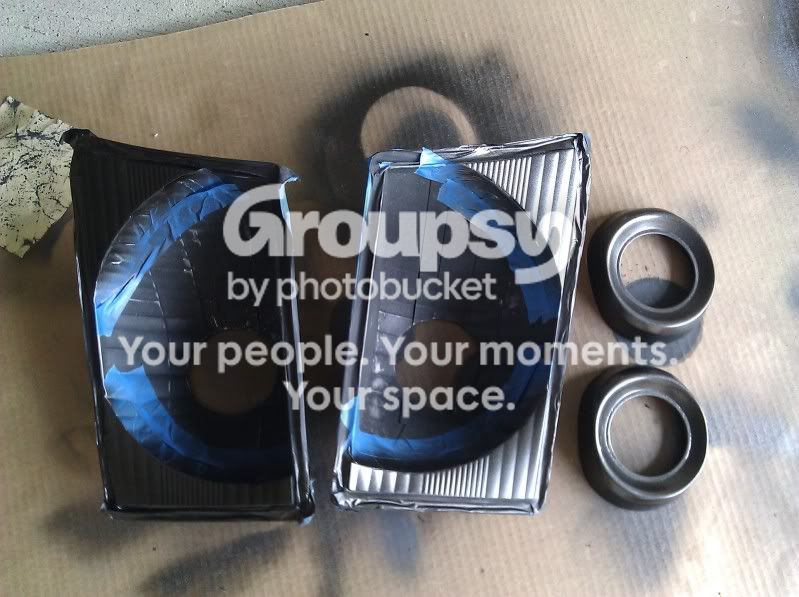

Here is a picture of the outside trim of the headlamp and the shrouds painted. I used automotive wheel metallic paint (I did 3 coats of this metallic paint). It is the same paint I used to paint my grill when I did the satoshi grill mod. Note the reflective portion of the headlight still only has been primered:
IMG_20110318_160448.jpg~original
In this picture, the left headlamp only has been primered whereas the right headlamp has the trim painted metallic gunmetal/silver:
IMG_20110318_160439.jpg~original

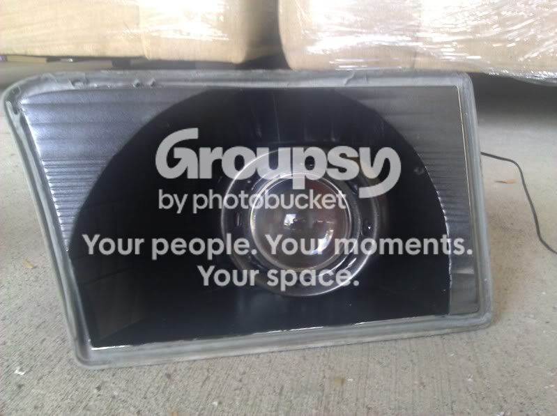

After two hours, I then taped up the trim of the headlamps (where there is metallic paint) so I could paint the reflective portion of the housing. I decided to use flat black wheel paint. Sorry but I forgot to take a picture of this part.
*** note, if I were to do this retrofit again (Which I won’t!), I would paint the housing after I drilled the holes to where to mount my projectors. As the picture below shows, that area gets super messy and dirty so might as well wait and paint all this when you know for SURE where the projector is going:
DSC03254.jpg~original

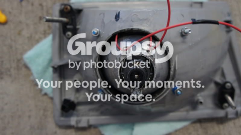

Now you have to decide where exactly you will be drilling four holes to mount the projector. Follow the rule: Measure 10 times, drill once (I exaggerate because it IS that important –otherwise your cutoff will be fudged). This is where I drilled my holes, I used a dremel bit to drill the holes because my drill was out of battery and I wanted to get as much done as possible while I was down in my garage:

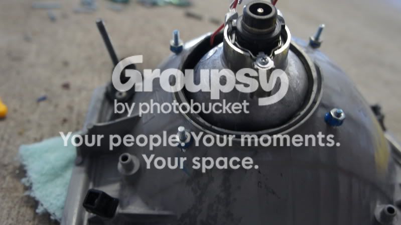

It would be smart to remove your nonretrofit headlights from your 4runner and place the current ones (the ones you are working on) in their place to just get an idea of where the projectors should mount. For each light, since this is a very important step, I did attach the headlamp to the black housing each time I wanted to check the alignment. I attached them together at all four anchors mentioned in the beginning of this write-up. I didn’t want to be lazy and only attach by the white knobs because this might affect the cutoff later. Be sure to wire the projectors so you could see the cutoff (I only connected the low beam and not the high beam). Use a sharpie to mark the areas (4) where you will drill. Align the projector with the holes and measure again. Repeat until you are certain the holes are correct. Then drill away – four holes for each headlamp.

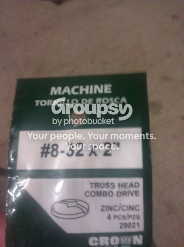

I used a total of 8 #8-32 x 2inch screws and a box of their respective nuts and washers. You will really only need 16 nuts and 8 washers but I bought more just in case. I also bought an extra packet of the screws just incase. You can return them later as long as you don’t open them (if you really wanted to). Here is a picture of the screws:

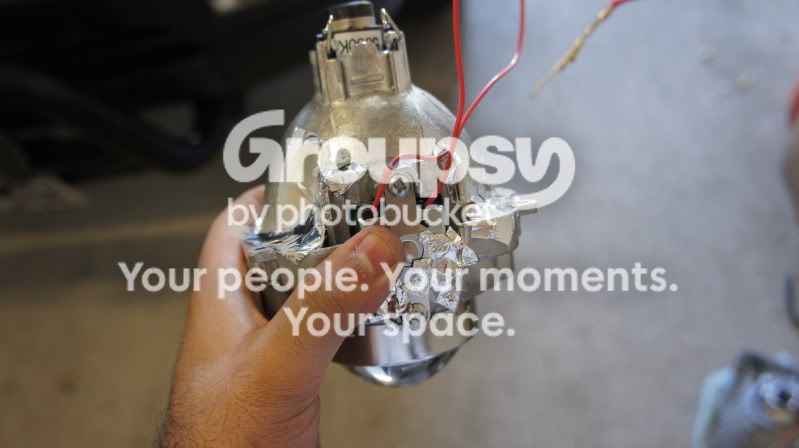

Projector aluminum taped up:
DSC03251.jpg~original
Without taping up the projector the light escapes into the housing:
DSC03259.jpg~original
By taping up the projector, the final product looks better with no light bleeding:
DSC03260.jpg~original

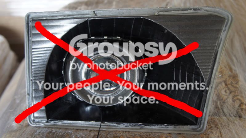

Now since this write-up is entitled “as experienced by SQ.MD”…I shall explain how I made this entire project almost look horrendous by my “innovative” uses of LEDs. I always liked LEDs but didn’t want to opt for a halo ring because I think it looks funny (to each his own, right?) I wanted something different so I decided to put LEDs around my shroud. In my mind, I thought it would look awesome. However after I put them around the shroud and EVEN JB-WELDED it all, since the LED strip was not flexible and would not remain wrapped around the shroud by its own adhesive backing, I realized it looked like crap! I was sooo pissed! Here is what I was pissed about:
DSC03267.jpg~original
DSC03268.jpg~original
I was so pissed, I stopped working on this for a few days! I was so mad, I bought myself an iPad 2 and waited in line for 5 hours:

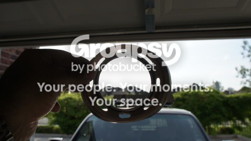

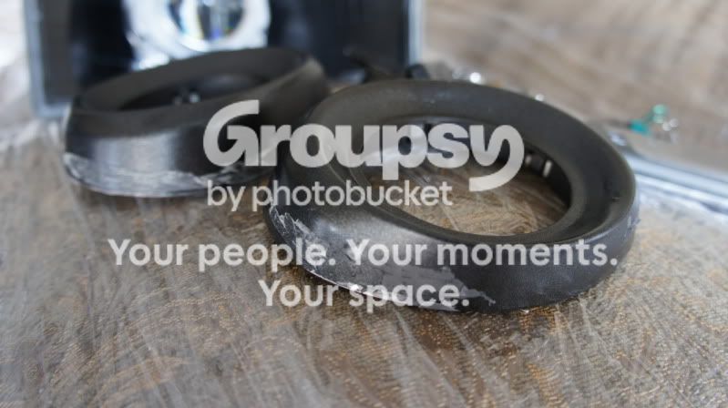

I then used a dremel to cut holes along the border of the shroud. My plan was to place my LED strip inside the shroud and have the light escape these cut out ovals & elongated ovals. All this was done using a simple bit on my dremel (the same bit I used to create holes to put the screws/bolts through from the projector). This is what it looked like:
DSC03271.jpg~original
DSC03272.jpg~original
I then sanded everything down again:
DSC03274.jpg~original
Primered and then sanded again:
DSC03275.jpg~original
And Finally painted (for the freakin’ second time!):
DSC03276.jpg~original

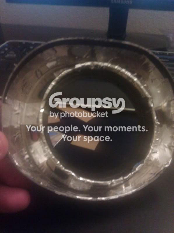

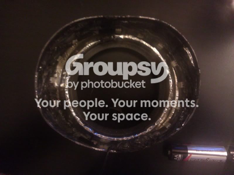

I let all that dry and the next day, I began my LED placement. This is a picture of the inside of the shroud:
IMG_20110323_000656.jpg~original

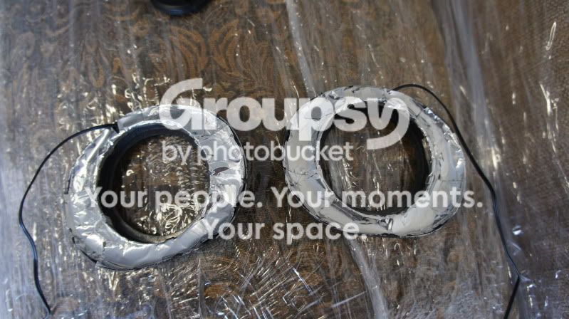

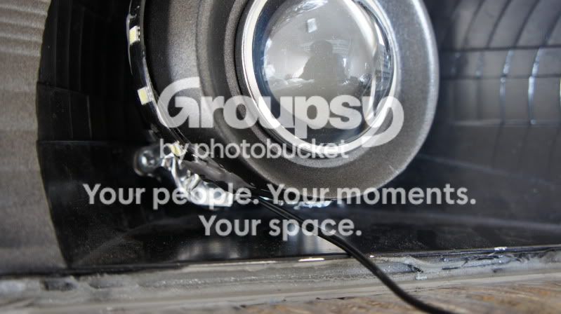

I put aluminum foil tape along the inside to reflect all the light:
IMG_20110323_014141.jpg~original
I then placed the LED in and used RSV ultra black silicone to keep it in place:
IMG_20110323_022643.jpg~original
Then I let all that settle/harden and then put Aluminum reflective tape on the back to decrease any LED light escaping:
DSC03278.jpg~original
Then I placed the shroud back on. To keep the shroud in place I wrapped some aluminum tape around the projecting edge of the projector. This gave the shroud a more snug fit. I also used some silicone on the inner edge of the shroud just incase. With it all in place, it looked amazing:
IMG_20110323_114022.jpg~original
Way better than this:
DSC03267-1.jpg~original

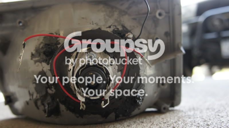

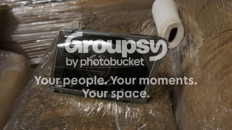

I then began to think about sealing the lights. Since I wanted to seal the headlamp assembly tight, I used ultra black RSV silicone. I first tried using JB-Weld, but I felt like it was to runny and wouldn’t stay. So I definitely recommend ultra black silicone. I sealed the four holes that I drilled (the ones with the nut/washer) and also sealed the gaps inbetween the projector and the headlamp. I had some huge gaps so it required some creativity in getting them all filled. After the silicone began to settle, I used some cardboard to smooth it out and not make it look all globby around the projector. Be sure to not let your red high beam wires or LED wires get stuck to the silicone! Here is a picture:
DSC03282.jpg~original
DSC03283.jpg~original
I let all this settle/harden for 24 hours.
Now it was time to close everything all up and put the clear glass lens back on the headlamp. I decided to not use the oven (since I didn’t want to melt the LED strip) and instead used a regular hair dryer. I had it on high heat and began melting the gray silicone around the glass lens. I would touch it occasionally to see how soft it was. Then I did the same to the headlamp. I spent about 5-8 minutes doing this on each light before I felt it was melted enough to adhere appropriately. I then put the two together and squished it all really hard. If some portions didn’t fit super tight, I directed some heat in that either until I could squeeze the two sides together. Once the fit was good, I placed the four metal clips (which were in my sandwich bags I created when I first started this project) back on. This is what the retrofit looked like at that point:
DSC03318.jpg~original

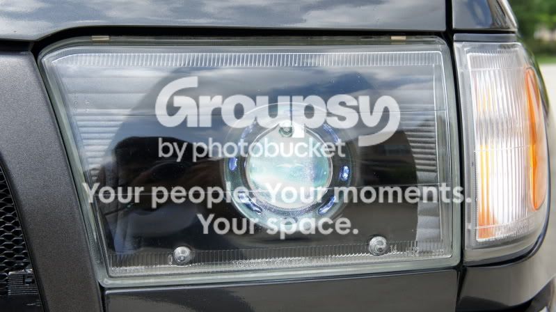

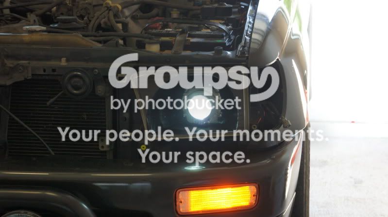

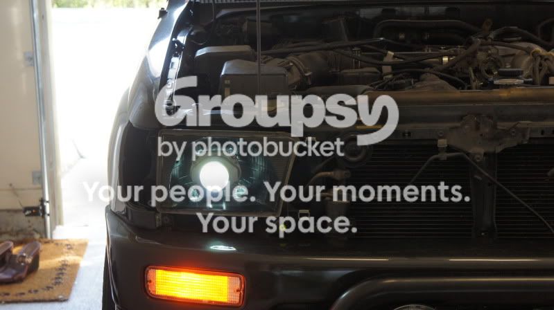

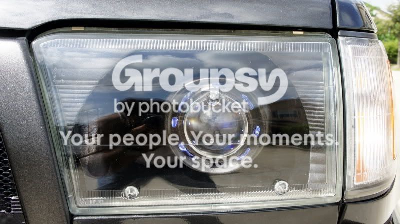

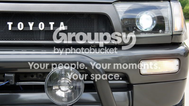

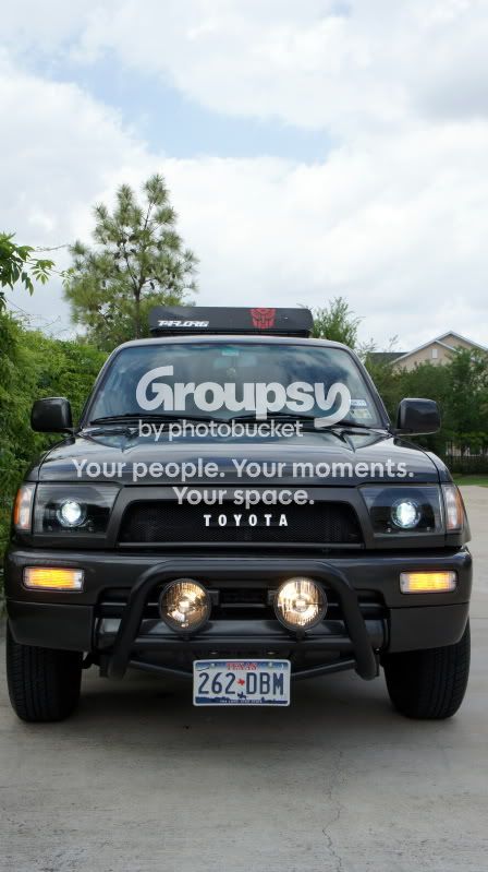

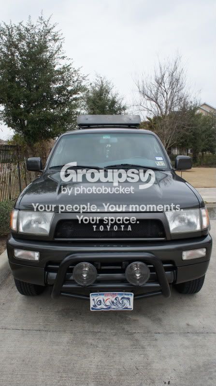

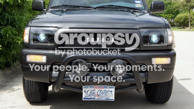

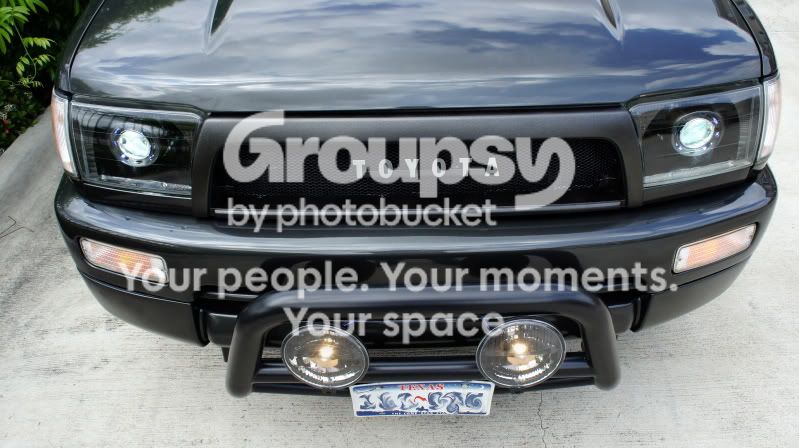

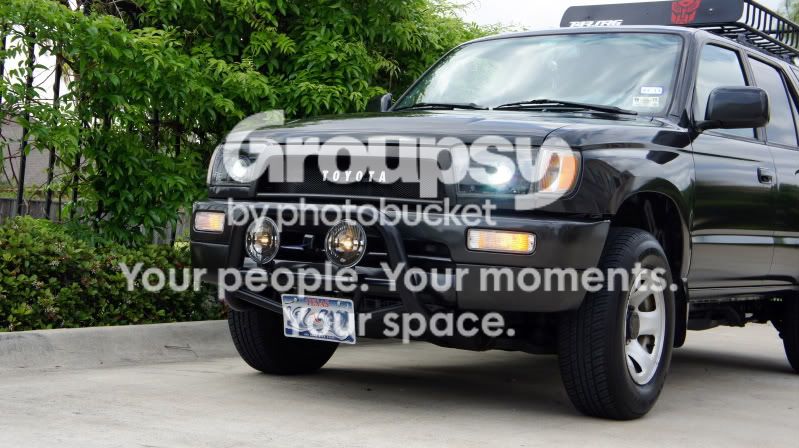

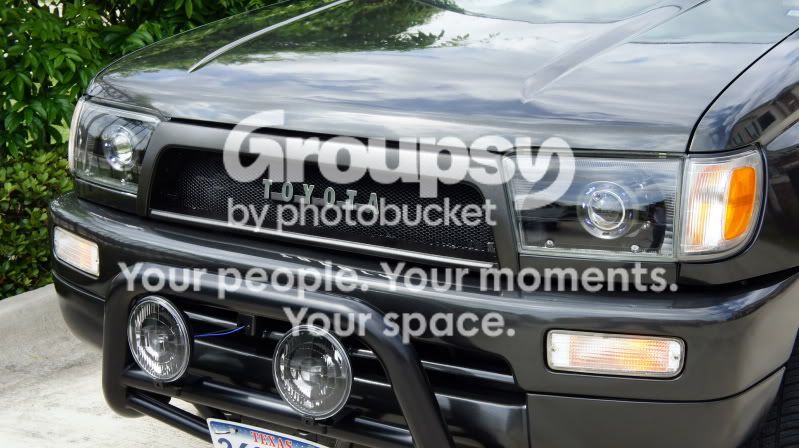

The next day, I took my 97 hazy headlights off my 4runner and put these babies in! This project was definitely worth it. I had to do some serious headlight aiming but I had gotten the hard part done.
From this:
DSC02809.jpg~original
To this:
DSC03369.jpg~original

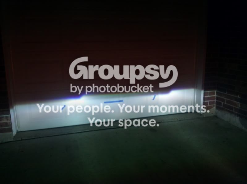

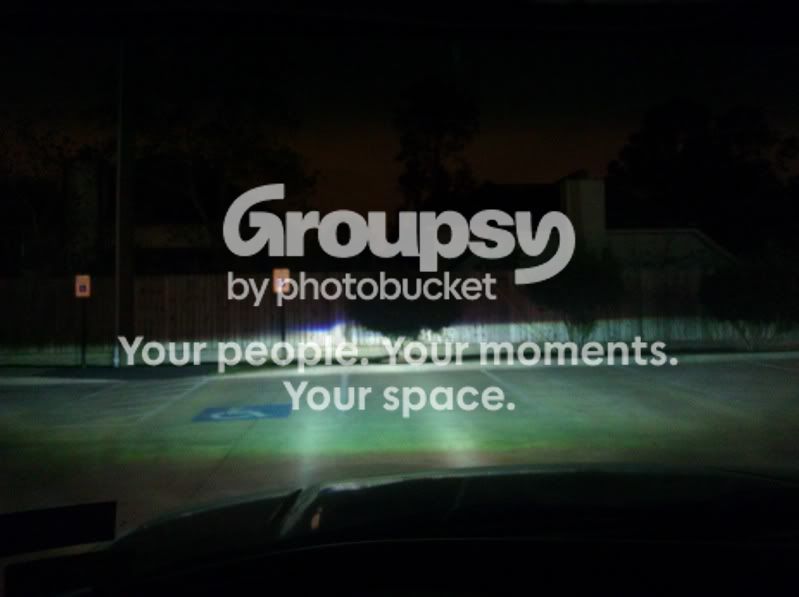

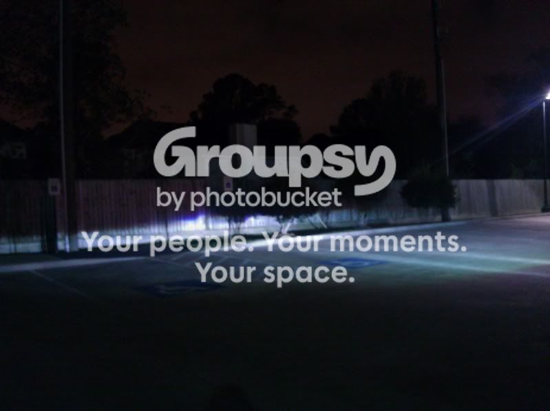

Cutoff (not completely aligned but you get the point):
IMG_20110324_224834.jpg~original
25ft+ away:
IMG_20110324_225311.jpg~original
Light spread:
IMG_20110324_225205.jpg~original

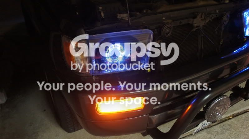

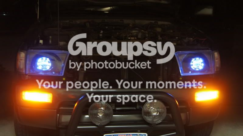

LEDs come on with daytime running lights:
DSC03329.jpg~original
DSC03332.jpg~original
