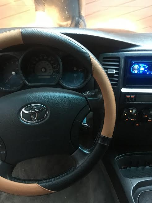

Instrument Cluster Not Working Following Radio Install
Purchased an '03 Limited two days ago. Have been tuning it up before a cross-country trip back to school in two days.
Took apart the dash and installed my own radio. Radio works perfectly. Also painted dash with black truck bed liner. Looks awesome.
I put the dash all back together and turned on the car to find that the instrument cluster was not working. No lights, no odometer, no movement of the gauge hands.
Was there a wire cluster I did not connect again?
When I took the dash apart, I did not go past the instrument cluster.
All the lights work, the turn signals work, the radio works, etc. I checked fuses and spun the dash light. The problem is that the entire instrument cluster doesn't function.
I've attached an image. Let me know what y'all think!

Cluster dead
Having the same issue here, check engine light is on though but no speedo, tach, temp, etc. Anyone have any luck solving this? Is it the cluster itself? Any help would be appreciated... Just in the middle of troubleshooting and is a bit of a mystery. Fuses all good well.
Cheers

So has anyone found a solution for this problem? Meaning, do we know the root cause of the problem and what the correct fix is?
I recently bought an '04 4Runner and it just started having a similar problem this past weekend. I noticed both the tachometer and the gas gauge stopped working.... but it's intermittent. Usually if I turn the car to the on position and this problem is happening, I can simply turn the car off and on again a few times and they will start working again. I'm pretty sure they will eventually be completely dead. Yeah thats an annoying workaround.... but I really want to fix this rather than deal with anything annoying or kludgy.
I'm hesitant to buy a used cluster from eBay or from a junkyard since that cluster may also exhibit this problem at some point as well.
Also, since the links to the service manuals are no longer working (even using the way back machine) I am unable to use them to troubleshoot the problem. I'll most likely end up buying the service manuals if I can't find the pdfs online somewhere... but just don't want to lay out a few hundred bucks right now to pick them up (or even the $10 - $15 bucks on Toyota's site for a couple of days of use).
I noticed that there is a ad on eBay for someone who offers a service to fix your existing cluster... so it seems like the info to handle this is out there somewhere..... however they want $100 to "fix" the problem though they don't guarantee it will be fixed when they ship the cluster back to you. Not a great option.

Just wanted to add that I went this route and spent the $109 + shipping to send my gauge cluster out to Tanin Auto Electronix and I've had it back and installed for a few weeks now and it works perfectly.
