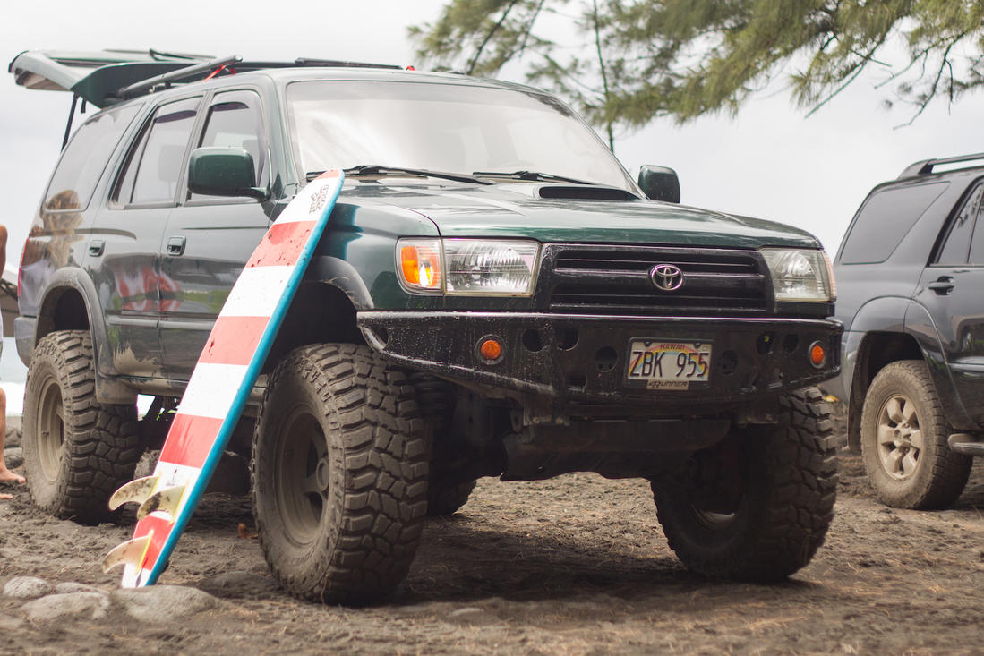

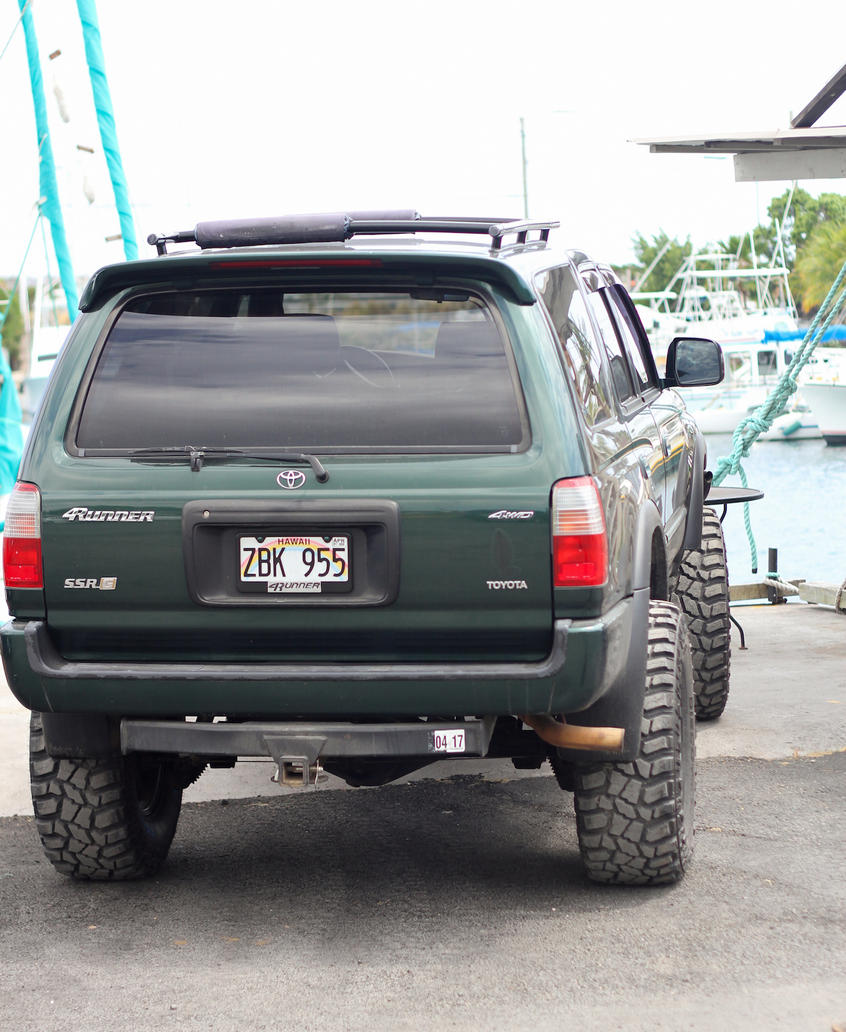

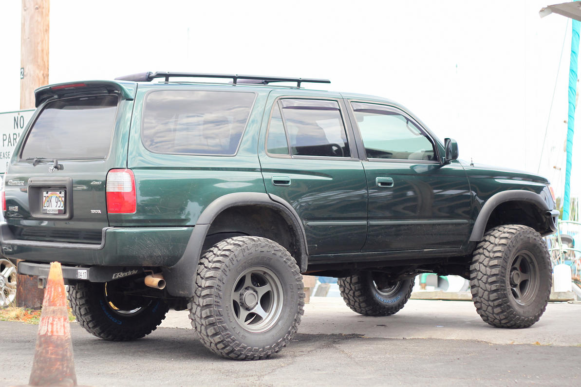

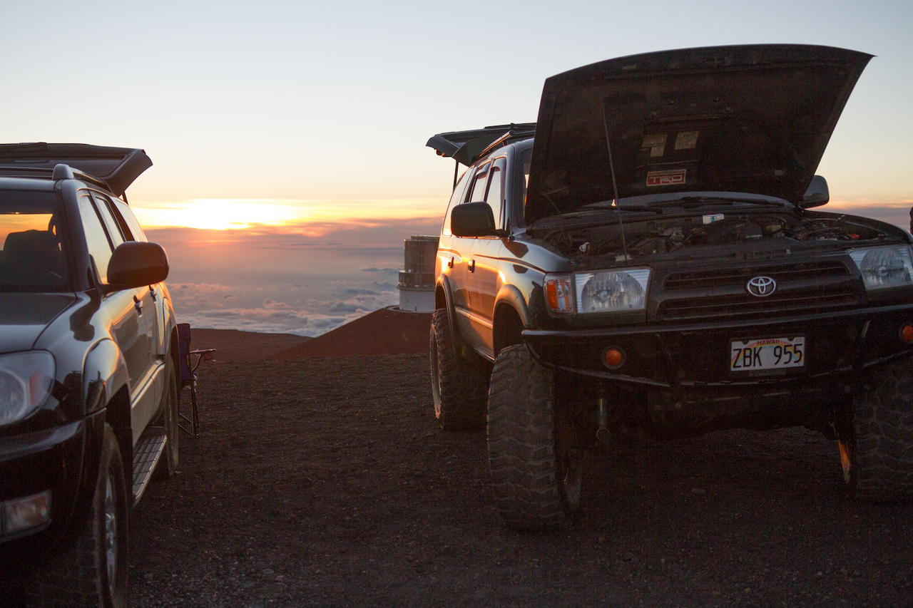

Just hit 200k miles, so some celebration shots
Great looking truck! Did the 305's fit in there with out rubbing? Do you have a body lift?
Thanks, ya they barely fit, the front required a little grinding off the plastic in the rear of the wheel well but that is it, other then that they fit great... although i have yet to test full flex - Im sure the rear will rub a little. As of right now very minimal rubbing
Sweet Rig Kanaka!
Excellent shop too. Top class welder on duty.
Islands may be small, but run deep and way high.
Mahalos, really appreciate it!

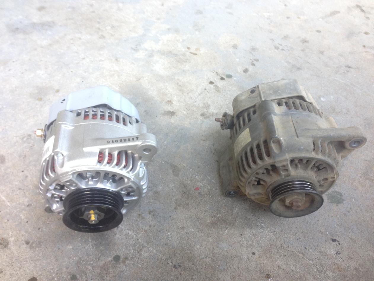

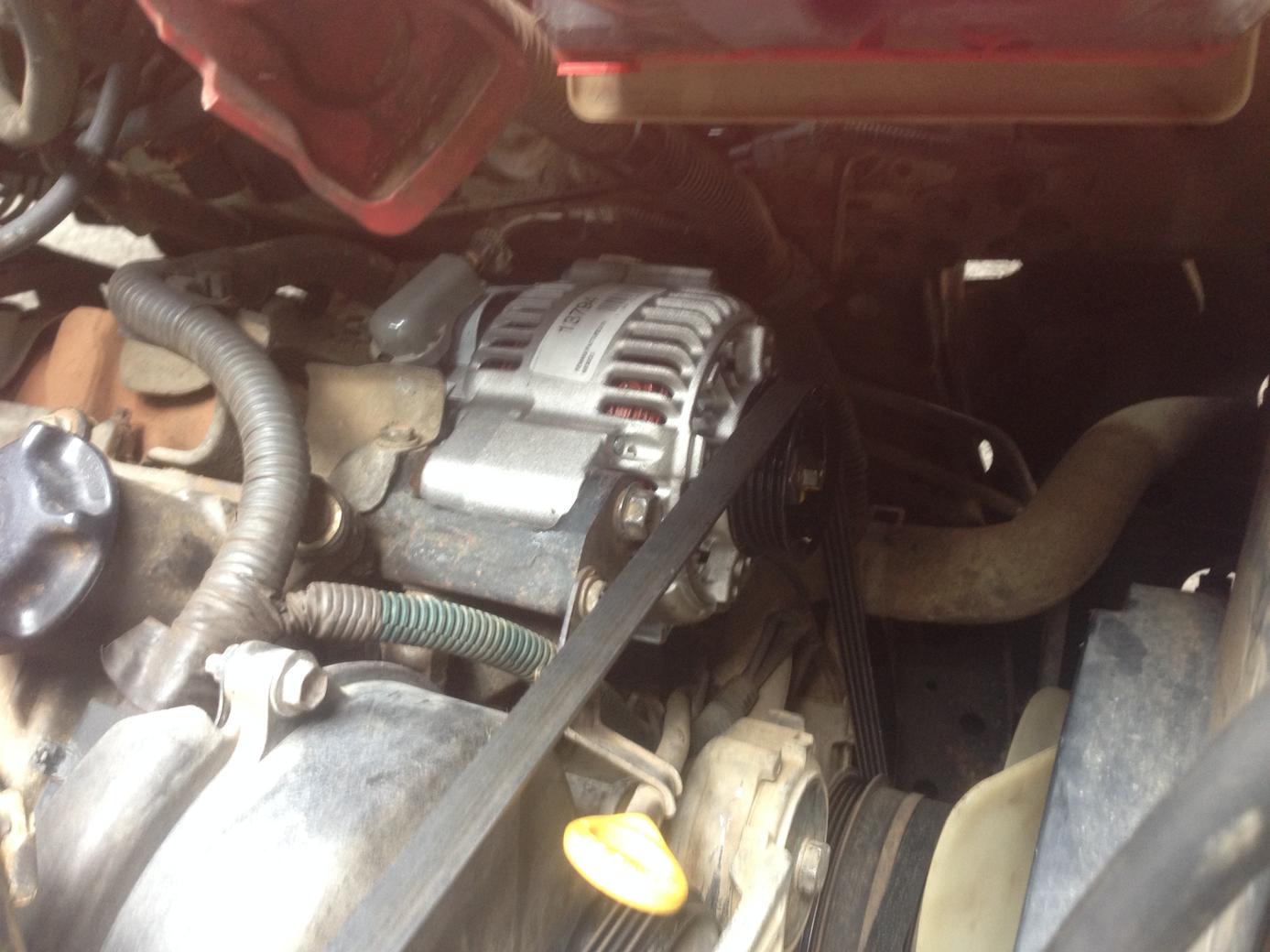

Few days ago my battery light turned on and of course it was the day before I was finally supposed to go on some missions.
So got a new alternator and replaced it, much easier job then I expected. I should really get a capacitor for my sounds...
Old Vs. New

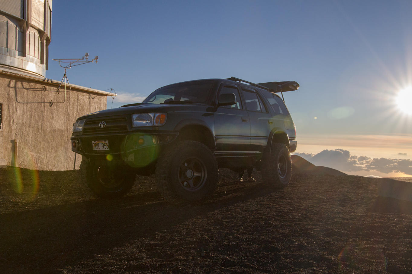

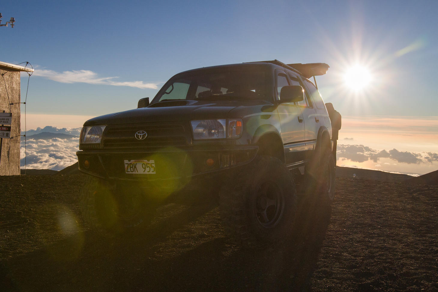

Got a couple days off with my friends and family so we went up to Mauna Kea (14,000 ft. elevation) and then the next day went down to the valleys.

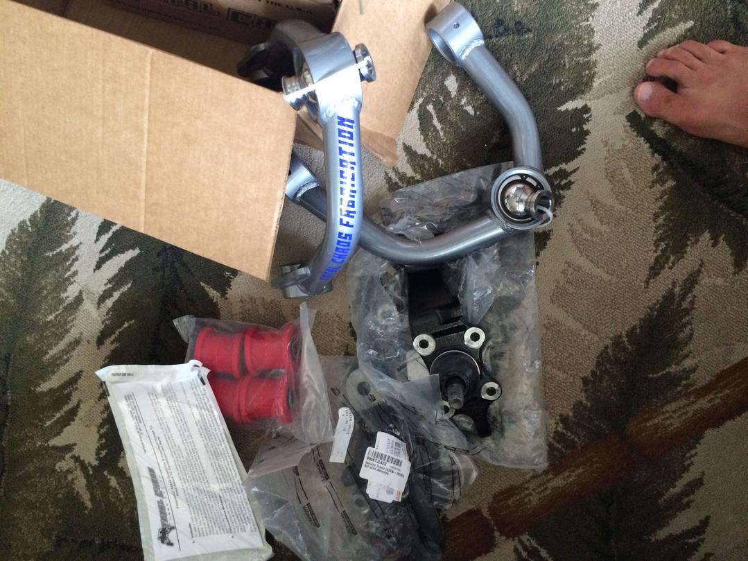

My ball joints have been shot for who knows how long. Just ordered a pair of LBJ's and Total Chaos UCA's with uni-ball.
Just got these dropped off, gonna try throw everything in tomorrow

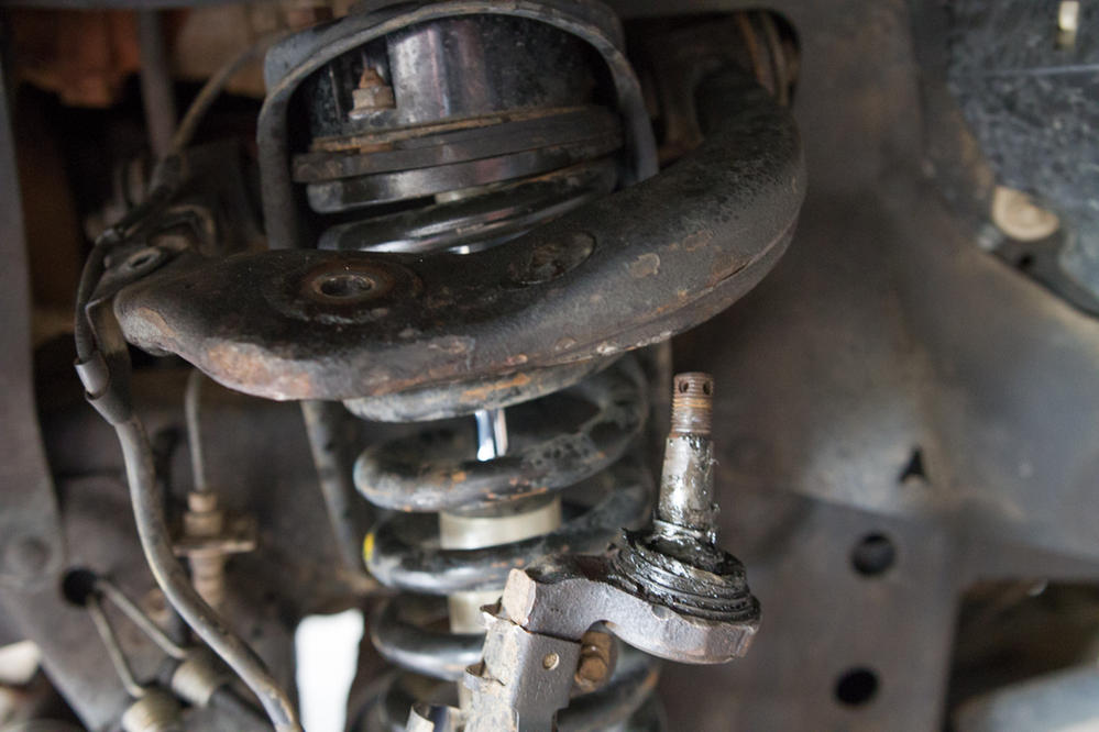

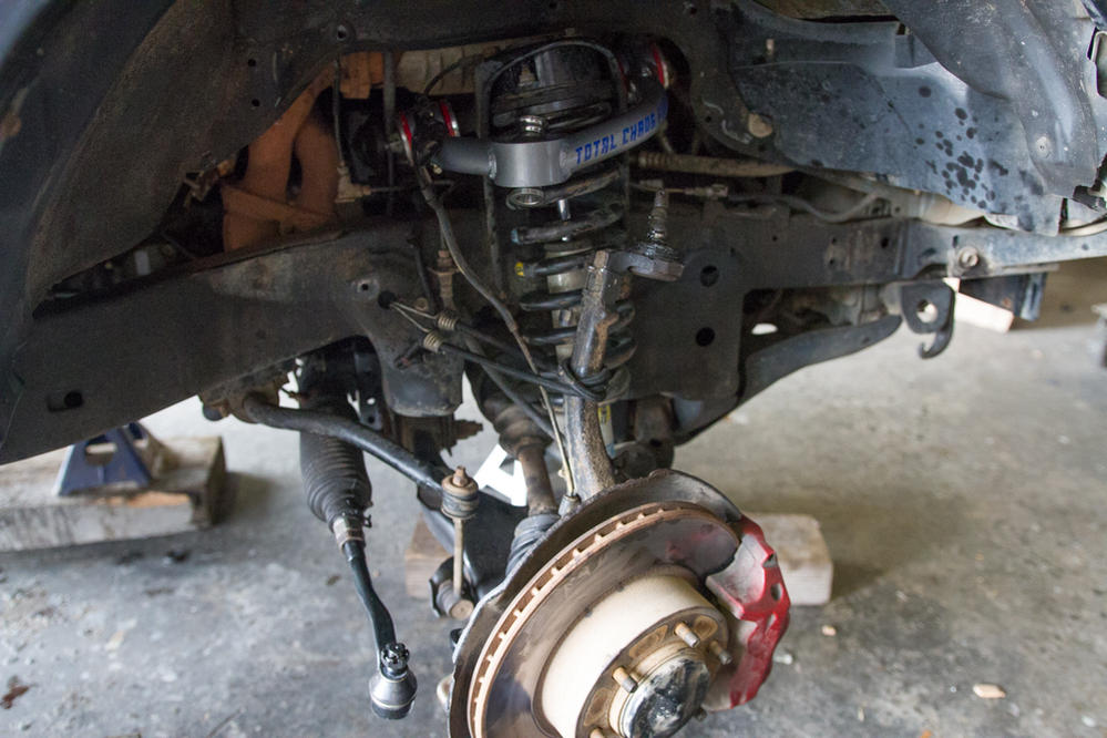

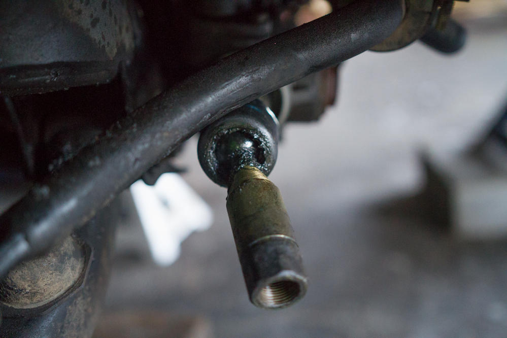

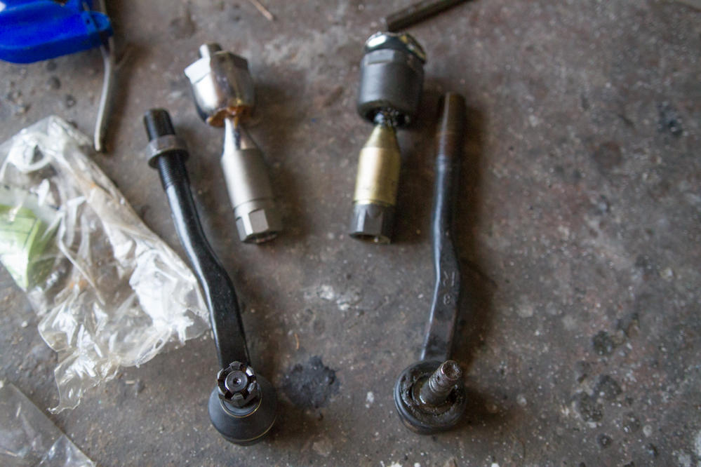

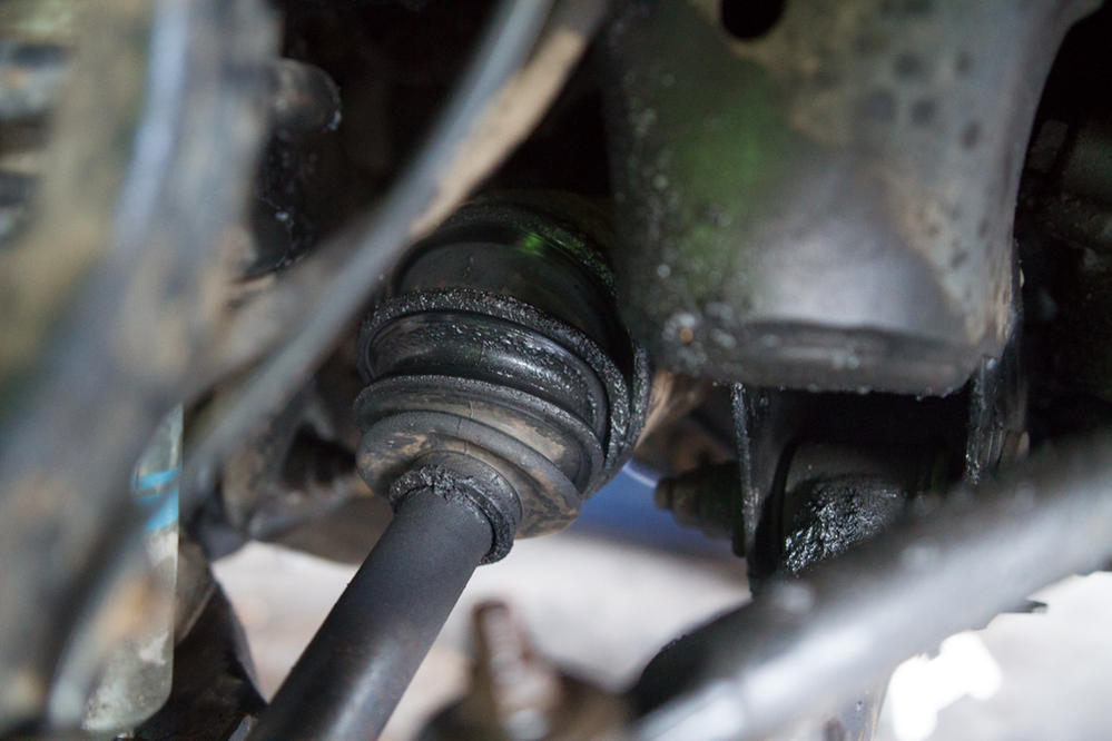

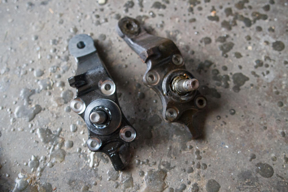

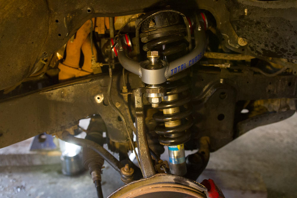

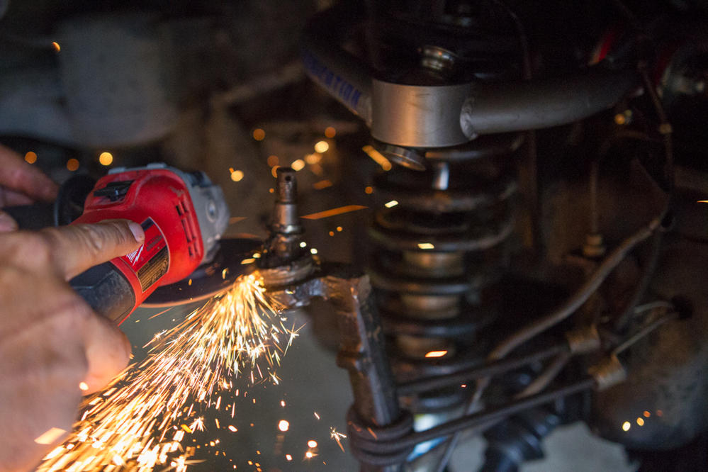

For the past few months my suspension has been making far too many knocking and squeaking noises. My upper ball joints have been shot for a while now especially with the angle from the lift. So I put in Total Chaos Uni-ball UCA's to eliminate the worry of upper bj's, also replaced the LBJ's and inner and outer tie rods, along with the driver side CV axle.
Passenger OTR new vs. old
Passenger LBJ new vs. old
Passenger UBJ was toast
Passenger UCA, Tie rods and LBJ in
Passenger side all buttoned up
Driver CV and ITR were also toast
Had to cut the Driver UBJ off because it was extremely bent
