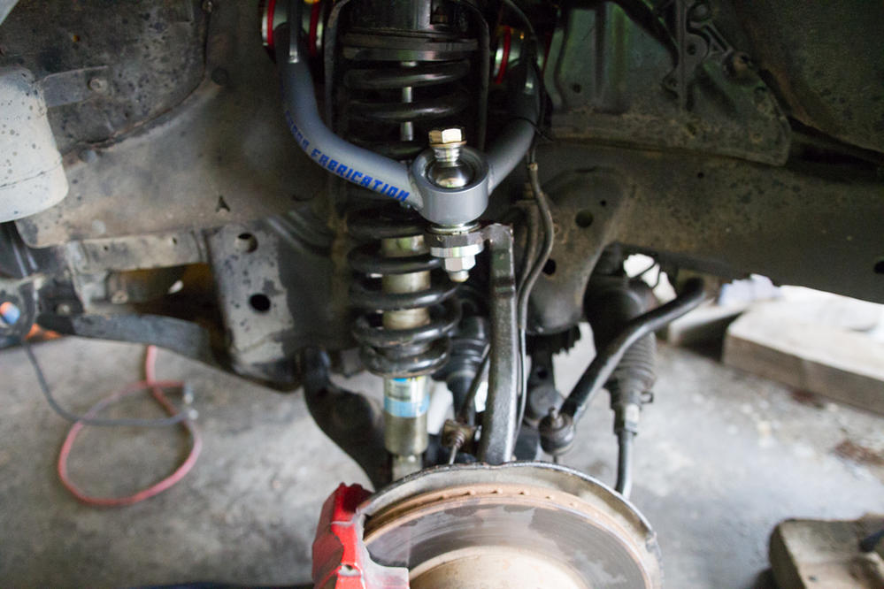

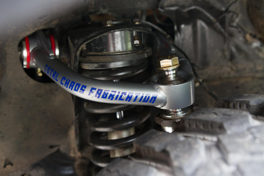

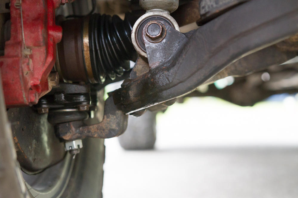

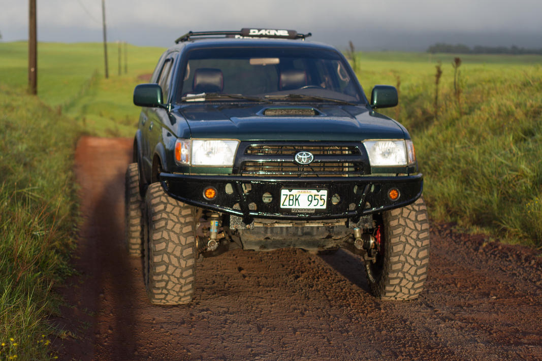

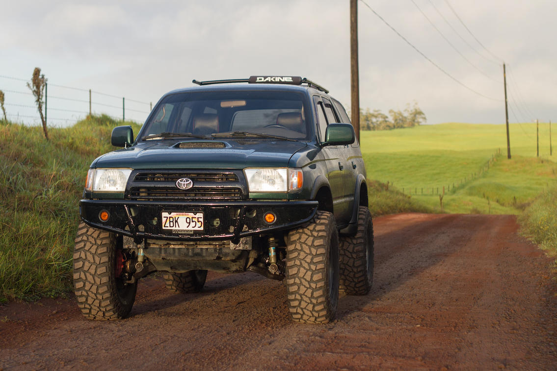

With the UBJ pounded out I put in the Uni Ball mount
Driver side UCA, tie rods, LBJ, and CV all buttoned up.

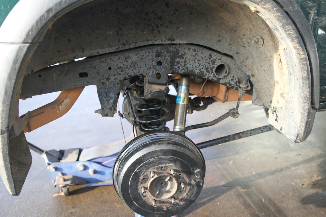

Been wanting to regear since I got the new tires. Contemplating 4.88s or 5.29s. With my stock gears the 305/70/16 tires have contributed a noticeable power loss. I also want to through in a grizzley locker, but that is aside the point. What gears should I get?

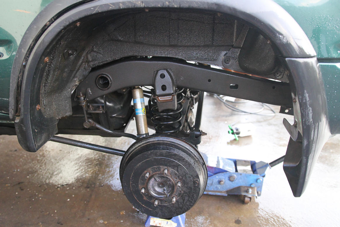

Noticed my driver side rear axle seals broke, spraying gear oil everywhere. Took it apart anticipating just replacing the inner axle seals,
and found the wheel bearing was absolutely shot, there was way too much play and for all I know they could be the 200k old originals.
So taking the axle shafts to a shop to get it pressed for new bearings and axle seals.
The whole hub was soaked:

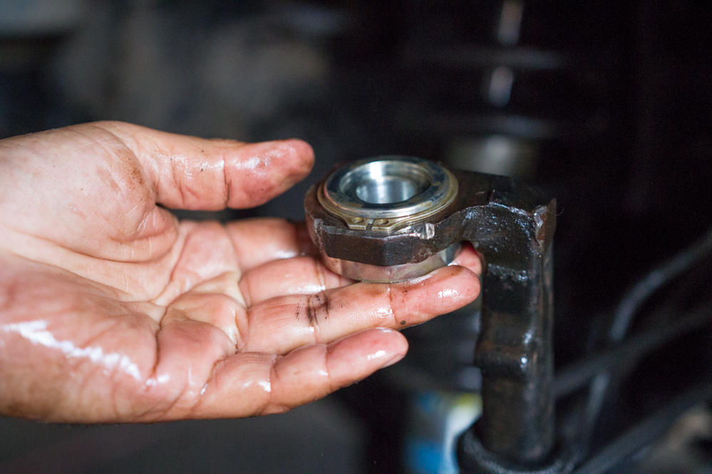

Old bearing assembly ready to get pressed at the shop:

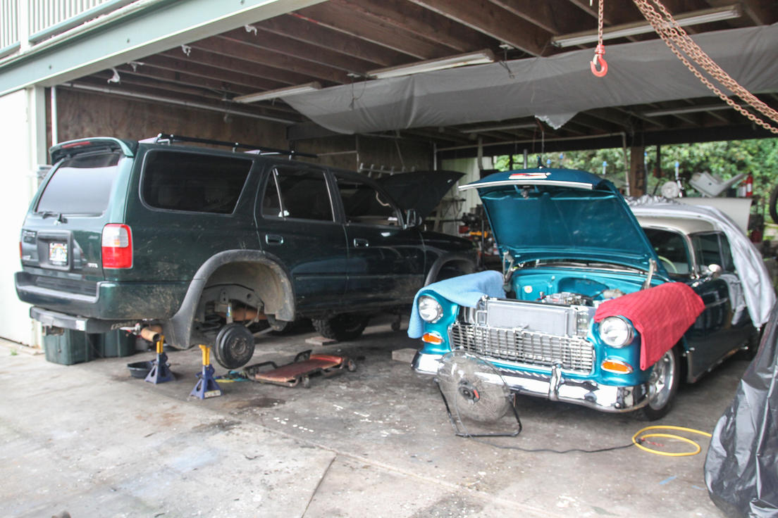

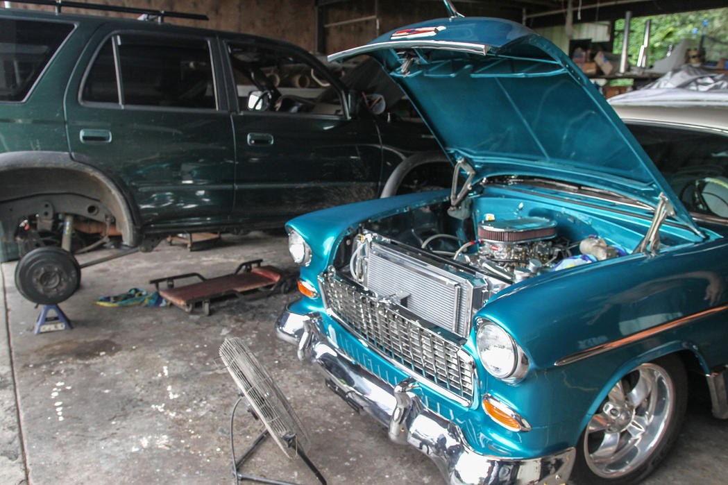

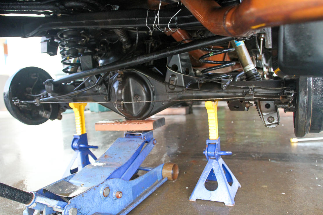

Been wrenching under my car waiting for my axle shafts to come back from the shop (wheel bearings), little stuff like my trans pan bolts and little leaks.

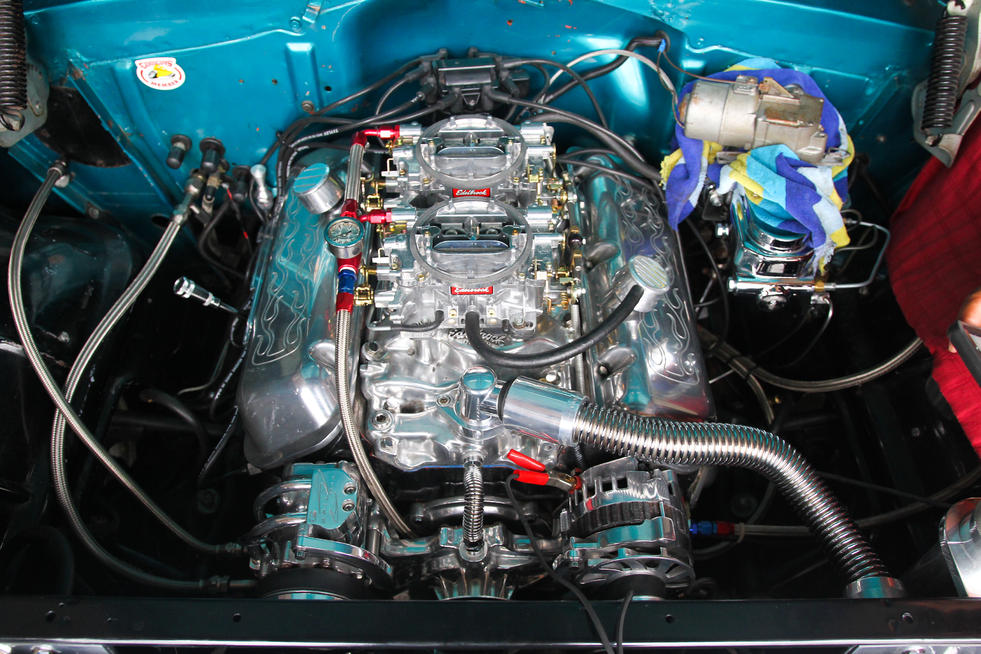

Also here is my donor car for my engine swap im planning: 454 big block out of a 55' chevy.
just kidding thats my dads chevy. We just threw in new carbs and have been fine tuning the timing

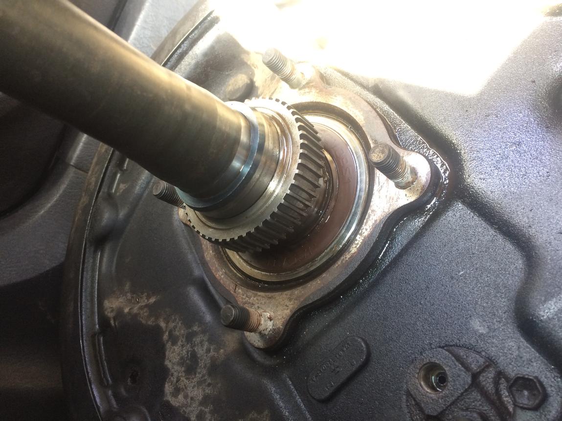

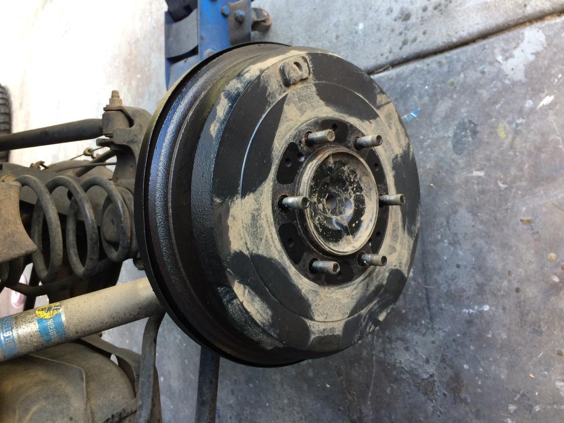

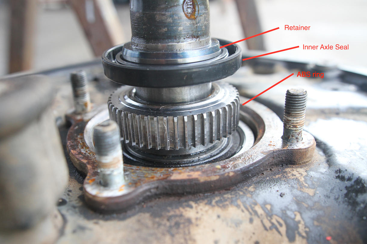

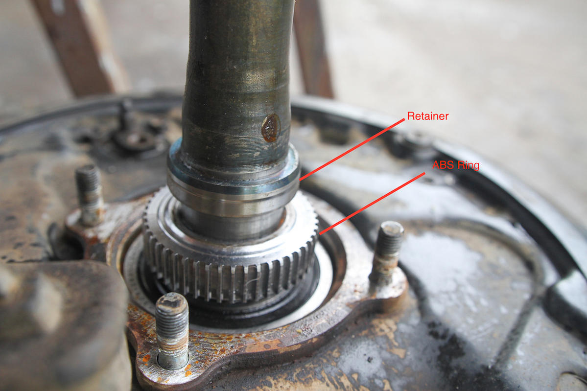

Possible Axle seal solution
Been working on my axle seals today and took my axle shaft down to a friend's shop to get new bearings, retainers, and abs ring pressed on.
He described these axles being so notorious for seal leaks because often the inner axle seal doesn't even meet the retainer on the shaft... so there tends
to be a gap right there or at least they are not snug together.
So when I got the shaft back today my friend at the shop showed me why he didn't press the retainer all the way down to the ABS ring
You can see how the retainer is not pressed all the way down against the ABS Ring
Here is what it would look like inside the axle housing and how the inner axle seal would fit flush on top of the retainer
I measured the inside of the axle housing from the end to the inner axle seal, and it measures perfectly for the retainer to fit snuggly against the inner seal.
Unfortunately I did not keep the exact measurements anymore, but you guys get the idea. By eliminating the gap between the retainer on the axle shaft and
the inner axle seal hopefully there will be a less chance of leaking.
So far I have only driven a couple miles and everything is still dry, I will try to update after substantial driving

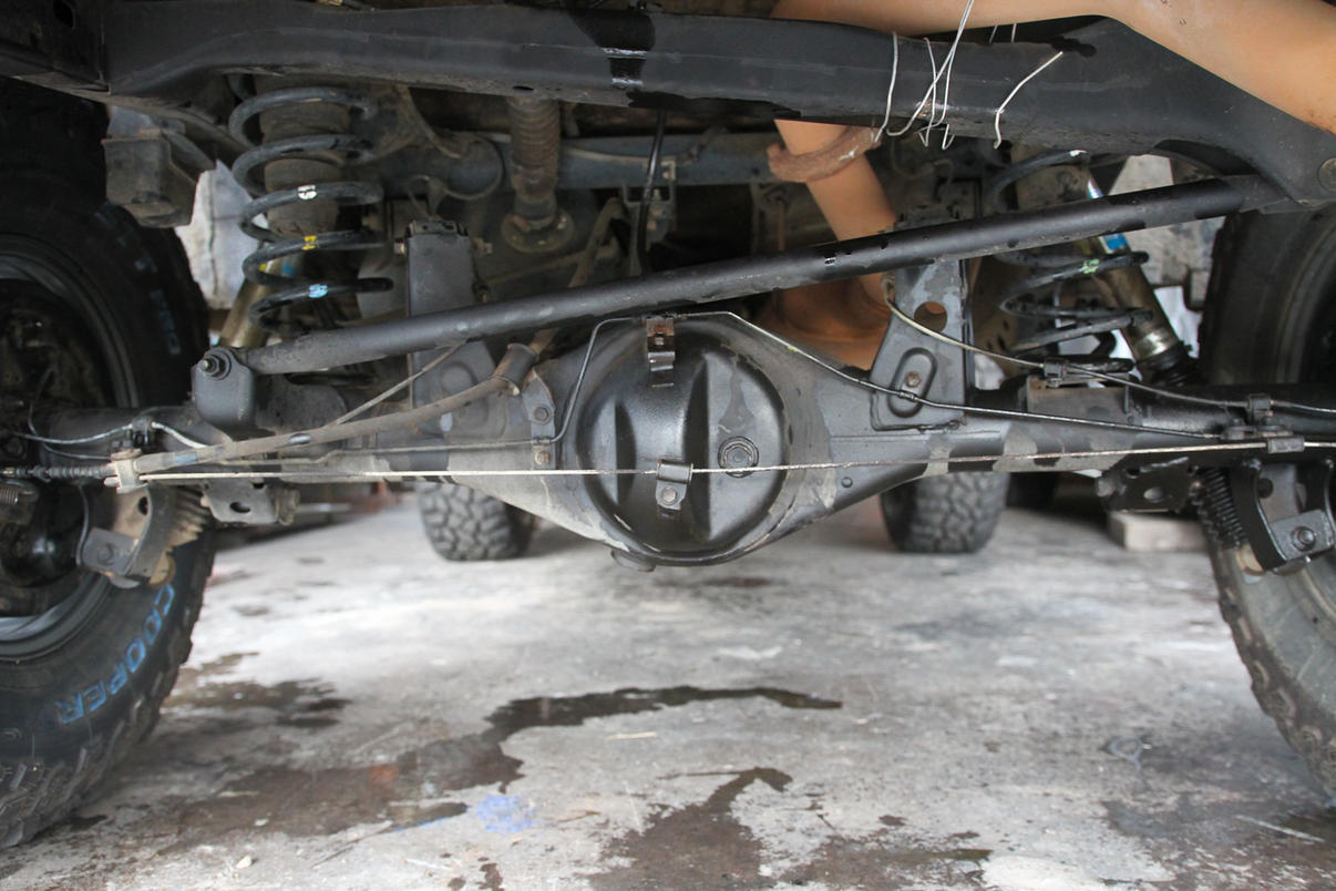

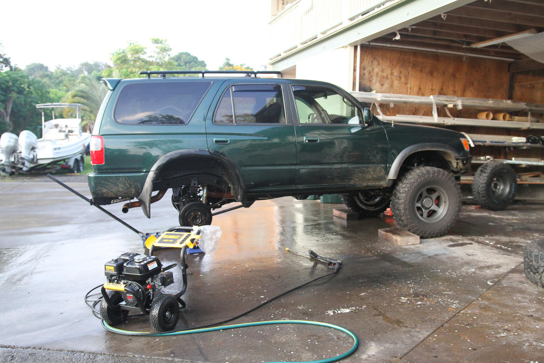

After completing the seals/bearings I also replaced the shoes and bleed the brakes. Also replaced the rear diff oil. Overall the rear end got super greasy so I degreased the whole undercarriage and pressure washed it.
Before:
After:

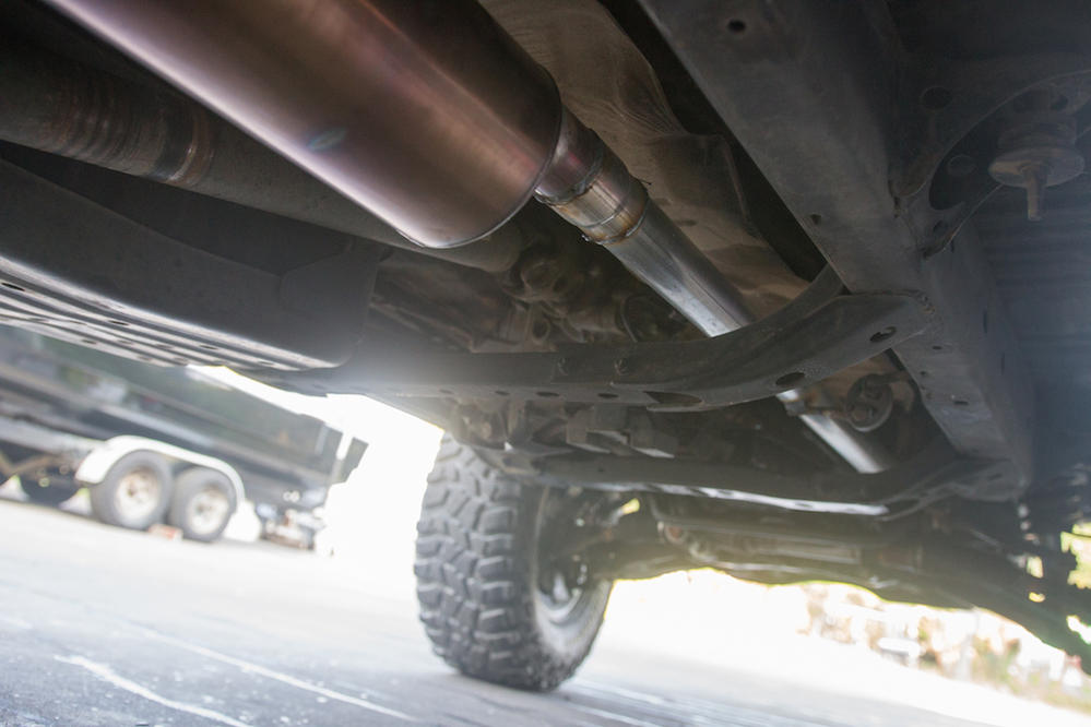

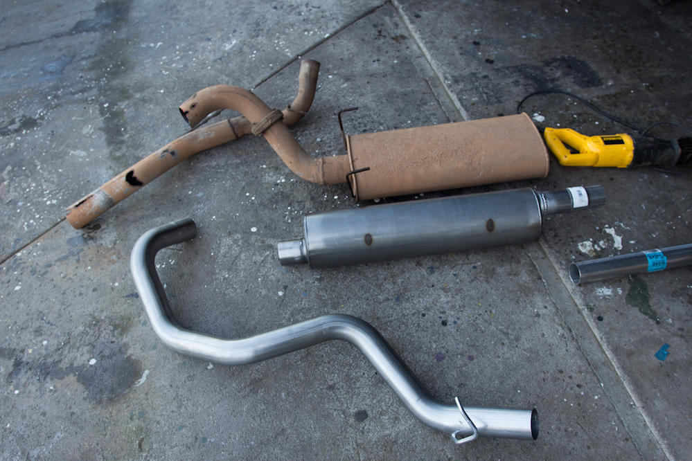

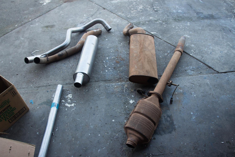

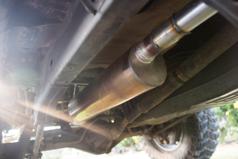

Since I have owned my 4r my exhaust has been falling apart. There were numerous holes in the muffler and tailpipe, and pretty much all the
hangers have rusted off. I had wrapped welding rod around the muffler and tailpipe just to hold it in place.
After searching far and wide for a cat-back exhaust I found the Gibson system decently priced from Burtman. It is crazy how hard it is to find an
exhaust system especially out here in Hawaii.
I also ended up cutting out the Cat and adding 2.5" pipe in its place. It was old I don't need any extra crap to choke up the forced induction engine,
after all gotta let it breathe... and fart.
While cutting the Cat out I damaged the O2 sensor I was gonna put on the replacement pipe like a dumby. Went to oreillys and got ripped off for a
new one.. cost $180... and CEL is on most likely because of it. Im getting a denso O2 sensor for a quarter of the price and hopefully solve the CEL.
Regardless of the CEL truck runs fine and sounds extremely aggressive.
Old Vs New
Welding the O2 sensor portal onto the cat replacement
All In... what cat?

Figured out the CEL. Oreillys ended up selling me the AF sensor and I didn't even notice, took it back pissed,
got an O2 sensor, saved over $100, fixed CEL.
Overall truck runs great, no more exhaust rattling. Call it placebo, I definitly feel like it opened up a little horsepower.
Gibson exhaust is loud, also can contribute a little of that to cutting out the cat. But as for sound it is very raspy at
low ends, and I think the loudest. On the highway it is nice, but when going slow in neigborhoods definitely not the
best choice. In the end I dont mind because i live in the boonies, and I like the sound a lot especially on the highway.
Just happy to have a tight hole-less exhaust.
Nice job on the Gibson install, I love the sound of mine so far even with the Cat in there.
How do you like the Uniball UCAs thus far? I've had a set of AllPro's sitting around for almost a year now waiting to install them, I've just been lazy. Hoping to hear it's worth it haha.
And is that a wave storm on top of your 4Runner? Hahaha I want one so badly to mess around on in shore break crap.
Best of luck with your surgery this week man!
Thanks man!! Love the sound especially when it opens up on the highway!
So far the UCAs have been great. They handle the angle way better especially at full droop. I have heard they get squeaky,
but I would just need to lubricate it with tri-flow, but honestly I havent heard anything from them. It is just nice not to see the
busted UBJ's. I highly recommend them so far, relatively easy install, the hardest thing for me was getting the old UBJs out.
