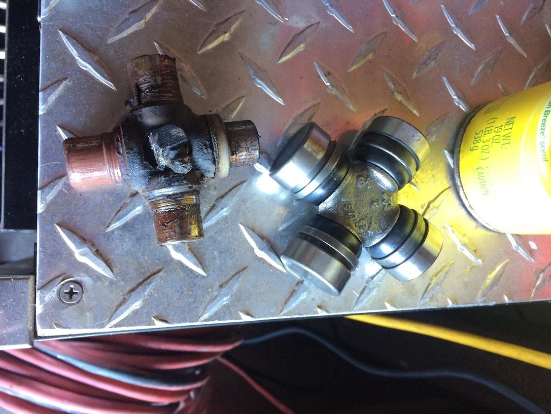

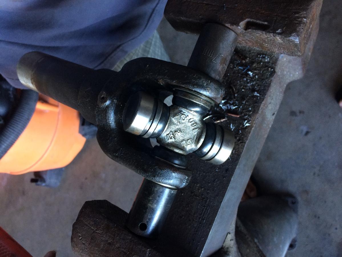

Started getting a squeaking noise while in reverse, ended up diagnosing it as the U-Joints. Got some Spicer U-joints and replaced them today, solved the squeaking.
Old U-Joint Vs. New
Notice the old one is completely dry on one of the sides
Pressed them in with a big ole clamp

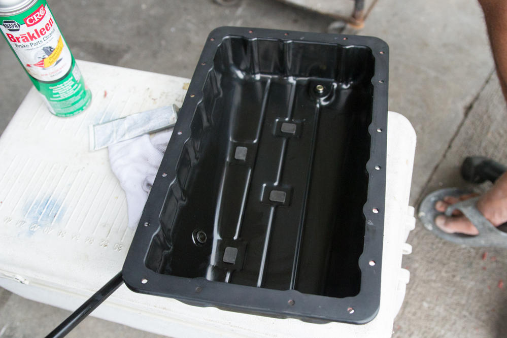

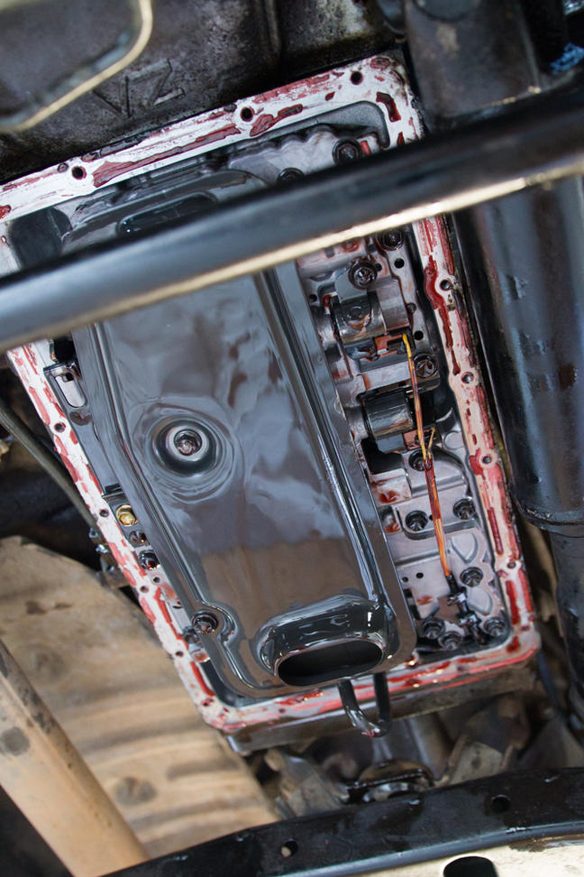

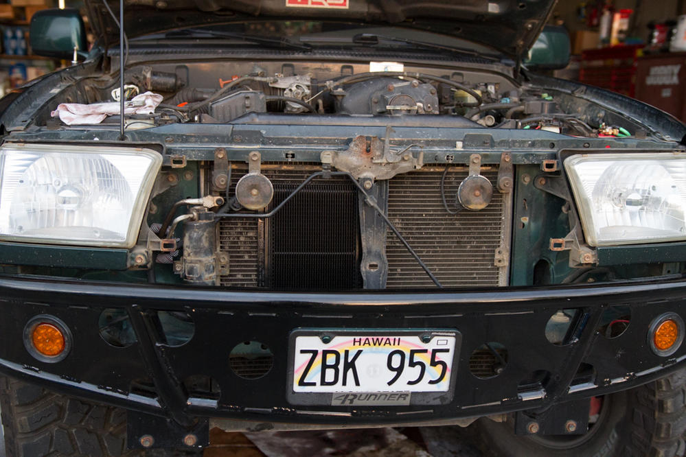

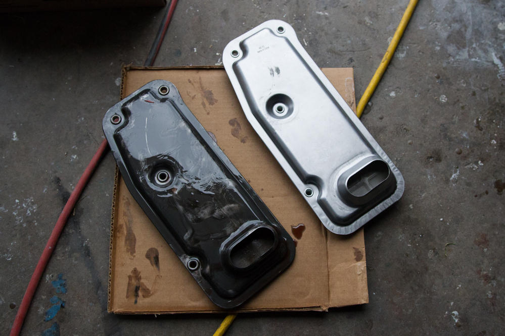

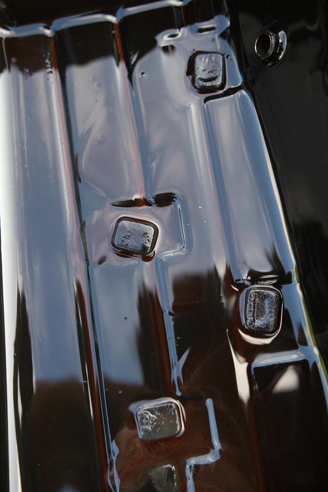

Did some long overdue transmission maintenance today
Replaced trans filter and gasket, along with a little flush (not the full transmission, just the 4-5 quarts that can be squeezed out of the oil pan).

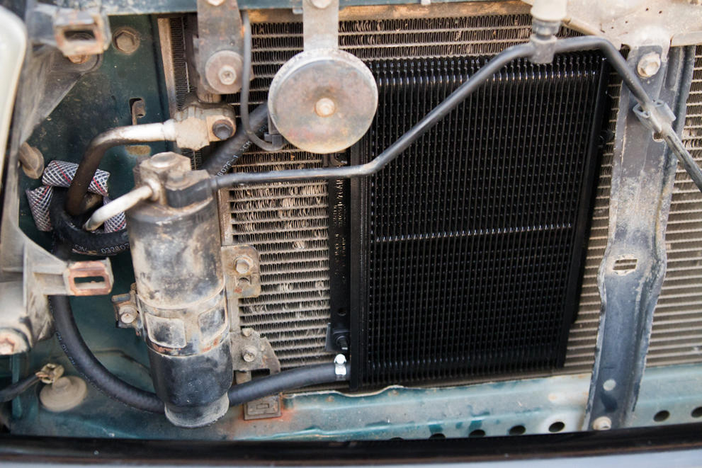

Also noticed recently when climbing/crawling extreme inclines in 4wd my a/t oil light would come on periodically. So got a B&M 70268 and with some help from [MENTION=44220]BigFishAllDay[/MENTION]'s trans cooler write up, got that installed also.
Trans oil pan off
Oil pan magnets werent as bad as I expected them to be
Old vs. New
Trans oil pan all clean
B&M supercooler installed

Looks good man. About to do the Trans cooler myself. While I had no lights appear, I was nervous about my trans temp this last trip I went on. Also picked up a Scan Gauge to help me monitor trans temp.
awesome, its well worth it, and relatively easy install!
I was getting pretty nervous being up at 13,000 ft elevation and my A/T oil temp light came on. For me seems like a must do
I should get a scanguage but for now im just using a bluetooth obd2 reader and an app on my phone.
Make sure to take it out of overdrive when climbing like that. It really helps keep temps down. With mine out of overdrive I never went over 210* or so going over the Rockies.
