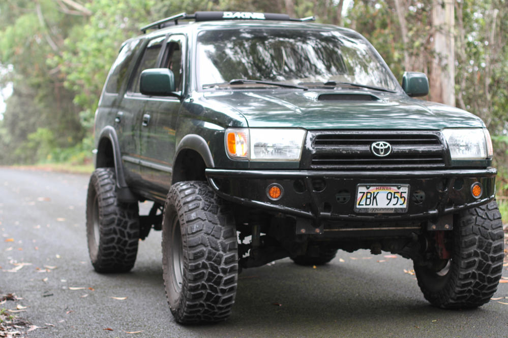

Its been a while so figured post the most recent pic, just bought a one man canoe so im pretty stoked on that.
In other news the back of the truck has been crooked since the 8 wraps, so i finally ordered a panhard drop bracket from toytec, assuming that will straighten things out.
Also bought a pair of 9 wraps from [MENTION=64758]FlipStyle54[/MENTION] to replace my 8 wraps, cant wait for that!
So the 8 wraps will be up for sale once the new ones come in

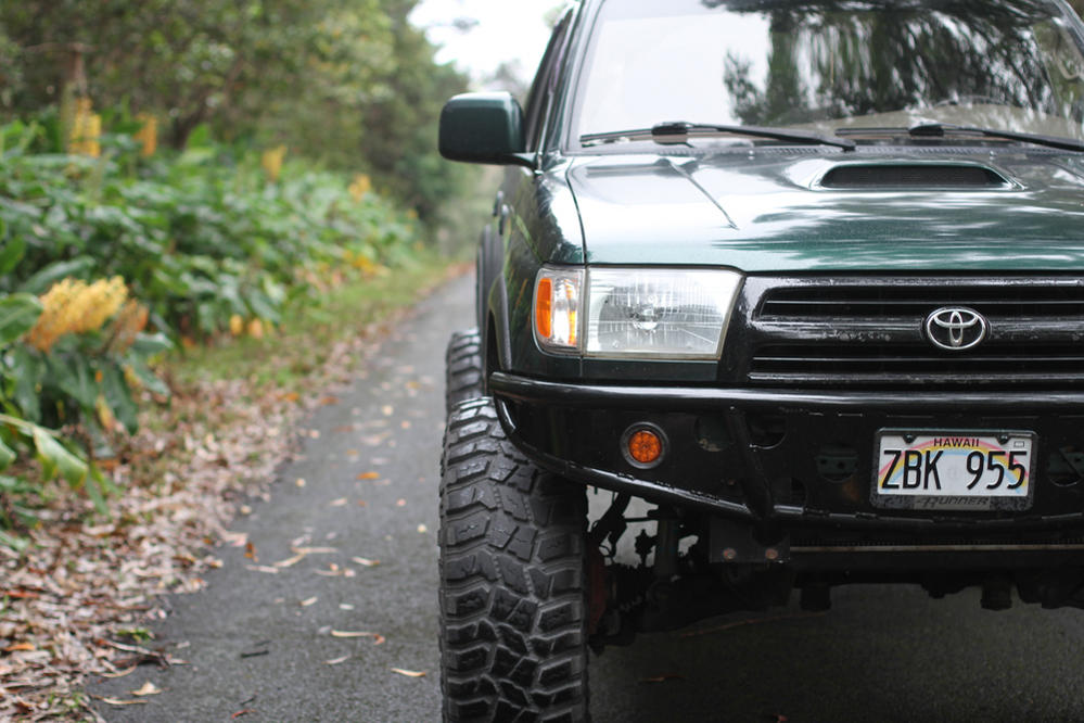

I got so much take you'd think I was a gardener! Been following your build since day one. Def digging that one of a kind front bumper you built.

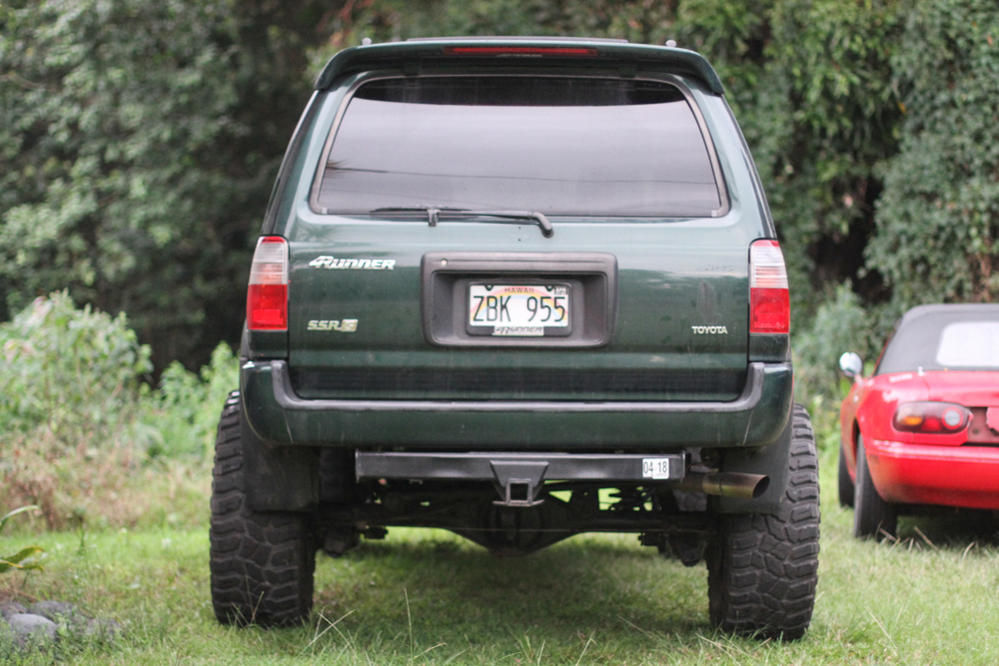

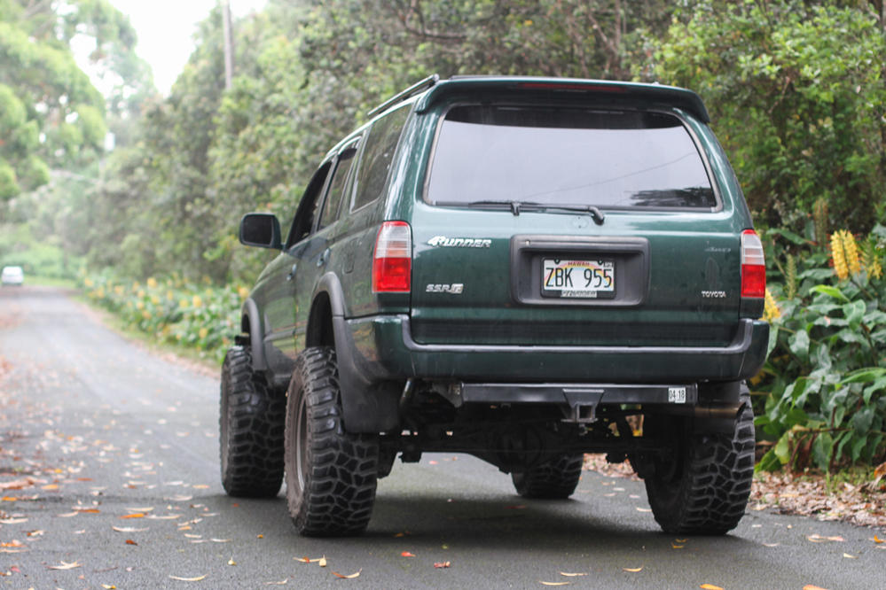

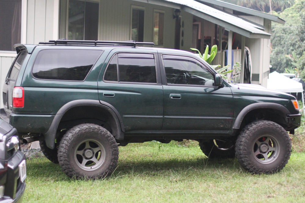

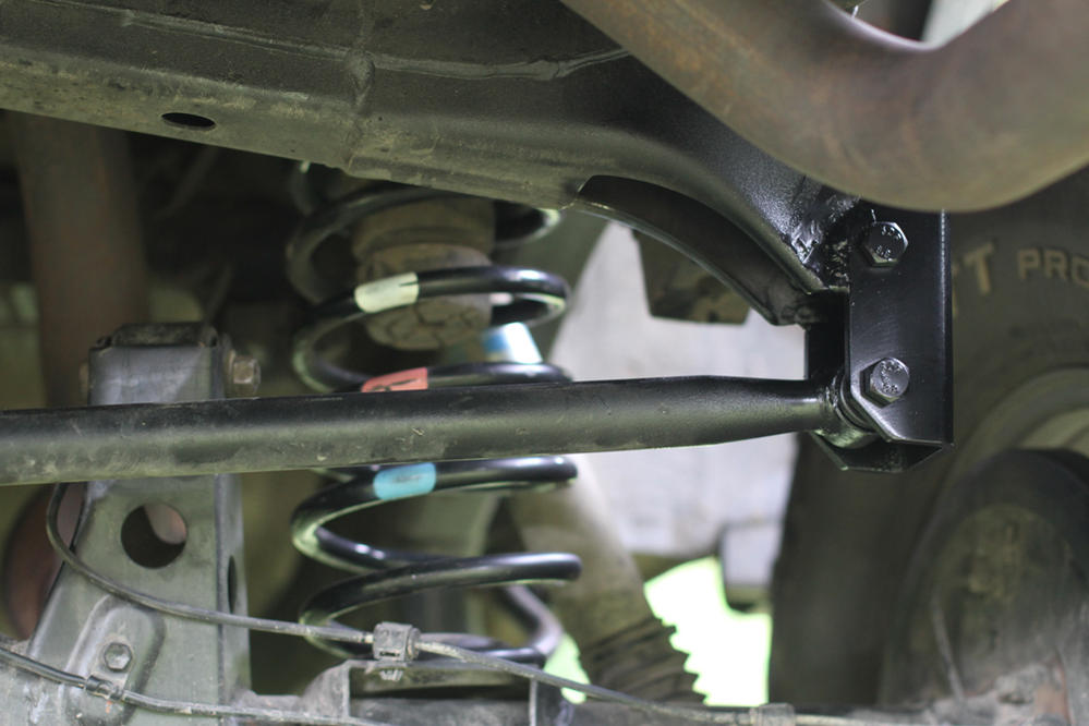

Finally found time to install the LC 9 wraps (color code: blue pink white/grey orange white) and Toytec panhard drop bracket that have been sitting for a few months. With the 8 wraps and
no pandhard drop my rearend was pretty crooked, but with the 9 wraps and panhard drop not only is my butt straight but it also seems to handle better.
I would have loved to try out the panhard correction kit made by @eimkeith but of course I only saw them after I ordered the toytec bracket.
Very happy with the rear lift now, got a good amount of rake that is much more noticeable if you are looking from behind.
Probably gained about a 1/2"-1" or so of lift over the 8 wraps. Got more rakes then a landscaper who cant afford a leaf blower
oh also threw my 1.25" wheel spacers back on cause can

Sweet rig! That front bumper is so cool! I'm glad I live in the continental US, must take forever to get parts to ship compared to Colorado
Thanks man greatly appreciated!
Yup haha, a lot of reasons why I had to improvise on some of my parts like the bumper, the little price of living out here

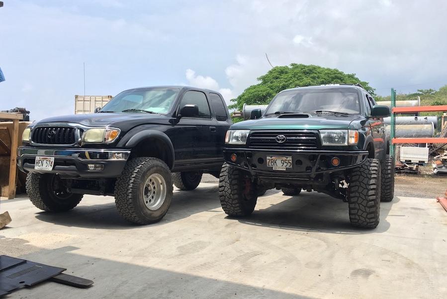

after chilling in the garage at work today, I noticed our race truck has a super similar bumper on it but with light bars. I should ask who made it for us
