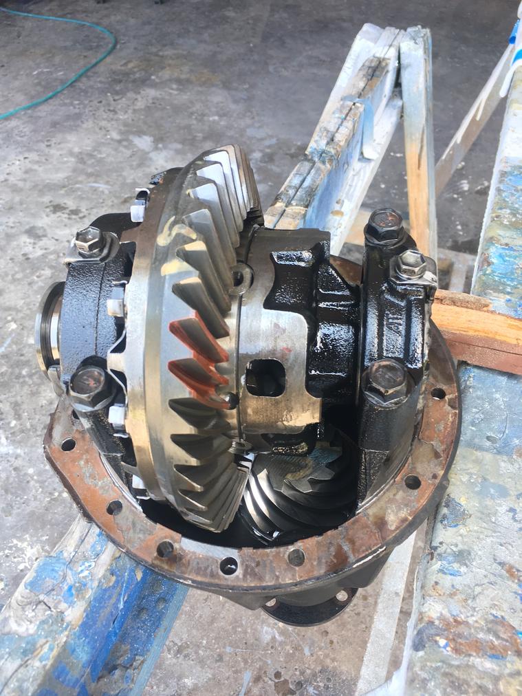

Took apart and cleaned the donor axle.
Found out its a 4.10 ratio, which matches my current gears meaning i dont have to swap out the front diffs, super stoked on that!

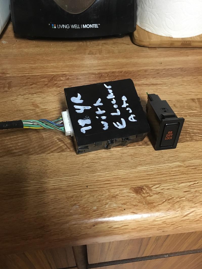

Also just bought a low-range offroad elocker ecu harness from @CRB Racing and an elocker ECU and OEM rr diff lock button off ebay.
Been studying @BigFishAllDay's retrofit and this site :Retrofit Electric Locker. Between the two I there is a substantial amount of helpful info.

Here is the e-locker third member from the donor axle

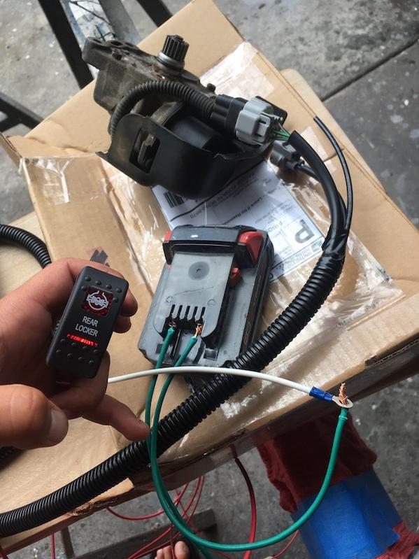

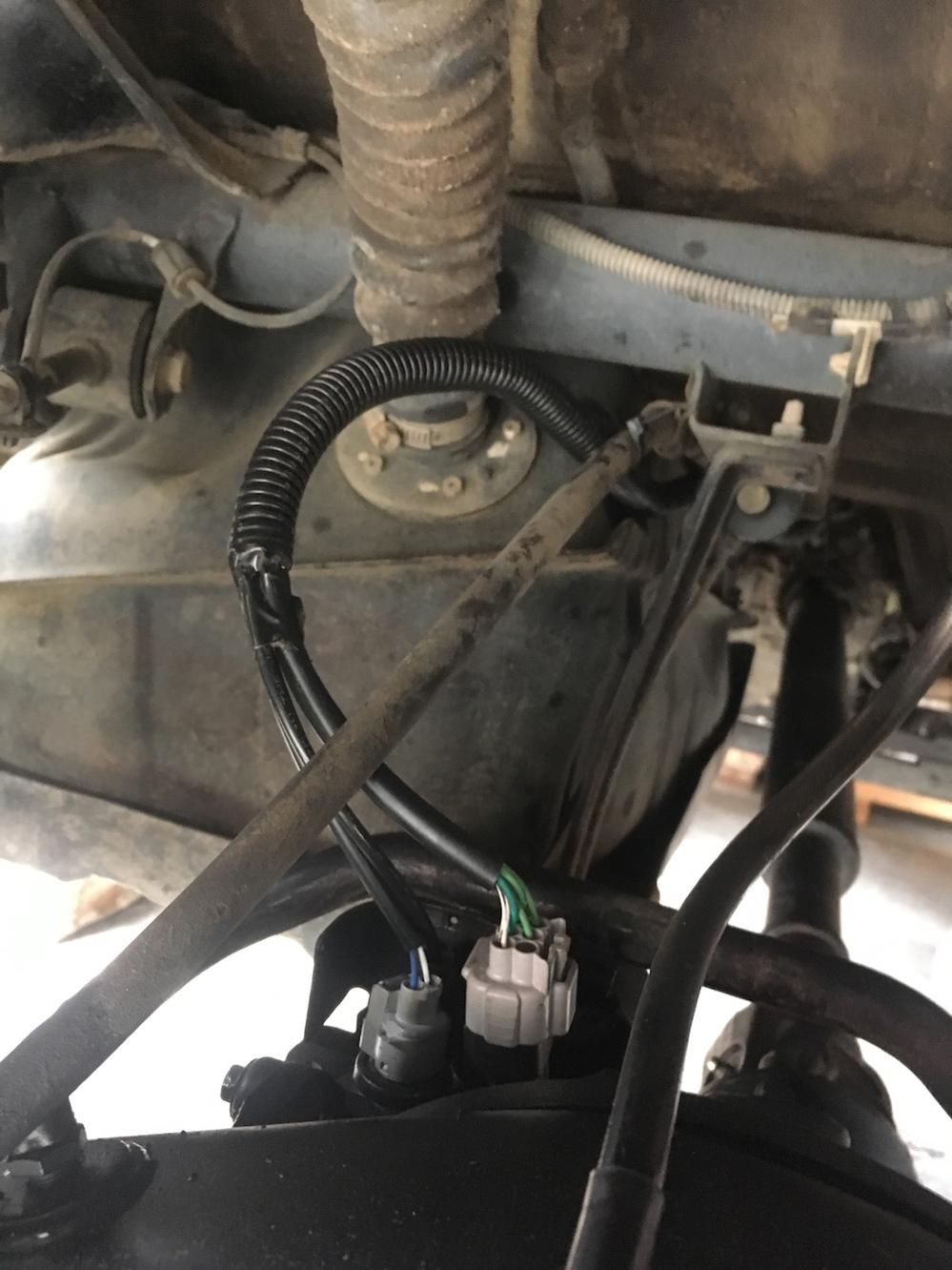

Got the low range off road wiring harness from [MENTION=104473]CRB Racing[/MENTION]. connected the harness to some power and the E-locker actuator and everything works!
Just ran all the wiring through the car, gotta wait for a full day or two to actually retrofit the 3rd member.
But with everything wired up, tested and working I could not be more excited.
Also due to my lack of research I ordered a 4x4 elocker ecu and oem button off ebay, not realizing that they are not needed when wiring with the
LROR harness, which is just plug and play (makes things very simple!). So once the ecu and rr diff locker button come in, i will probably post them up for sale

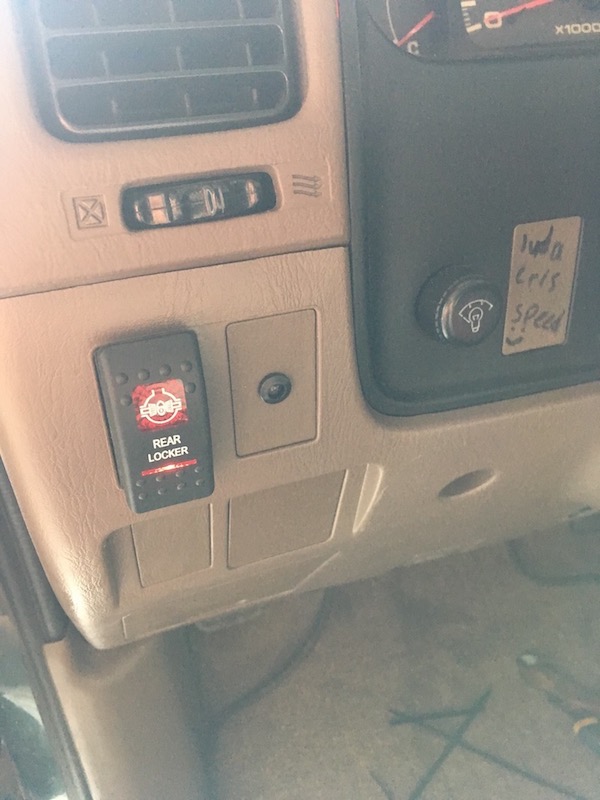

Yes, you won't need the button or locker ECU with the low range off road harness. Just plug it in, route the harness and mount the button.

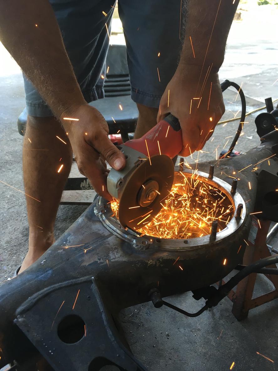

One thing I learned when I did my retrofit. Don't use the gasket as a template to drill the holes for the locker!
Use the gasket to mark where you need to clearance for the e-locker, then install the diff assy. And use that to help drill the holes.
I used the gasket to locate the holes, drilled it and the bolts were off!

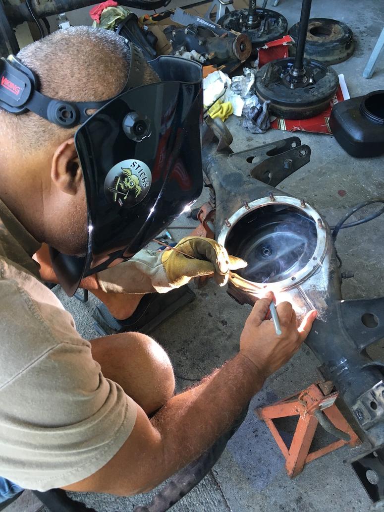

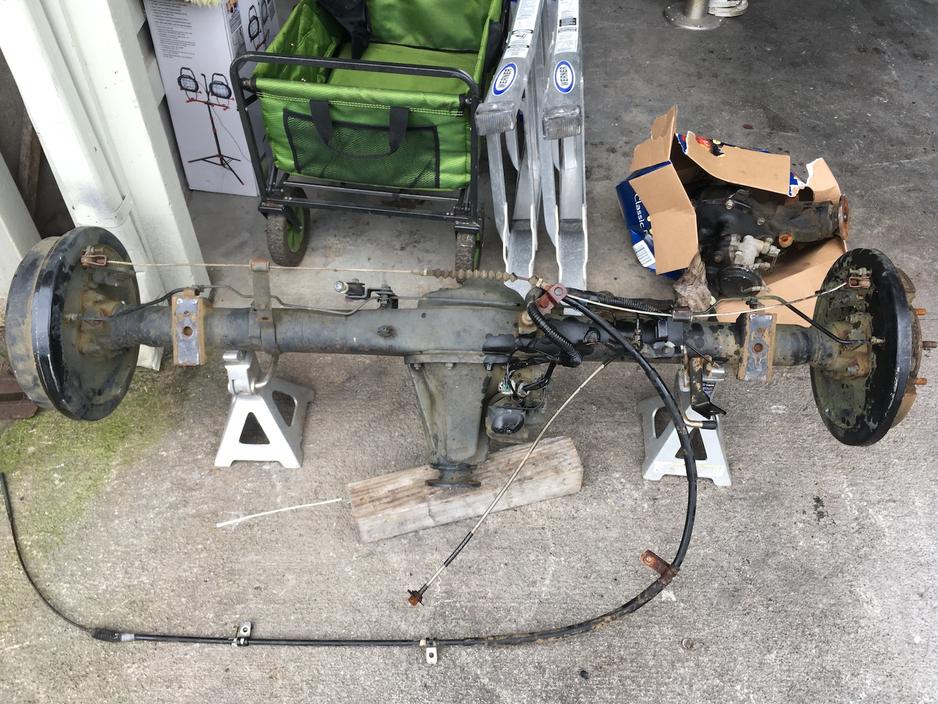

Finally finished E-locker Retrofit
The day has come, I am finally locked!
Details:
Donor diff: 00' tacoma axle - 4.10 gears (matches mine) - also pulled any studs needed to modify my housing
Low Range Off Road Wiring Harness (bypass ECU)
Toyota OEM Diff gasket (part #42181-60050)
Very helpful how to's:
-@BigFishAllDay's build thread
-Retrofit E-locker

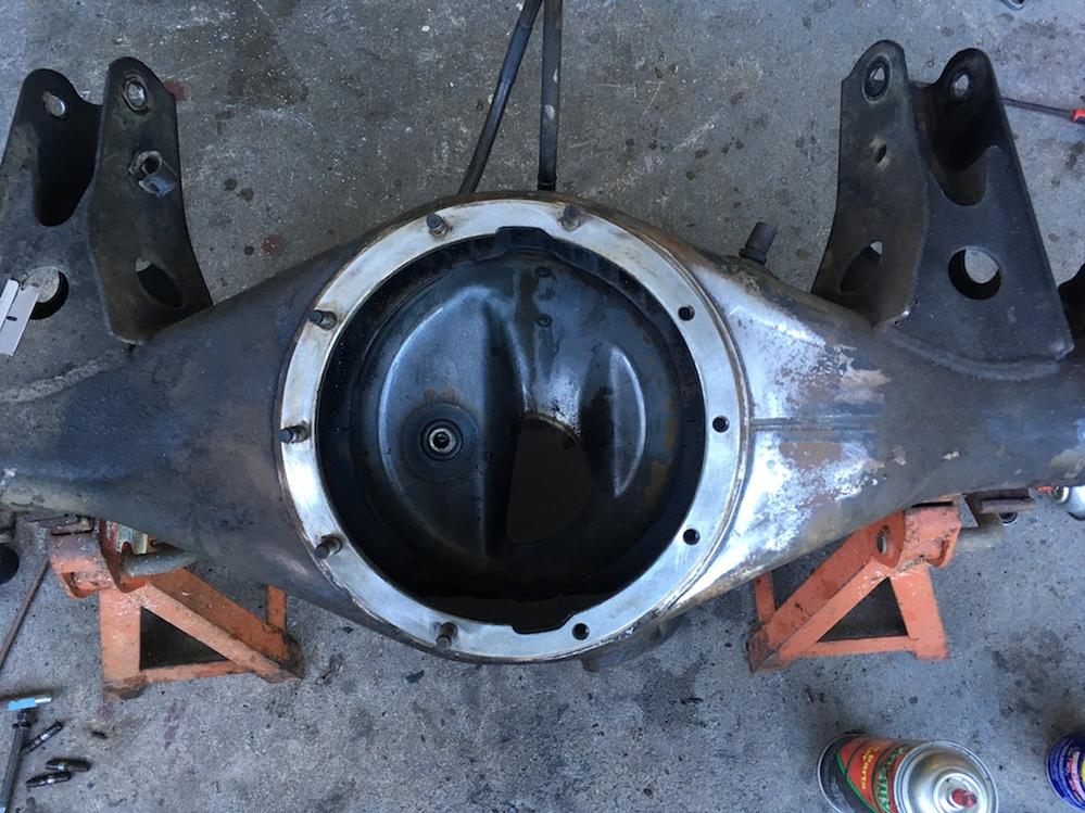

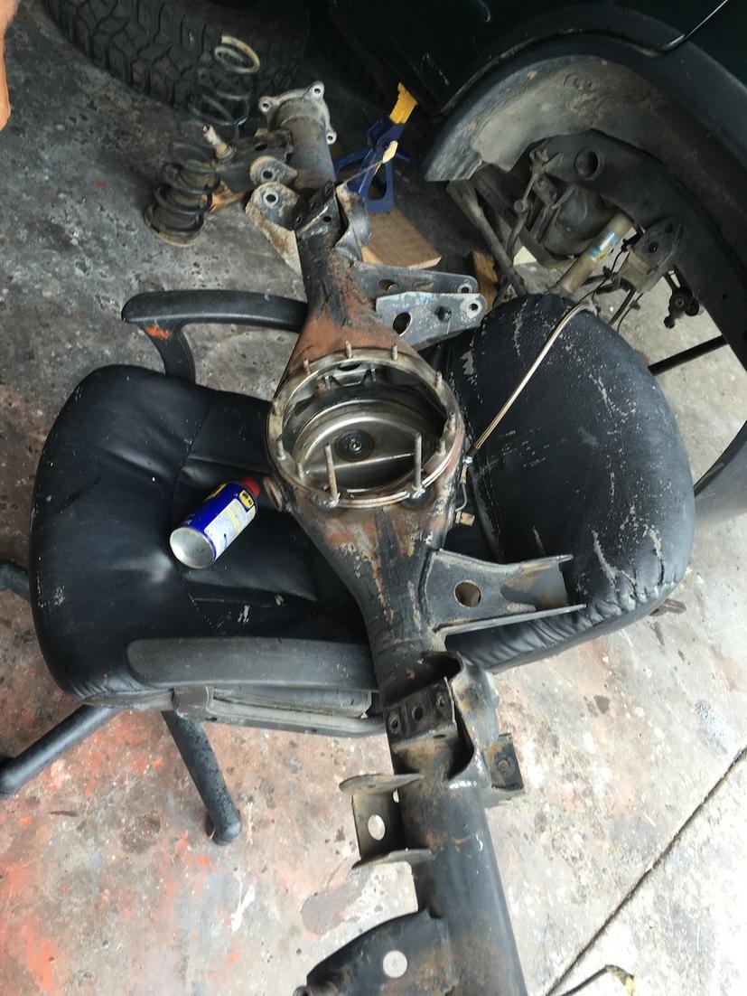

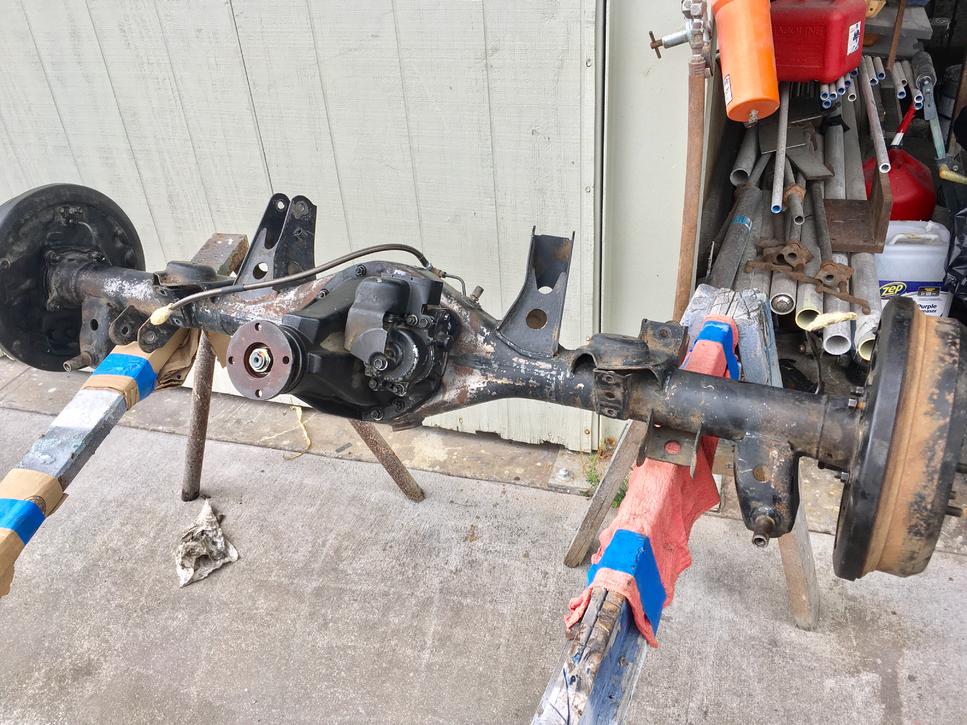

Pulled my axle; prepped it for the modifications. Have to make new stud placements

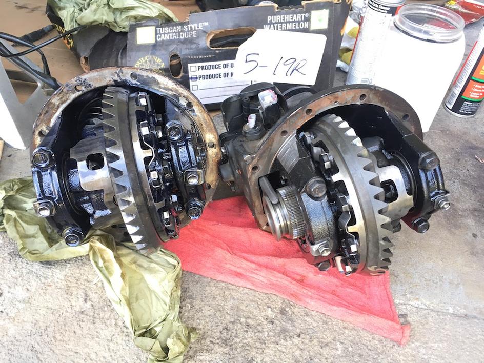

my old diff on the left - Newish e-locker diff on the right
New studs - ready to mount 3rd member

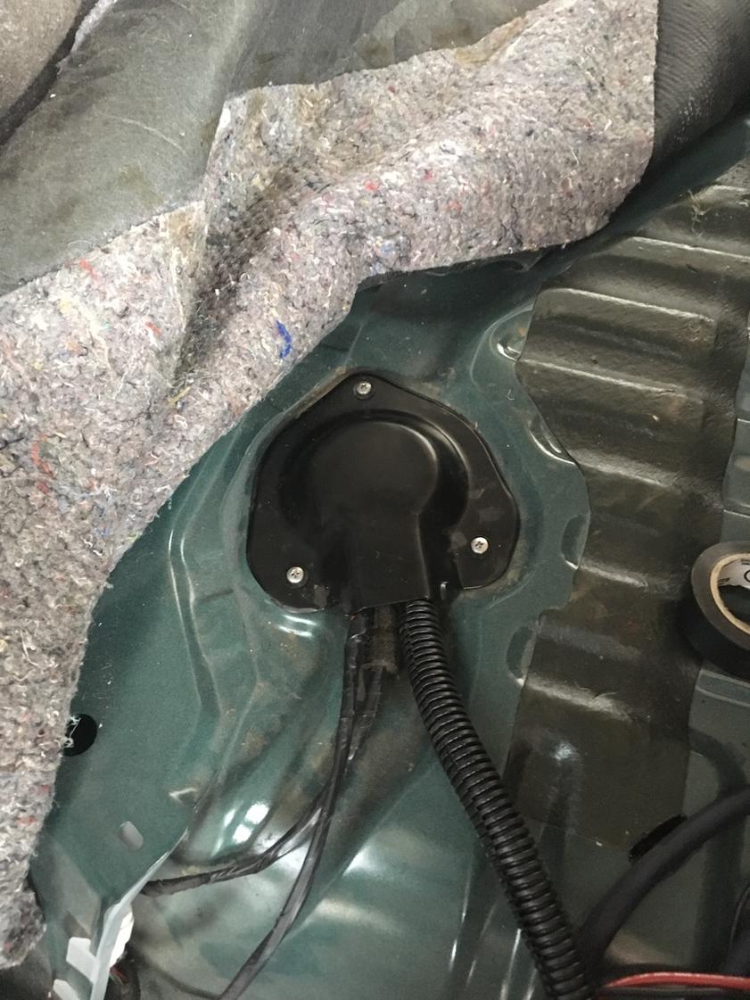

Wired harness through opening under rear driver side seat
Cleaned & Prepped axle to be repainted

Finally finished E-locker Retrofit - continued

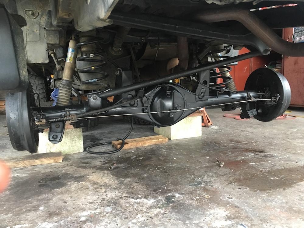

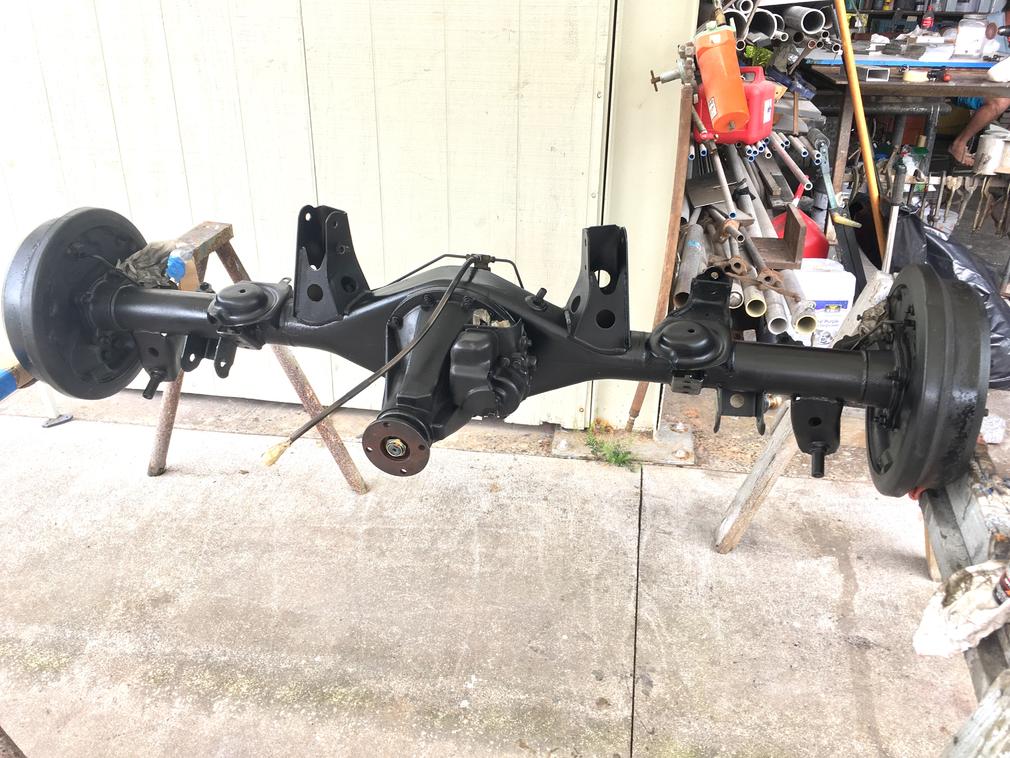

Painted the axle - now shes all pertty
Got her all buckled up, bled the brakes and shes all good to go
