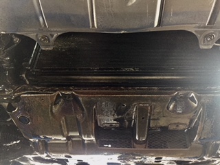

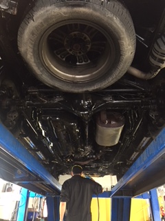

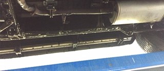

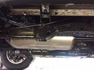

It's a problem in the rust belt, since you live in TX, I'm sure the frame will outlast the engine. If you wanted to do some preventative maintenance, just spray fluid film.
I live in the rust belt.
I'm convinced local government is trying to turn our lakes into saltwater bodies of water. They alternate between crystal salt and salt brine over the winter.
Having said that, Krown spray every fall and this is what my '06 looks like right now.
