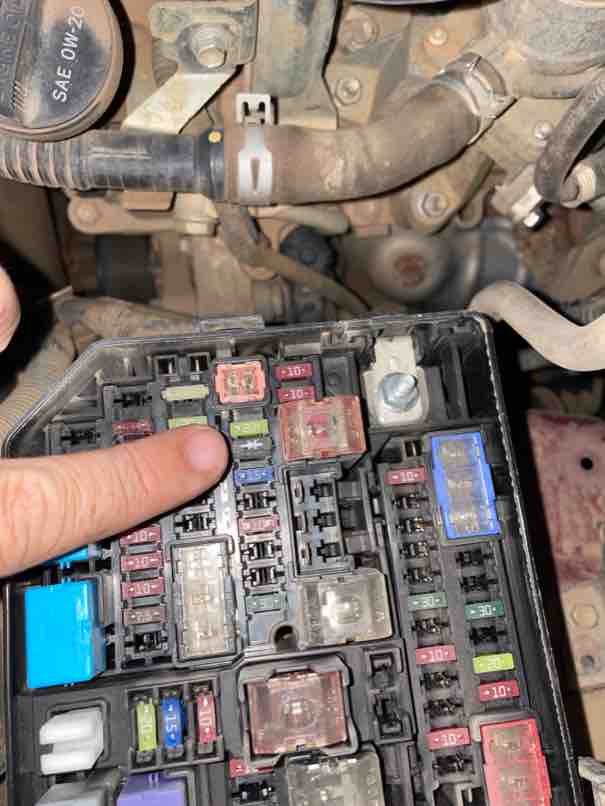

BUT, if I read this correctly, what is the owner of a 2017 or newer to do?
Apparently our ECU thinks it knows better than we do about voltage/Amperage requirements...
A BCDC 1225 charger is a work around for those with both a LEAD ACID and an AGM battery...but we are still stuck with a puny 130A alternator...
What options do we have have to up the amps to 270?
I thought about the pulley change but, I am running 4.88's and 70mph is already 2600 rpm ish. Any more and the bearings will be screaming for mercy..
Any and all options will be welcomed!
AMLOR
Wow I just switched a fuse and my alternator been charging at 13.9-14.5 for past year now!!
william...would that "fuse" be the "GM DIODE" Rigtec was referring to ???
If so can you please share which fuse you replaced to trick the alternator?
Thanks!
AMLOR
Thanks!
AMLOR
Yes that’s it. Looks like alt-s this one in pic image-2021-05-25-21:00:34-759.jpg

[MENTION=420040]AMLOR[/MENTION] did you get get an uprated alternator, or otherwise solve the 130A alternator problem?
Well, sort of.... the 270A alternator is on my list of cool stuff to do to the 4R, but not as of yet.
Currently running the "GM diode" trick on my 2019 with acceptable results.
Output is 14.2-14.5v on cold startup. That said I DO believe this mod shortened the life of my Optima Red start battery.
All other auxiliary power needs are routed through a RedArc BCDC 1225 that manages the AGM auxiliary battery at 13.2-13.5V.
