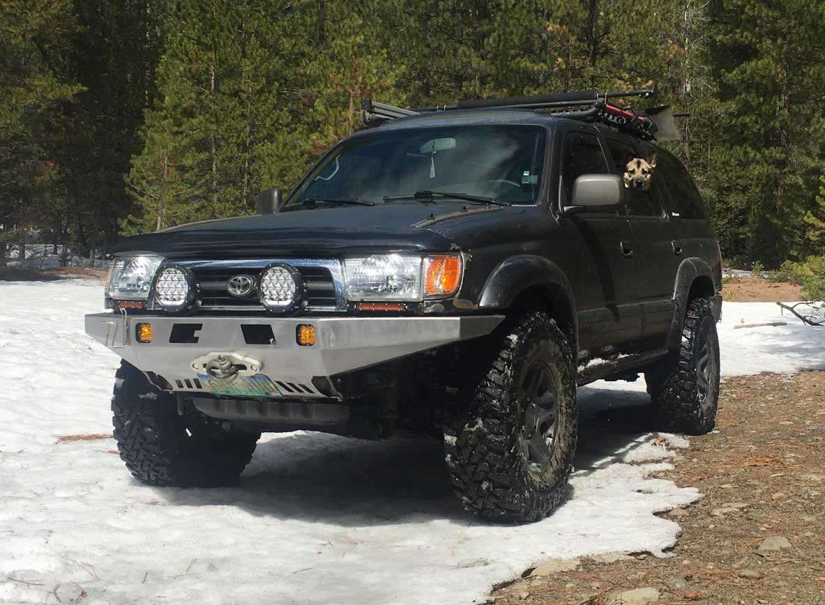

After owning a 1st gen for 11 years, and a 2nd gen for 8, it was time to
see what the buzz for a 3rd gen was about...

After many painstaking hours of research and sleepless nights of
"to drop or not to drop", I chose the following components:
FRONT
Bilstein Tundra 5100 5-ways (1st setting)
TRD Coils
OEM LBJs
REAR
Bilstein 5125 w/adapters
OME 890 Coils
1.25" All Pro Wheel Spacers
"Buy Local" :)
candy_zpsd68abdcd.jpg~original
The install went a smooth as anything I could have asked for...
The rust free nature here and no real neglect or abuse made everything
go very easy. Heck, the rear shocks simply unscrewed!
New lift, new life
current_zpsb2bb6402.jpg~original
profile_zps8bca238c.jpg~original
Pre-lift (hub to LTD flare lip)
DF: 20.5" DR: 20.75" PF: 20.25" PR: 20.25"
Post-lift (~1/4 tank fuel)
DF: 21.5" DR: 23.25" PF: 21.5" PR: 23.25"
Certainly a bit ass-high, but MAN what a difference in ride quality!!
Got the alignment done next day and took it on all the bumpy, jarring,
completely non-confidence-inspiring roads I frequent. A whole new truck!
I kept the front low for now, since lift wan't my primary goal. Need to let
the 890s settle a little and see what they like for weight in the back.
CVs wept a tiny bit, but no diff drop planned. Gonna see how it goes...
Rear brake bracket was bent lower, and I fabbed up a ebrake relocator.
Will give it a little flex session this week to check everything proper.
