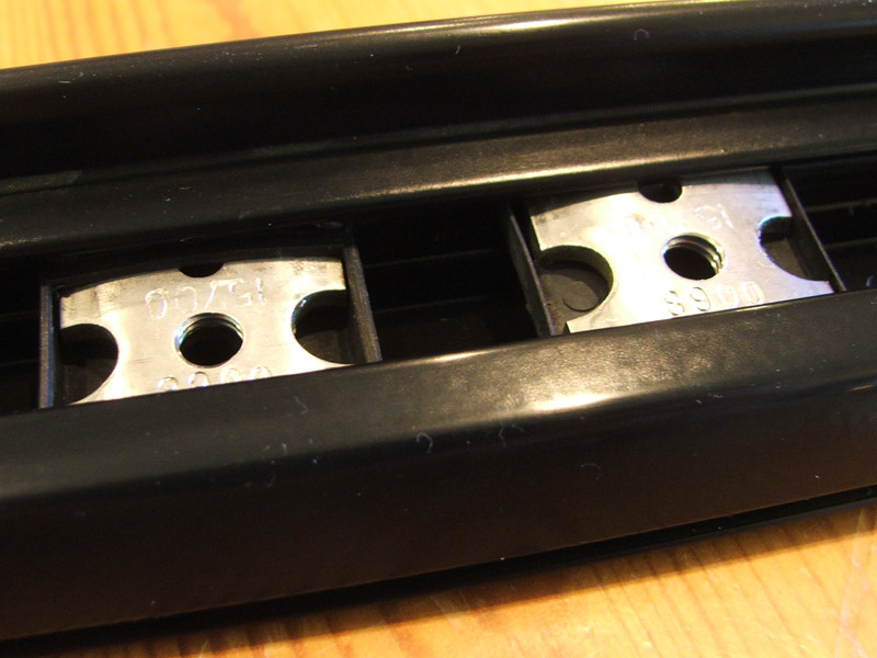

Ghost,I like what you did with the rack.The lower profile is nice.Do you happen to have any pics of the hardware pieces that you used inside the roof track ?

Hey! Sorry I missed this question earlier...
The nut-things in the track are the OEM versions re-used from the
main cross bars and the little eyelets that screw down the small crossbars.
Essentially what was already in the tracks.
I used some short 12mm (Subaru) bolts we had in the bins.
32964d1284509903-question-3rd-gen-4runner-roof-rack-rehab-dscf1694.jpg~original
I then cut/drilled some .25"x1.25" angle to accept two fasteners each.
The width of the OEM tracks seemed to match up very well to allow
welding the angle direct to the Rola bars.
photo12_zpsed8d20d7.jpg~original
Really happy with the results! The only drawback is: using factory hardware
parts prevents me from easily selling the crossbars, but that's a pretty minor issue
