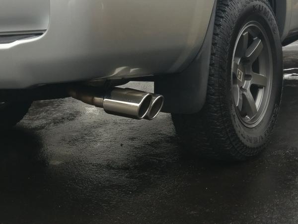

I wanted to hold off on adding pictures until the situation was finished. Here is how the side exit came out on my 2006. Also shown is the notch I had to take out of my hitch to clear the tips.
Looks good. I'm assuming that you were able to finally resolve the rubbing issues? You may want to add something to that hanger though to make it more secure.

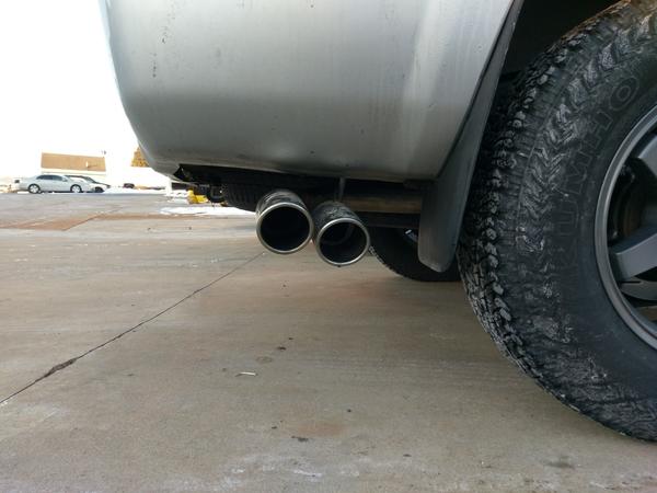

I picked up a SS Gibson from Jason awhile back and was waiting to install as the stock exhaust was still good at the time. Bought with Thorley headers which are as yet uninstalled. My local muffler shop installed for $120. Truck has skids from engine to T-case and I asked them to turn out the single tip to the side. They turned it out and welded the chromed tip on the end. I might have liked that not welded, but it's water under the bridge. I'll try to remember to add a pic.
After a little over a week of driving with it:
Wife likes and approves. Says truck sounds "Much better, sounds like a TRUCK now!"
The often observed 1900-2100 drone is there. An issue I notice in the 68-73 MPH range
It took me about a week to get my foot back to normal. That will likely change again when windows down season begins. Same thing happens for my Harley.
In person it looks like crap. The hanger isn't going anywhere. Shame it doesn't fit as it should though.

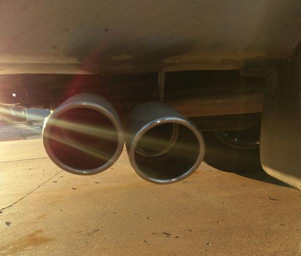

I have the Gibson elite black exhaust dual, love how it looks, fits “ok” does rub but I’ve remedied it. However another worse problem now what am I suppose to do about the “whistle/whine” coming from the exhaust at higher Rpms especially when downshifting going up hill it’s very Annoying.
What did you do to fix the runbbing? It had a chatter when I started up this morning.
Update: the whining noise is actually a vibration from the exhaust touch metal at higher res I am goin f to try to figure it and pinpoint and fix it :)
I have seemed to have fixed my issues. Adjusted the pipe that goes over the crossmember. And a couple hose clamps on the hangers.

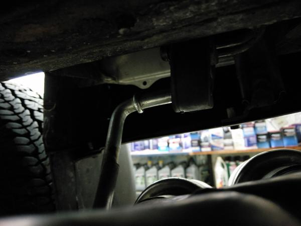

Does anyone know if there is a "direction" to the muffler? I just read the directions and they mentioned: "with the louvers facing towards the converter"... I wasn't sure if I have it backwards or not???
When I look under from the passenger's side I can read "GIBSON".
Thanks!
Tighten the U bolts down TIGHT. You can't break em. It's even better to use air tools on them if you have.
Yes, it does making a difference which way the muffler goes in. Some choose to install it backwards because the want a MORE sound. The INLET of the muffler is the side with the open fave of the louvers. They are designed to catch the air :)

Here is how inlet of muffler should be when installed properly.

The picture inlet of the muffler looks very familiar... I just can't recall which direction I put it. Does anyone know if the picture above is from the "G" end or the "N" end of the "GibsoN" stamped on the side of the muffler?
Either way... I'll bust it open next week and report back if I don't hear from anyone.
