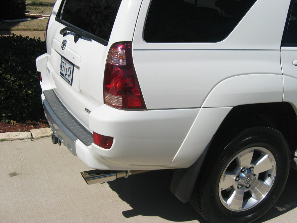

After much research (primarily from this site) - I purchased the Gibson Exhaust from Jason at Burtman Industries. It arrived a few days later and is exactly what was promised - thank you Jason for your quick turnaround and thoroughness.
Also - a quick thanks to Pronto Mufflers in Plano, TX. It took them 40 minutes and $70 to install this - way easier than borrowing my neighbor's jack stands. These guys did super!
My review:
Mileage - after 2 weeks (and a recent trip to Austin), I am happy to report a slight gain in mileage (1-2 mpg).
Power - I have not dyno'd it, but it does seem to pull harder in the lower gears...could be psychological though. :-)
Sound - rocks! It is very low and humble and snarls nicely when stomped. Cabin noise (i.e. drone) is almost non existent - however, the pipe's sound is noticeable most at 1800-2000 rpm. I would not call it a drone, as it's not annoying...but you can hear it.
Bottom line - love the exhaust (thanks Jason) and love the quick work (thanks Pronto) and thanks to all of you on T4R for all the posts/research.
Next up....how to get a slight 1" lift...(need new shocks anyways...just can't figure out how to get that small of a lift).
Posting an after pic - but I've more images if anyone wants to see..
laters..

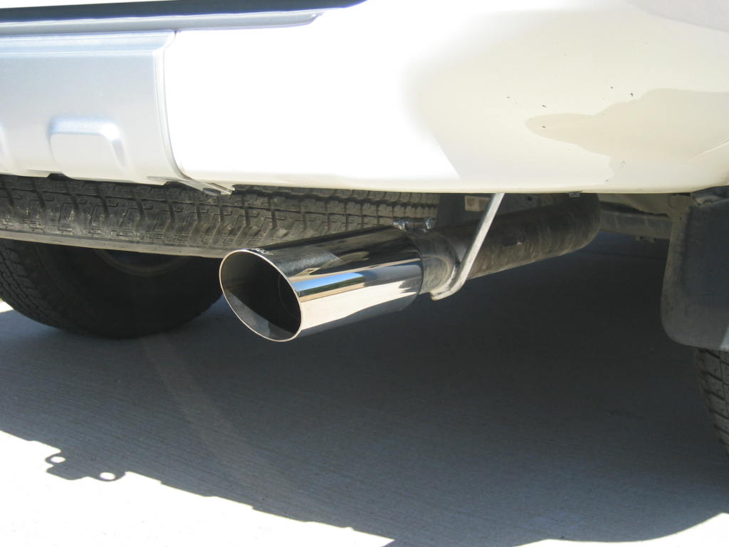

Hey Jason, sorry for the delayed response - just moved to a new house in Mckinney, TX (anyone in the area message me if you know if some good offroading/camping) and trying to get settled in. Here are a few more pics of the Gibson installed. Still love it - still gets good gas mileage and turns a few heads!!

I purchased from Jason a few weeks ago and installed it. I was a bit dissappointed with the flange that meets up with the stock midpipe as it was machined a bit to small. I had spend some time widening it out as the bolt holes didn't allign properly. Other than that, I am pretty happy with it.
Didn't go with Jason, but I did just purchase a Gibson Exhaust. Pics will be up soon.
My only gripe about this exhaust would be the mid-pipe connecting bolts that were supplied with the kit. Gibson did not include any springs at all, compared to the stock connecting bolts. This seems like it would put alot of stress on the exhaust manifolds, wouldn't you think so? I mean, the springs are there to help the pipe flex when it needs flexing, such as going over unexpected pot holes.
