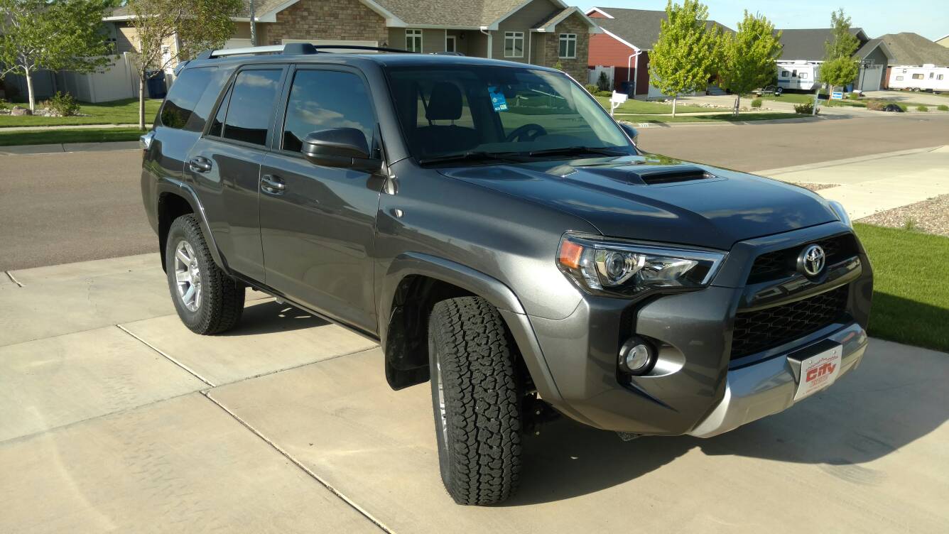

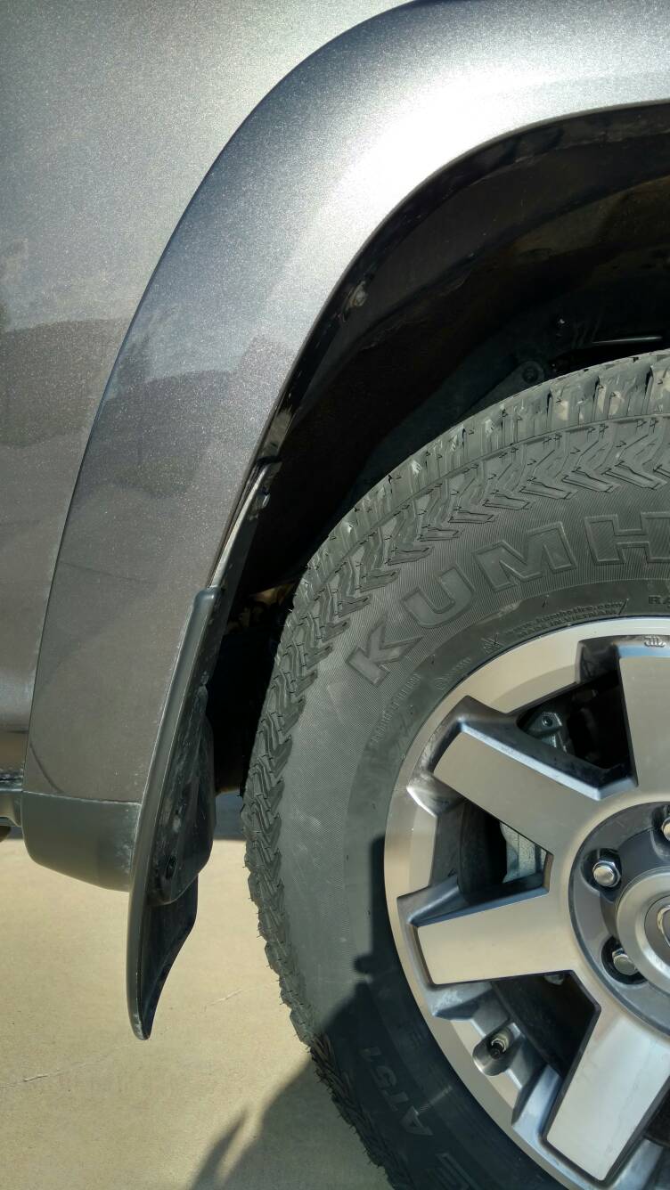

Just installed Kumho 275/70/17 on stock wheels 17*7 with 15 mm offset , no mods , no rubbing, no lifts.

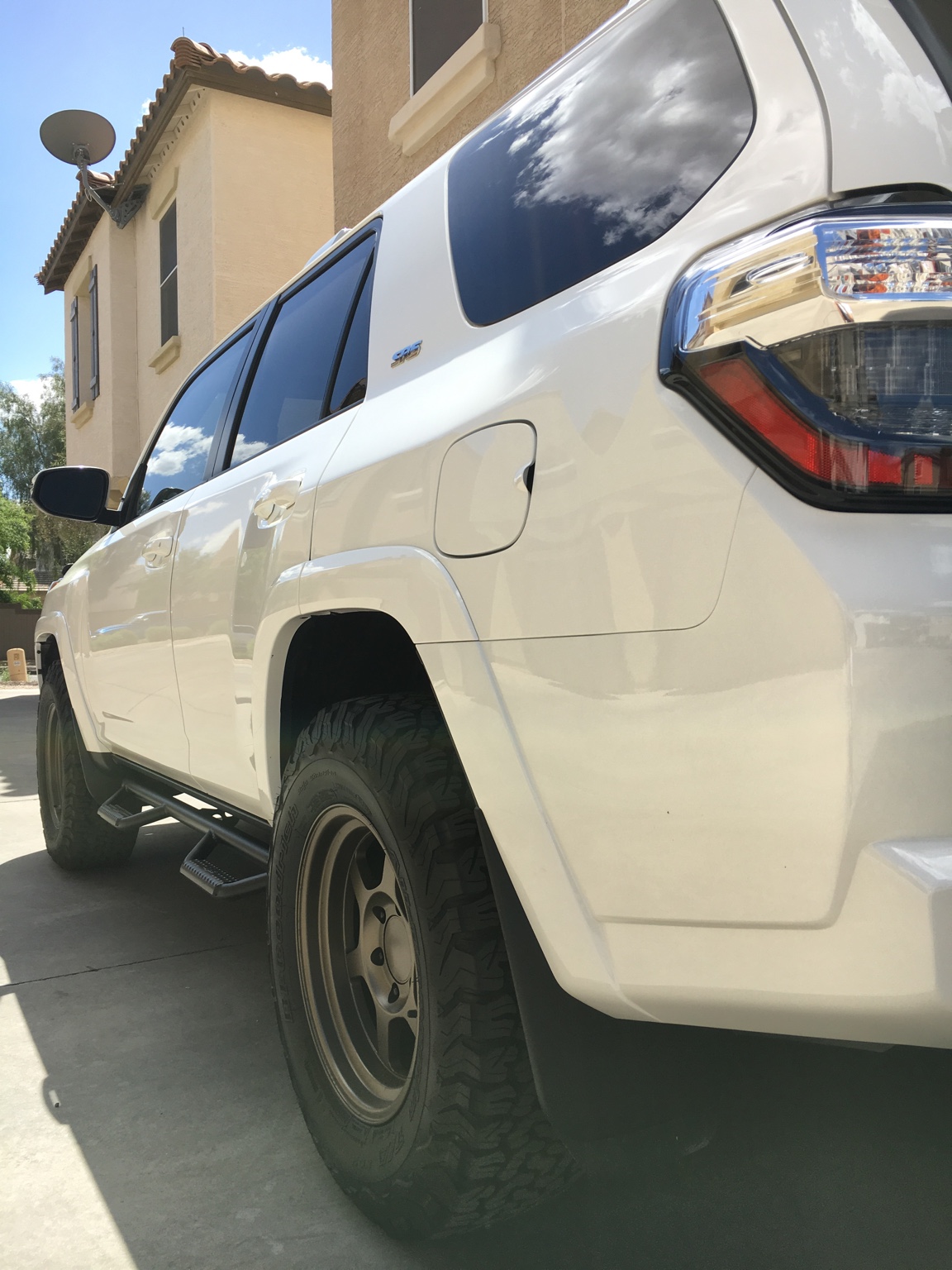

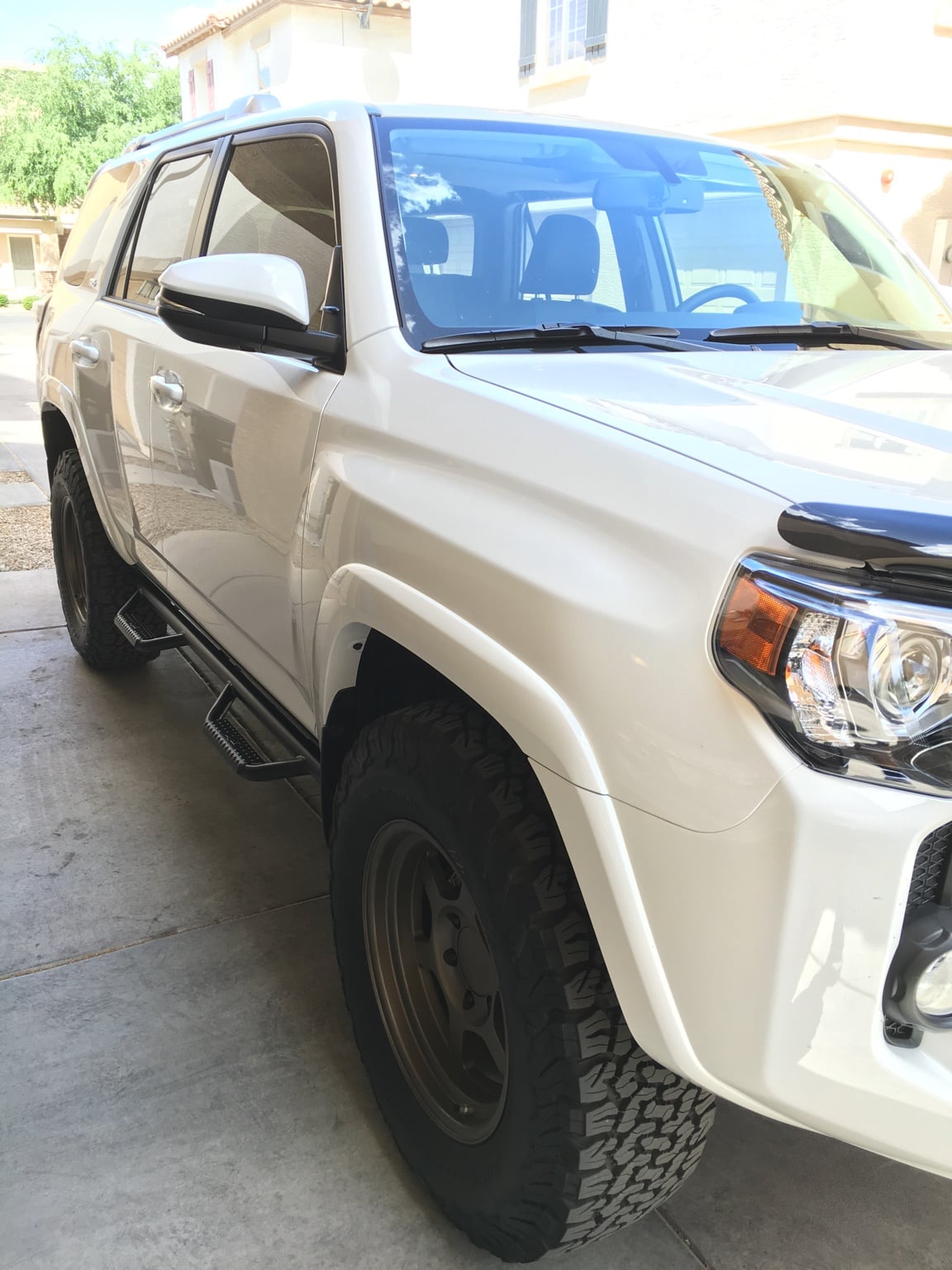

For what it's worth, I have 265 KO2's on 17x8 FN wheels with -10 offset and 4.1" of backspacing. With stock suspension, I had a very aggressive setup IMO with the wheels and tires much further out compared to stock wheels but I did have rubbing at full lock in reverse. AFTER lifting the front with Billy's set to 1.75 - I no longer have any rub at all and I wish I had 275's. I wonder if discount tire will hook me up on upgrading my tires from 265 to 275. Hahaha. I don't need them but I just want them.
[MENTION=134037]singletrackftw[/MENTION].. Can we get more pic of your rig... full shot, side shot wanna see how much wheels stick out with those offset. Love the wheels btw.. Thanks

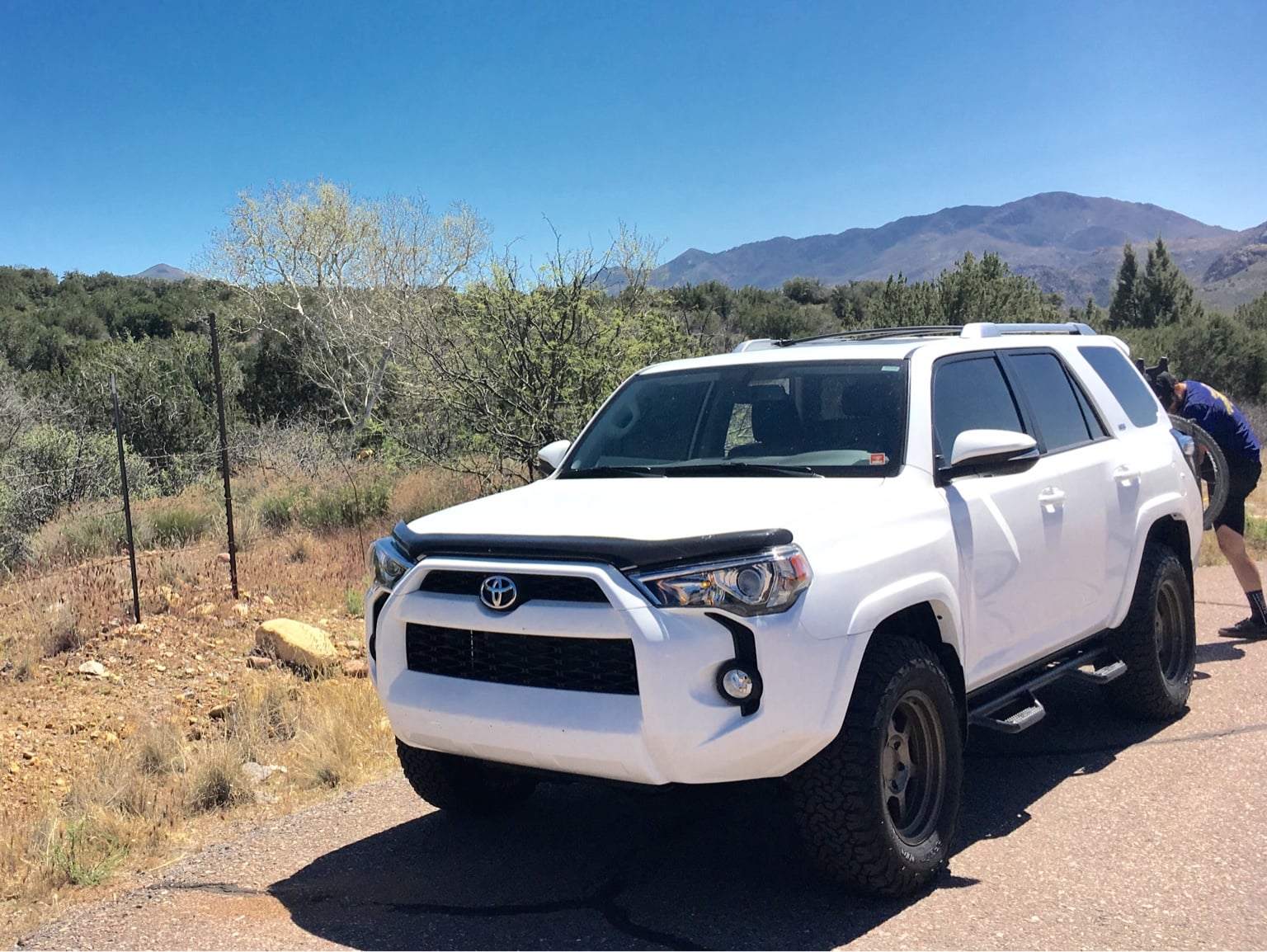

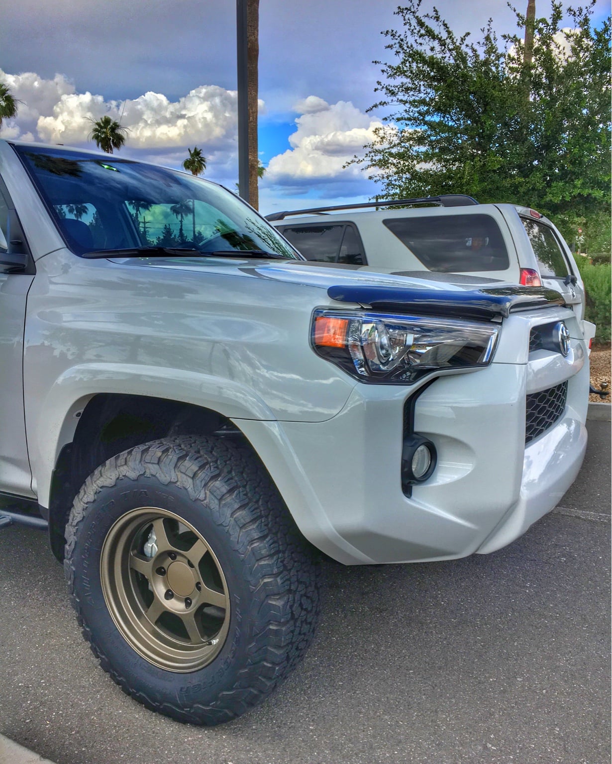

Thanks a lot! I'll get some more pics of the side and quarter views but here are a couple pics from BEFORE I ever lifted the truck.

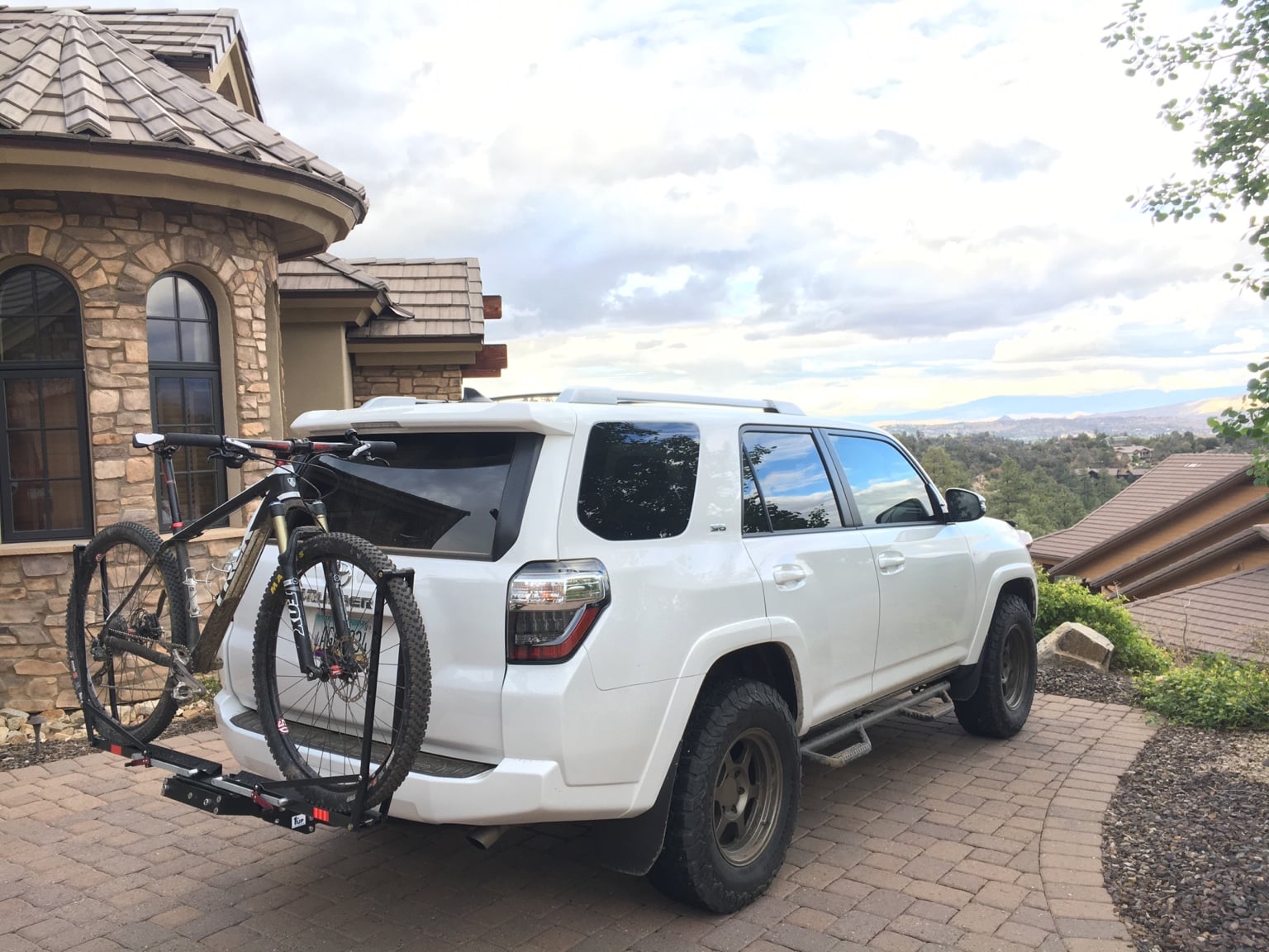

In This last pic the truck is not lifted but it looks more level because of the hitch rack and 2 bikes on the back.

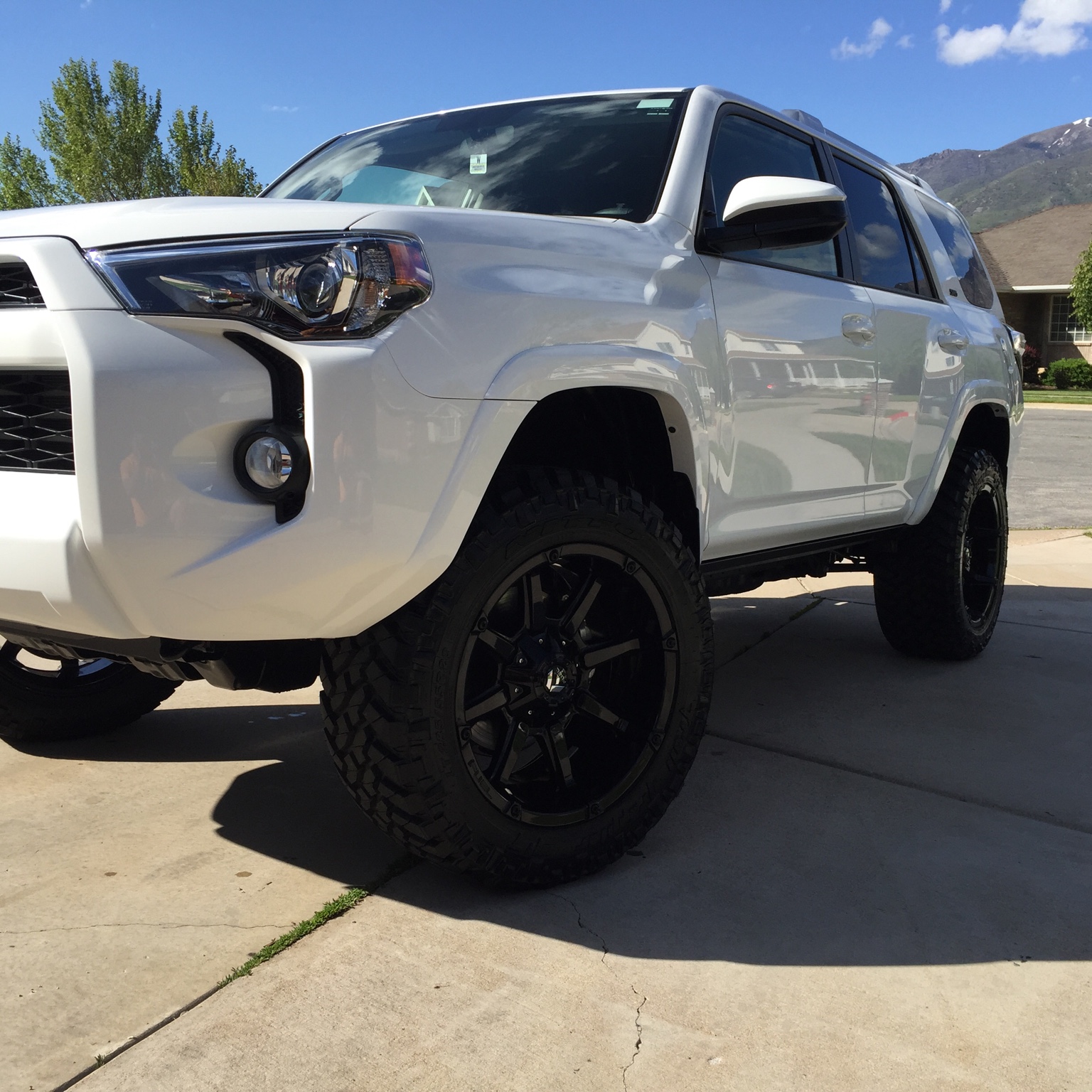

i get the feeling a lot off people get scared when reading this. it scared me..
i contemplated getting 275 with no spacers based on the graph (scary red)
not being one to play it safe or too worried about busting out the dremel i went with a 1.25 inch spacer and 285s. i trimmed what i think is very little and dont rub at all (including offroad) didnt even have to take off the mudflaps
kinda wanna go bigger now tbh.
