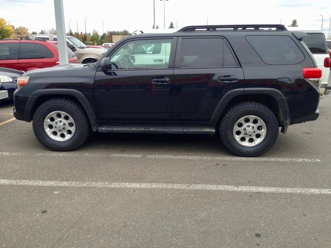

I'll just throw this out there, last week I had BFG KO2 285/70/17 installed. Before I went to the shop, I did the fender liner mod. There was rubbing after the install but removing the front mud flaps cured that problem.
I had 285/70/17 Cooper A/TW put on today. I pulled the front fender liners forward and massaged the front mudflaps with a heat gun last night and so far so good. No rubbing while driving around today on pavement or over curbs and speed bumps. I'll have to get out and have some fun with it soon and see if there is any rubbing under compression but it looked pretty good to the naked eye.
Are those with stock wheels less likely to rub than those with the aftermarket ones? Anyone know the offset on the stock trail wheels?
I am looking at 3" of lift and 275's but only because I am afraid that 285's will require me to remove my mudflaps and I am quite partial to them. I know that I've seen quite a few TRDP's with 275's and no rubbing so perhaps it has something to do the offset on the TRD wheels also.
Of course there are variances with every vehicle as some seem to toss on 285's without a single rub while others have to resort to cutting and hacking.

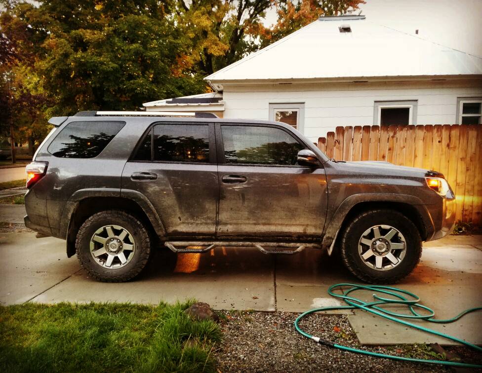

After a bad week with a broken phone and a flat tire out in the middle of the woods on 2 month old tires... it was time to get the aggressive tires on because i live in north idaho. Anyways i wanted to go up a size in tires but they didn't have them in Stock. Maybe adding a lift will make it look cooler.
Currently Costco has a sale on the BFGOODRICH KO2s! 265/70/17.
What's a good lift size?
And what's a decent set of rims looking for a set of 4 under 500!

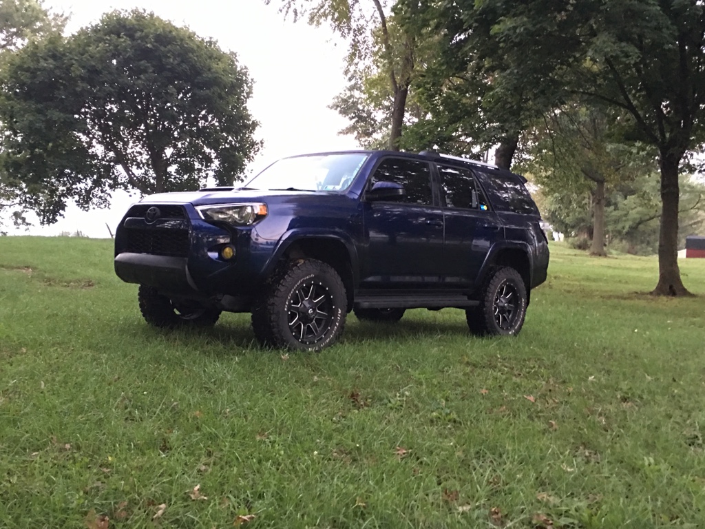

What are the specs on these wheels, brand and offset. Are you running any type of lift or level
Sent from my SAMSUNG-SM-G891A using Tapatalk
Fuel maverick wheels 18x9. Offset -12
285/65/18 bf Goodrich at 2 tires.
Zero lift
This is after 3" toytec lift with billstein 5100's
Zero lift
I love it. I'm going that same route but I'm gunna only do the 1" spacer. Thanks for the info
You will rub at mud flaps. And from bumper and bumper liner.
Sounds like an easy fix. I was gunna go 285 60 18 cooper zeon. Hopefully that won't rub as much since it's not an aggressive tire
