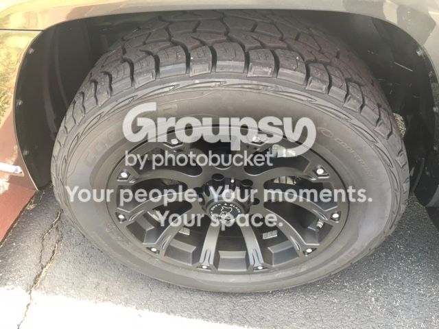

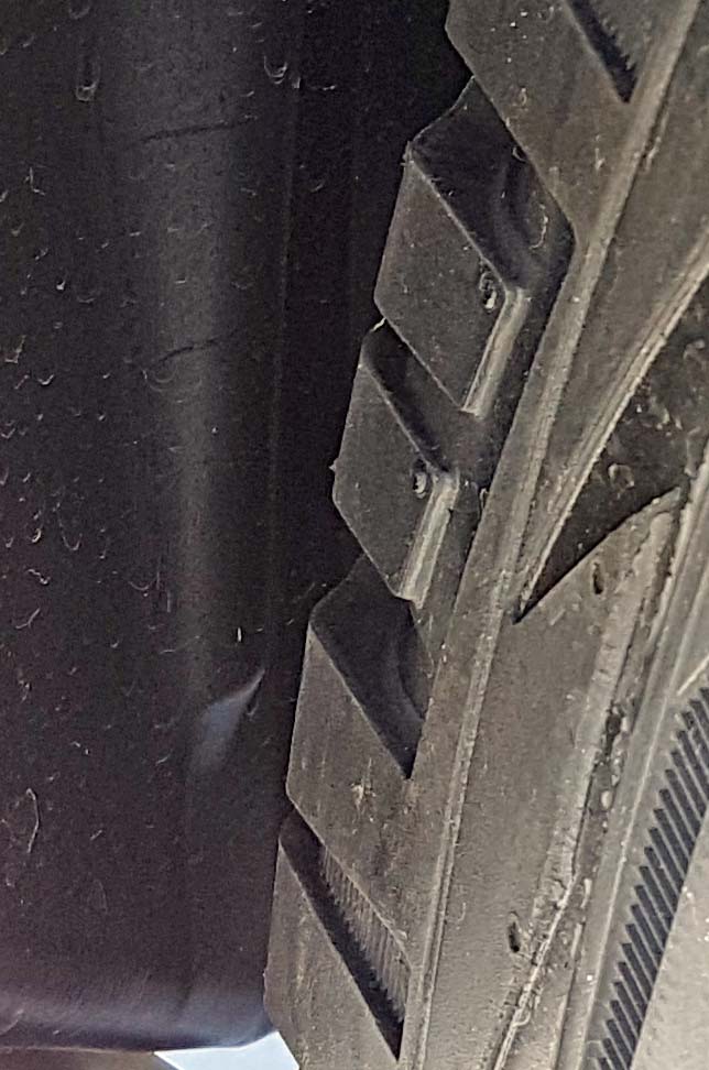

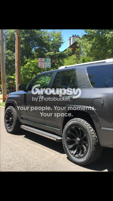

Definitely different for every vehicle. I assumed I was in the "safe" zone with 20 x 9 (-12) Black Rhino Sidewinders with 275/55 R 20 Tires and I have slight rubbing (barely) on front and decent rubbing (Last 20% of stroke) on rear mud flap. Rubbing both when moving forward but also quite a bit in reverse.
Thanks for this. I have took some Nitto TG off my Chevy with stock 20's and was hoping i could put them on my limited. Looks like i can!

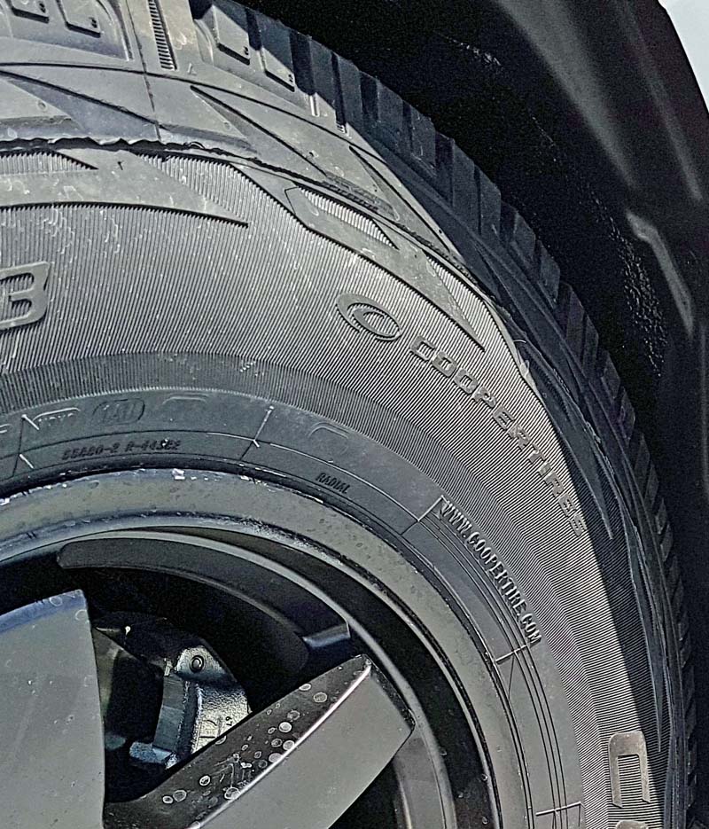

No problems here. No rubbing either. I ran that size of Toyo AT2 on my 2013 LE then changed to my 2015 LE and made it to 50k without issue. I could have have 10k or more to. There has been a little round of the edge but that probably has a little to do with going on the narrower side of the recommended rim width. And maybe my driving (mostly city).

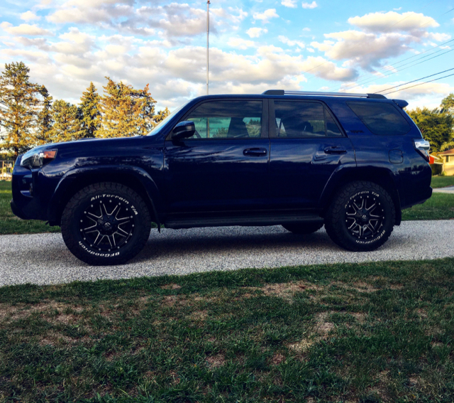

18x9 with 285/65/18 bf Goodrich ko2 tiny bit if rub.
