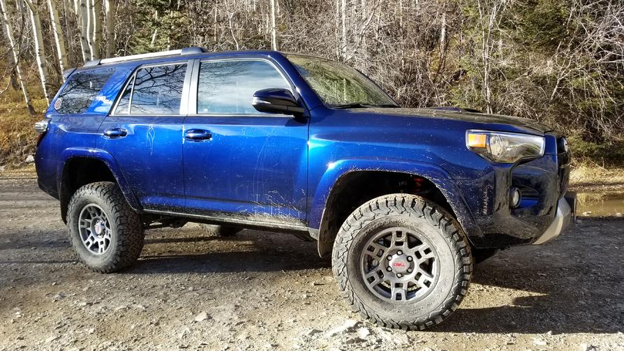

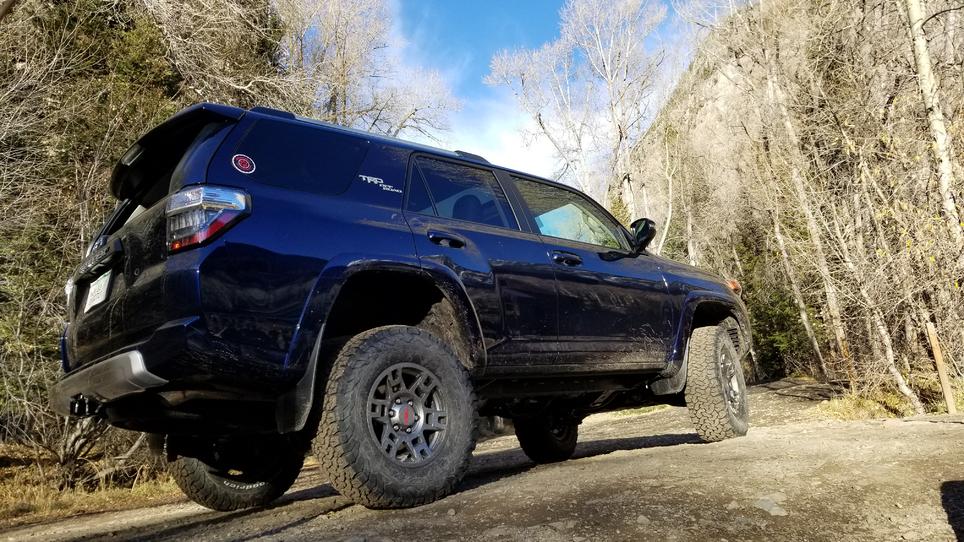

Any pictures of your truck and the wheels in the sunny/bright side, I always look at it and the wheels are always in the shadows (lol). I am just trying to get a feel for the glossy gunmetal FN's, I am torn between the trd pros in black and the FN gunmetals and even matte black, I am also starting to like the Ikon Alphas with grey center and black bead lock.

Guess not lol but I will get one tomorrow and post up. They're glossy and can be as shiny as your paint if you polish and wax them.

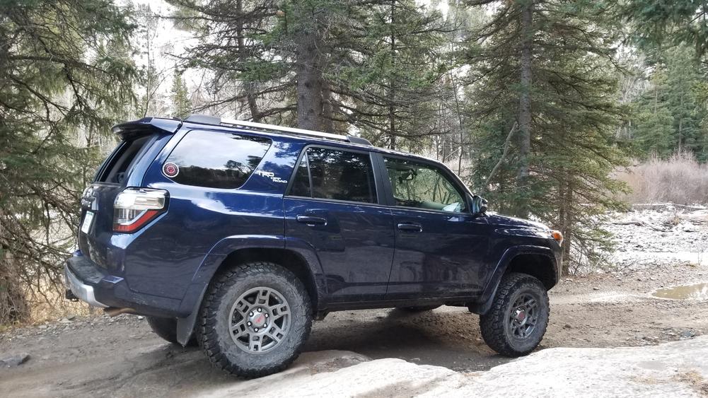

See if these work, just a little muddy here in Colorado.

Thanks, that is helpful but i think the FN;s are much, much darker. I have a MGM, they look great with the blue, nice rig. Thanks for sharing. Are those 275 or 285?
Correct. FN wheels are darker than the MGM body paint. They are also lighter and wider than the stock TRD wheels and they have less back spacing. All around a better wheel and more suited for the width of a 285 or bigger.

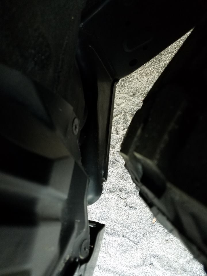

I just installed 275/70r17s BFG K02s with TRD Pro wheels on my stock 2014 Limited.
There is quite a bit of rub only in reverse when turning (mainly on the front right). Not a big deal, I am going to trim or use the heat gun trick; buttttt just thought I would point out. The fit guide says its "green" with 275s, not the case in my experience:-)

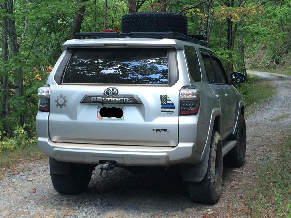

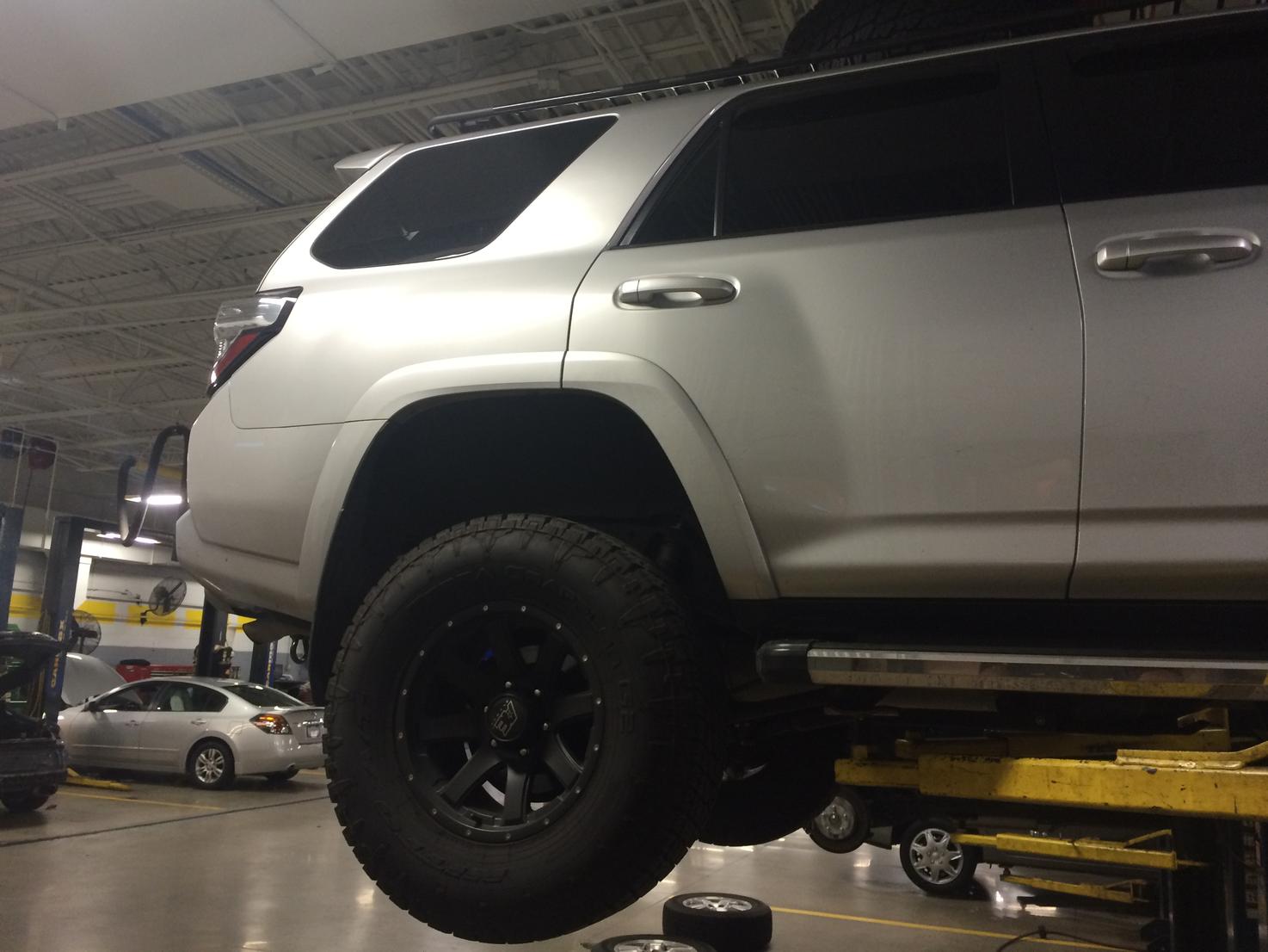

Toyotech lift, total chaos UCAs, spider traxx spacers, Nitto Terra Grappler G2 AT and a little trimming. No rub.. Mostly. I do plan to replace the front bumper with a new one from CBI and that should completely remove the minor rub I get at full lock.
