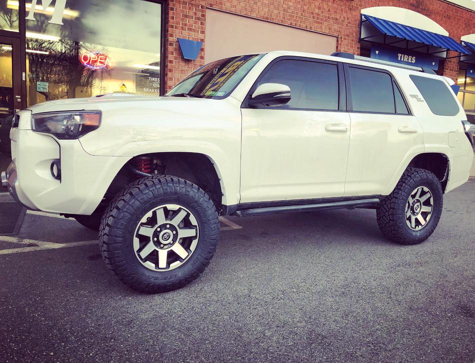

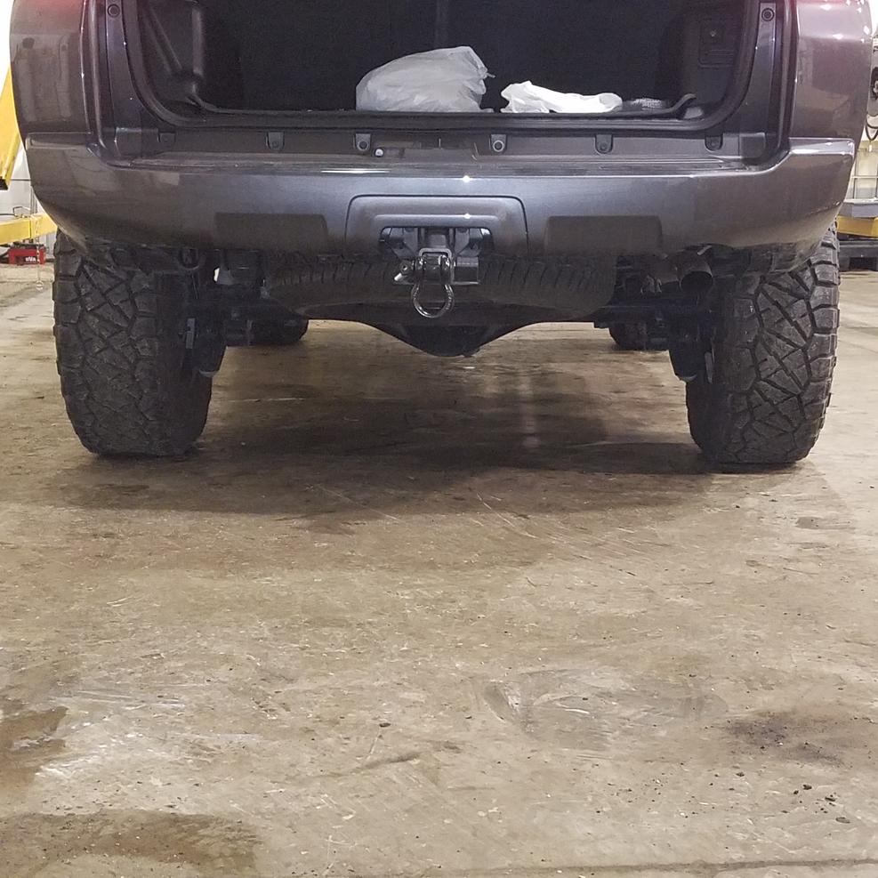

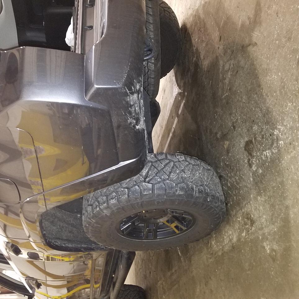

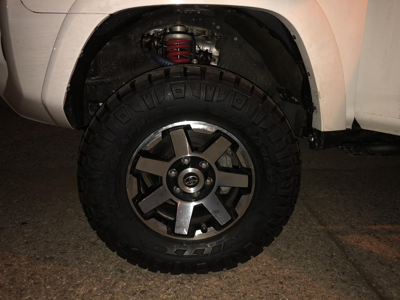

Don't fear the rub. Dremmel, masking tape, 10mm wrench, knife and good to go. Went 285/70R17 ridge grappler, 121Q. Removed mud flaps... They're lame
